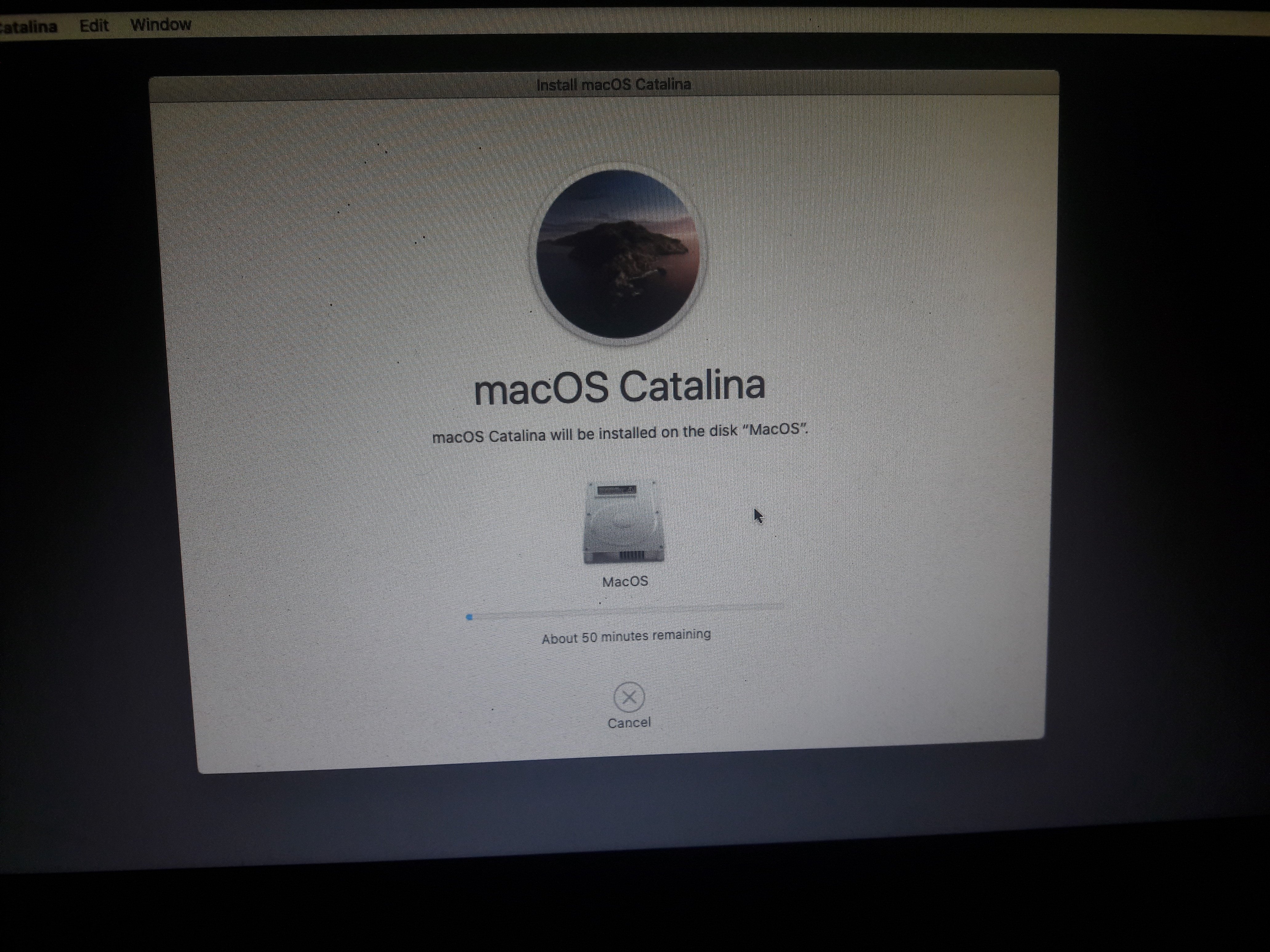

munafpatel Posted October 19, 2019 Share Posted October 19, 2019 (edited) someone help insatller crash while downloading mac os OC.zip Edited October 19, 2019 by ankit_naik Screenshot Link to comment Share on other sites More sharing options...

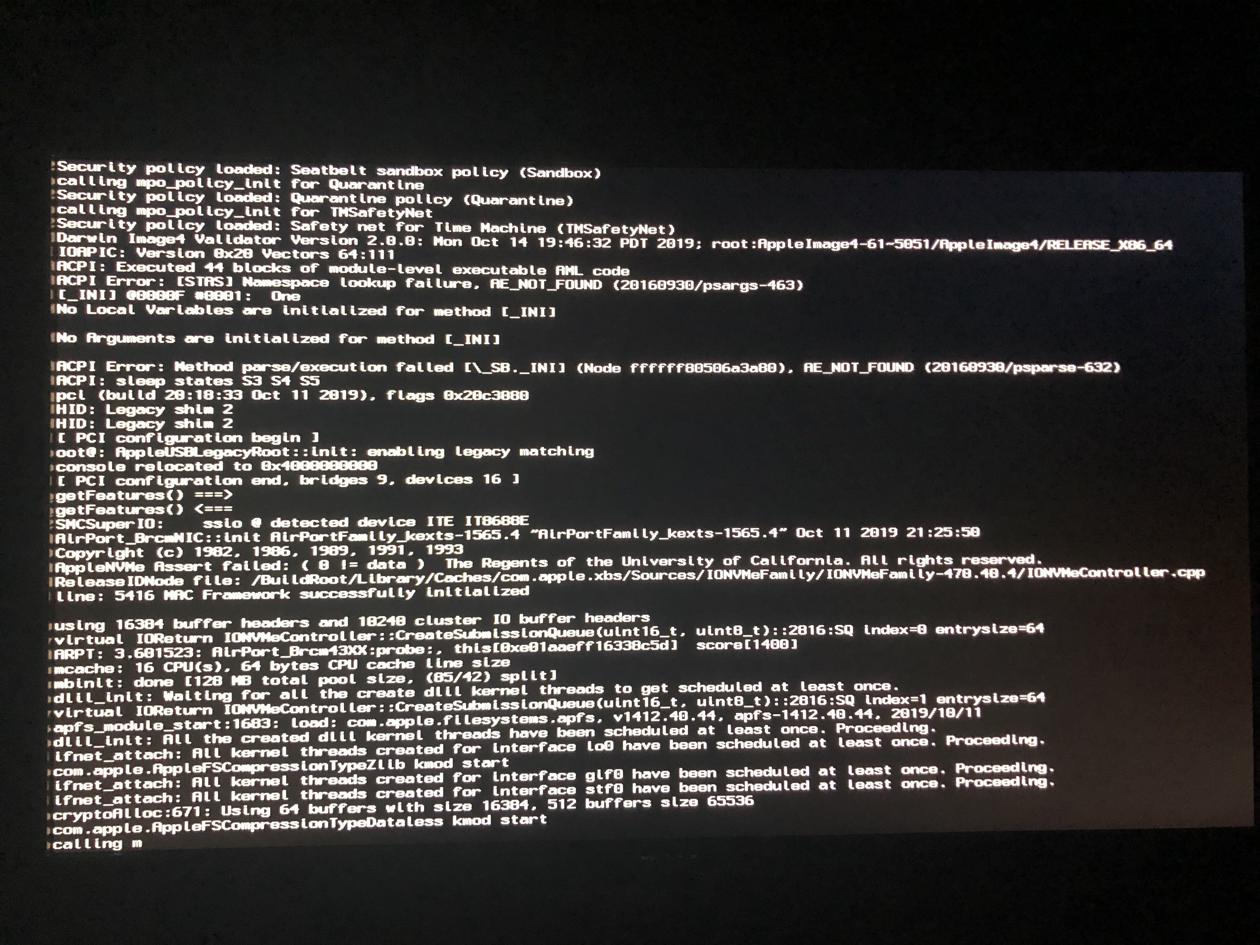

dogansan Posted October 19, 2019 Share Posted October 19, 2019 On 10/13/2019 at 9:33 PM, dogansan said: thanks for help. I deleted FakeSMC and ACS6x.kext from L/E and made off SSDT in config.plist. Now, I see some progress but still no full booting and login. I am using a USB as boot device , it seems my signature is not seen at the bottom, my systems spec are as follows: Desktop PC : Intel Core i7 3370K | ASUS Maximus Formula V |ASUS R7 370 | DDR3 (2x8GB) RGB | 82579V Gigabit LAN | Broadcom BCM43228 802.11a/b/g/n+ Bluetooth | macOS Catalina 10.15.1 Beta 19B68f, Linux , Mojave and Windows Enterprise 10 Build 1903 (Bootloader : Clover r5080 + OpenCore 0.5.1 not yet) I solved the hanging at apfs boot module start during booting by activating SSDT-EC-USBX.aml abd adding nv_disable=1 to boot args. It now boots ,now I have to activate Radeon R9-270 Link to comment Share on other sites More sharing options...
