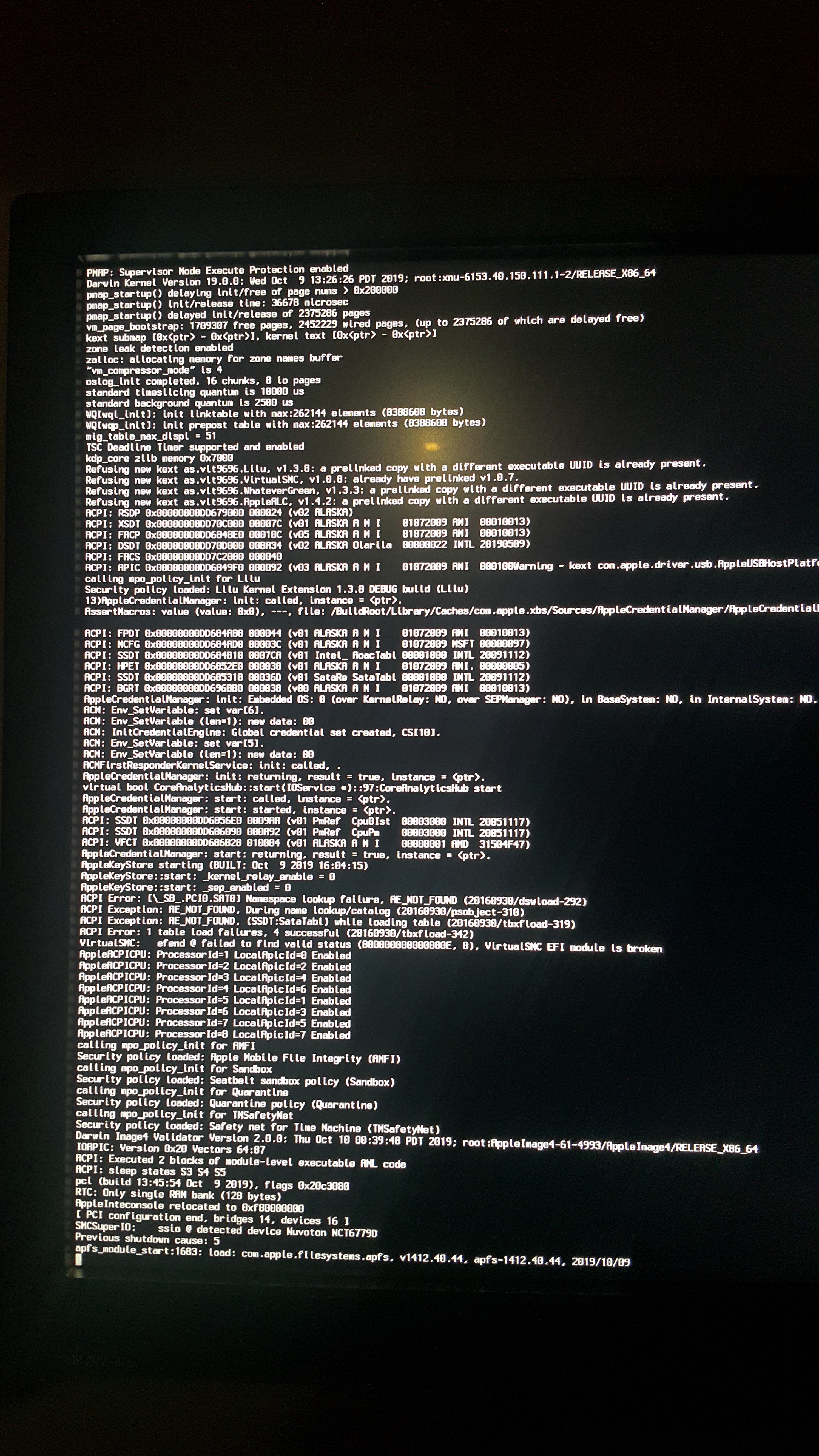

dogansan Posted October 13, 2019 Share Posted October 13, 2019 (edited) On 10/1/2019 at 7:25 AM, Andres ZeroCross said: git clone https://github.com/acidanthera/OpenCorePkg.git Hi Pavo I used your OCBuilder and created attached EFI. I am stuck at the point shown in attached snapshot. I had the same issue some time ago with Clover but I do not remember how I solved it. EFI.zip Edited October 13, 2019 by dogansan Link to comment Share on other sites More sharing options...

Pavo Posted October 13, 2019 Share Posted October 13, 2019 34 minutes ago, dogansan said: Hi Pavo I used your OCBuilder and created attached EFI. I am stuck at the point shown in attached snapshot. I had the same issue some time ago with Clover but I do not remember how I solved it. EFI.zip OCBuilder only compiles the latest comments to the repos and puts them into a correctly EFI structured folder. Its still up to the user to setup the config correctly. 2 Link to comment Share on other sites More sharing options...
dogansan Posted October 13, 2019 Share Posted October 13, 2019 1 minute ago, Pavo said: OCBuilder only compiles the latest comments to the repos and puts them into a correctly EFI structured folder. Its still up to the user to setup the config correctly. Is it possible to tell me what is the issue , by looking at this snapshot of boot log ? Link to comment Share on other sites More sharing options...

Pavo Posted October 13, 2019 Share Posted October 13, 2019 2 minutes ago, dogansan said: Is it possible to tell me what is the issue , by looking at this snapshot of boot log ? Well there are a few things from what I can see that are wrong. - SSDT for SAT0 device isn't correct. - Looks like you are using FakeSMC and VirtualSMC at the same time. One one or the other but not both. - Whatever driver you are using for Accusys is messed up. Without knowing what system specs are I can't determine what is wrong and right. Link to comment Share on other sites More sharing options...

dogansan Posted October 13, 2019 Share Posted October 13, 2019 (edited) 41 minutes ago, Pavo said: Well there are a few things from what I can see that are wrong. - SSDT for SAT0 device isn't correct. - Looks like you are using FakeSMC and VirtualSMC at the same time. One one or the other but not both. - Whatever driver you are using for Accusys is messed up. Without knowing what system specs are I can't determine what is wrong and right. thanks for help. I deleted FakeSMC and ACS6x.kext from L/E and made off SSDT in config.plist. Now, I see some progress but still no full booting and login. I am using a USB as boot device , it seems my signature is not seen at the bottom, my systems spec are as follows: Desktop PC : Intel Core i7 3370K | ASUS Maximus Formula V |ASUS R7 370 | DDR3 (2x8GB) RGB | 82579V Gigabit LAN | Broadcom BCM43228 802.11a/b/g/n+ Bluetooth | macOS Catalina 10.15.1 Beta 19B68f, Linux , Mojave and Windows Enterprise 10 Build 1903 (Bootloader : Clover r5080 + OpenCore 0.5.1 not yet) Edited October 13, 2019 by dogansan Link to comment Share on other sites More sharing options...

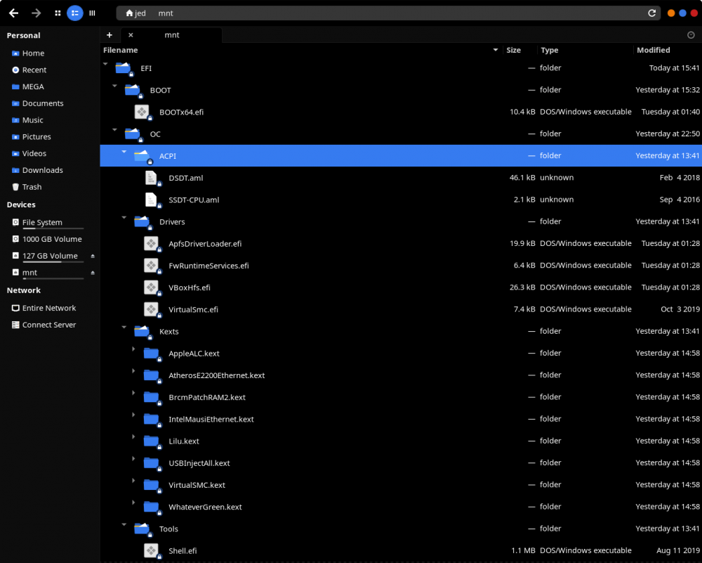

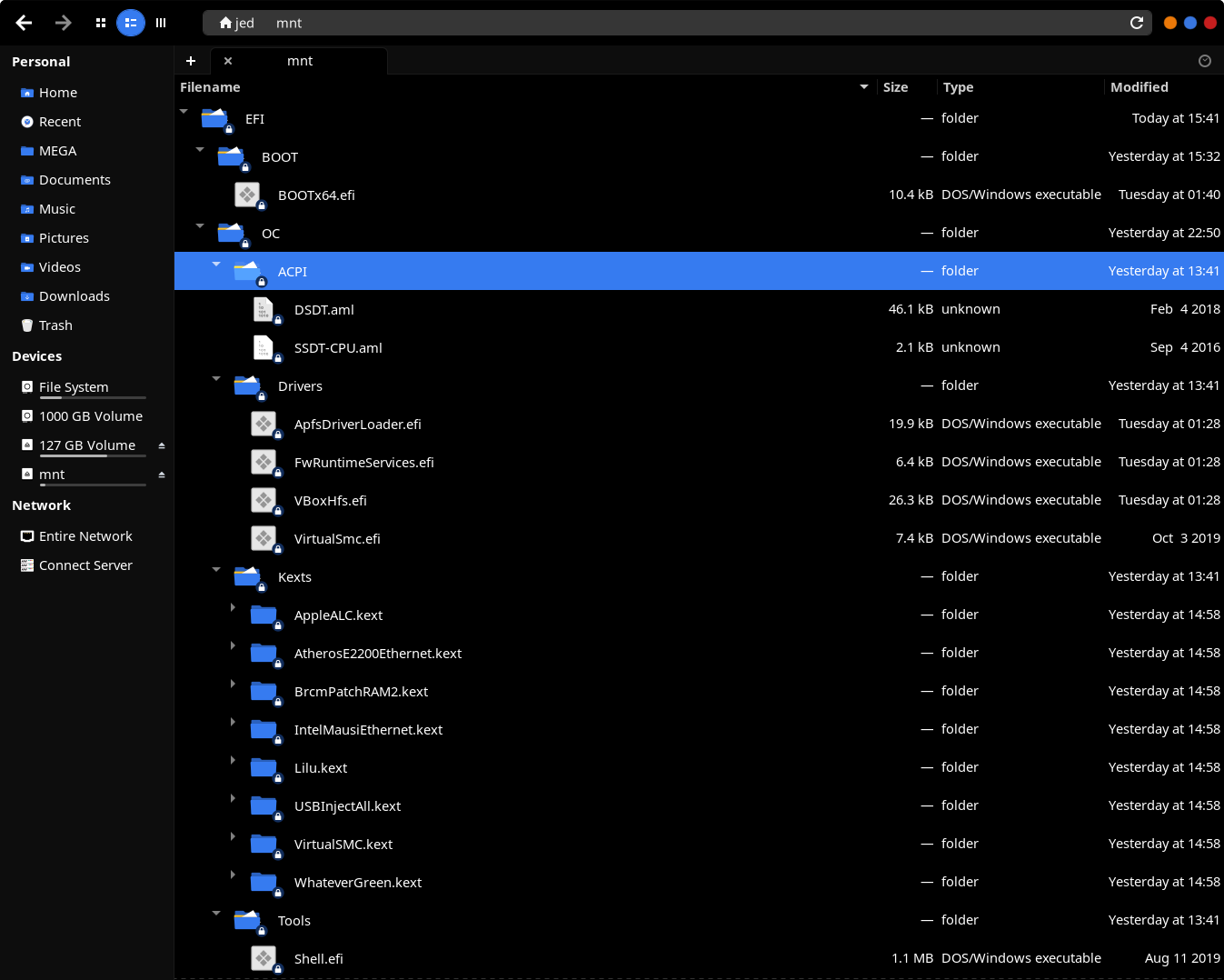

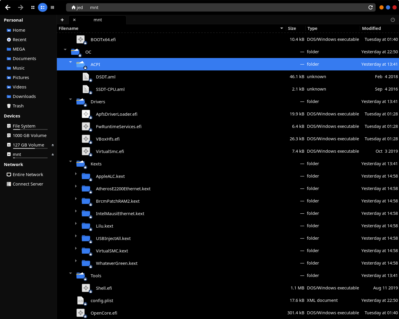

birdbird Posted October 13, 2019 Share Posted October 13, 2019 (edited) On 10/13/2019 at 3:22 PM, STLVNUB said: Post your EFI Folder I'm only allowed to upload 10mb... I'll upload each directory in the EFI folder... I discovered the APPLE folder under EFI has some large files: APPLE/EXTENSIONS/Firmware.scap APPLE/FIRMWARE/IM131.scap Should I delete these? The uploaded files are the rest of the stuff under EFI Please note I deleted my SMBIOS information. I just copied over the working values from my Clover config. That section of the OC config.plist is intentionally empty. Thanks! Edited October 15, 2019 by birdbird remove files Link to comment Share on other sites More sharing options...
Andrey1970 Posted October 13, 2019 Share Posted October 13, 2019 (edited) Delete APPLE folder, and upload EFI folder. Source code it isn't necessary to upload here. Edited October 13, 2019 by Andrey1970 Link to comment Share on other sites More sharing options...
