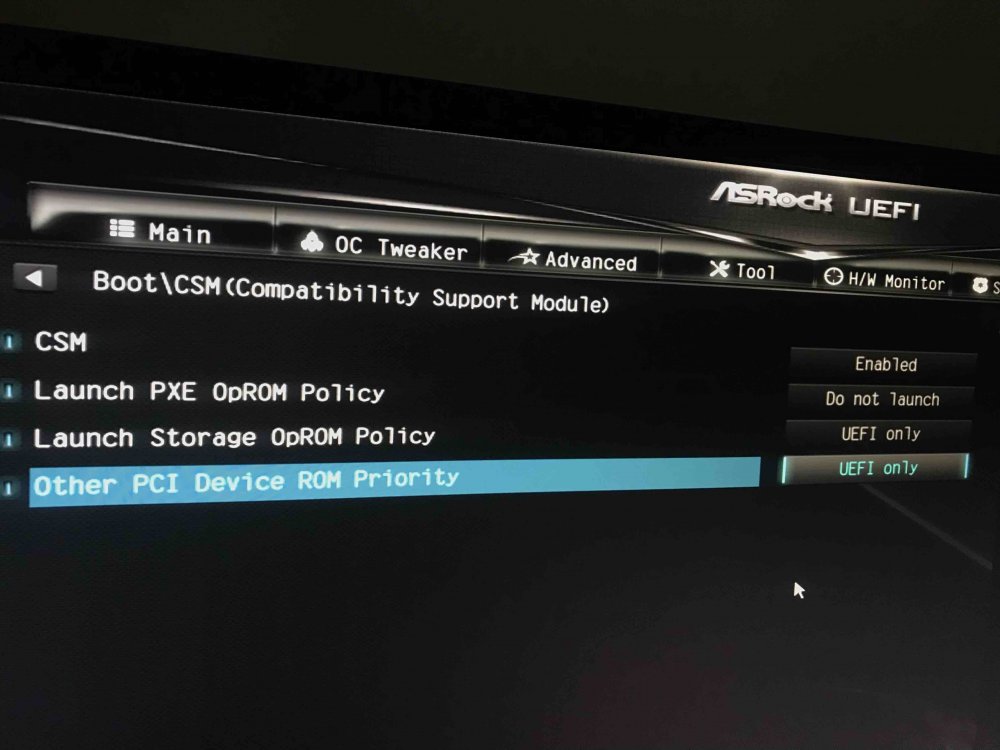

justin Posted September 1, 2019 Share Posted September 1, 2019 (edited) EDIT: add my current config.plist I'm having a strange issue on my Desktop hack, 1. if power cable always on, just shutdown macOS, then do a cold boot, I'm able to see Apple Logo from the beginning to the end, everything works fine. 2. If power cable is plugged off and then plugged on and do a cold boot, i'm not able to see the Apple Logo, OC shows "Time Out" on the boot menu, wait for a while it brings me directly to the second boot stage and then login window, everything other than that works fine too. My hardware is in signature, OC was compared just now. (OC 0.04 same issue), but IIRC, OC 0.03 with AptioMemoryFix.efi did not have this issue. 4D1FDA02-38C7-4A6A-9CC6-4BCCA8B30102:opencore-version DBG-050-2019-09-01 ProvideConsoleGop is set to YES. I have attached the debug log of the 2 case, hope you guys take a look and give some advise. Thank you a lot. @vit9696 @Download-Fritz @Andrey1970 power_cable_always_on_coldboot.txt power_cable_off_then_on_coldboot.txt config.plist Update: Problem solved, I reflashed BIOS firmware, and the problem gone. I think it was due to running ClearNVRAM too many times... Edited September 3, 2019 by justin Link to comment Share on other sites More sharing options...

justin Posted September 2, 2019 Share Posted September 2, 2019 (edited) 22 hours ago, justin said: EDIT: add my current config.plist I'm having a strange issue on my Desktop hack, 1. if power cable always on, just shutdown macOS, then do a cold boot, I'm able to see Apple Logo from the beginning to the end, everything works fine. 2. If power cable is plugged off and then plugged on and do a cold boot, i'm not able to see the Apple Logo, OC shows "Time Out" on the boot menu, wait for a while it brings me directly to the second boot stage and then login window, everything other than that works fine too. My hardware is in signature, OC was compared just now. (OC 0.04 same issue), but IIRC, OC 0.03 with AptioMemoryFix.efi did not have this issue. 4D1FDA02-38C7-4A6A-9CC6-4BCCA8B30102:opencore-version DBG-050-2019-09-01 ProvideConsoleGop is set to YES. I have attached the debug log of the 2 case, hope you guys take a look and give some advise. Thank you a lot. @vit9696 @Download-Fritz @Andrey1970 power_cable_always_on_coldboot.txt power_cable_off_then_on_coldboot.txt config.plist CSM was totally Disabled, with following BIOS settings, Problem Solved: Enable CSM and set both "Launch Storage OpROM Policy" "Launch PCI Device Priority" to UEFI only. Edited September 2, 2019 by justin 1 Link to comment Share on other sites More sharing options...

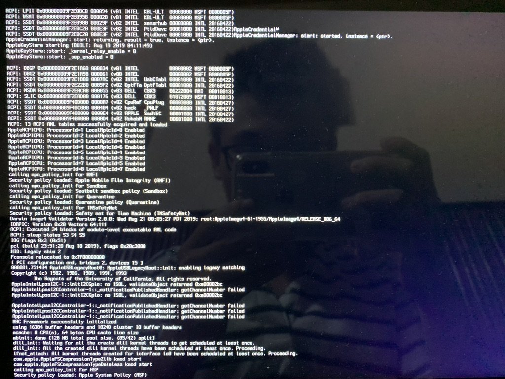

baddles Posted September 2, 2019 Share Posted September 2, 2019 Hi, I'm currently new to OpenCore and I have finished setting up my config.plist. When I tried booting, it freezes here. May I ask why and any solution to this? I have attached the config below for further assistance. My specs: Dell Inspiron 13 7373 i7-8550u 16GB RAM. SATA M.2 SSD - Currently booting from Internal SSD. config.plist Link to comment Share on other sites More sharing options...

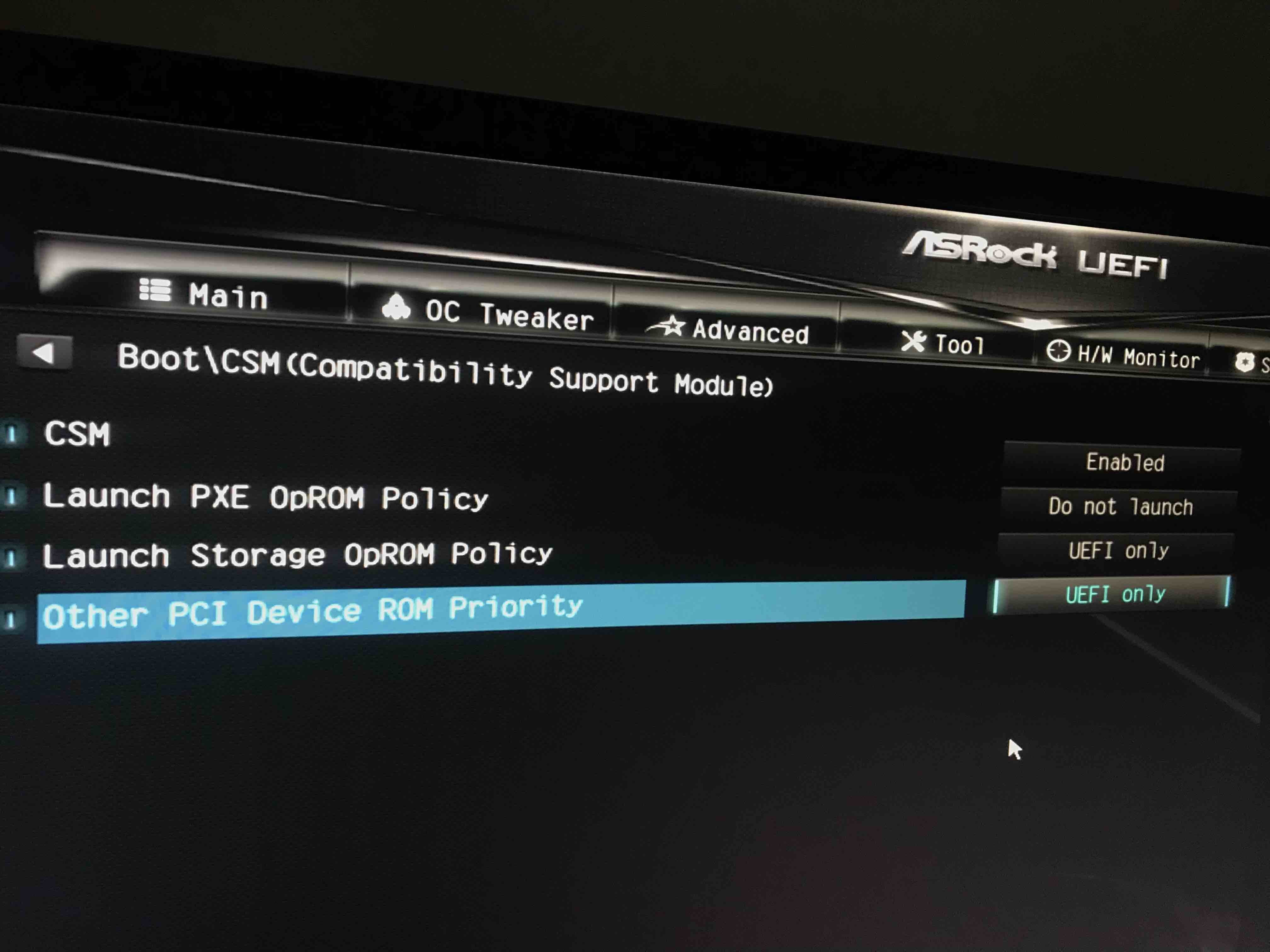

maddie Posted September 3, 2019 Share Posted September 3, 2019 22 hours ago, justin said: CSM was totally Disabled, with following BIOS settings, Problem Solved: Enable CSM and set both "Launch Storage OpROM Policy" "Launch PCI Device Priority" to UEFI only. It seems that on some Asrock boards, CSM needs to be Enabled. At least that's how yours and my Deskmini build behaves. My Deskmini won't even have proper graphics working on boot with CSM off (black screen, no signal from DP/HDMI). Link to comment Share on other sites More sharing options...

justin Posted September 3, 2019 Share Posted September 3, 2019 7 hours ago, maddie said: It seems that on some Asrock boards, CSM needs to be Enabled. At least that's how yours and my Deskmini build behaves. My Deskmini won't even have proper graphics working on boot with CSM off (black screen, no signal from DP/HDMI). Reflashed BIOS firmware, problem gone. 1 Link to comment Share on other sites More sharing options...

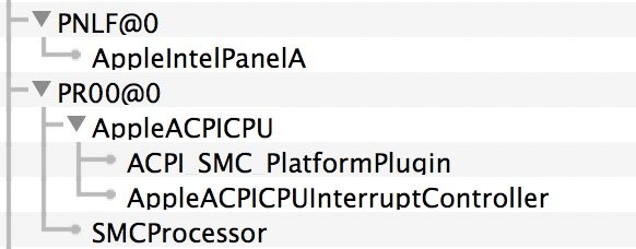

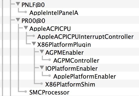

iGPU Posted September 4, 2019 Share Posted September 4, 2019 (edited) I'm having difficulty getting XCPM to work in OC. The mobo is an ASUS Prime Deluxe X299 with MSR disabled, so XCPM should work natively. In the attached screen shots shown are the Clover activation (X86PlatFormPlugin present) and the lack of activation in OC. I also attached the PLUG file. I've tested this in both Mojave 10.14.6 and Catalina 10.15 ß7 and get the same results in both. OC is latest 0.5.0 release. Both Clover and OC have the same SSDTs, Patches, and KEXTs. I've also verified XCPM activity in Clover and none in OC using various test commands in Terminal. Updated Question (6-Sept): in Clover, the PluginType check box is essential for XCMP activation. If left un-checked, XCPM does not work. So what would be equivalent to use in OpenCore? OC: Clover: EDIT:9 Sept 2019: SOLVED Most on-line SSDT methods for trying to inject X86PlatformPlugin use the following code, which did not work on the X299 ASUS Prime Deluxe in OC. Not working in OC: Scope (_SB.PR00) { Method (_DSM, 4, NotSerialized) // _DSM: Device-Specific Method { If (LNot (Arg2)) { Return (Buffer (One) { 0x03 }) } Return (Package (0x02) { "plugin-type", One }) } } The first line can also appear as Scope (_SB.CP00) or Scope (_SB.CPU0) depending upon the mobo. But none of these variations work the the X299 ASUS Prime Deluxe mobo.For this mobo, I finally found that it required the following code: Scope (\_SB.SCK0.PR00). Working in OC: Scope (\_SB.SCK0.PR00) { Method (_DSM, 4, NotSerialized) // _DSM: Device-Specific Method { If (LEqual (Arg2, Zero)) { Return (Buffer (One) { 0x03 }) } Return (Package (0x02) { "plugin-type", One }) } } Attached is the SSDT file that works with OpenCore with the X299 ASUS Prime Deluxe, properly injecting X86PlatformPlugin (it will probably work with other X299 mobos too). It will also work with Clover if you un-check the PluginType box, but why bother. SSDT-Plug-X299.aml Edited September 10, 2019 by iGPU Problem solved. Link to comment Share on other sites More sharing options...

justin Posted September 6, 2019 Share Posted September 6, 2019 On 9/4/2019 at 11:55 PM, iGPU said: I'm having difficulty getting XCPM to work in OC. I'm using an SSDT-PLUG file that works in Clover (but maybe other settings are helping; I'm not certain). The mobo is an ASUS Prime Deluxe X299 with MSR disabled, so XCPM should work natively. In the attached screen shots shown are the Clover activation (X86PlatFormPlugin present) and the lack of activation in OC. I also attached the PLUG file. I've tested this in both Mojave 10.14.6 and Catalina 10.15 ß7 and get the same results in both. OC is latest 0.5.0 release. Both Clover and OC have the same SSDTs, Patches, and KEXTs. I've also verified XCPM activity in Clover and none in OC using various test commands in Terminal. Updated Question (6-Sept): in Clover, the PluginType check box is essential for XCMP activation. If left un-checked, XCPM does not work. So what would be equivalent to use in OpenCore? SSDT-PLUG.aml OC: Clover: upload your orig DSDT.aml 47 minutes ago, gndzer0 said: I have been tinkering with OpenCore for some time now. I really like the project and where it is headed. Documentation is top notch as well. Big thanks to all developers for making this open source project available to all of us! The machine I am using OpenCore on is generally stable. The only issue I have are freezes after wake. More details in the previous post here. Same symptoms on Mojave and Catalina Beta. I have noticed that the machine is pulling ~80W from the wall when it is frozen (it is pulling 30-40W when idle). Looks like something is spinning on the CPU? Couple questions: 1. Is it possible that the following error has anything to do with the freezes? 00:337 00:001 OC: Driver VirtualSmc.efi at 4 is being loaded... 00:441 00:103 VSMC: VirtualSmc 2.1.0 loading... 00:442 00:001 VSMC: Initial key obtain failure - Security Violation 00:443 00:000 VSMC: Failed to remove key - Not Found 00:443 00:000 VSMC: Failed to create status - Security Violation I am not seeing such errors when using VirtualSMC.efi with Clover if that indicates anything. 2. Is some configuration change or boot option required (apart from -v) to get kernel to print panic details to the screen or to the serial console (motherboard has working physical serial port)? I don't see any panic details on screen or on serial console when machine freezes. I am also not getting any messages when I toggle one of the Kernel / Quirks options that are required to boot the OS. Machine simply reboots without sending trace to screen or serial port. I can see standard kernel messages on serial port just fine when using "-v serialbaud=115200 serial=1 debug=0x12a" boot args. Turn on Settings-Sharing-Remote Login. when it freezes, ssh into your macOS, do some debug, such as "top -d1" to see cpu usage. "log show" to see some other stuff. many things you can do. Link to comment Share on other sites More sharing options...

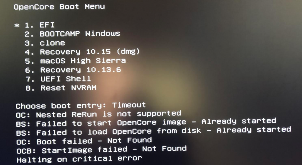

Guest Posted September 8, 2019 Share Posted September 8, 2019 Hi @devs I have this problem with new 0.05 feature PollAppleHotKey with my system in signature, if I set it to true my system hangs in boot menu as you can see in my picture (I can't select anything else of ctrl/alt/del to reboot after error message) setting it to false system starts fine as usual I have same problem using or not UsbKbDxe.efi driver and AllowNvramReset to to true or to false Any help? Thank you Link to comment Share on other sites More sharing options...
