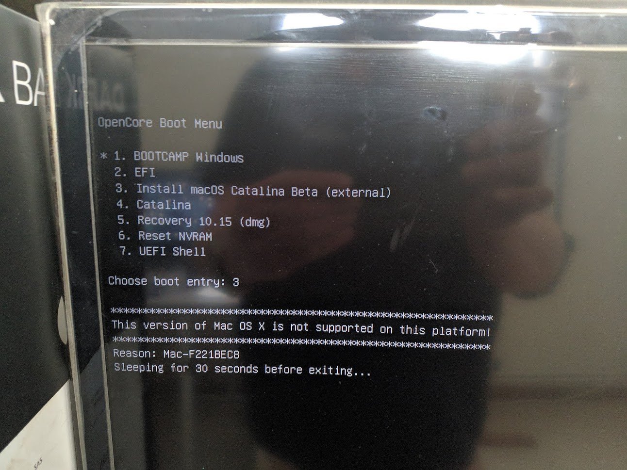

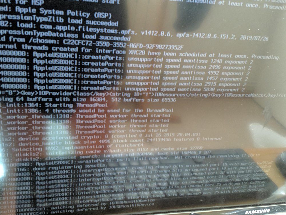

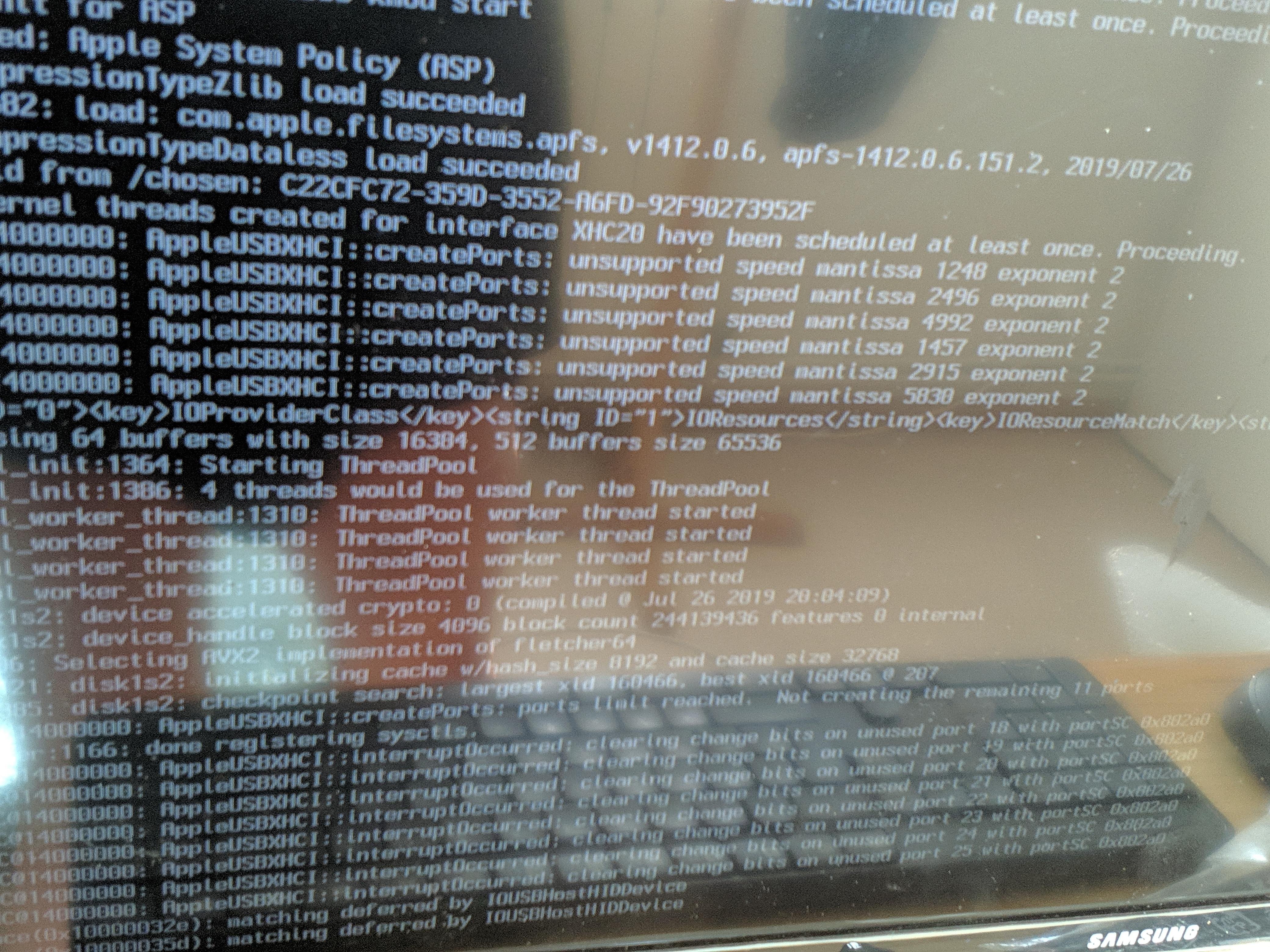

Because I can't install with createinstallmedia method. Just my opinion, there is a issue with DSDT or something else. I don't know. (Images below)

This is not a OC issue. OC can in fact install macOS using the createinstallmedia method, if you can’t then it is something that you are doing to your config or ACPI tables that isn’t allowing it to boot. As per to OC docs, you should not be injecting a patched DSDT.

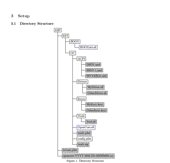

DSDT is in OC structure in Configuration Docs. I don't understand.
Everything in gray background is optional, you don't need them to boot.
Just make sure that:
1. You have OpenCore correctly installed with above directory structure
2. You have config.plist configured correctly for your hardware, and BIOS settings too
3. Add appropriate EFI Drivers to Drivers folder, and kexts to Kexts folder, and add them into your config.plist
4 minutes ago, gengik84 said:
It's only example for efi's structure and it is not mandatory to use dsdt.

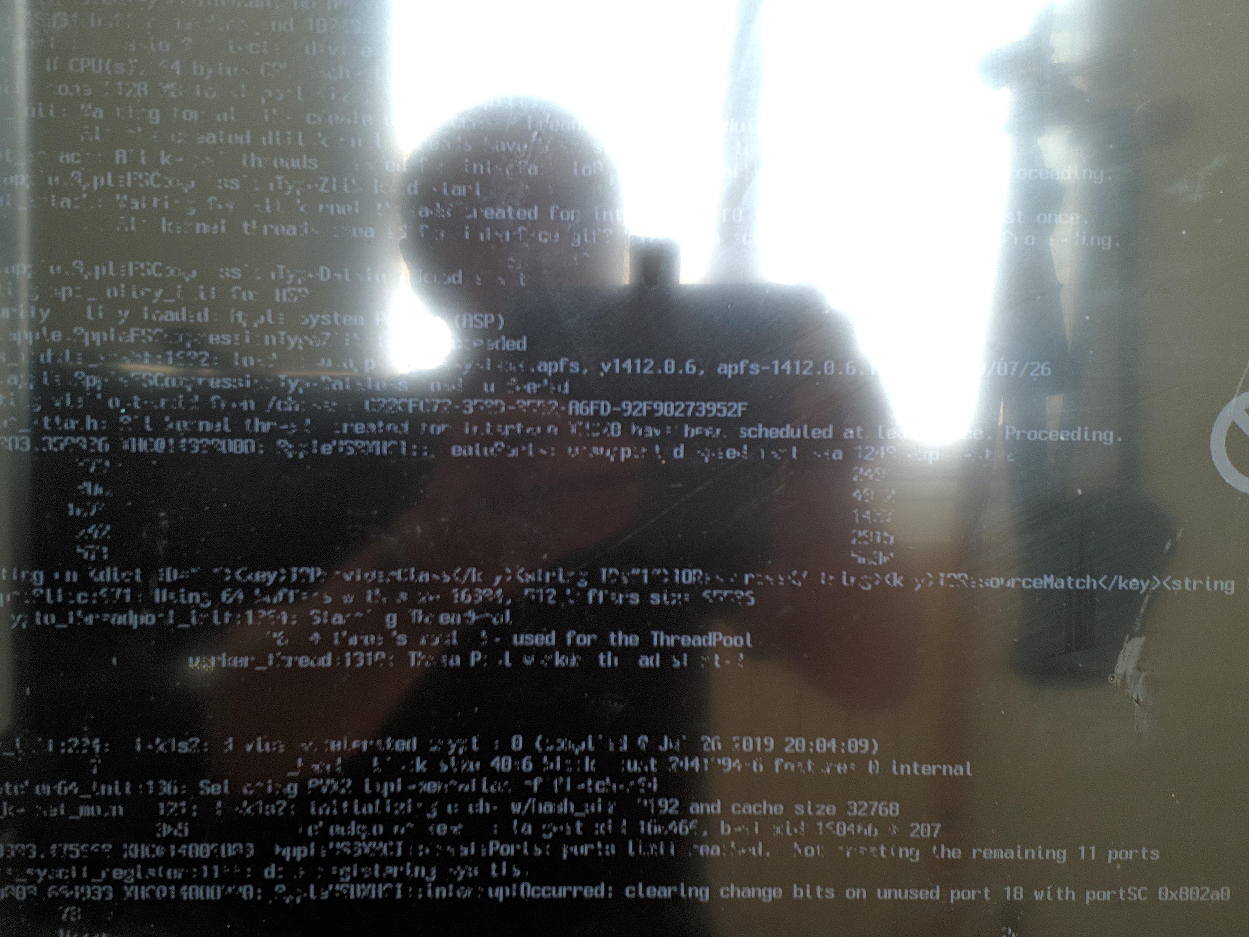

There is another issue now when I try to install via OC USB.
18 minutes ago, Matgen84 said:
What do you means 'sorry for my bad english) about DSDT.
As long as you didn't update your BIOS, just use patched DSDT that i have made.
Your problem above is about USB Limit, just enable limit XCH from your config.plist. Your another problem is SMBIOS,,, Mac-F221BEC8 is not supported by Catalina.
  • Thanks 1

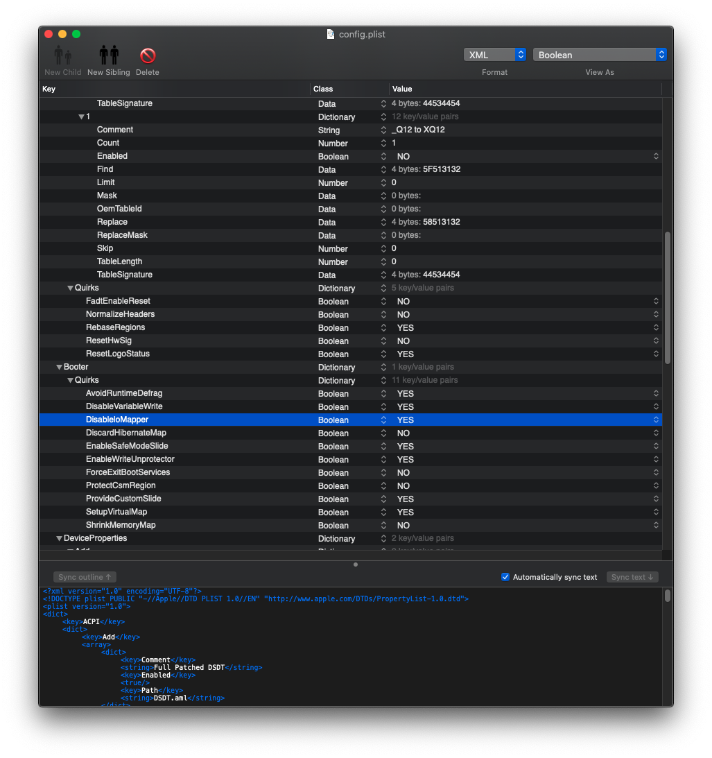

What is this??? DisableIOMapper in Booter? Did you really read doc to edit config.plist??. How can you blame it into patched DSDT????
This is the reason i always refuse to edit DSDT for someone, they change all configuration except DSDT then they blame it into DSDT if there is a mistake with his system
I use your DSDT, enable Limit XCH from config.plist. I don't why SMBIOS is incorrect. Now I put Imac19,1

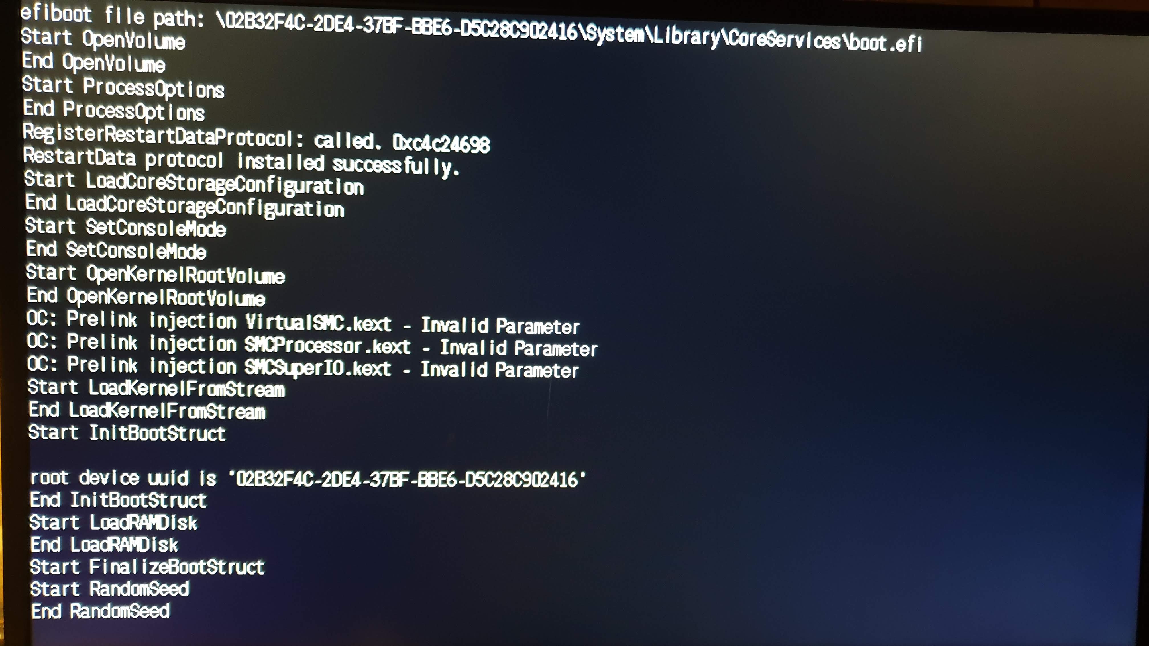

Hi guys!
Question about the latest official VirtualSMC version 1.0.7.
As soon as a change from version 1.0.6 to 1.0.7 and reboot my hack won't boot to Desktop. It will show Apple logo with boot-progress but after 10 seconds or so my screen goes black and stays black, can't remote login nada. Even after several minutes still black screen.
The exact same config except change back to VirtualSMC 1.0.6 from power on to Desktop in about 25 seconds.
This is on Catalina 10.15 Beta (19A526h), latest official OC 0.04 and drivers and kexts.
I didn't see anything on the VirtualSMC Github that anything have to be adjusted in config.plist but I have the feeling that VirtualSMC 1.0.7 on my system isn't loading and I don't get why.
Any clues? Thanks!
  • Sad 1

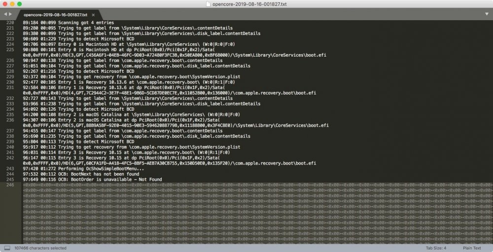

Oops.., thanks for reminder. I did read honestly, but guessing.. not get them really well.

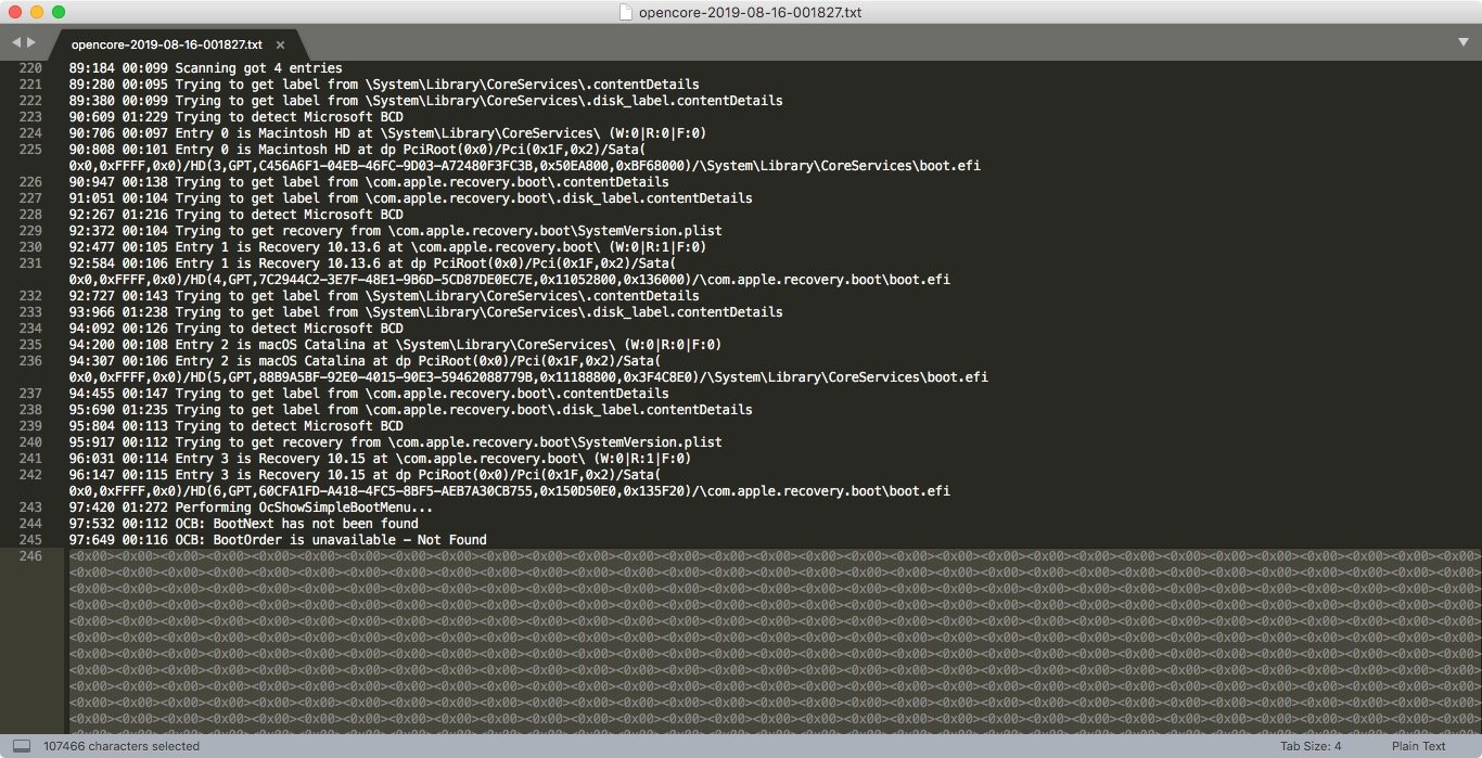

Now it works, but just.. I have no verbose log printed on screen (kernel). macOS 10.13.6 - 10.15 Beta are boot'ed fine.
config-a43sj.plist.zip
opencore-2019-08-15-232556.txt.zip
Edited by Badruzeus
