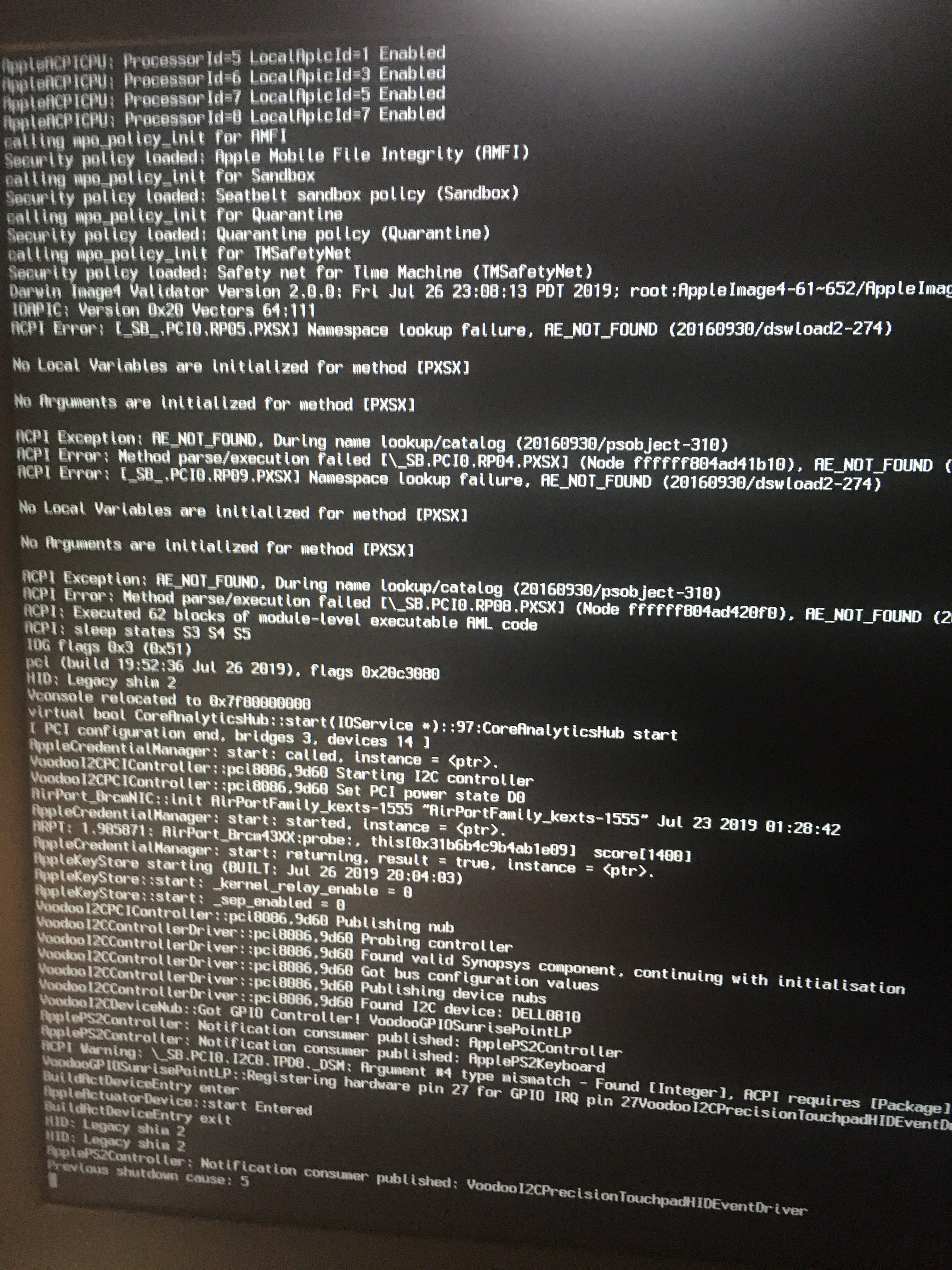

matgeo Posted August 14, 2019 Share Posted August 14, 2019 Need your help. OC with High Sierra works fine , but I cannot boot on Catalina. Can someone take a look ? opencore-2019-08-14-053406.txt OC.zip Link to comment Share on other sites More sharing options...
maddie Posted August 14, 2019 Share Posted August 14, 2019 1 minute ago, matgeo said: Need your help. OC with High Sierra works fine , but I cannot boot on Catalina. Can someone take a look ? opencore-2019-08-14-053406.txt OC.zip Make sure that XHCI hand-off is enabled in your BIOS Link to comment Share on other sites More sharing options...

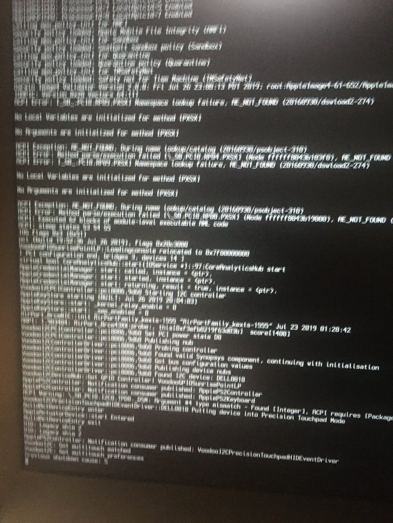

Matgen84 Posted August 14, 2019 Share Posted August 14, 2019 (edited) 47 minutes ago, matgeo said: Need your help. OC with High Sierra works fine , but I cannot boot on Catalina. Can someone take a look ? opencore-2019-08-14-053406.txt OC.zip Do you try boot-args: -v dart=0 debug=0x100 keepsyms=1. Post another screenshot. Complete your signature with your config, please Edited August 14, 2019 by Matgen84 Link to comment Share on other sites More sharing options...

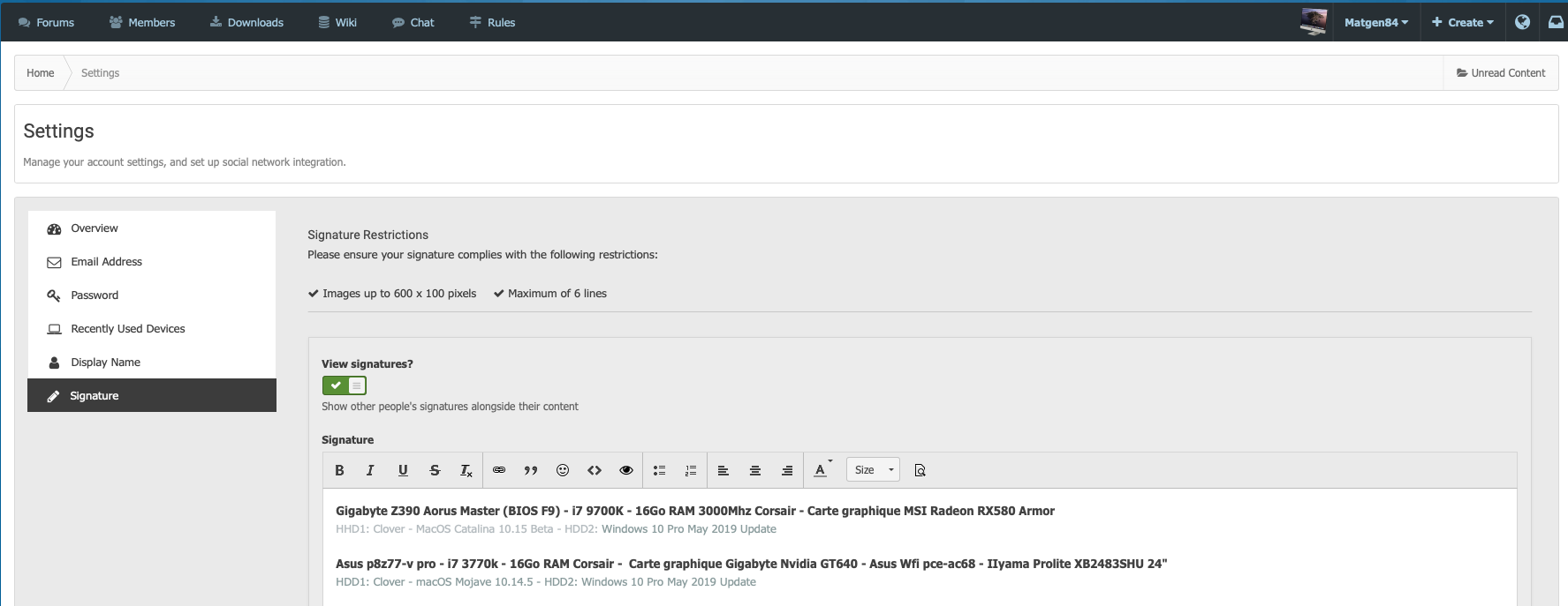

matgeo Posted August 14, 2019 Share Posted August 14, 2019 Sorry , can't figure out how to add my config to profile. My system is a Dell 5570 with : Intel i5-8250u Intel UHD 620 16gb RAM 2 samsung ssd Link to comment Share on other sites More sharing options...
Matgen84 Posted August 14, 2019 Share Posted August 14, 2019 (edited) 23 minutes ago, matgeo said: Sorry , can't figure out how to add my config to profile. My system is a Dell 5570 with : Intel i5-8250u Intel UHD 620 16gb RAM 2 samsung ssd Can you try boot-args: -v dart=0 debug=0x100 keepsyms=1. Reboot then Post another screenshot. For complete signature: left click on your name at top right. Select Account settings then Signature in setting menu (left windows) Edited August 14, 2019 by Matgen84 Link to comment Share on other sites More sharing options...
Andres ZeroCross Posted August 14, 2019 Share Posted August 14, 2019 1 hour ago, matgeo said: Need your help. OC with High Sierra works fine , but I cannot boot on Catalina. Can someone take a look ? opencore-2019-08-14-053406.txt OC.zip WRong ACPI table (DSDT patch) in your configuration. Too many ACPI error about namespace lookup failure in RP09.PXSX, RP04.PXSX, RP05.PXSX, RP08.PSX. This is not good 1 Link to comment Share on other sites More sharing options...
matgeo Posted August 14, 2019 Share Posted August 14, 2019 @Matgen84 , that's what I did. Isn't that right? @Andres ZeroCross , I know about that. But doesn't stop me from booting on High Sierra on both Clover and OC. Is it possible for you to take a look if we can fix that errors? Attaching origin folder. Screenshot 2019-08-14 at 10.35.42 am.pdf origin.zip 1 Link to comment Share on other sites More sharing options...
