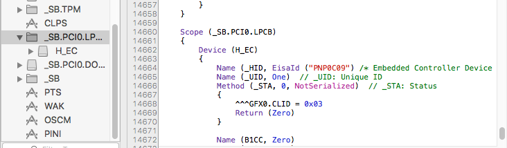

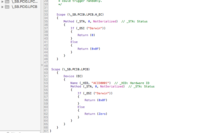

I'm on desktop Haswell system and it seems I have embedded controller of PNP0C09 type.
Did I understood well, and my SSDT-EC.aml should look like this?
or just use one of this methods and then add power to my USB legacy kext ? Please some hints.
