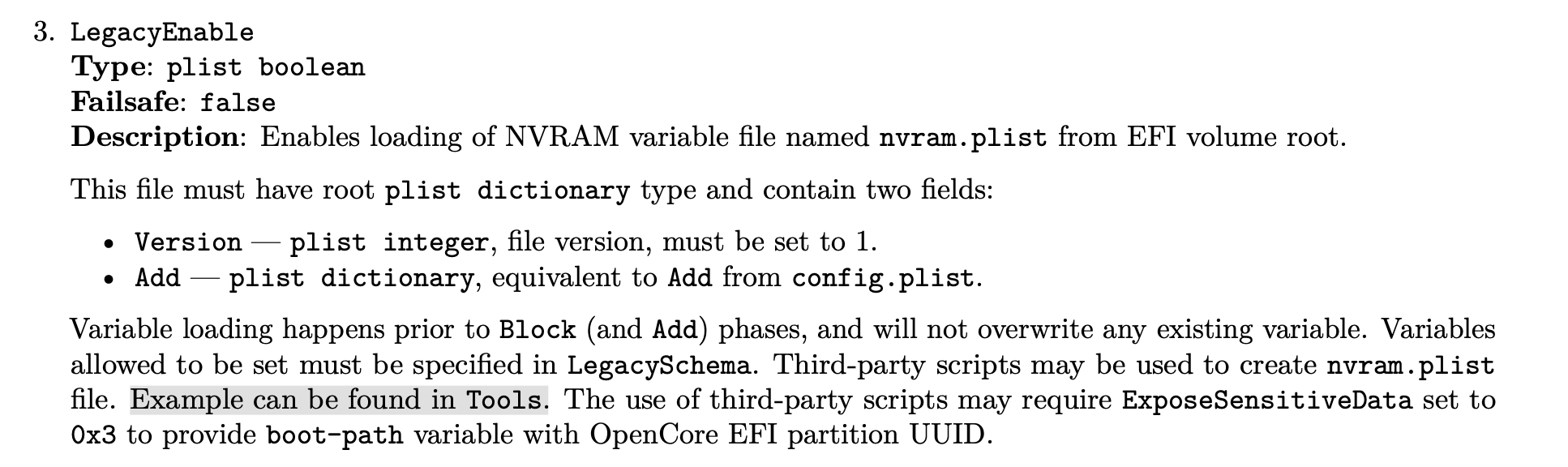

MacPato Posted July 14, 2019 Share Posted July 14, 2019 (edited) @Download-Fritz Example of NVRAM.plist is missing from the Tools Directory on build of OC, it says it's there in the manual but doesn't seem to be there. Edited July 14, 2019 by MacFriedIntel Link to comment Share on other sites More sharing options...
justin Posted July 14, 2019 Share Posted July 14, 2019 (edited) 10 minutes ago, MacFriedIntel said: Example of NVRAM.plist is missing from the Tools Directory on build of OC, it says it's there in the manual but doesn't seem to be there.   You need to compile OpenCore from latest git commit and you'll find Utilities/LogoutHook/LogoutHook.command, this tool is used to create nvram.plist.  Even without third party tools, the Documents is already very clear on the structure: Root {Version, Add} , "Add" is the same structure as config.plist/UEFI/Add/  attached is an example. nvram.plist Edited July 14, 2019 by justin Link to comment Share on other sites More sharing options...
MacPato Posted July 14, 2019 Share Posted July 14, 2019 1 hour ago, justin said:  You need to compile OpenCore from latest git commit and you'll find Utilities/LogoutHook/LogoutHook.command, this tool is used to create nvram.plist.  Even without third party tools, the Documents is already very clear on the structure: Root {Version, Add} , "Add" is the same structure as config.plist/UEFI/Add/  attached is an example. nvram.plist  Okay so might be an idea to add that to the manual. but thanks Link to comment Share on other sites More sharing options...

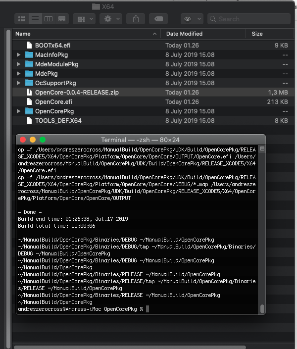

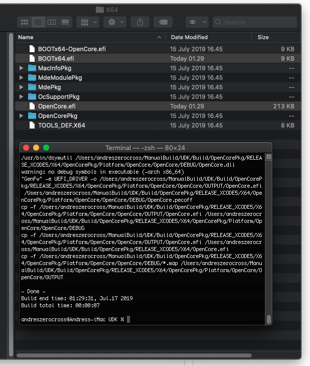

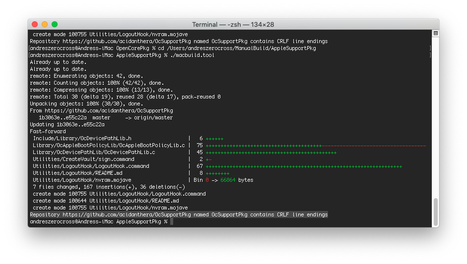

Andres ZeroCross Posted July 15, 2019 Share Posted July 15, 2019 (edited) @Download-Fritz, I can't build latest OpenCorePkg or AppleSupportpkg with macbuild.tool for each folder., there is line about "Repository https://github.com/acidanthera/OcSupportPkg named OcSupportPkg contains CRLF line endings" But build is ok if i just build with source edksetup.sh build -a X64 -b RELEASE -t XCODE5 -p OpenCorePkg/OpenCorePkg.dsc Edited July 15, 2019 by Andres ZeroCross Link to comment Share on other sites More sharing options...
mhaeuser Posted July 15, 2019 Share Posted July 15, 2019 @Andres ZeroCross One just gotta love VS... fixed 3 1 Link to comment Share on other sites More sharing options...

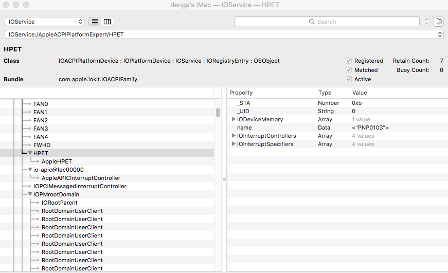

hardcorehenry Posted July 16, 2019 Share Posted July 16, 2019 Could someone help me with HPET. I don’t have DSDT in OC/ACPI on my Haswell  hackintosh, only SSDT hotpatches . No SSDT-HPET.aml hotpatch can make _STA return 0xf. My original OEM HPET looks like this:   Device (HPET)                {                    Name (_HID, EisaId ("PNP0103") /* HPET System Timer */) // _HID: Hardware ID                    Name (_UID, Zero) // _UID: Unique ID                    Name (BUF0, ResourceTemplate ()                    {                        Memory32Fixed (ReadWrite,                            0xFED00000,        // Address Base                            0x00000400,        // Address Length                            _Y0F)                    })                    Method (_STA, 0, NotSerialized) // _STA: Status                    {                        If (LGreaterEqual (OSYS, 0x07D1))                        {                            If (HPAE)                            {                                Return (0x0F)                            }                        }                        ElseIf (HPAE)                        {                            Return (0x0B)                        }                        Return (Zero)                    }                    Method (_CRS, 0, Serialized) // _CRS: Current Resource Settings                    {                        If (HPAE)                        {                            CreateDWordField (BUF0, \_SB.PCI0.LPCB.HPET._Y0F._BAS, HPT0) // _BAS: Base Address                            If (LEqual (HPAS, One))                            {                                Store (0xFED01000, HPT0) /* \_SB_.PCI0.LPCB.HPET._CRS.HPT0 */                            }                            If (LEqual (HPAS, 0x02))                            {                                Store (0xFED02000, HPT0) /* \_SB_.PCI0.LPCB.HPET._CRS.HPT0 */                            }                            If (LEqual (HPAS, 0x03))                            {                                Store (0xFED03000, HPT0) /* \_SB_.PCI0.LPCB.HPET._CRS.HPT0 */                            }                        }                        Return (BUF0) /* \_SB_.PCI0.LPCB.HPET.BUF0 */                    }                }  Link to comment Share on other sites More sharing options...
justin Posted July 16, 2019 Share Posted July 16, 2019 1 hour ago, hardcorehenry said: Could someone help me with HPET. I don’t have DSDT in OC/ACPI on my Haswell  hackintosh, only SSDT hotpatches . No SSDT-HPET.aml hotpatch can make _STA return 0xf. My original OEM HPET looks like this:   Device (HPET)                {                    Name (_HID, EisaId ("PNP0103") /* HPET System Timer */) // _HID: Hardware ID                    Name (_UID, Zero) // _UID: Unique ID                    Name (BUF0, ResourceTemplate ()                    {                        Memory32Fixed (ReadWrite,                            0xFED00000,        // Address Base                            0x00000400,        // Address Length                            _Y0F)                    })                    Method (_STA, 0, NotSerialized) // _STA: Status                    {                        If (LGreaterEqual (OSYS, 0x07D1))                        {                            If (HPAE)                            {                                Return (0x0F)                            }                        }                        ElseIf (HPAE)                        {                            Return (0x0B)                        }                        Return (Zero)                    }                    Method (_CRS, 0, Serialized) // _CRS: Current Resource Settings                    {                        If (HPAE)                        {                            CreateDWordField (BUF0, \_SB.PCI0.LPCB.HPET._Y0F._BAS, HPT0) // _BAS: Base Address                            If (LEqual (HPAS, One))                            {                                Store (0xFED01000, HPT0) /* \_SB_.PCI0.LPCB.HPET._CRS.HPT0 */                            }                            If (LEqual (HPAS, 0x02))                            {                                Store (0xFED02000, HPT0) /* \_SB_.PCI0.LPCB.HPET._CRS.HPT0 */                            }                            If (LEqual (HPAS, 0x03))                            {                                Store (0xFED03000, HPT0) /* \_SB_.PCI0.LPCB.HPET._CRS.HPT0 */                            }                        }                        Return (BUF0) /* \_SB_.PCI0.LPCB.HPET.BUF0 */                    }                }   upload your orig DSDT.aml, i can help create a find and replace patch for you to make sure the HPET always return 0xF Link to comment Share on other sites More sharing options...
HmO Posted July 16, 2019 Share Posted July 16, 2019 Device (HPET) { Name (_HID, EisaId ("PNP0103") /* HPET System Timer */) // _HID: Hardware ID Name (_UID, Zero) // _UID: Unique ID Name (BUF0, ResourceTemplate () { Memory32Fixed (ReadWrite, 0xFED00000, // Address Base 0x00000400, // Address Length _Y0F) }) Method (_STA, 0, NotSerialized) // _STA: Status { Return (0x0F) } Method (_CRS, 0, Serialized) // _CRS: Current Resource Settings { Return (BUF0) /* \_SB_.PCI0.LPCB.HPET.BUF0 */ } } Â Link to comment Share on other sites More sharing options...
hardcorehenry Posted July 16, 2019 Share Posted July 16, 2019 Sorry, wasn't precise. When I put back my patched DSDT everything works, but I have KP in other systems, so removed it. Trying with only hotpatches, my HPET looks like this:  // Fix HPET devices DefinitionBlock("", "SSDT", 2, "hack", "HPET", 0) {    External(_SB.PCI0.LPCB, DeviceObj)    Scope(_SB.PCI0.LPCB)    {        Device (HPET)        {            Name (_HID, EisaId ("PNP0103")) // _HID: Hardware ID            Name (_UID, Zero) // _UID: Unique ID            Name (BUF0, ResourceTemplate()            {                IRQNoFlags() { 0, 8, 11, 15 }                Memory32Fixed (ReadWrite,                               0xFED00000,        // Address Base                               0x00000400,        // Address Length                               _Y30)            })            Name (_STA, 0x0F)            Method (_CRS, 0, NotSerialized)            {                Return (BUF0)            }        }    } }  and it doesn't seems to load. Renaming HPET to XPET, also doesnt help. Attaching my OC.zip Link to comment Share on other sites More sharing options...
justin Posted July 16, 2019 Share Posted July 16, 2019 what do you want? if you only want to have HPET return 0xF, as i've said, upload your untouched DSDT.aml, i can help to make a find/replace patch.  36 minutes ago, hardcorehenry said: but I have KP in other systems  what is the "other systems" ?  Link to comment Share on other sites More sharing options...
