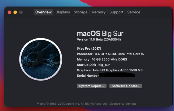

I have at last managed to install.11.0 Beta (20A5364e). but I had to make a new EFI File and change to a iMac 20,2
It runs ok but I have a small problem I would like help with.  (1) when I boot up in Mac the scrolling script is using large type
(2) I would like to add boot up icons. What settings do I need to change in my config.plist to fix the two problems I have

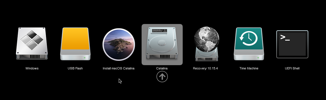

If you mean Opencanopy PickerMode=External
If you want to always show ShowPicker=yes
Remember to download fonts/icons from Acidanthera OcBinaryData repository on github and put in the Resources folder in EFI/OC/
You also need opencanopy.efi in /EFI/OC/Drivers/

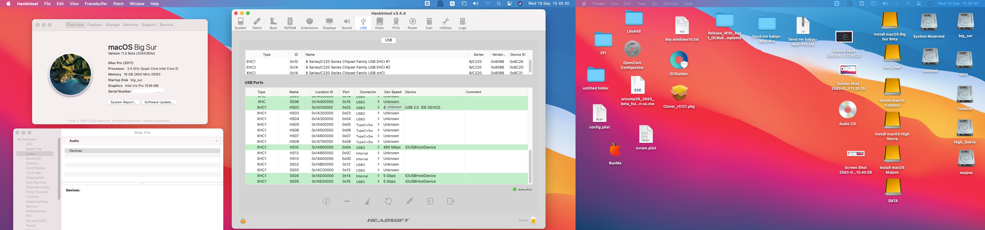

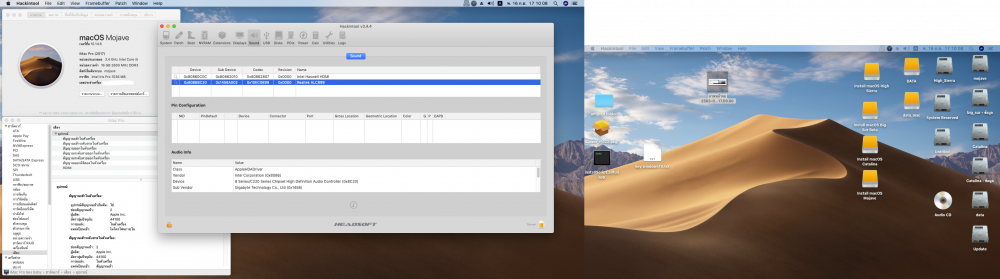

@BALDY_MAN Take everything into account as said by @ghost8282 plus have a look at the potion of the config.plist I have attached for you to follow also you can swop out your current Resources Folder the one here and you will have the result like the two examples in the pics. Good luck.

@ghost8282 &eSaF. thanks for your help. I just needed to add open canopy. now the icons work. but there big size how do I change the resolution to a smaller size

its cool noticed  in the resolution was a blank string. just changed it to Max sorted thanks again for you help

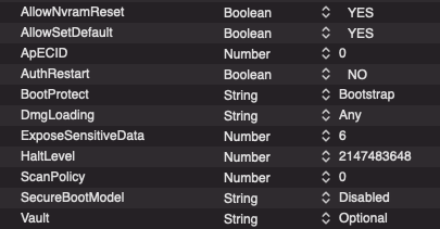

On 8/12/2020 at 3:44 PM, eSaF said:
Actually I had a thought on this as well if the OC Devs could include a way of bypassing the sealing of that volume in BS during installation. I suppose  they would have to circumvent Apple's Security method and then the difficulty to apply such method also what impact it would have on future updates/upgrades etc. I suppose with the on going work load the Devs already have, it is something not necessarily on their radar but would be interesting to hear their thoughts. To be honest I for one is not bothered by the DoNotSeal option, I install BS as is every time and has no problems with the installation every install.
I just disabled the Bootstrap feature in config.plist --> Misc --> BootProtect None.
This feature is supposed to protect your Bios from being modified by other opsyses in a multi boot environment, it works as intended however on my Haswell build it locks me out of my Bios altogether, that is not acceptable to me so I just disabled Bootstrap. On my Skylake build I left it on as it is not as invasive and still allows me to enter Bios for editing.

On 8/14/2020 at 1:49 PM, Matgen84 said:
@eSaF
I work (test) with several bootloader on my USB key: this is the reason why 'Opencore' show up in BIOS, is annoying for me  (I don't want to use multi-boot because I've got 3 separated disk)
Yes @Matgen84disabling BootProtect - Misc -->Security-->Bootprotect - just change Bootstrap to None, will solve your problem, it is an annoying feature
when one is testing other opsyses outside the control of open core.
