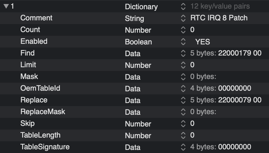

eSaF Posted May 4, 2020 Share Posted May 4, 2020 I am testing both forks of OC and this is the Patch I am using for HotPlug/Swop and on each version it works on my Z390. The same patch that worked in Mojave also works in Catalina. 1 Link to comment Share on other sites More sharing options...
Matgen84 Posted May 4, 2020 Share Posted May 4, 2020 (edited) 18 minutes ago, kiu777 said: Okay, added this patch but got boot error "No schema for MatchKernel at 8 index" And (maybe therefore) it did not work :-( The error message is clear: simply remove MatchKernel entry. Take a look in sample.plist, match kernel doesn't exist for OC (If I remember well). Put external icons to true. Edited May 4, 2020 by Matgen84 Link to comment Share on other sites More sharing options...

eSaF Posted May 4, 2020 Share Posted May 4, 2020 @ kiu777 - I've done some corrections to the Patch and removed some unnecessary entries and it is clean as possible (See Pic). This Patch allows me to hot swop disks on the fly as I have a case with an X-DOCK feature which I use to load programs from external disks and do backups also disks shows as external (Orange Icon). 1 Link to comment Share on other sites More sharing options...

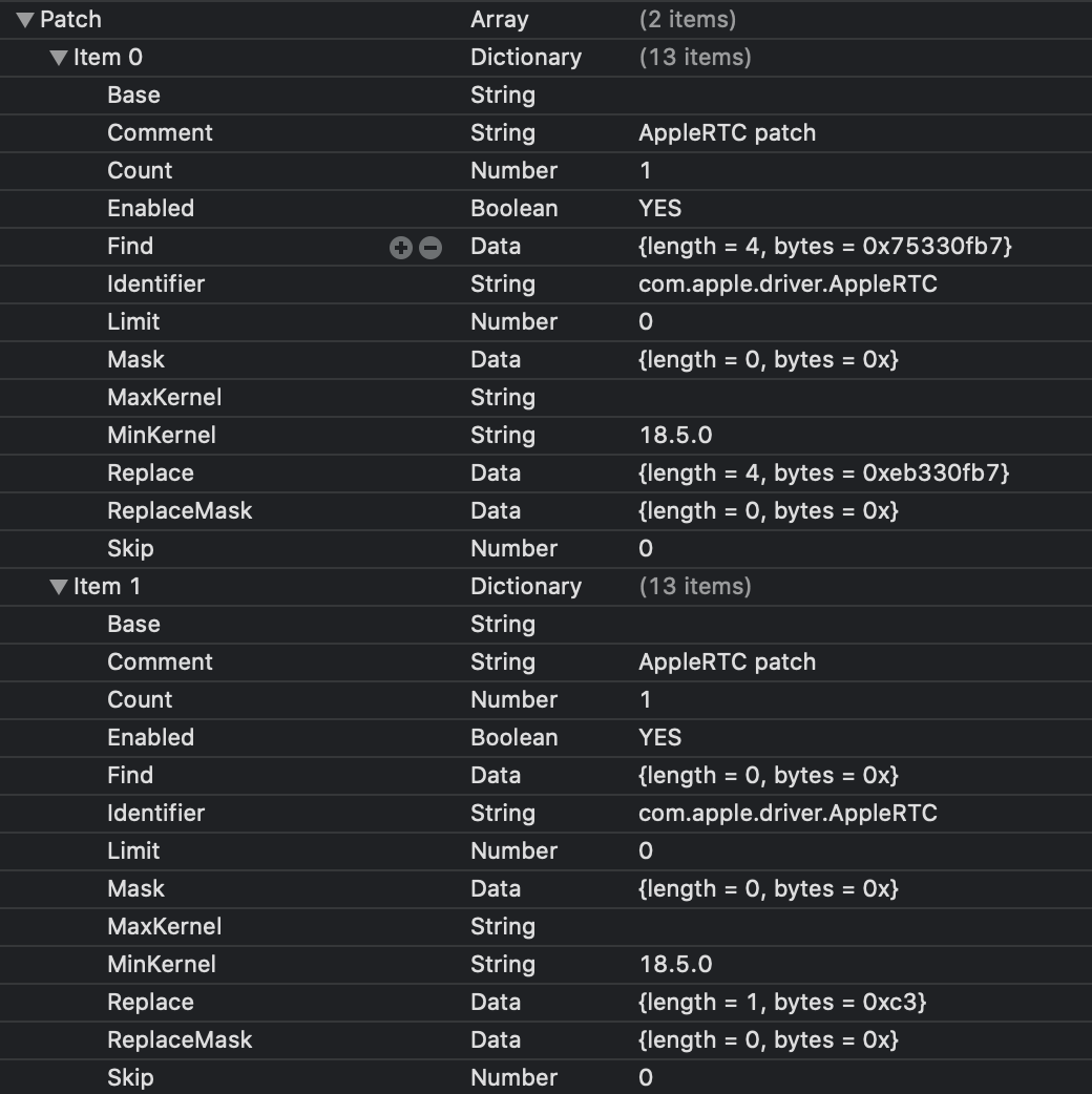

Sander Spilleman Posted May 4, 2020 Share Posted May 4, 2020 (edited) Hi, I've just upgraded to OC 0.5.8. I'm on macOS 10.15.4 on a Asus Prime Z390-A. Over time I've collected some stuff in my config related to RTC patching, which is needed as otherwise I have that F1 POST / Safe mode {censored}. I might have some stuff in my config that may not be needed anymore. I'd like to get some support to get confirmed what is still needed and want I can remove by now. My config contains the following Kernel --> Quirks --> DisableRtcChecksum set to TRUE (added in update to OC 0.5.8) UEFI --> ProtocolOverrides --> AppleRtcRam set to TRUE (added in update to OC 0.5.8) NVRAM --> Add --> 7C436110-AB2A-4BBB-A880-FE41995C9F82 --> wake-failure set to 5 bytes 0 (added after 10.15.4: https://github.com/acidanthera/bugtracker/issues/765) ACPI --> Add --> SSDT-AWAC.aml (per vanilla desktop guide) ACPI --> Patch as follows: (I believe this was generated by SSDTTime) And Kernel --> Add --> Patch the following 2: (found these in here... somewhere) Is there something I can get rid of?? Thank you so much! Sander Edited May 4, 2020 by Sander Spilleman Link to comment Share on other sites More sharing options...

kiu777 Posted May 4, 2020 Share Posted May 4, 2020 1 hour ago, eSaF said: @ kiu777 - I've done some corrections to the Patch and removed some unnecessary entries and it is clean as possible (See Pic). This Patch allows me to hot swop disks on the fly as I have a case with an X-DOCK feature which I use to load programs from external disks and do backups also disks shows as external (Orange Icon). Tried even your stripped version of the patch. And it did not work either. Not really astonishing for me because it is not so different from the version I tried before. I suspect that there must be another problem in my configuration. Nevertheless thank you for your effort! 1 Link to comment Share on other sites More sharing options...
eSaF Posted May 4, 2020 Share Posted May 4, 2020 1 hour ago, kiu777 said: Tried even your stripped version of the patch. And it did not work either. Not really astonishing for me because it is not so different from the version I tried before. I suspect that there must be another problem in my configuration. Nevertheless thank you for your effort! Here is my config.plist minus personal details if you want to make a comparison. config.plist.zip Link to comment Share on other sites More sharing options...
