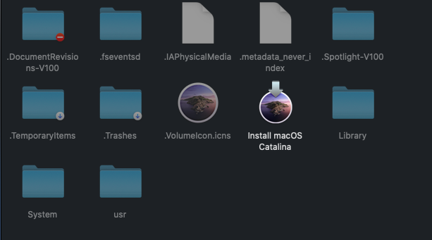

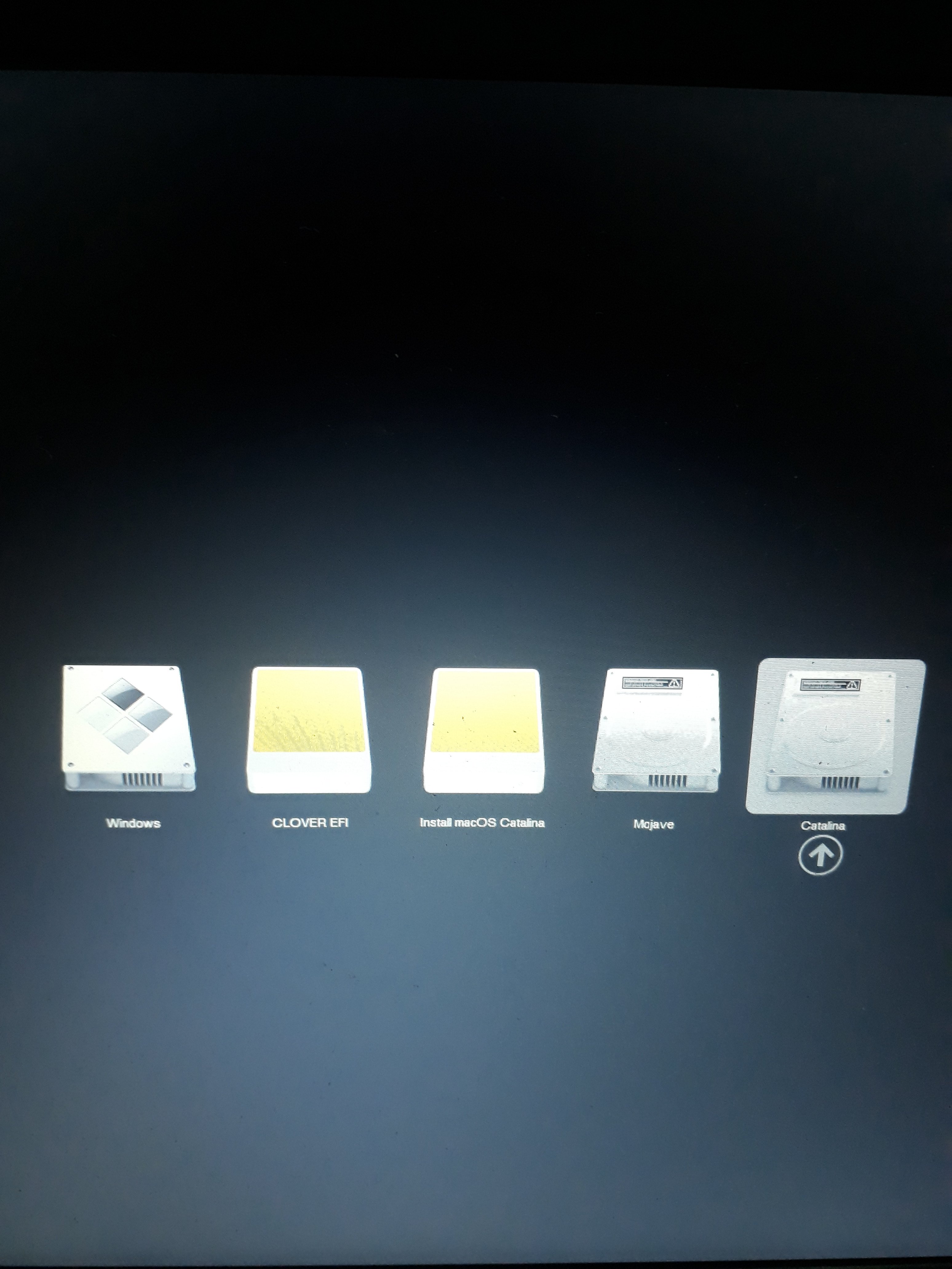

ameenjuz Posted April 23, 2020 Share Posted April 23, 2020 (edited) @Andrey1970 i put it .VolumeIcon.icns into root volume for custom macOS Installer but didn't show macOS Installer Icon in GUI such like this Edited April 23, 2020 by anmool edited Link to comment Share on other sites More sharing options...
mhaeuser Posted April 23, 2020 Share Posted April 23, 2020 @anmool Installer icons use an icns format not supported by 0.5.7, wait for 0.5.8 rolling out 1 Link to comment Share on other sites More sharing options...
ameenjuz Posted April 23, 2020 Share Posted April 23, 2020 45 minutes ago, Download-Fritz said: @anmool Installer icons use an icns format not supported by 0.5.7, wait for 0.5.8 rolling out thanks for replying i m using latest commit changes compiled 5.8 and using icns format Link to comment Share on other sites More sharing options...
pieropontra Posted April 23, 2020 Share Posted April 23, 2020 9 hours ago, pieropontra said: Hey guys! I just switched from SMBIOS/DATAHUB/etc into Platform Info in my config.plist to Automatic / General. With previous method I was able to use CPUType to correctly display 18 core Xeon W for my 9980XE, now about this Mac shows only "3 GHz" and nothing else. What am I missing? Thanks So, OpenCore isn't able to retrieve all the CPUType in automatic? When I was using SMBIOS/DataHub/PlatformNVRAM I added "3841" (0xF01 in Hex) to SMBIOS-->ProcessorType and it showed correctly "Intel Xeon W 18 core" since I got a 9980XE and MacPro7,1 SMBIOS. Now, with latest changes to config.plist sample, we're forced to use the Automatic/Generic mode which doesn't give us the ability to modify ProcessorType. Is there a way to solve this? I know in other SMBIOSes / CPUs OpenCore is able to retrieve ProcessorType automatically, will this functionality be updated for MacPro7,1 / X299 Skylake-X (and newer). Thanks. Link to comment Share on other sites More sharing options...

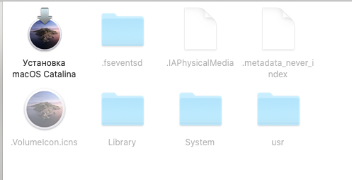

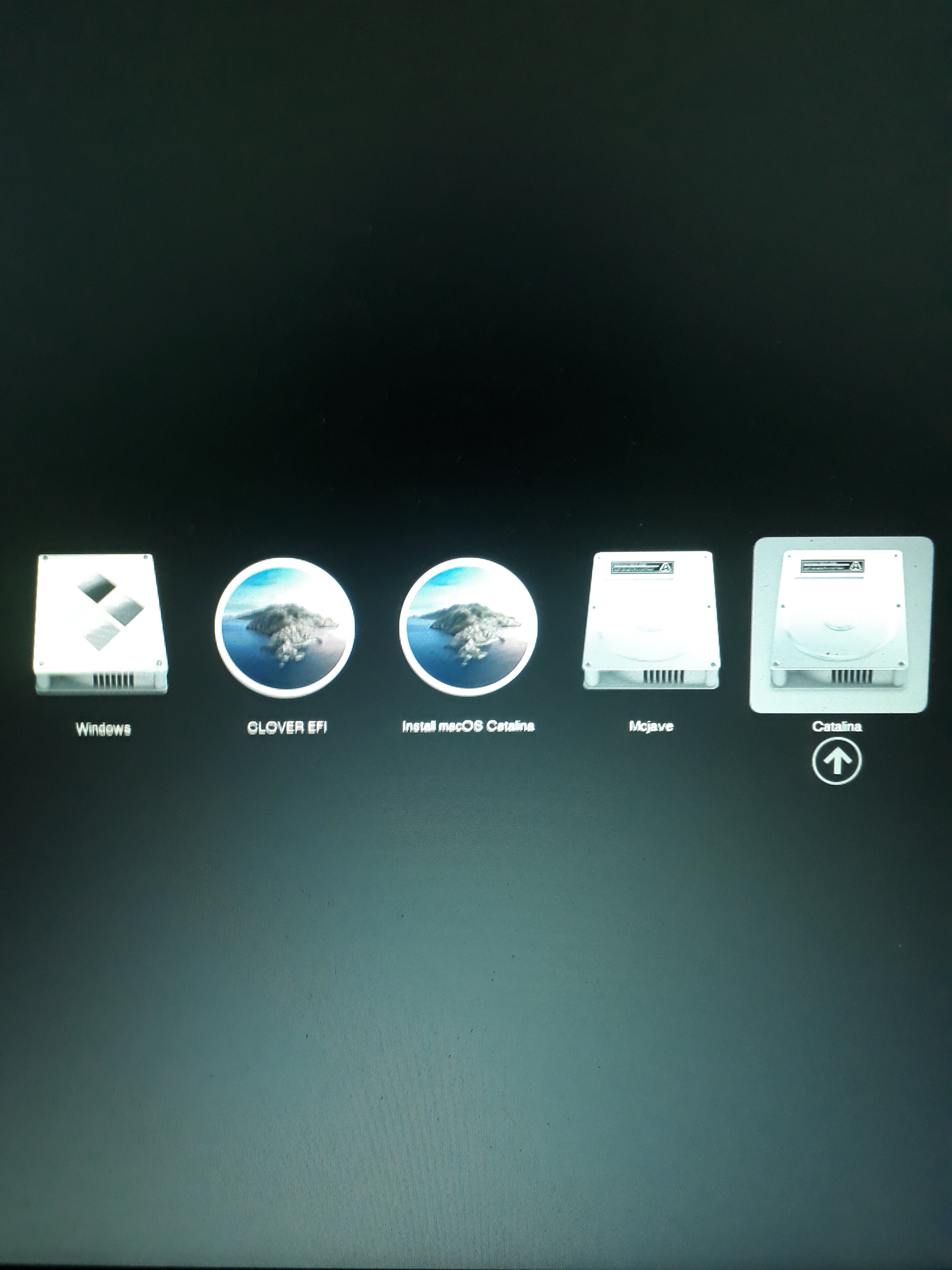

Andrey1970 Posted April 23, 2020 Share Posted April 23, 2020 (edited) 1 hour ago, anmool said: thanks for replying i m using latest commit changes compiled 5.8 and using icns format Mac USB installer already contains .VolumeIcon.icns, you don't need to add. OpenCore shows installer icons as on real Mac. Edited April 23, 2020 by Andrey1970 1 Link to comment Share on other sites More sharing options...

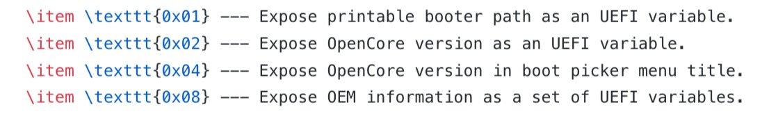

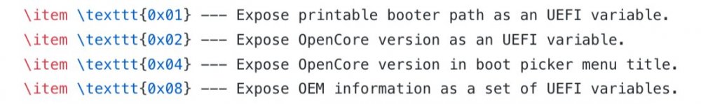

Shaneee Posted April 23, 2020 Share Posted April 23, 2020 Has the nvram for finding OC version changed? shaneee@iMac-Pro ~ % nvram 4D1FDA02-38C7-4A6A-9CC6-4BCCA8B30102:opencore-version nvram: Error getting variable - '4D1FDA02-38C7-4A6A-9CC6-4BCCA8B30102:opencore-version': (iokit/common) data was not found I can still pull other info but not OC version shaneee@iMac-Pro ~ % nvram 4D1FDA02-38C7-4A6A-9CC6-4BCCA8B30102:oem-vendor 4D1FDA02-38C7-4A6A-9CC6-4BCCA8B30102:oem-vendor Micro-Star International Co., Ltd. Link to comment Share on other sites More sharing options...
Paksman Posted April 23, 2020 Share Posted April 23, 2020 3 hours ago, Shaneee said: Has the nvram for finding OC version changed? shaneee@iMac-Pro ~ % nvram 4D1FDA02-38C7-4A6A-9CC6-4BCCA8B30102:opencore-version nvram: Error getting variable - '4D1FDA02-38C7-4A6A-9CC6-4BCCA8B30102:opencore-version': (iokit/common) data was not found I can still pull other info but not OC version shaneee@iMac-Pro ~ % nvram 4D1FDA02-38C7-4A6A-9CC6-4BCCA8B30102:oem-vendor 4D1FDA02-38C7-4A6A-9CC6-4BCCA8B30102:oem-vendor Micro-Star International Co., Ltd. Do you have ExposeSensitiveData set to 6 in config.plist ? I just tried and reading OC version from NVRAM works. Link to comment Share on other sites More sharing options...
Shaneee Posted April 23, 2020 Share Posted April 23, 2020 8 minutes ago, Paksman said: Do you have ExposeSensitiveData set to 6 in config.plist ? I just tried and reading OC version from NVRAM works. It's set to 8 to display more info. Was working on the release of 0.5.7 but I am currently booting with the latest sources I compiled. Link to comment Share on other sites More sharing options...
vit9696 Posted April 23, 2020 Share Posted April 23, 2020 6 hours ago, anmool said: thanks for replying i m using latest commit changes compiled 5.8 and using icns format Make sure that PickerAttributes have BIT0 set. If it is the case and you are on master, please upload the relevant file, OpenCore debug log, and your EFI directory. Link to comment Share on other sites More sharing options...
Paksman Posted April 23, 2020 Share Posted April 23, 2020 30 minutes ago, Shaneee said: It's set to 8 to display more info. Was working on the release of 0.5.7 but I am currently booting with the latest sources I compiled. Try setting 10 or 14 Link to comment Share on other sites More sharing options...
Shaneee Posted April 23, 2020 Share Posted April 23, 2020 32 minutes ago, Paksman said: Try setting 10 or 14 14 fixed it. Thanks 4D1FDA02-38C7-4A6A-9CC6-4BCCA8B30102:opencore-version REL-058-2020-04-22 Link to comment Share on other sites More sharing options...

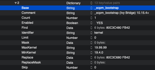

hardcorehenry Posted April 23, 2020 Share Posted April 23, 2020 (edited) 22 hours ago, MacNB said: I have and Ivy Bridge CPU and have successfully used a xcpm_bootstrap patch for 10.14 using : The same values for Find/Replace do not work with 10.15 (Catalina). Do you happen to have a patch for 10.15 for Ivy Bridge ? Thx. Base: _xcpm_bootstrap Comment: _xcpm_bootstrap (Ivy Bridge) 10.15.4+ Count: 1 Enabled: YES Find: 80C3C480FB42 Identifier: kernel Limit: 0 Mask: MinKernel: 19.04.00 MaxKernel: 19.99.99 Replace: 80C3C680FB42 ReplaceMask: Skip: 0 Edited April 23, 2020 by hardcorehenry Link to comment Share on other sites More sharing options...

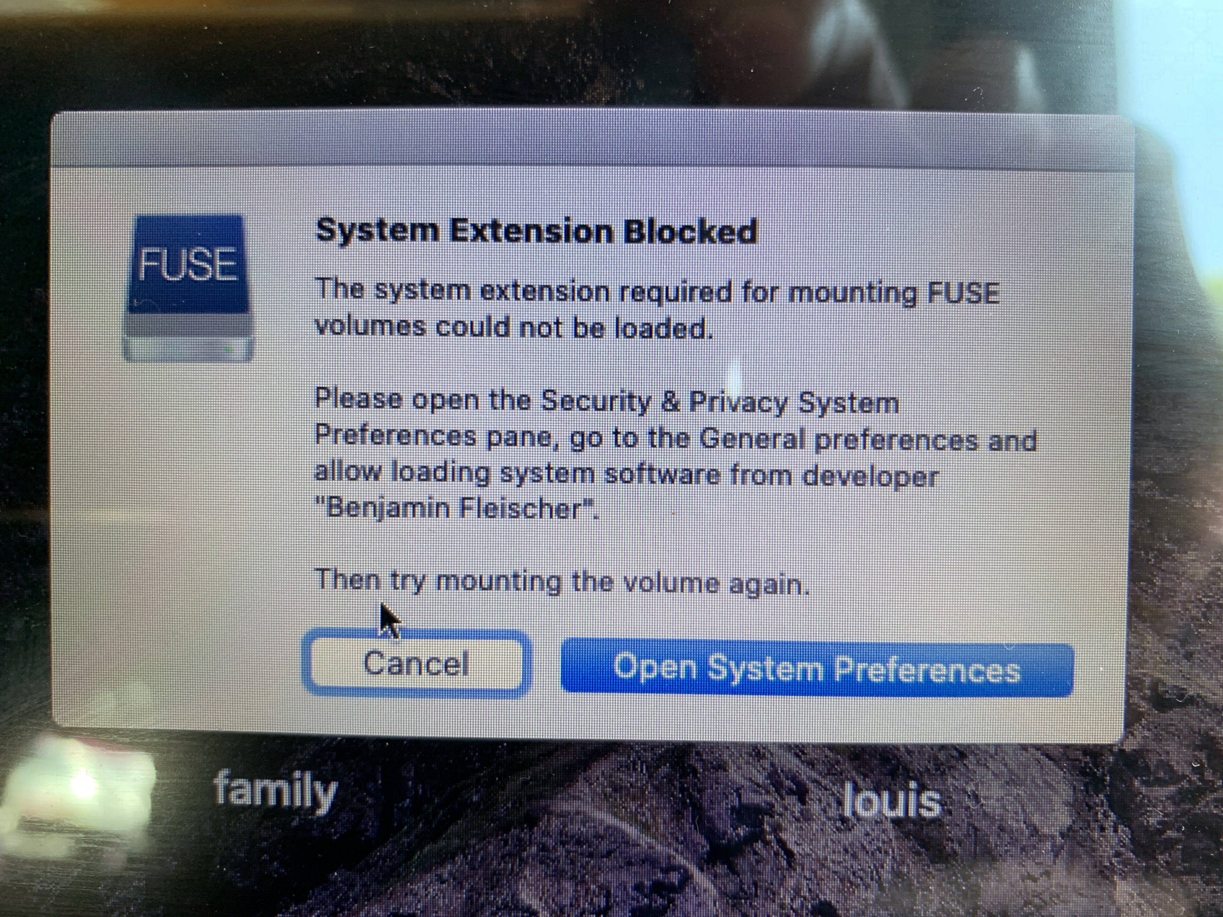

ltooz_audis Posted April 23, 2020 Share Posted April 23, 2020 Hello all, After a few days trials and errors, I got the 0.5.7 to boot to my MacBookPro11,2 Catalina 15.4, but I got this message on my OSXFUSE. What do I need to do to? Clover is fine with read/write to NTFS. Thanks, Louis Link to comment Share on other sites More sharing options...

ameenjuz Posted April 23, 2020 Share Posted April 23, 2020 10 hours ago, Andrey1970 said: Mac USB installer already contains .VolumeIcon.icns, you don't need to add. OpenCore shows installer icons as on real Mac. 5 hours ago, vit9696 said: Make sure that PickerAttributes have BIT0 set. If it is the case and you are on master, please upload the relevant file, OpenCore debug log, and your EFI directory. i followed as your instruction i don't see any realmac macOS Installer icon during boot with USB Installer only i see orange icon Install macOS Catalina on GUI i attached screenshot and EFI folder OpenCore-EFI.zip Link to comment Share on other sites More sharing options...
