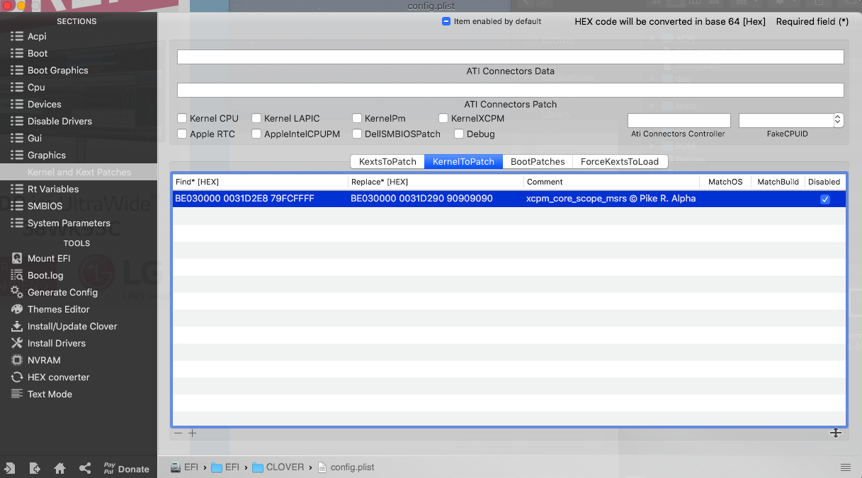

38 minutes ago, braindeadmac said:
Do you happen to know if you have native XCPM power management working with that processor choice? Trying to get xpcm working with X-299/Intel 7920x combination and it's a bit broken.
On Skylake-X/X299 Systems with unlocked mainboard BIOS MSR 0xE2 BIOS register and SMBIOS iMacPro1,1 we gain fully native HWP (IntelSpeedShift) Power Management after disabling the last remaining XCPM KernelToPatch entry "xcpm_core_scope_msrs" in the config.plist under Section "Kernel and Kext Patches" of Clover Configurator, which by default is still implemented but disabled in the config.plist of my actual respective X299 EFI-Folder distribution.
Users with locked mainboard BIOS MSR 0xE2 register, still have to use the "xcpm_core_scope_msrs" XCPM KernelToPatch entry to successfully boot their systems. Otherwise the OSX Kernel will write to that BIOS register and cause KP at boot!
HWP is a way for the processor itself to manage the power consumption, with minor input from OSX on what it thinks it needs. In contrary, XCPM is the OSX power management part. It directly controls older hardware like Broadwell-E/EP or Haswell-E/EP and enables HWP on newer hardware like Skylake-X. It also sets some HWP variables, like the desired frequency at the maximum.
XCPM is enabled by default.

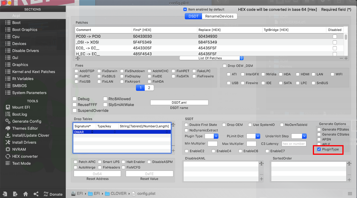

For it's complete configuration, XCPM still requires the CPU "plugin-type" injection to properly load the required XCPM frequency vectors from the iMacPro.plist, which can be directly achieved within the config.plist by checking "PluginType" in Section "ACPI" of Clover Configurator.

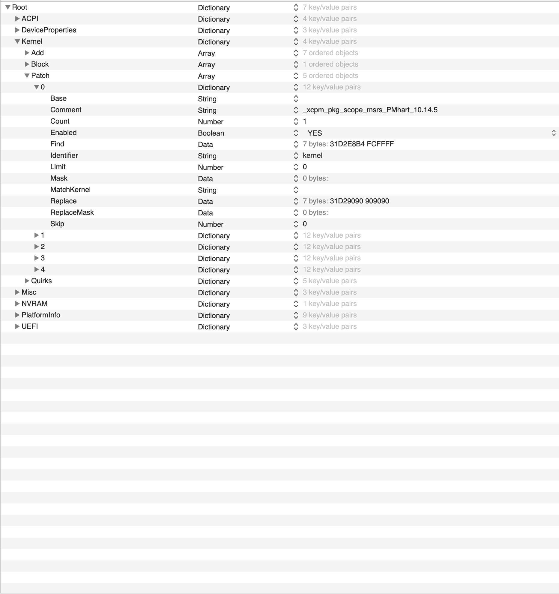

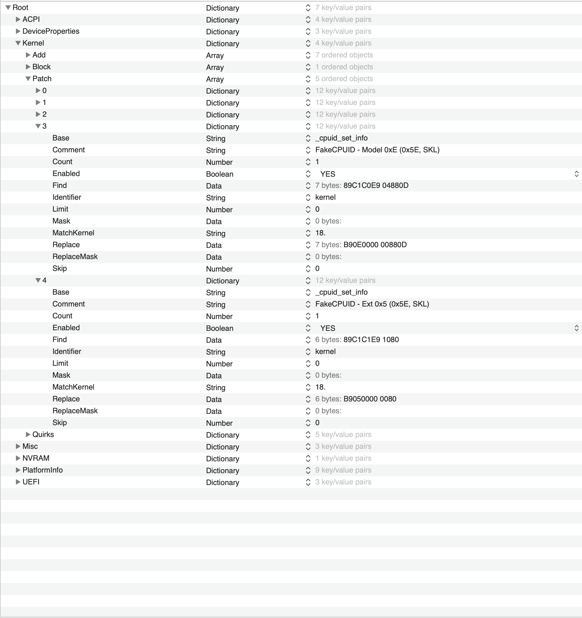

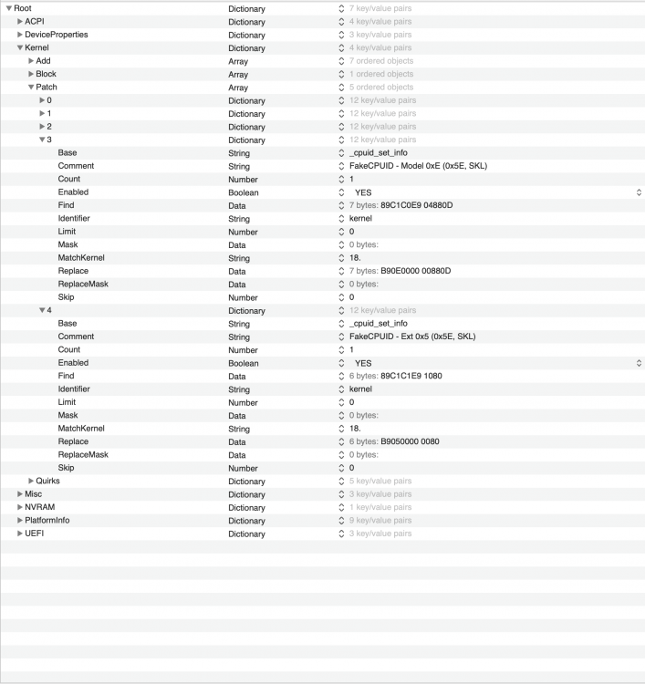

14 minutes ago, braindeadmac said:
32 minutes ago, obus said:
Thanks, @obus I'm aware of KGP's work. Under Clover I have xcpm working, and MSR 0xE2 is unlocked on my ASUS X299 Prime. However XCPM is not working correctly when I boot using the OpenCore bootloader.
Whit my processor I need FakeCPUID and  xcpm_pkg_scope_msrs_ for XCPM to work in OC.
Credit to @PMheart
Edited by obus
20 minutes ago, braindeadmac said:
HI
Maybe you have a working XCPM with clover setting plugin type set or with a SSDT for your cpu..
In OC I have a simple SSDT (thanks @gengik84) to have a working xcpm

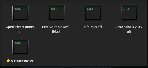

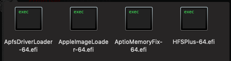

Are you in your senses? What is wrong with copying EmuVariableEfi from e.g. MdeModulePkg or Clover (if you cannot compile) and just putting it to drivers? Sure, we do not support this configuration as we want a cleaner solution, but why would not it work in the first place?
@dgsga, am I right that Clover devs modded EmuVariable in a way that it does not load unless explicitly controlled with a protocol you added?
Edited by vit9696
  • Like 3
@vit9696
I was indeed out of my senses. EmuVariableUefi.efi from Clover is a no go. EmuVariableRuntimeDxe.efi compiled from MdeModulePkg works just fine. No longer any need for the fork...
@MacFriedIntel
cd to your UDK folder. Compile EmuVariableRuntimeDxe driver from MdeModulePkg using the commands:
source edksetup.sh
build -a X64 -b RELEASE -t XCODE5 -p MdeModulePkg/MdeModulePkg.dsc -m MdeModulePkg/Universal/Variable/EmuRuntimeDxe/EmuVariableRuntimeDxe.inf
Add to the compiled driver to OpenCore and it should fix the KP issues. It did on my ASRock board...

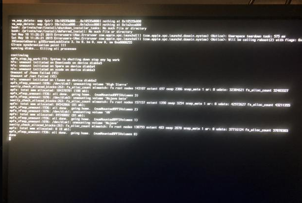

8 hours ago, dgsga said:
For those of you with z390 boards:
I have created a fork of OpenCore which solves the kernel panic on sleep/shutdown/restart
https://github.com/dgsga/OpenCorePkg
It's a quick and dirty fix, it just loads the EmuVariableUefi protocol like Clover. Use EmuVariableUefi and AptioMemoryFix drivers as per usual. Note that this panic issue is NOT related to OpenCore so can I politely request that we don’t hassle the OC developers about it...:)
It didn't work for any of our Z390 users and if anything made the shutdown process worse. but the Z390 issue does need fixing

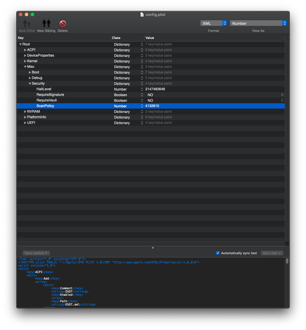

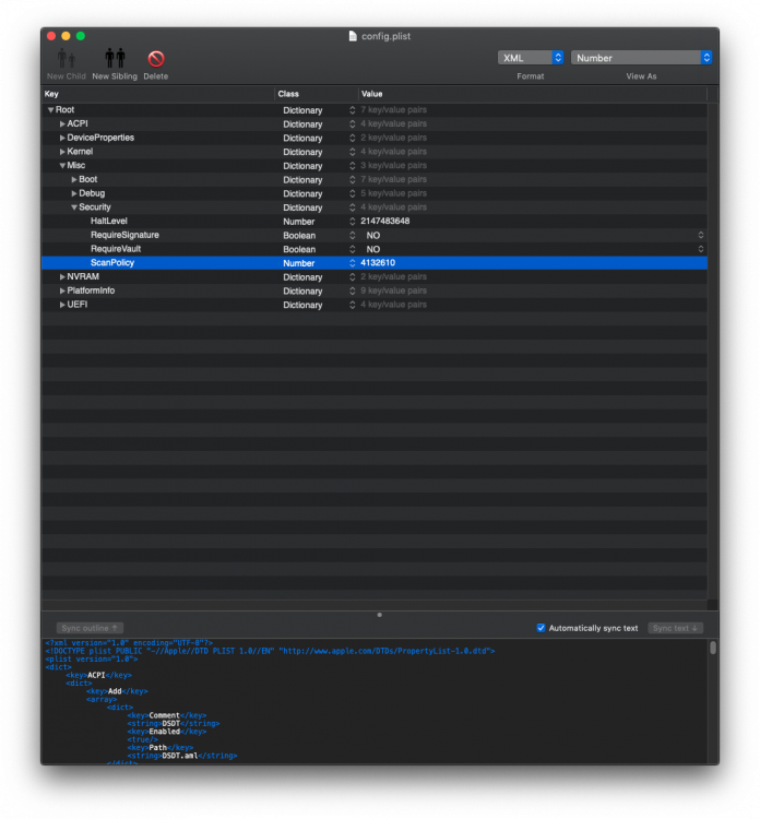

On 5/17/2019 at 11:39 PM, steve3d said:
don't work on my side, if I set this value or 0, and boot from usb flash, then oc shows my windows boot entry, but if on my nvme ssd, none of these value shows my windows boot entry. only mojave and recovery.
It work in my configuration,,, just use "4132610 (0x3F0F02)" as scan policy :)
bit0 OC_SCAN_FILE_SYSTEM_LOCK
bit1 OC_SCAN_DEVICE_LOCK
bit8 OC_SCAN_ALLOW_FS_APFS
bit16 OC_SCAN_ALLOW_DEVICE_SATA
bit17 OC_SCAN_ALLOW_DEVICE_SASEX
bit18 OC_SCAN_ALLOW_DEVICE_SCSI
bit19 OC_SCAN_ALLOW_DEVICE_NVME
bit20 OC_SCAN_ALLOW_DEVICE_ATAPI
bit21 OC_SCAN_ALLOW_DEVICE_USB
bit22 OC_SCAN_ALLOW_DEVICE_FIREWIRE
bit23 OC_SCAN_ALLOW_DEVICE_SDCARD
Use the calculator.
For example: All file systems and only sata.
