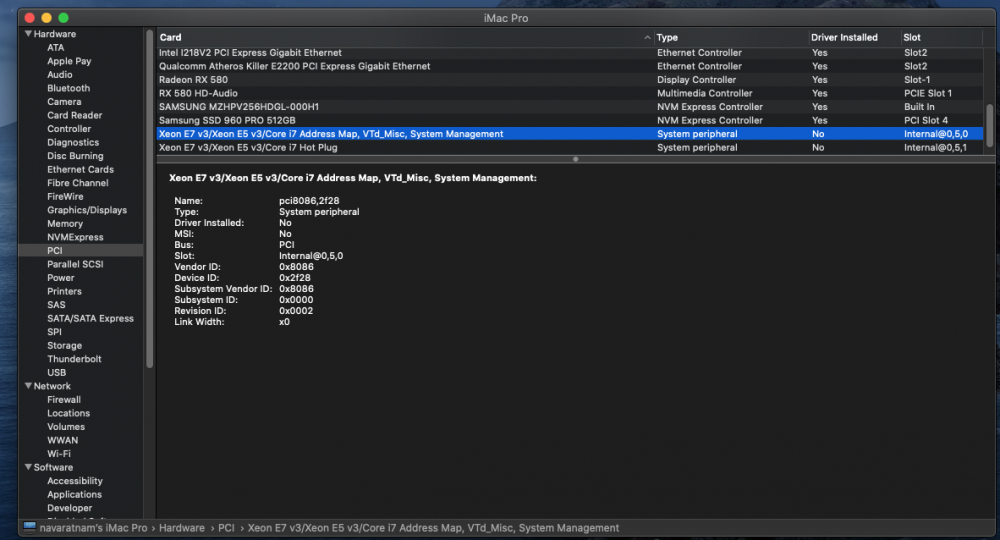

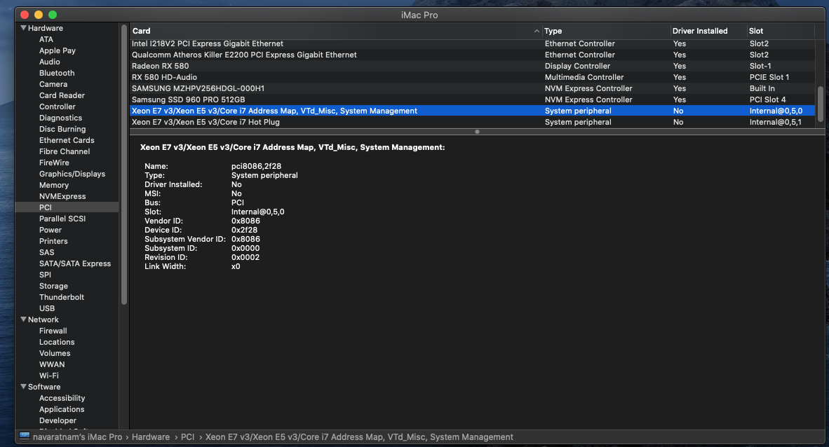

syn909 Posted January 31, 2020 Share Posted January 31, 2020 (edited) 7 hours ago, nmano said: Add System peripheral Detail for X99 and X299 System X299.zip THANK YOU @nmano! This fixed my issue, Vmware not giving me any problems after resuming from sleep! Are you able to boot from the recovery partition? I have HfsPlus.efi but I just get a black screen and it reboots back to the OC picker. Edited January 31, 2020 by syn909 1 Link to comment Share on other sites More sharing options...

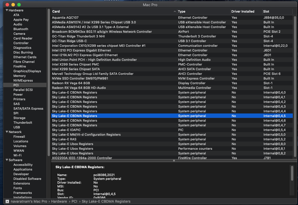

canyondust Posted February 1, 2020 Share Posted February 1, 2020 On 1/31/2020 at 5:05 AM, nmano said: Add System peripheral Detail for X99 and X299 System X99.zip X299.zip Out of curiosity, (devs) how important is this step in configuration? I assumed this was entirely cosmetic, but these posts suggest otherwise? 1 Link to comment Share on other sites More sharing options...

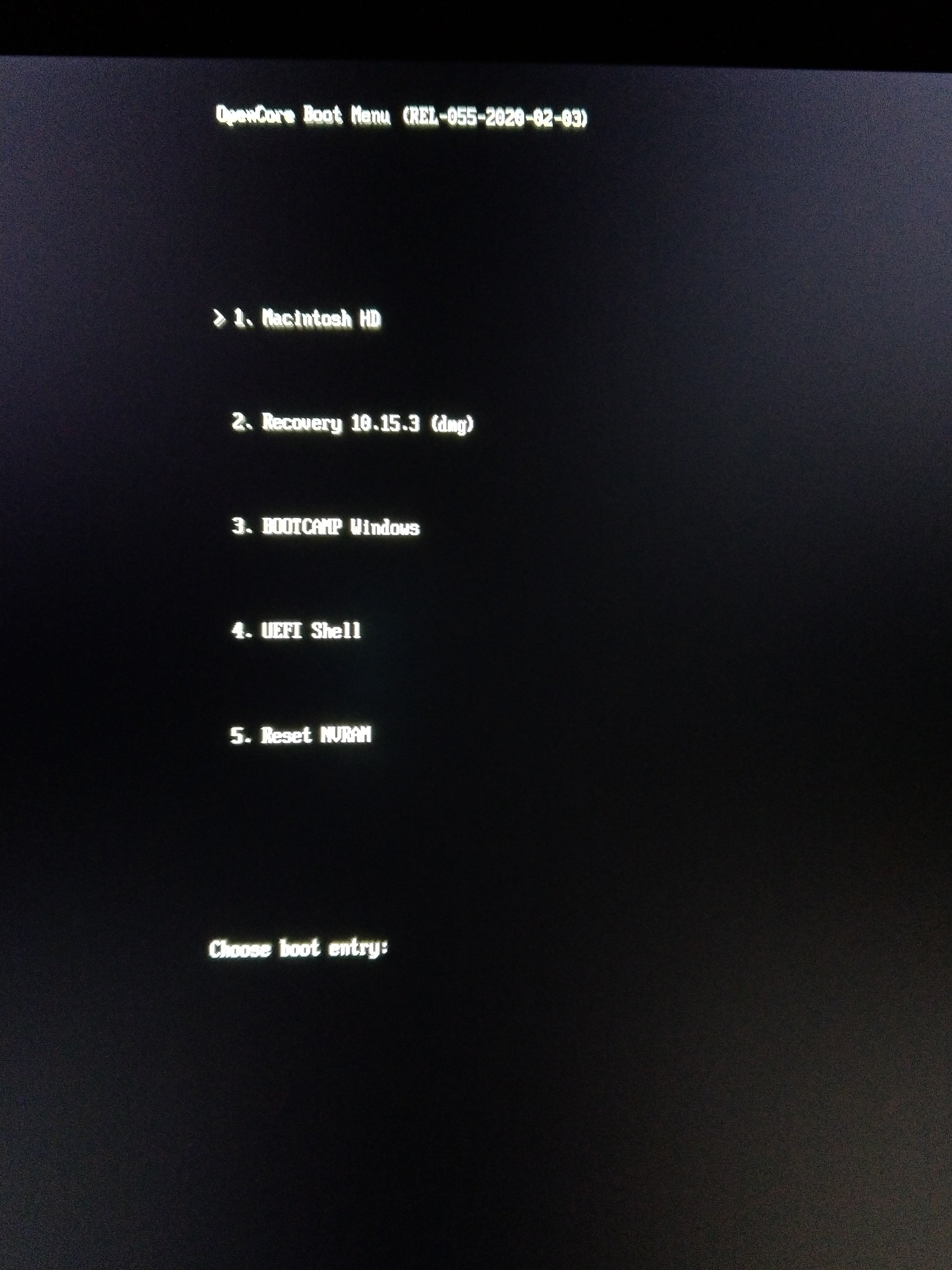

Cloverkit Posted February 3, 2020 Share Posted February 3, 2020 OC Boot menu does not display properly on Gigabyte GA-Z77P-D3 Rev1.1 It should appear in the top left corner of the screen!But now it's in the middle My Hardware: Motherboard: Giabyte GA-Z77P-D3 Rev1.1 CPU: Intel Xeon E3 1230 V2 Graphics Card: Sapphire Radeon RX560D Display: View Sonic VX2478-4K-HD (4K 23.6") DP 1.2 Z77P-D3 OC EFI.zip Config.plist Link to comment Share on other sites More sharing options...
Cloverkit Posted February 3, 2020 Share Posted February 3, 2020 6 minutes ago, Cloverkit said: OC Boot menu does not display properly on Gigabyte GA-Z77P-D3 Rev1.1 It should appear in the top left corner of the screen!But now it's in the middle My Hardware: Motherboard: Giabyte GA-Z77P-D3 Rev1.1 CPU: Intel Xeon E3 1230 V2 Graphics Card: Sapphire Radeon RX560D Display: View Sonic VX2478-4K-HD (4K 23.6") DP 1.2 Z77P-D3 OC EFI.zip Config.plist But Press F12 boot into BIOS Boot Menu and Select OC Boot Option is right Link to comment Share on other sites More sharing options...
1Ale1 Posted February 3, 2020 Share Posted February 3, 2020 Hi, today I've just updated to OpenCore 0.5.5, no issues so far. Excellent Bootloader. My hardware is down below (see signature) and while I was reading though the UEFI section of the Configuration.pdf file I found something familiar with my ASUS motherboard: As @vit9696 described here, he mentions double boot entry problems when dealing with namespaces. "However, some firmwares do their own boot option scanning upon startup by checking file presence on the available disks. Quite often this scanning includes non-standard locations, such as Windows Bootloader paths. Normally it is not an issue, but some firmwares, ASUS firmwares on APTIO V in particular, have bugs. For them scanning is implemented improperly, and firmware preferences may get accidentally corrupted due to BootOrder entry duplication (each option will be added twice) making it impossible to boot without cleaning NVRAM" Now, I would like to have some clarification on the topic, I'm currently using these Quirks under UEFI > Quirks: •RequestBootVarFallback ON I suppose that this quirk enhances security as described here: "By redirecting Boot prefixed variables to a separate GUID namespace we achieve multiple goals (goals_list_after)" I need confirmation that this happens when RequestBootVarFallback is enabled. Thanks Also, this quirks implements security fixes by doing this, is it? "redirects some Boot prefixed variables to EFI_GLOBAL_VARIABLE_GUID (and requires the other quirk down below to be enabled)" The other quirk I need to have more clarification on, is this: •RequestBootVarRouting ON "To trigger the bug one should have some valid boot options (e.g. OpenCore) and then install Windows with RequestBootVarRouting enabled." My question is: if my scope is Not to trigger the bug, I should reboot my pc at least once with both quirks disabled (RequestBootVarFallback OFF +RequestBootVarRouting OFF)? Thanks in advance. Link to comment Share on other sites More sharing options...
vit9696 Posted February 3, 2020 Share Posted February 3, 2020 Regarding picker issues, newly added BuiltinTextRenderer may improve the situation (it also supports HiDPI). @1Ale1, RequestBootVarFallback reduces the chance to run into the entry duplication bug. I.e. you may likely not face the bug when you have RequestBootVarFallback enabled if your motherboard is faulty. The bug may still happen even when RequestBootVarFallback is enabled, however. Even if you have both quirks (RequestBootVarRouting and RequestBootVarFallback) disabled you may still trigger the bug, but indeed with both of them off there is little chance it will happen. However, disabling RequestBootVarRouting will break functionality like switching between operating systems, remembering the default operating system, authenticated restart, unattended update installation, and several others. 1 Link to comment Share on other sites More sharing options...

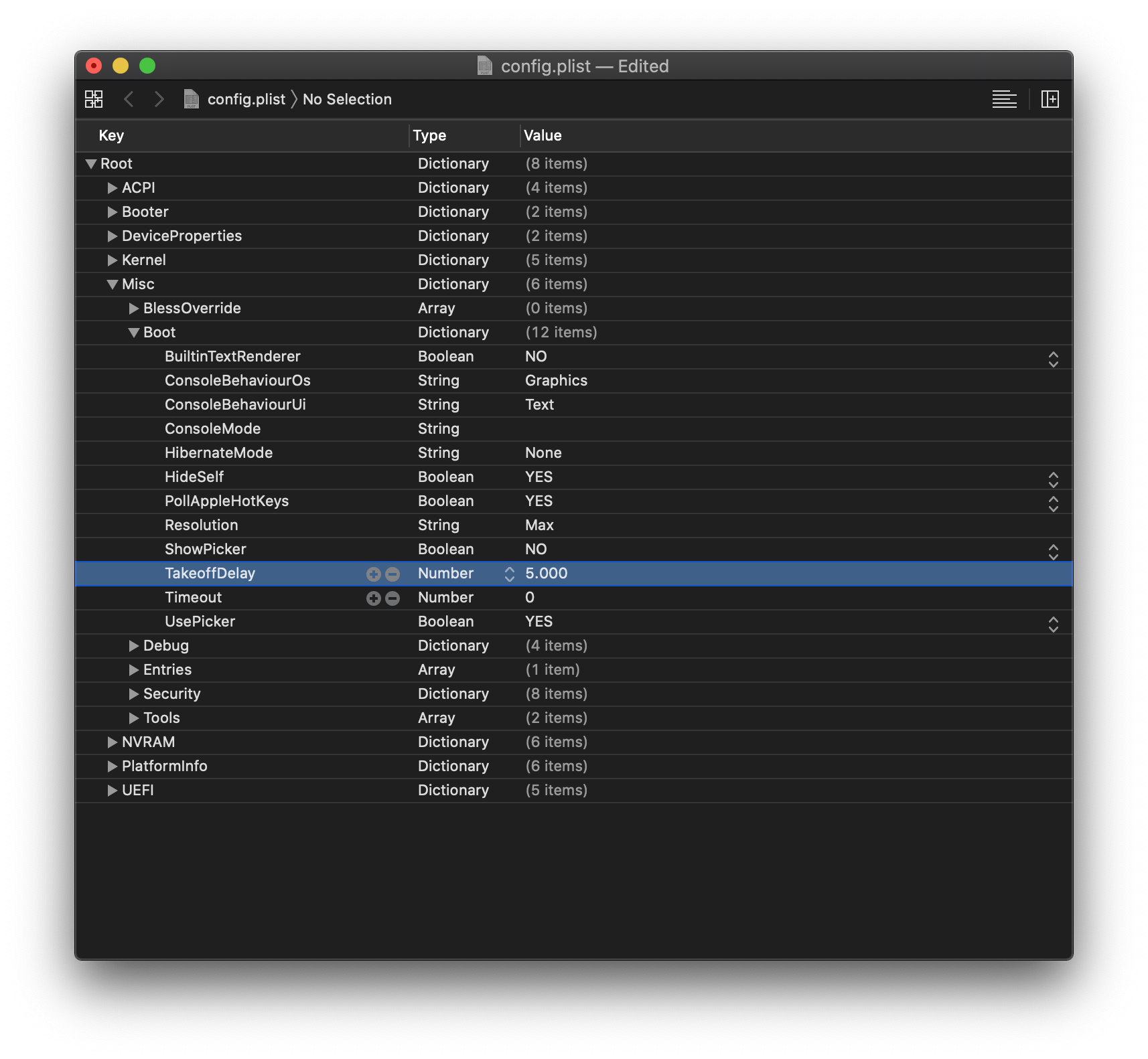

Andrey1970 Posted February 3, 2020 Share Posted February 3, 2020 (edited) 1 hour ago, telepati said: Command-R still doesn't work with TakeoffDelay. These are my settings; I also set TakeoffDelay 0 but nothing change. After Asus Logo, I am pressing Command-R but system boot directly Default boot Drive. Which part or setting I am doing wrong? On Asus Logo press and hold without releasing. To release when you will see Apple Logo. Show screenshot Input and Drivers sections in config.plist Edited February 3, 2020 by Andrey1970 1 Link to comment Share on other sites More sharing options...
