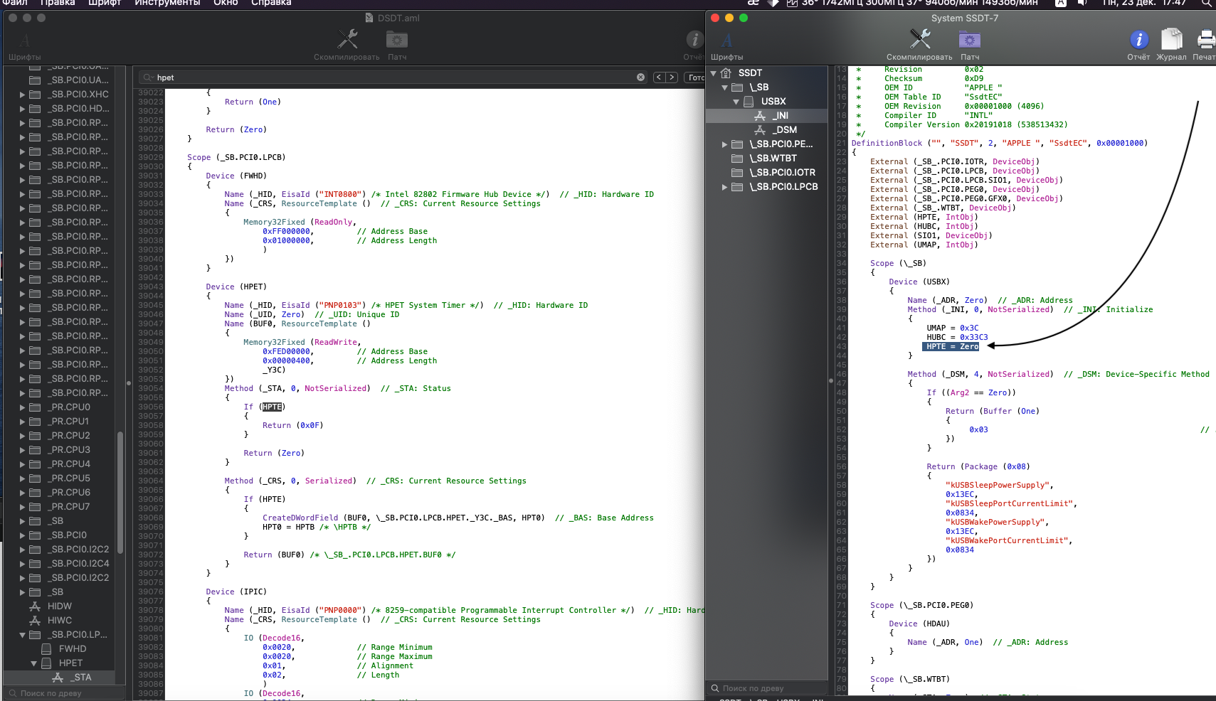

32 minutes ago, DanielMac said:
Thank you for that information, but I don't understand the implications of disabling HPET. Do I need HPET for something? Why does it take up 4 IRQs?
if the processor supports XCPM (Xnu CPU Power Management), HPET is not needed.

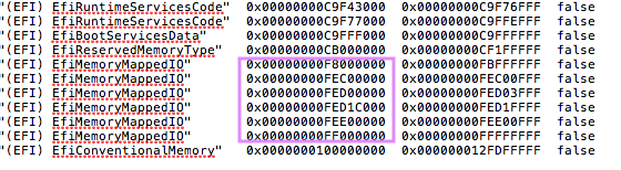

5 minutes ago, hardcorehenry said:
@fabiosun try DevirtualiseMmio+MmioWhitelist
thank you but all things found on public forums  have been tested with the same result from different users with different motherboard
could you help for a serious debugging?
What I meant, I wasn’t able to boot with DevirtualiseMmio quirk alone(KP), MmioWhitelist also had to be enabled. I don’t need that quirk, just wanted try it, out of curiosity. Addresses can be extracted from DarwinDumper(Memory), if you are able to boot with clover.  But no sadly I can’t provide help for serious debugging.
Edited by hardcorehenry
29 minutes ago, hardcorehenry said:
What I meant, I wasn’t able to boot with DevirtualiseMmio quirk alone(restart), MmioWhitelist also had to be enabled. I don’t need that quirk, just wanted try it, out of curiosity. Addresses can be extracted from DarwinDumper(Memory), if you are able to boot with clover.  But no sadly I can’t provide help for serious debugging.
Addresses undertake from OpenCore log.
1 minute ago, Andrey1970 said:
At first to add all addresses, but then to delete not necessary addresses. What addresses to leave, it is necessary to define experimentally.
