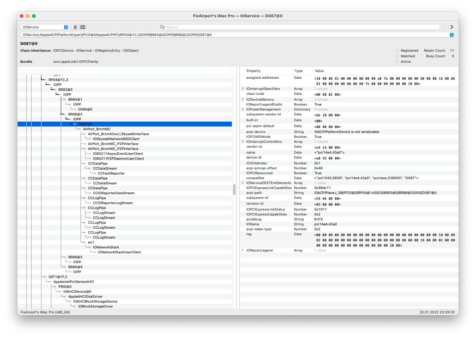

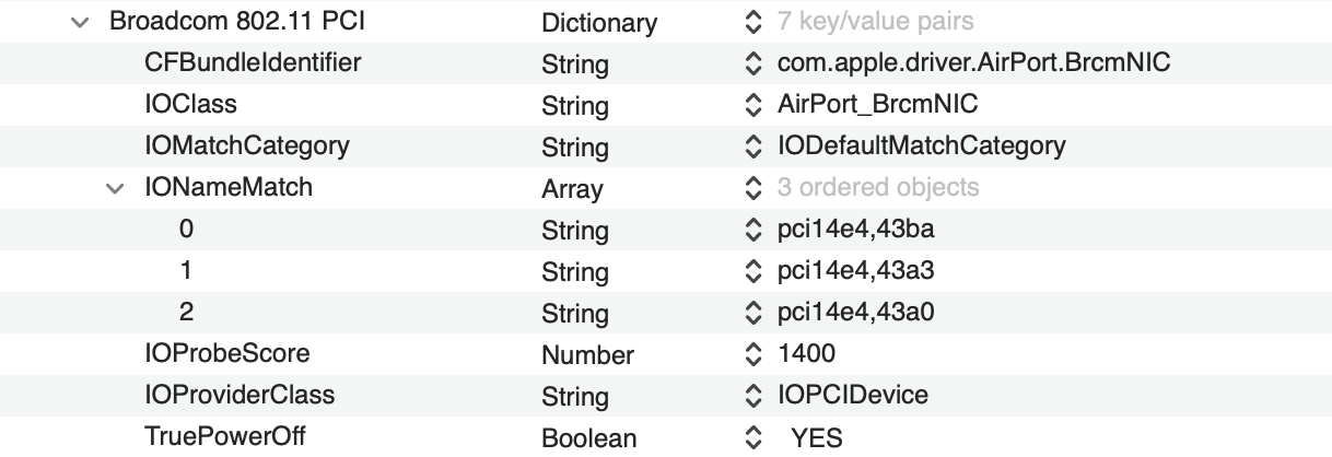

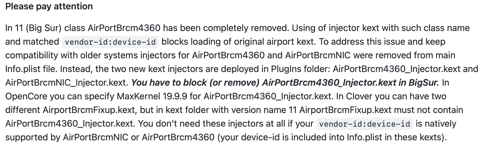

dMatik Posted January 22, 2022 Author Share Posted January 22, 2022 13 hours ago, jsl2000 said: In order to activate your WIFI 4360 you need add two kexts at Monterey I don't see the point injecting with a higher probe score same device(mine has pci14e4,43a0) and even from AirportBrcmFixup instructions you should not use the injectors. 1 Link to comment https://www.insanelymac.com/forum/topic/350364-airportbrcmfixupbcm94360hmb-maybe-broken-in-monterey-121-and-122/page/2/#findComment-2775499 Share on other sites More sharing options...
lorys89 Posted January 22, 2022 Share Posted January 22, 2022 some of you are making confusion, airportbcmfixup without plugin is used for native apple cards type BCM94360CS2, to activate all frequencies with #a, if you look at the plugin nic also contains the native ids 43a0, 43a3, 43ba to use it with non-apple cards like dw1830, dw1820a, bcm94360hmb, you understand? Link to comment https://www.insanelymac.com/forum/topic/350364-airportbrcmfixupbcm94360hmb-maybe-broken-in-monterey-121-and-122/page/2/#findComment-2775500 Share on other sites More sharing options...

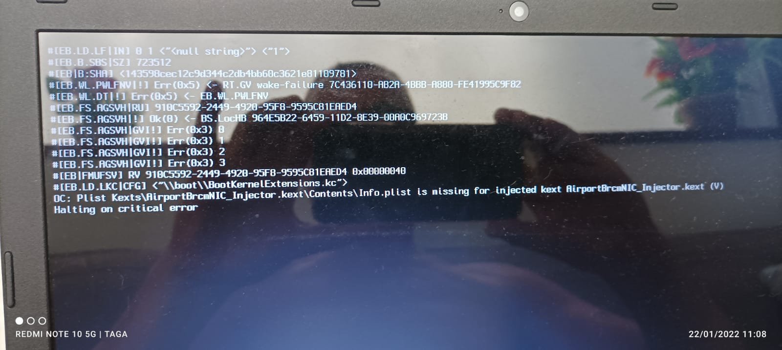

taga Posted January 22, 2022 Share Posted January 22, 2022 21 minutes ago, dMatik said: Tente este EFI (é o seu efi postado anteriormente, acabou de adicionar o aprimorador de depuração e os argumentos de inicialização), deixe-nos saber se funciona, só funciona se você tiver o 12.1 instalado, não funciona para instalar o aprimorador de depuração 12.1 bc não é suportado na recuperação. Você pode instalar o 12.1 com o wifi desativado e tente isso. EFI.zip 5,8 MB · 1 download Not 12.1. KP 12.0.1. ok Link to comment https://www.insanelymac.com/forum/topic/350364-airportbrcmfixupbcm94360hmb-maybe-broken-in-monterey-121-and-122/page/2/#findComment-2775505 Share on other sites More sharing options...
taga Posted January 22, 2022 Share Posted January 22, 2022 10 minutes ago, jsl2000 said: Please this EFI-fix EFI-fix.zip 5.85 MB · 3 downloads error config.plist Link to comment https://www.insanelymac.com/forum/topic/350364-airportbrcmfixupbcm94360hmb-maybe-broken-in-monterey-121-and-122/page/2/#findComment-2775507 Share on other sites More sharing options...
dMatik Posted January 22, 2022 Author Share Posted January 22, 2022 9 minutes ago, jsl2000 said: Please this EFI-fix EFI-fix.zip 5.85 MB · 0 downloads Check this, if your wifi card has vendor, device id matching Apple AirportBrcmNIC's info.plist, disable AirportBrcmNIC_Injector from your config.plist. Attention, mandatory -v boot arg, and 12.1,12.2 installed (does not work for installer) EFI-fix.zip Link to comment https://www.insanelymac.com/forum/topic/350364-airportbrcmfixupbcm94360hmb-maybe-broken-in-monterey-121-and-122/page/2/#findComment-2775508 Share on other sites More sharing options...

jsl2000 Posted January 22, 2022 Share Posted January 22, 2022 42 minutes ago, taga said: error config.plist Sorry, please try this new one EFI-fix. EFI-fix.zip Link to comment https://www.insanelymac.com/forum/topic/350364-airportbrcmfixupbcm94360hmb-maybe-broken-in-monterey-121-and-122/page/2/#findComment-2775512 Share on other sites More sharing options...
