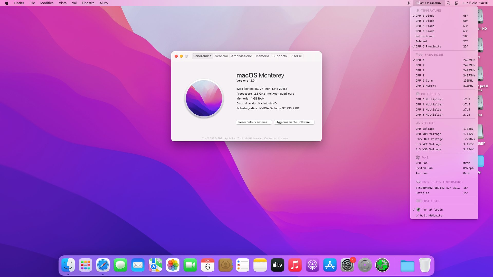

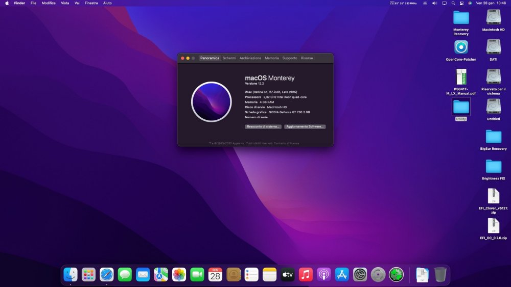

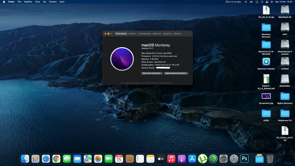

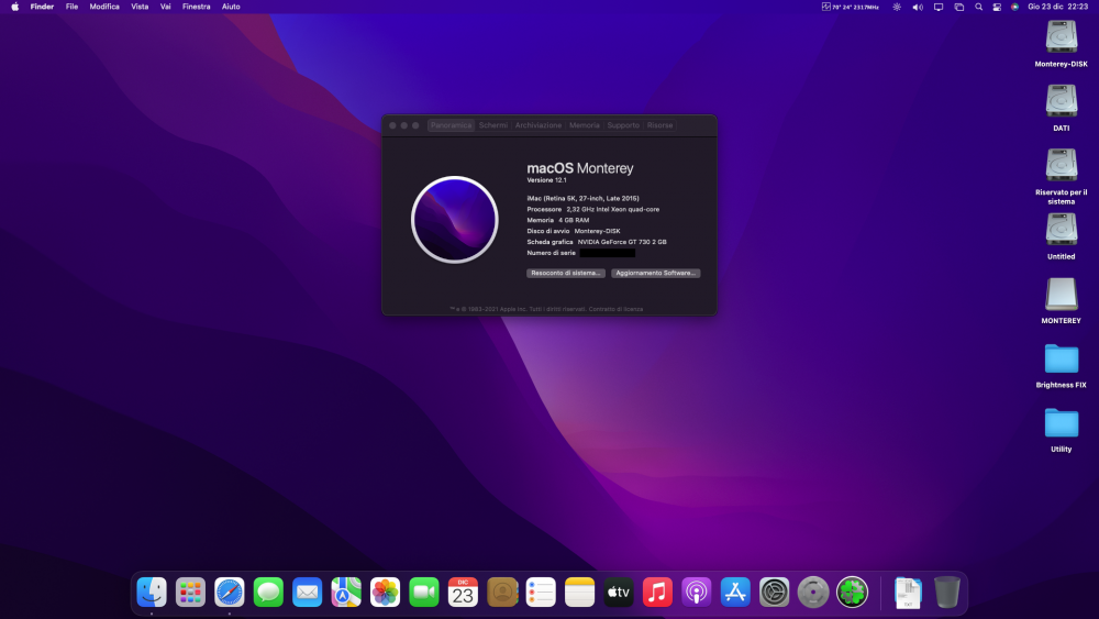

Successfully installed monterey 12.01 on old motherboard asus p5g41t-m lx v2 release 2009 lga775 without ahci with cpu xeon l5420 and gpu nvidia g730) with opencore 7.6
with OpenCore 7.6 full working: 3D acceleration with Nvidia GT730 patched, audio, all usb, cards reader, mouse and keyboard, cpu throttling, sensors temperature, brightness level with app third parts, lan network.

3 hours ago, miliuco said:
Please complete your signature (account settings >> signature).
And tell to us something more about your installation, it’s the only way to learn.
ok I have completed signature.
For installation I have used Opencore 0.7.6. I have used online installation because my motherboard is with boot legacy and my controller sata without ahci so in bios I have changed controller sata in compatible mode. For acceleration graphic I have used Nvidia Kepler Patcher of chris1111 and for audio VoodooHD 2.9.7. For brightness level I have installed app from AppleStore. For cpu throttling I have used FakeSMC3 with his plugins. For making work usb I have used patch of opencore in apci and others. For to use cpu Xeon L5420 I have bought it in net modified for socket LGA775.
