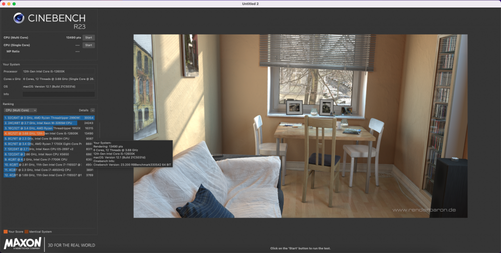

vandroiy2012 Posted November 12, 2021 Share Posted November 12, 2021 (edited) Asus Strix Z690-F Gaming WIFI + i5-12600K + 32Gb DDR5 4800MHz Works like a charm. Research in progress. Still tuning new hardware. Lilu.kext and OpenCore already have basic AlderLake support https://github.com/acidanthera/Lilu/commit/23fa49f79afe331add04c0a606f1174e74dbd93a https://github.com/acidanthera/OpenCorePkg/commit/6cef37f0bee04f2aa8dcab9aa8c390870f69f9cd and https://github.com/acidanthera/OpenCorePkg/commit/13af8ec14ad5f7dcb162a156c70f08e5bcd19462 Geekbench results (Only P-Cores active) https://browser.geekbench.com/v5/cpu/10939422 Cinebench R23 Trying to get E-Cores working in macOS... Edited November 12, 2021 by vandroiy2012 4 3 Link to comment Share on other sites More sharing options...
