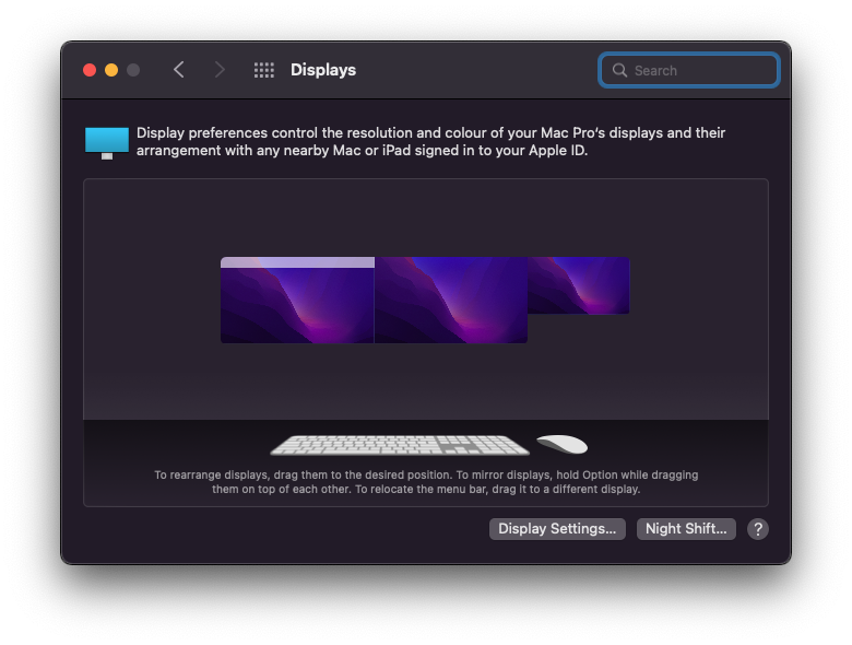

Although its working now there is a caveat......it only works on display port if i have hdmi plugged in as well which make MacOS think there are two displays connected.
I am yet to try HDMI on its own but thats the next test.
HDMI is a success.

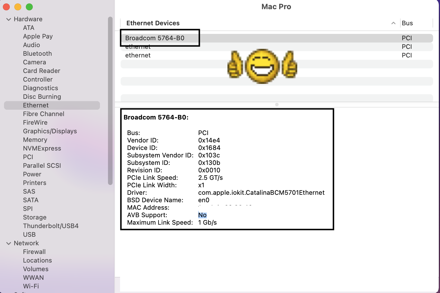

I’ve disabled my onboard Ethernet and using a hp n360t (I think) dual port.
Sent from my iPhone using Tapatalk
@SavageAUS. So have I, using a DGE-560T, just sad that it requires sacrificing a scarce PCIe slot. On the BT side I can now at least work somehow. When the GA-Z490 Vision G's wake from sleep, they wake with BT switched off, but I can at least switch BT on again, without having to reboot these machines. But that kind of working environment is just not to my liking, therefore Big Sur is where I spend most of my productive hours. Big Sur is also beta, at least the version I am running (11.6.1). Just wandering how many days, weeks, or perhaps months we will eventually be running our hacks with "released code" before the next iteration of "beta macOS" becomes available next June. 🤪

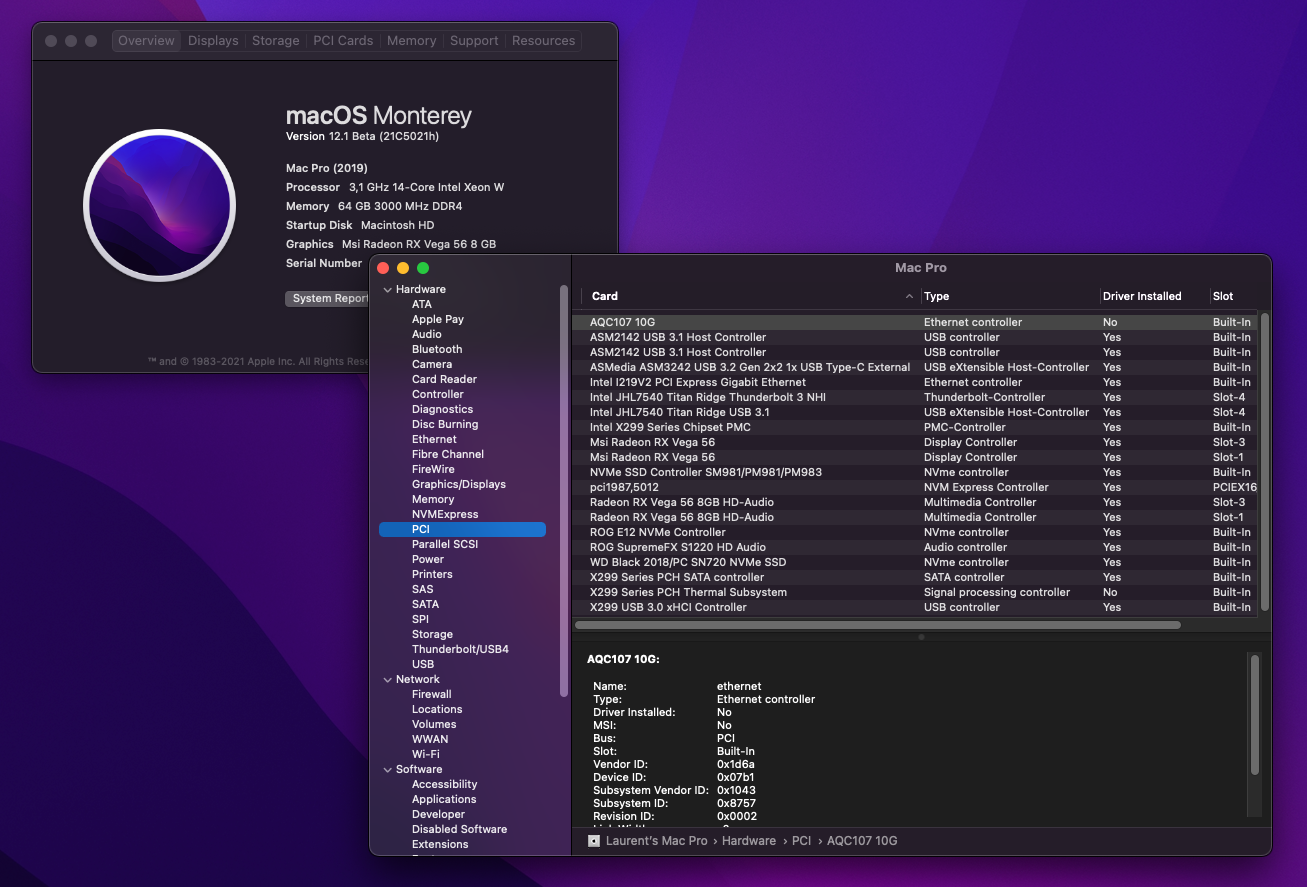

I come back after a few days of waiting for the delivery of SSDs to my mountain : install 12.1 Beta (21C5021h) - clean install - on my R6 EE went smooth , next step new beta
(AQC107 need to be patched)
