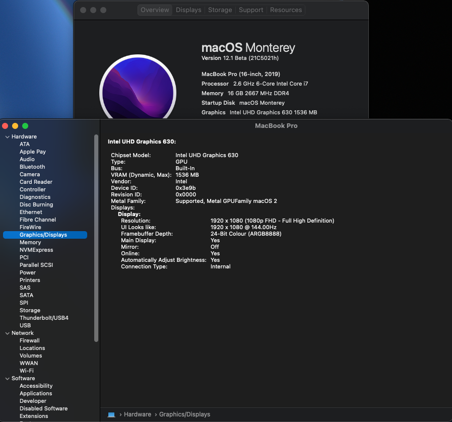

aben Posted October 29, 2021 Share Posted October 29, 2021 10 hours ago, chris1111 said: Update macOS Monterey 12.1 (21C5021h) without problem HD 4000 on probook 6570b Hello @chris1111! I see that your notebook display is showing the refresh rate along with current resolution at 60.00Hz. My Dell Skylake laptop display is outputting at 1080p(FHD) on Intel HD 520 with 64MB DVMT allocation however no refresh rate is shown on my end. It never has since Catalina. Does this mean my laptop display is actually not refreshing at 60.00Hz even though it can? I am probably missing something with my config. I was of the impression that only external monitors hooked to macOS would show the refresh rate options. Link to comment Share on other sites More sharing options...

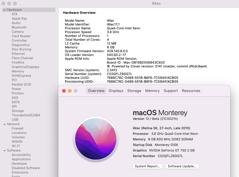

SavageAUS Posted October 29, 2021 Share Posted October 29, 2021 Updated to 12.1 beta 1 without issue with clover 5141. Only used ExtendedFirmwareFeatures and ExtendedFirmwareFeaturesMask. HWTarget was already set so unsure if it was needed to show up but i deleted it before the first reboot. This is all on my laptop using smbios MacBookPro16,4. AMD rig to be updated tomorrow. 1 Link to comment Share on other sites More sharing options...

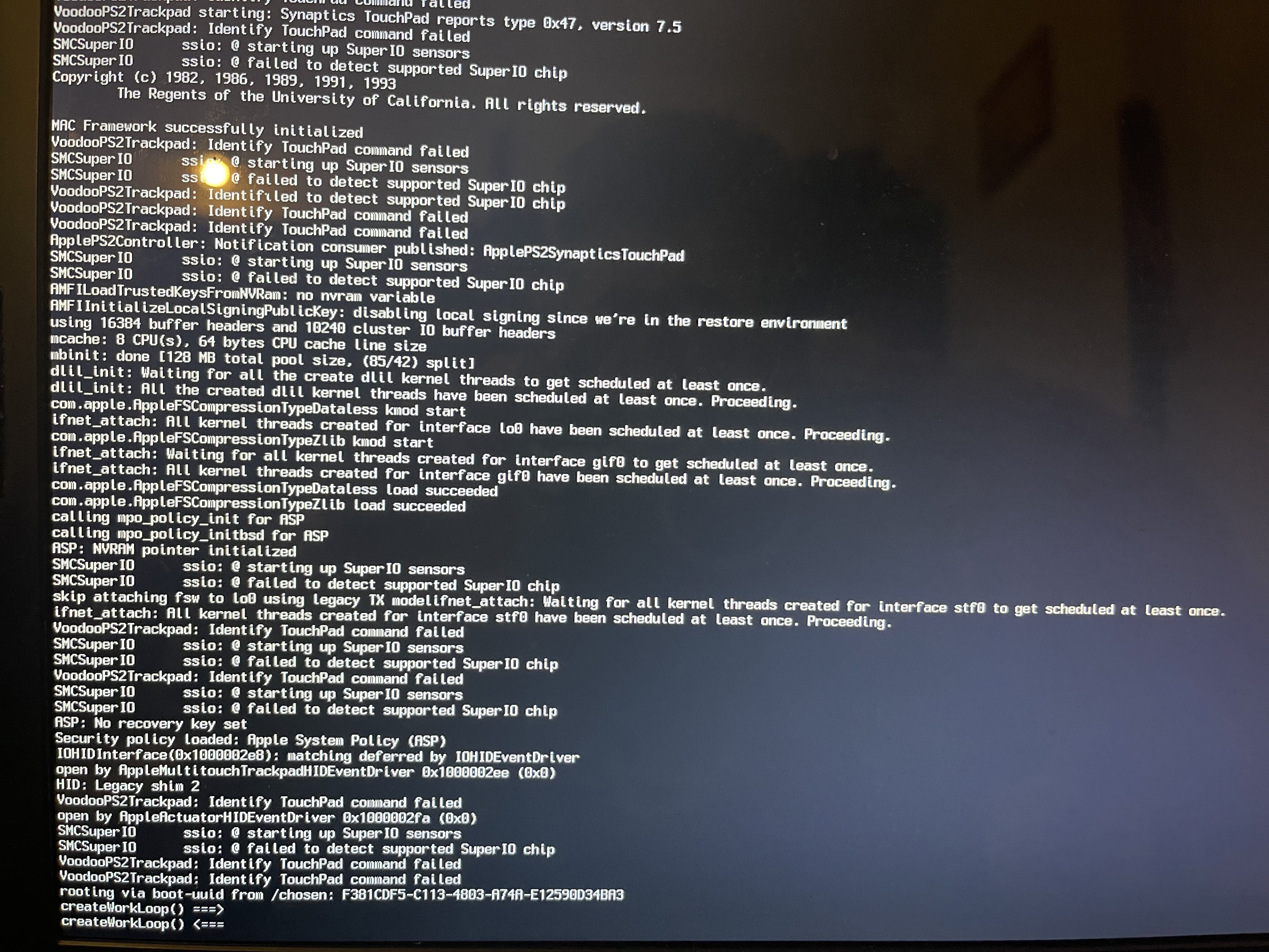

GOOGE Posted October 29, 2021 Share Posted October 29, 2021 My ASUS H97I-Plus. i5-4440, Intel HD Graphics 4600, installed and runs 12.0.1 release. Trying 12.1 beta, download from Apple installer works, then it just hangs after first reboot, trying from Macintosh HD 1 Link to comment Share on other sites More sharing options...

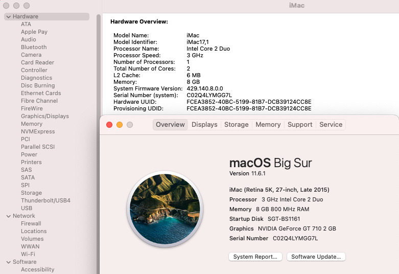

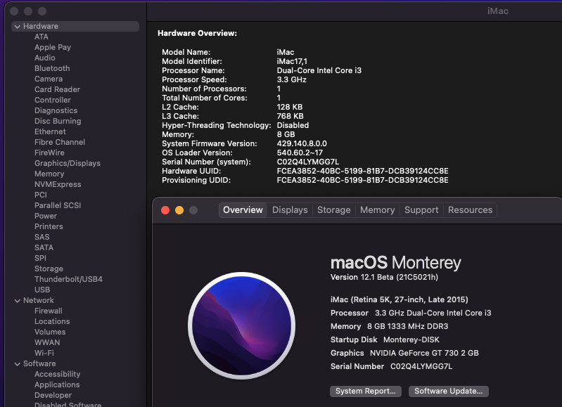

Stefanalmare Posted October 29, 2021 Share Posted October 29, 2021 9 hours ago, Shaneee said: Seems to be new patches for this on Monterey, https://forums.macrumors.com/threads/monterand-probably-the-start-of-an-ongoing-saga.2320479/ Yes, this patches work. Funny, I have core2 fully functional with Monterey 12.1 but I can't install on ivy ProBook 4540s i7 3840QQM. 1 Link to comment Share on other sites More sharing options...

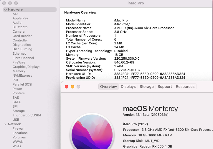

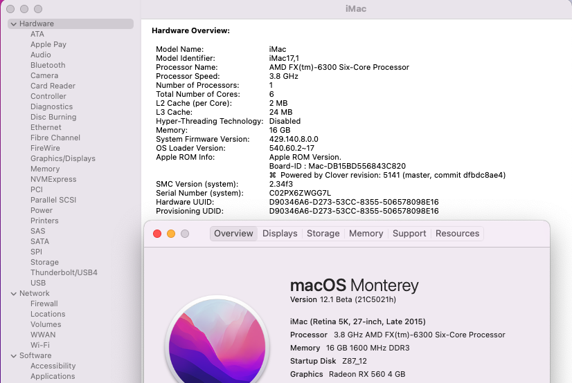

jsl2000 Posted October 30, 2021 Share Posted October 30, 2021 (edited) On 10/29/2021 at 8:54 PM, Shaneee said: Seems to be new patches for this on Monterey, https://forums.macrumors.com/threads/monterand-probably-the-start-of-an-ongoing-saga.2320479/ Thanks and these two extra kernel patches worked for my FX-6300 & Intel P6TSE as well as LGA 775 P5Q PRO & GA-965P-DS4 Hackintoshs now ! Acer Veriton M4610 need cpus=1 to boot it because no valid VoodooTscSync.kext or CpuTscSync.kext working yet ! [Edit] I can confirm that RDRAND was stripped from 12.1 Beta 2's kernel because booted by OpenCore 0.7.4 or 0.7.5 I must disable these two kernel patches in FX-6300, P6TSE & P5Q, otherwise it can not boot at all ! Edited November 15, 2021 by jsl2000 3 Link to comment Share on other sites More sharing options...
