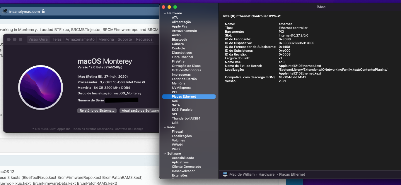

9 hours ago, MacWill said:
Using a Manual Address works in Big Sur but not in Monterey unfortunately either. If it is working for you in Monterey, can I please see your config.plist for comparison? Clean all the SMBIOS Info data.
11 hours ago, pompis12 said:

19 hours ago, MacWill said:
Thanks for sharing. I had a llok at it. And I have no idea why Ethernet is working for you at all.
You are using a setup for ethernet which was used for catalina but is no longer required.
Yoiu are also using deviceid 0x15f28086 which you then rename with the Kernel Patch to 0x15F30000 which was the intended way for Catalina. This is no longer required since on Big Sur supports this controller natively. But on top of that you are also using FakePCIID and Fake_PCIID 225.kext which does the same thing (renaming 0x15f28086 to 0x15F30000) which is no longer necessary since the kernel Patch handles that for Catalina.
IntelMausi is not even needed for this Board anyway. This is only required for the Vision D Board. This EFI  looks like it was taken from a vsion D.
What is this for: HS80211Family.kext/Contents/PlugIns/IO80211NetBooter.kext
and this: HS80211Family.kext
Wifi?
Your Fake_PCIID 225 kext is the first in the order of Kexts but Lilu, VirtualSMC should be first due to dependencies of other kext. All in all I am actually astounded that it even boots…
Edited by 5T33Z0
