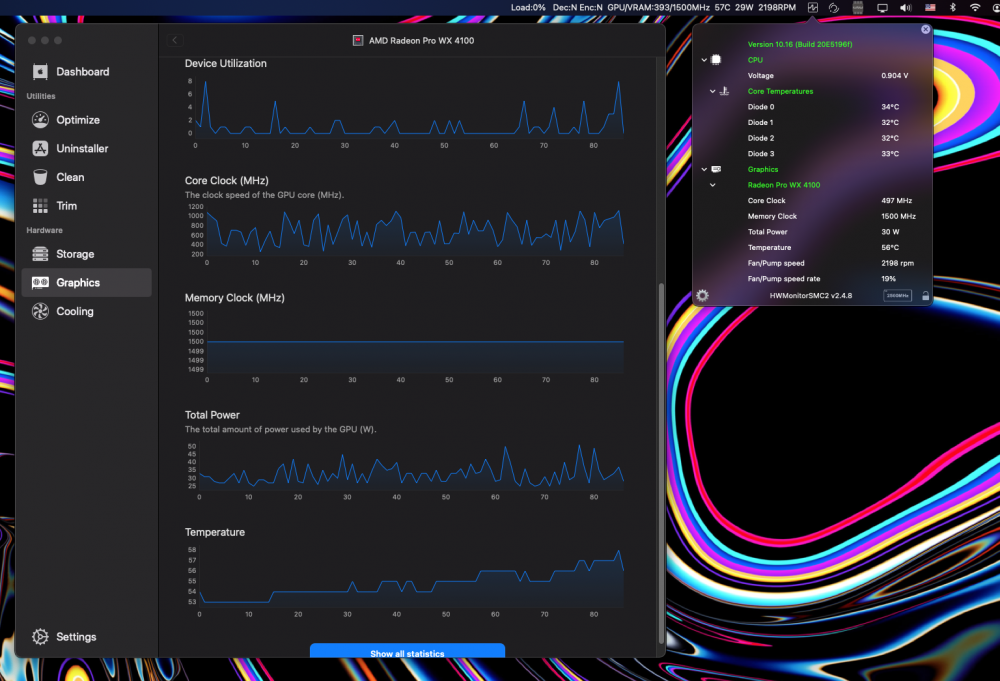

MacNB Posted March 5, 2021 Share Posted March 5, 2021 On 2/16/2021 at 7:02 PM, yapan4 said: Hello, @Hervé Thank you for your response Yes, maybe this is normal for macos. I don't have any real mac for comparison. But in comparison with Windows its look absolutely abnormal Reveal hidden contents Probably only applies to AMD graphic cards. I tried different monitoring utilities and I have no reason not to trust these values P.S. All my posts are translated by Google, so sorry if something is wrong Yes it's a common problem. Even in Windows. Seems there no solution. My observations are different. When second monitor is used, the GPU clock does go up & down based on load but the VRAM clock is fixed at 2000Mhz. @mitch_de's AMD GPU Menue App that displays the GPU performance in the Menu bar. 1 Link to comment Share on other sites More sharing options...

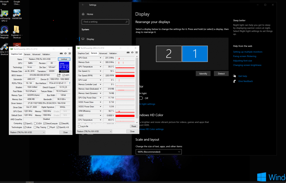

yapan4 Posted March 5, 2021 Share Posted March 5, 2021 (edited) @MacNB No, on Windows 10 I have a normal speedstep for VRAM and it confuses me. And another difference in my case - in macOS after falling asleep and waking up VRAM clock remains at maximum. Where can i find AMD GPU Menu app for download? Thank you. Edited March 5, 2021 by yapan4 Link to comment Share on other sites More sharing options...

yapan4 Posted March 5, 2021 Share Posted March 5, 2021 (edited) 3 hours ago, MacNB said: So it's probably GPU specific. I have Sapphire Nitro+ RX 580. Or driver specific. I have WX4100 and drivers for professional graphics cards. Someone else will say that it also depends on the monitors 2K, 4K, etc... But here is such a funny situation - you can connect a switched off second monitor and see the same result. Edited March 5, 2021 by yapan4 Link to comment Share on other sites More sharing options...

yapan4 Posted March 6, 2021 Share Posted March 6, 2021 (edited) Everything else remains the same but now I begin to doubt since I am the only user with a positive result on Windows 10. Need more statistics on the same, similar and other configurations, Mac and Hackintosh, Windows and macOS, etc... Spoiler Spoiler Edited March 6, 2021 by yapan4 Link to comment Share on other sites More sharing options...
