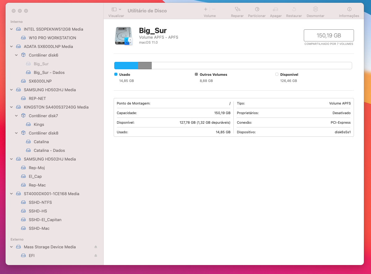

Works since im run "sudo trimforce enable" command in Catalina. Im not need re-enable again...all my machines with hack.

My bad, it seems what trimforce does is to add a NVRAM variable called EnableTRIM and I did clear my NVRAM after that so it disappeared.
Thanks for checking :)
