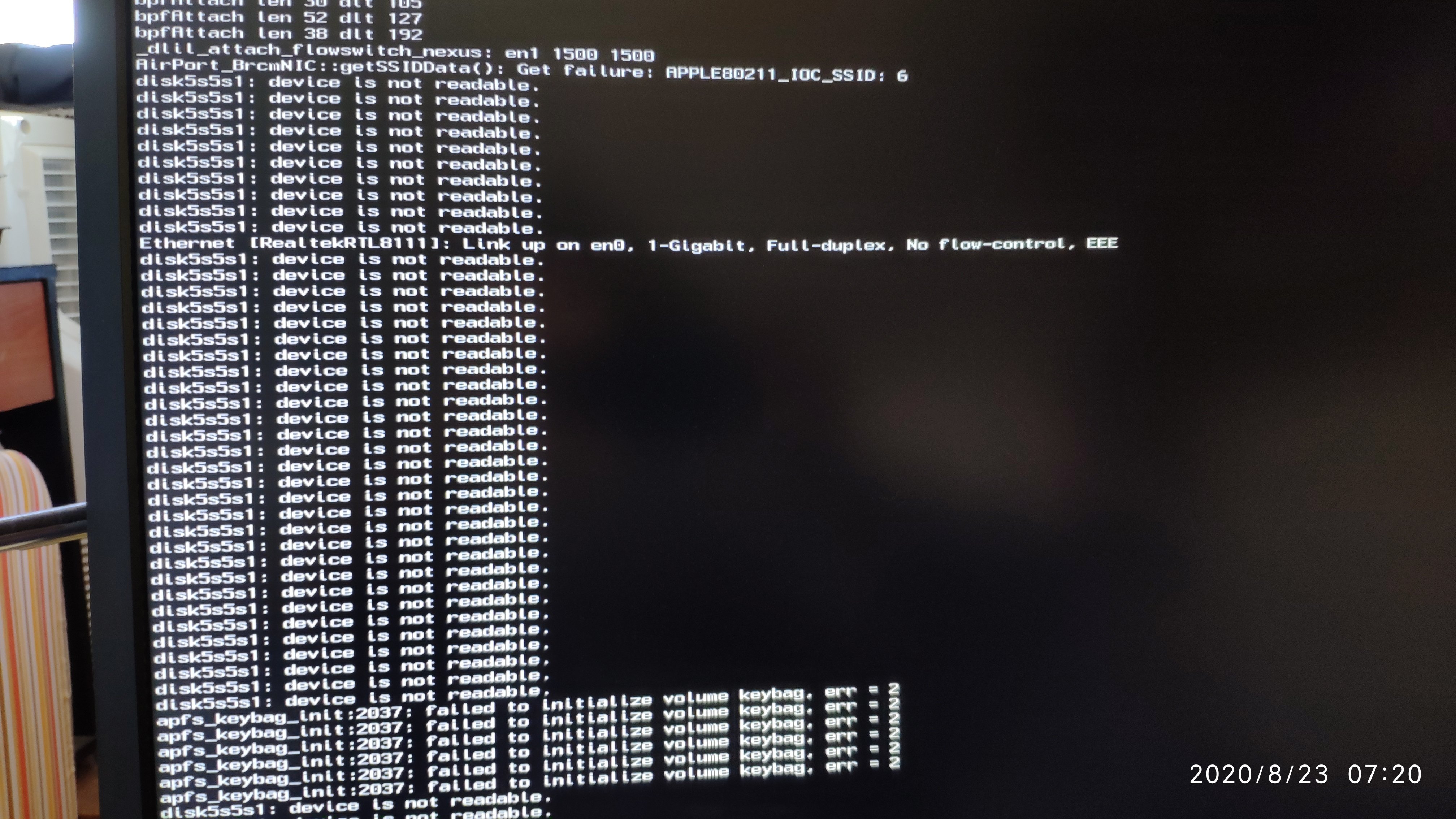

asdesoso Posted August 18, 2020 Share Posted August 18, 2020 9 hours ago, chris1111 said: This is normal you have to wait at the end and its reboot Big Sur BETA IS WAIT WAIT WAIT It has been rebooted, after waiting 10 - 15 minutes, in Forcing CS_RUNTIME, here there was SSD activity. But after that, after select Preboot volume, I stuck into the previous photo without vsmcgen=1. Furthermore, Recovery 11.0 Volume is fine, I can boot it. Cheers. Link to comment Share on other sites More sharing options...
chris1111 Posted August 18, 2020 Share Posted August 18, 2020 1 hour ago, asdesoso said: It has been rebooted, after waiting 10 - 15 minutes, in Forcing CS_RUNTIME, here there was SSD activity. But after that, after select Preboot volume, I stuck into the previous photo without vsmcgen=1. Furthermore, Recovery 11.0 Volume is fine, I can boot it. Cheers. This is strange, I never see this if passing Forcing CS_RUNTIME the rest is done quickly. Link to comment Share on other sites More sharing options...
asdesoso Posted August 18, 2020 Share Posted August 18, 2020 12 minutes ago, chris1111 said: This is strange, I never see this if passing Forcing CS_RUNTIME the rest is done quickly. Yes, is very strange, therefore, I asked you, if you can post your EFI folder from your ProBook 6570B, because I don´t know what to do more, and what´s the problem. Cheers. Link to comment Share on other sites More sharing options...
chris1111 Posted August 18, 2020 Share Posted August 18, 2020 2 minutes ago, asdesoso said: Yes, is very strange, therefore, I asked you, if you can post your EFI folder from your ProBook 6570B, because I don´t know what to do more, and what´s the problem. Cheers. I told you before my EFI is create from the program like you and its not diferant I will post my EFI without my DSDT because it doesn't work for you EFI.zip Link to comment Share on other sites More sharing options...
asdesoso Posted August 18, 2020 Share Posted August 18, 2020 (edited) 12 minutes ago, chris1111 said: I told you before my EFI is create from the program like you and its not diferant I will post my EFI without my DSDT because it doesn't work for you EFI.zip Thank you, I will try it. Cheers Edit : I have the same problem with your EFI, as I imagine. So the problem could be by the BIOS version? In my 2570P I have F.73 version. Edited August 18, 2020 by asdesoso Same problem Link to comment Share on other sites More sharing options...
chris1111 Posted August 18, 2020 Share Posted August 18, 2020 17 minutes ago, asdesoso said: Thank you, I will try it. Cheers Edit : I have the same problem with your EFI, as I imagine. So the problem could be by the BIOS version? In my 2570P I have F.73 version. probably yes? Link to comment Share on other sites More sharing options...
asdesoso Posted August 18, 2020 Share Posted August 18, 2020 4 minutes ago, chris1111 said: probably yes? I found the problem, it was FastBoot, because two weeks ago, I did a BIOS reset, and I forget to disable this feature. After disabling this, my laptop boots in 1 minute, very quickly. Thank you. Cheers. 2 Link to comment Share on other sites More sharing options...

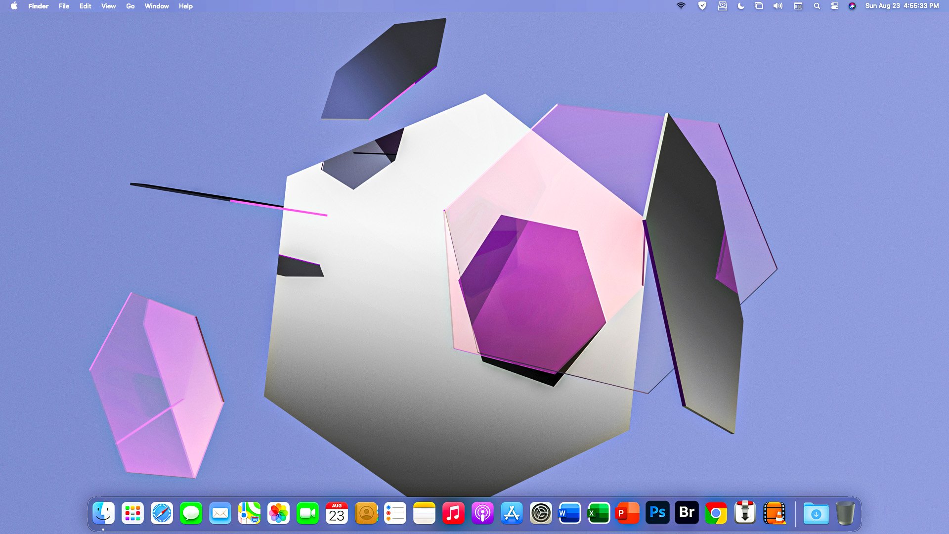

asdesoso Posted August 18, 2020 Share Posted August 18, 2020 (edited) 1 hour ago, chris1111 said: Post a Picture of BigSur desktop please Whats not work ? I read very carefully your guide in GitHub again, and I saw that FastBoot must be disabled, and I remembered that 2 weeks ago I did a BIOS reset, and I supposed that FastBoot comes enabled by default, so I disabled it, and voila. Here is my 2570P´s Desktop. Cheers. ACPI, IGPU, Audio, Ethernet, Sleep are working. WiFi not because I have an Atheros AR9280, I don´t know if it´s supported on Big Sur, but there is no problem, because my 2570P is connected through Ethernet. Bluetooth and SD Card Reader I didn´t tested it, because I didn´t need it. Cheers. Edited August 18, 2020 by asdesoso 1 Link to comment Share on other sites More sharing options...

chris1111 Posted August 18, 2020 Share Posted August 18, 2020 14 minutes ago, asdesoso said: I read very carefully your guide in GitHub again, and I saw that FastBoot must be disabled, and I remembered that 2 weeks ago I did a BIOS reset, and I supposed that FastBoot comes enabled by default, so I disabled it, and voila. Here is my 2570P´s Desktop. Cheers. ACPI, IGPU, Audio, Ethernet, Sleep are working. WiFi not because I have an Atheros AR9280, I don´t know if it´s supported on Big Sur, but there is no problem, because my 2570P is connected through Ethernet. Bluetooth and SD Card Reader I didn´t tested it, because I didn´t need it. Cheers. Efectively the Fast boot activate its not working You can see here some people enable Atheros wifi but for me I use a BCM compatible 1 Link to comment Share on other sites More sharing options...

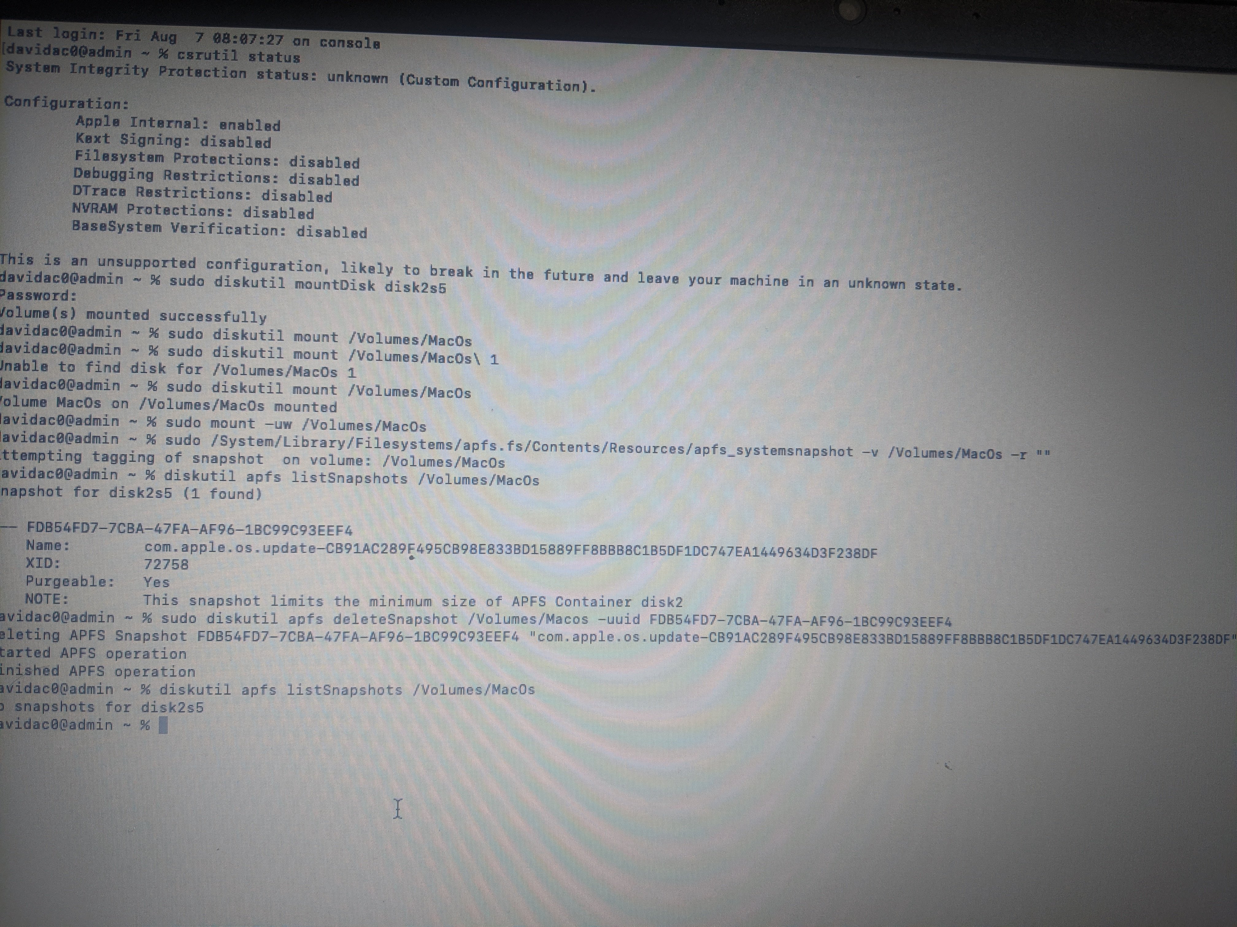

fuzzylogic Posted August 18, 2020 Share Posted August 18, 2020 Sealed volumes (snapshots) failing to get a result the difficulty is the mount -uw /Volumes/Macintosh\ HD/ how do i do this with the settings below my disk label is BigSur or do i use the disk id? Link to comment Share on other sites More sharing options...

DarkNeptune0 Posted August 18, 2020 Share Posted August 18, 2020 3 hours ago, fuzzylogic said: Sealed volumes (snapshots) failing to get a result the difficulty is the mount -uw /Volumes/Macintosh\ HD/ how do i do this with the settings below my disk label is BigSur or do i use the disk id? To remove the snapshot i used the following procedure, the system volume un my case is MacOs Spoiler Link to comment Share on other sites More sharing options...
