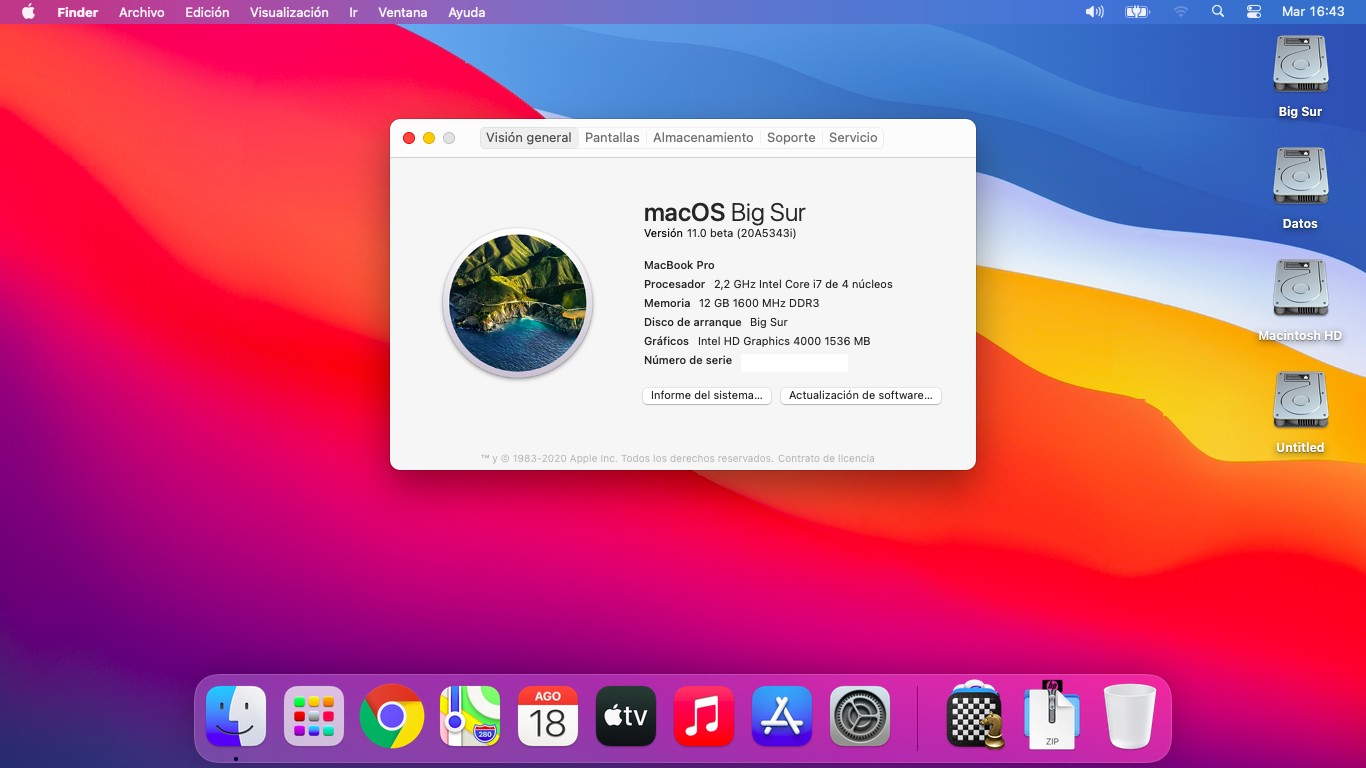

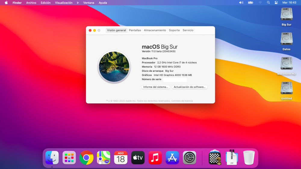

tdack Posted August 10, 2020 Share Posted August 10, 2020 Big Sur Public Beta 1 installed on a Gigabyte Z87-HD3 with an i7-4790 booting with OpenCore. Followed Dortania Desktop Guide for Haswell and Broadwell using generic SSDT-EC-DESKTOP.aml and SSDT-PLUG-DRTNIA.aml Working sound from onboard ALC HDA. Ethernet working with RealtekRTL8111.kext. temp@iMac ~ % nvram 4D1FDA02-38C7-4A6A-9CC6-4BCCA8B30102:opencore-version 4D1FDA02-38C7-4A6A-9CC6-4BCCA8B30102:opencore-version REL-060-2020-08-03 temp@iMac ~ % kextstat | egrep 'as\.|8111' 45 3 0 0x86000 0x86000 as.vit9696.Lilu (1.4.7) 8788947D-AF51-343F-A5F9-F6ED214D97B2 <8 6 5 3 2 1> 46 0 0 0xa2000 0xa2000 as.vit9696.WhateverGreen (1.4.2) 8D0814CB-5EEE-321A-87B6-CDD0608AE7DD <45 14 8 6 5 3 2 1> 47 0 0 0x170000 0x170000 as.vit9696.AppleALC (1.5.2) C27C3769-847F-30EB-B82C-A95F0495AE75 <45 14 8 6 5 3 2 1> 60 0 0 0x2e000 0x2e000 as.vit9696.VirtualSMC (1.1.6) A3E629D8-2CA4-3CC8-A9F4-4CB155C57057 <45 13 8 6 5 3 2 1> 70 0 0 0x77000 0x77000 com.insanelymac.RealtekRTL8111 (2.3.0d10) 5A31221B-80DB-3CD2-BD0A-D20B516D674E <43 14 6 5 3 1> 2 Link to comment Share on other sites More sharing options...
