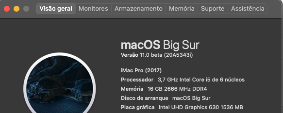

Hi Guys, info.plist from App Store when we enroll Mac from Catalina show another image with final "g".
But when update shows up " i " at the Installation...
20 min to install and not issues with OC update and kexts...!!!

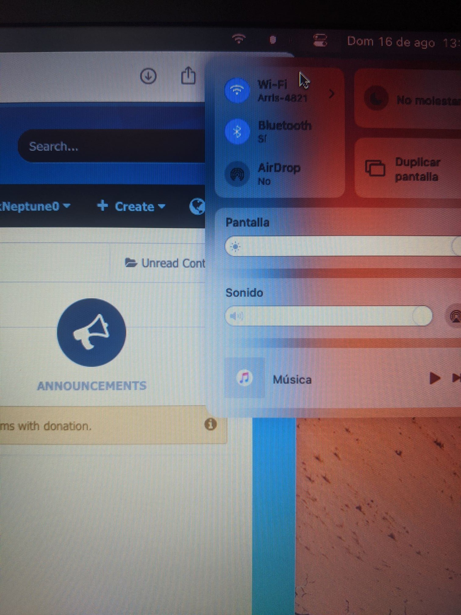

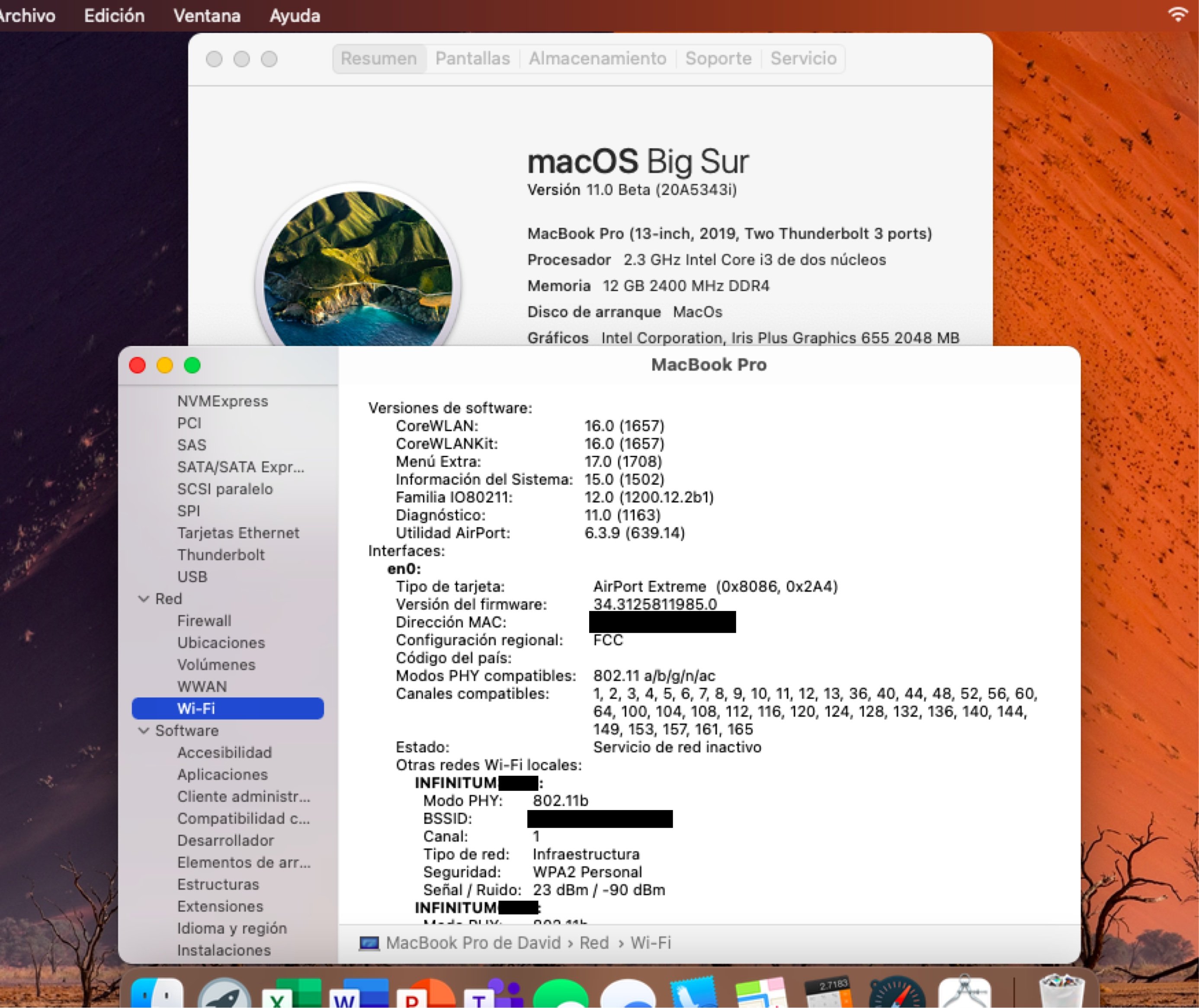

7 hours ago, dannyboy9 said:
He is currently working on it. There is another script that gives you a Wifi picker but that has to be activated every single time. So might as well live with what the itlwm guy has to offer.
it is in my Big Sur ver 4 setup works 70 mbs in g mode not 400 but baggers can't be choosy

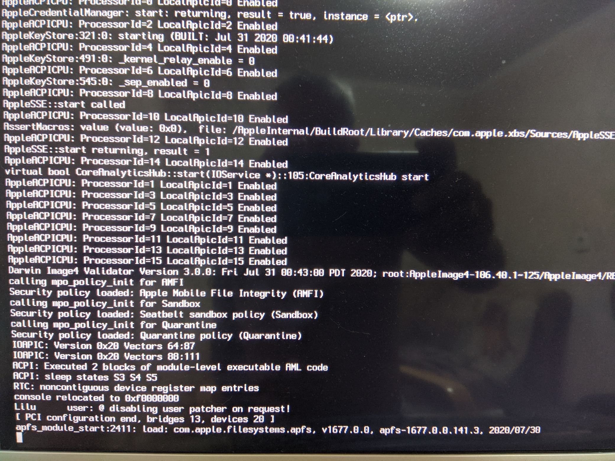

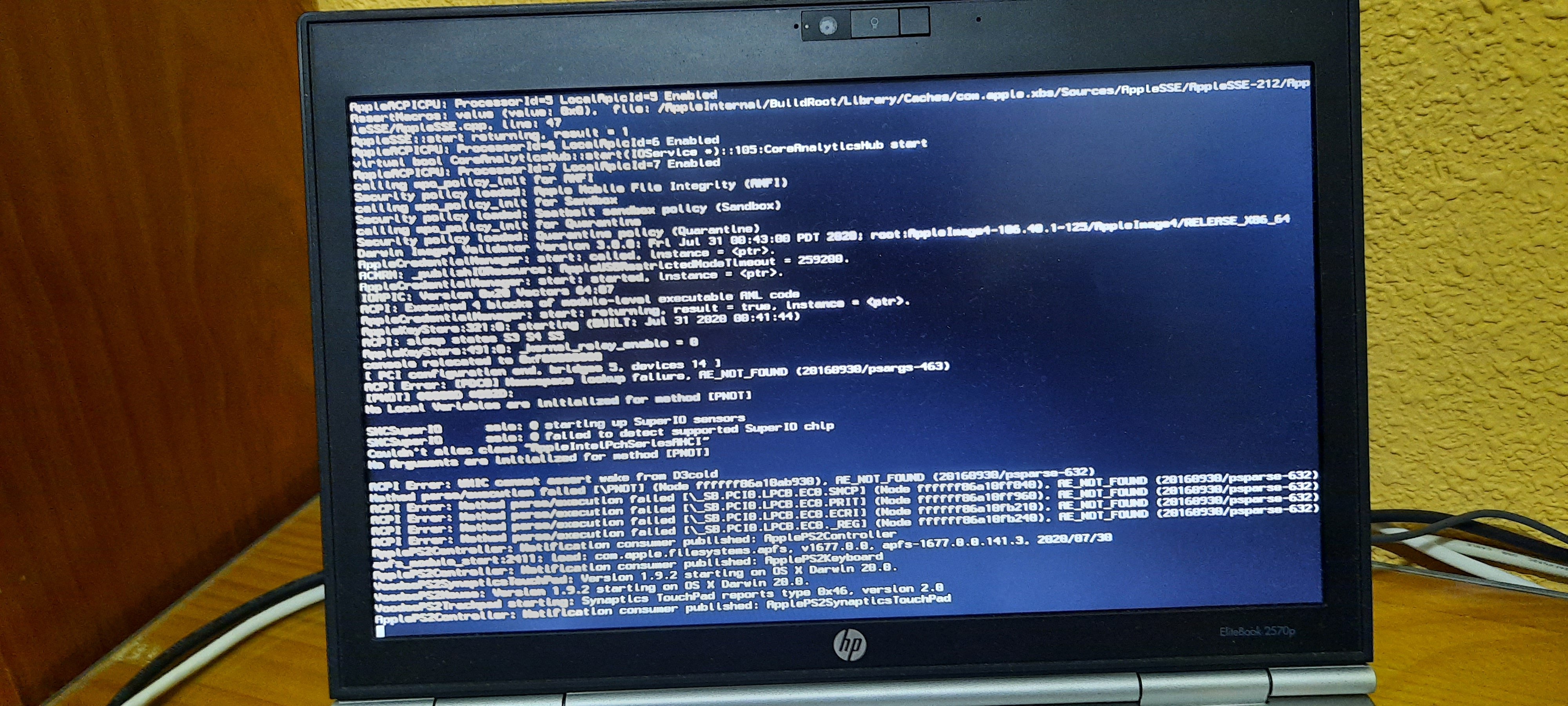

I have one ASUS H97M-E with OpenCore 061 works well with Catalina but I can't intall from usb.
It always stop the instal when there are 12 minutes left.
Could you help me with my EFI?
Thanks a lot
Edited by Streets
1 hour ago, Streets said:
@bisdak4920
Thanks a lot
EFI.zip
We have the same problem. My installation is is by VMWARE using @ludufre method which is very fast and easy. Sorry I can't help you on USB install.

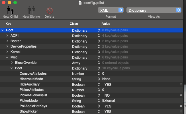

5 hours ago, Streets said:
@bisdak4920
Thanks a lot
Make sure You have only the necessary files in Your Drivers folder and in the config.plist UEFI/Drivers section. I struggled with the same thing.

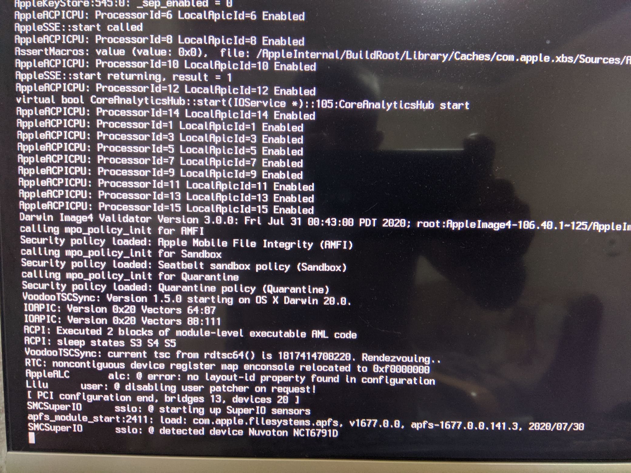

@SavageAUS @Alex HQuest @Max.1974  Thank you for all your assistance.
I finally managed to get BS Public Beta installed on my system (onto a separate m.2 SSD) from a USB.
Things that I did
  1. Replaced the USB drive with a newly purchased one.
  2. Did a fresh download of the public beta installer.
  3. Created installer and did the install.
  4. Kexts and config.plist file was unchanged from the previous install.
I noticed that this time that the drive sealing stage went through a bit slower and showed success message (previously I suspect there were errors, the verbose mode scrolls so fast that it is difficult to read) and the boot went through successfully.
I think in my previous installs the sealing phase had failed, and thats what caused the KP as reported in my earlier posts.
Is there a boot-arg or some hotkey that can enable a log of all that shows up on the -v (verbose screen during boot) up until the point we get to the desktop?
I would like to see that and evaluate, to see if there are areas or error which can be eliminated.
