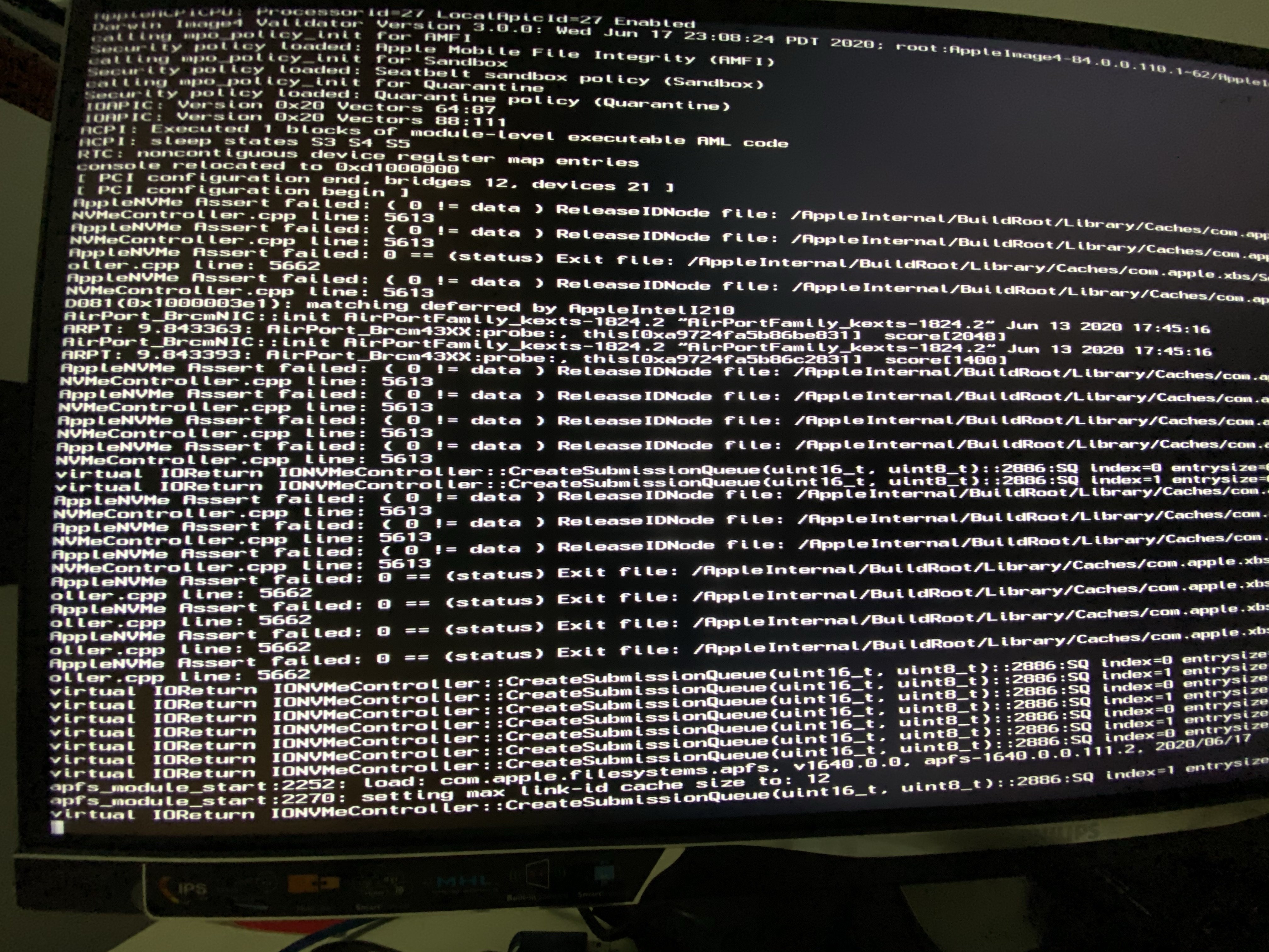

I use Samsung 970 EVO SSD - NVMe m.2; I haven't had any problems so far with it (using it since High Sierra). And the other betas of Big Sur were not making this problem, so I assume apple changed sth yet again related to that.
you are missing the point your computer has a touchscreen according to the screen you posted and there is no corresponding driver for that hub to take care off, so installation dies because of unidentified device you could take of the problem by posting a notch kext which tells make no to busy with this device to make it its own and use its own drivers
My computer does not have a touchscreen (lenovo 700 - 15isk with Skylake i7). How did you infer that? I see only touchpad related stuff in the boot logs.

u vac napisano eto vconze bashei loga kotorgo vi postali pochitai ego vnimatelno i vi uvidete sami look at the end of your log it says all about your touchscreen device elan which probably needs a voodooCElan.kext andvoodoogpio.kext and a ssd-tplo or tpd0 or what ever your DSDT says

I don't know what ever the picture says I think I tries to mount something and than expand the dmg file into it but doesn't succeed in mounting
This is not the problem. I turned off the kext for my touchpad and this line disappears. It gets stuck on AppleNVMe assert failed and the 2 virtual IOReturn IONVMeController lines

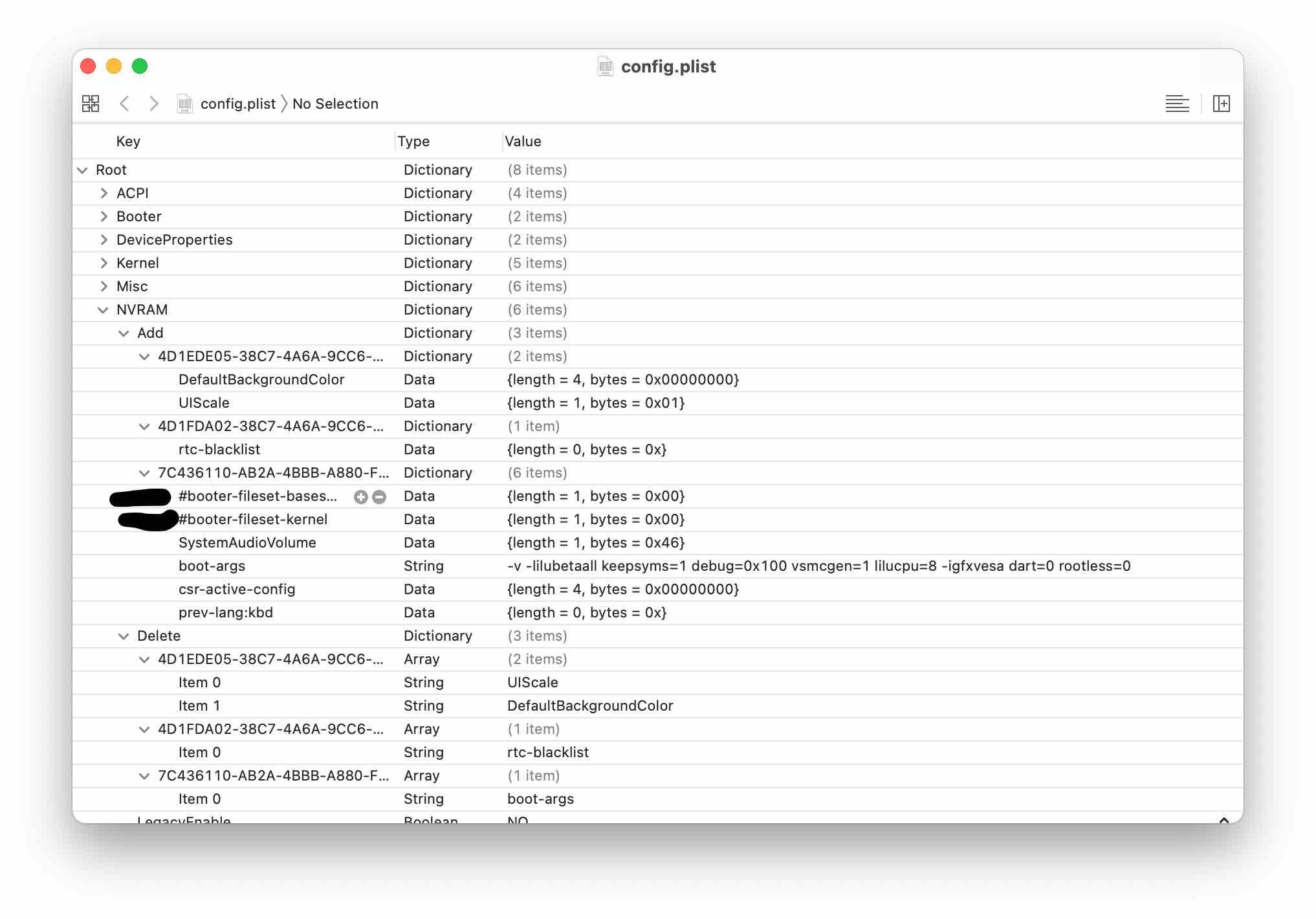

If you want to boot the installer you need to remove these boot-args:
Spoiler
4 minutes ago, Toilet said:
Add vsmcgen=1 to boot-args for beta 3
it's already using it
<plist version="1.0">
<string> -v debug=0x100 keepsyms=1 alcid=5 vsmcgen=1</string>
</plist>
</plist>
Please update your kexts to the latest ones

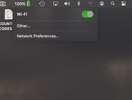

Ok, understand. I will return to this very soon. Now I need to get mi wifi working with DW 1560, BCM94532Z, something like that

Now I am trying to get my wifi working , I have DW1560 card.
As @markl18 pointed out, the actual GPI0 device may have a different name in your DSDT.  Mine are TPD0 and TPL1.  I don't think this is a bug.  I think that using I2C to read SATA drives is a more modern method and AHCI may get phased out.  Not really sure about that.
I do have full function of IGPU.  I only wish I could use my dGPU but it is disabled in the BIOS.  I believe I have the DW1560 wifi/BT card and it is working fine with this kext version.

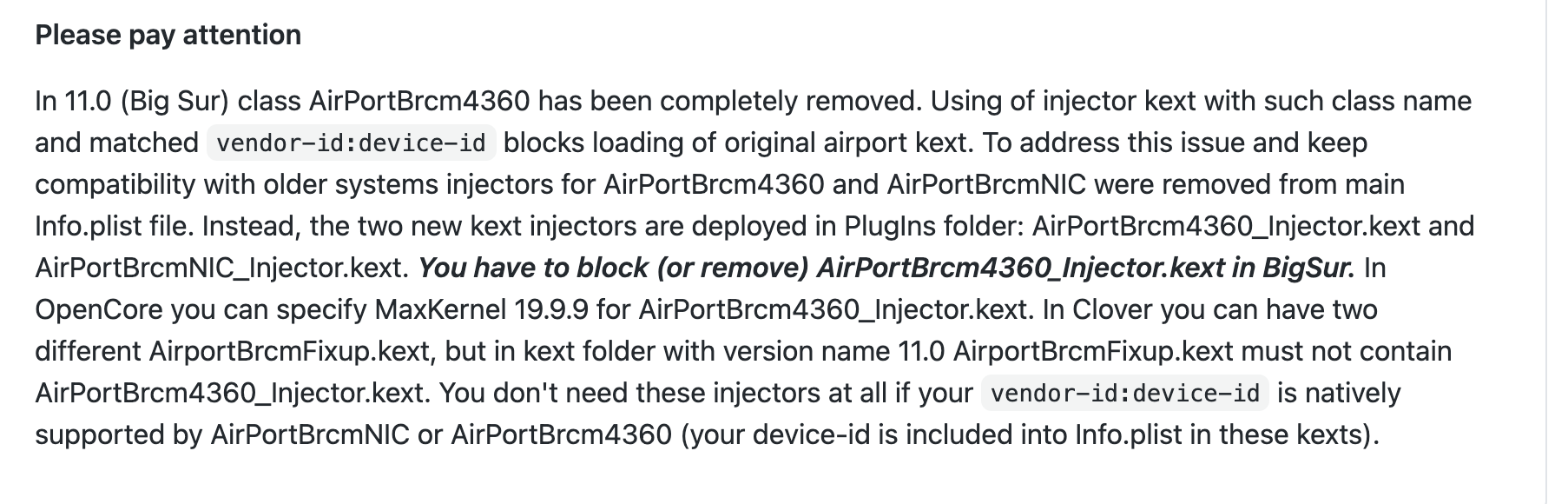

Wifi for BigSur.zip
Wifi for BigSur.zip

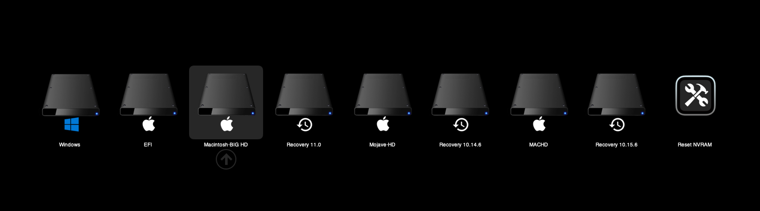

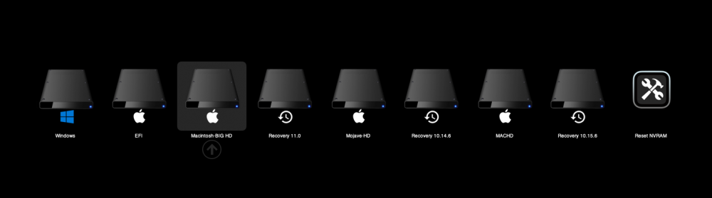

6 hours ago, eSaF said:
Yea if your finding is correct with Clover, then there is something flaky with or a misconfiguration in Opencore causing the BS disk not to show in the Startup Disk section in System Preferences. It has been a daily task of mine trying to find out why and I've yet to track it down. :(
I still think this is how OC is dealing with new APFS partitions in BigSur, and why we're having problems with getting Recovery to work properly. BigSur has changed something in APFS so that OC isn't properly working (and why disks are disappearing when using Startup Disk section).
According to OC docs, 0x00000100 — OC_SCAN_ALLOW_FS_APFS should work with an APFS partition, but it does not. We must set ScanPolicy to 0 to get into BigSur Recovery (and even then disabling csrutil doesn't seem to 'stick' on re-boot). [Usual OC settings do get into Catalina Recovery, just not BigSur Recovery.]
