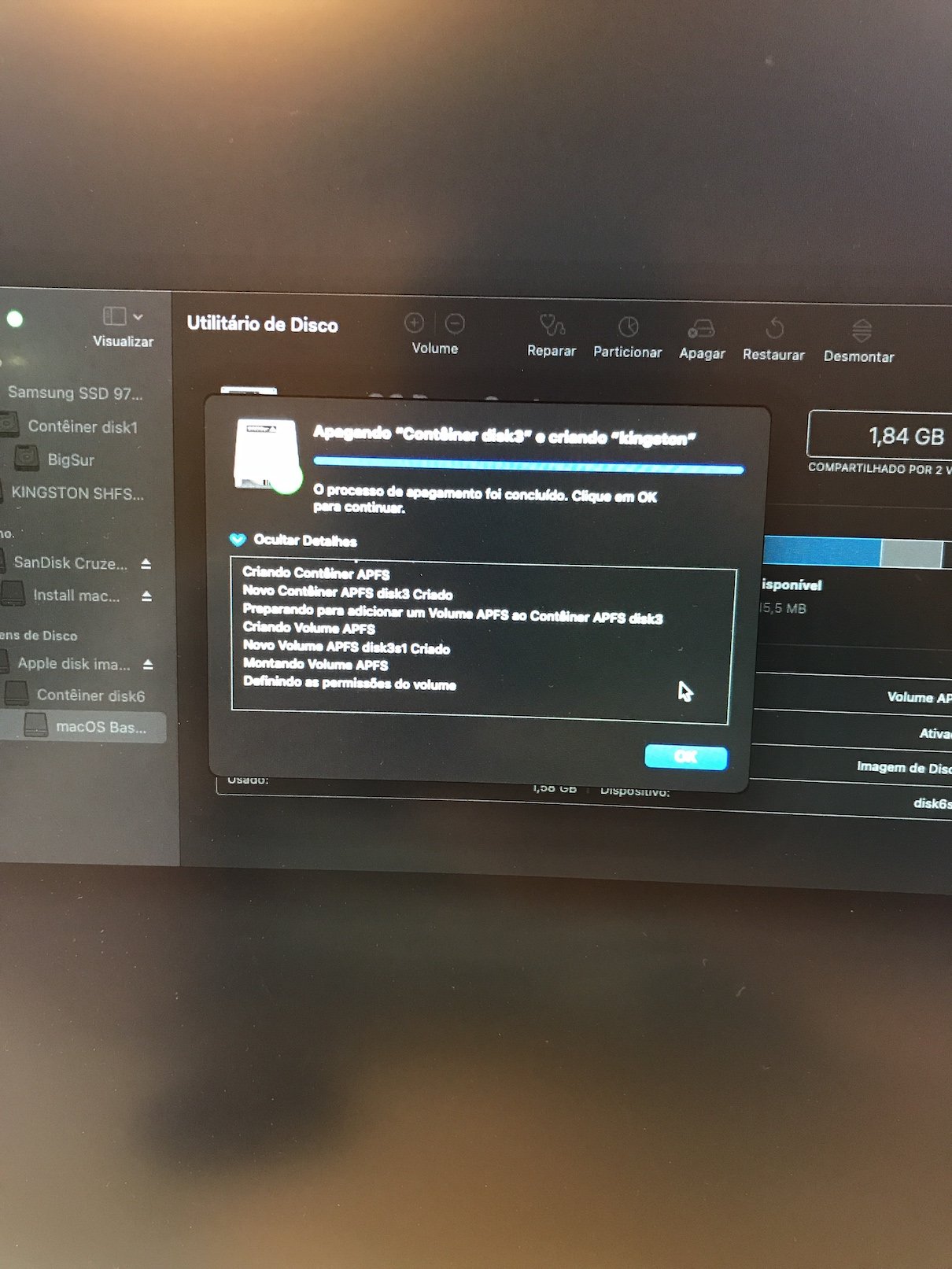

rianosx Posted July 6, 2020 Share Posted July 6, 2020 Hello friends, I'm trying to upload BigSur vanilla with an efi made available by a friend. But in the installation menu the hard drive is not recognized. It doesn't even appear on diskutil actually. My hardware: I3-7020U HD 620 HDD SATA EFI.zip Link to comment https://www.insanelymac.com/forum/topic/344428-pre-release-macos-big-sur/page/6/#findComment-2728935 Share on other sites More sharing options...

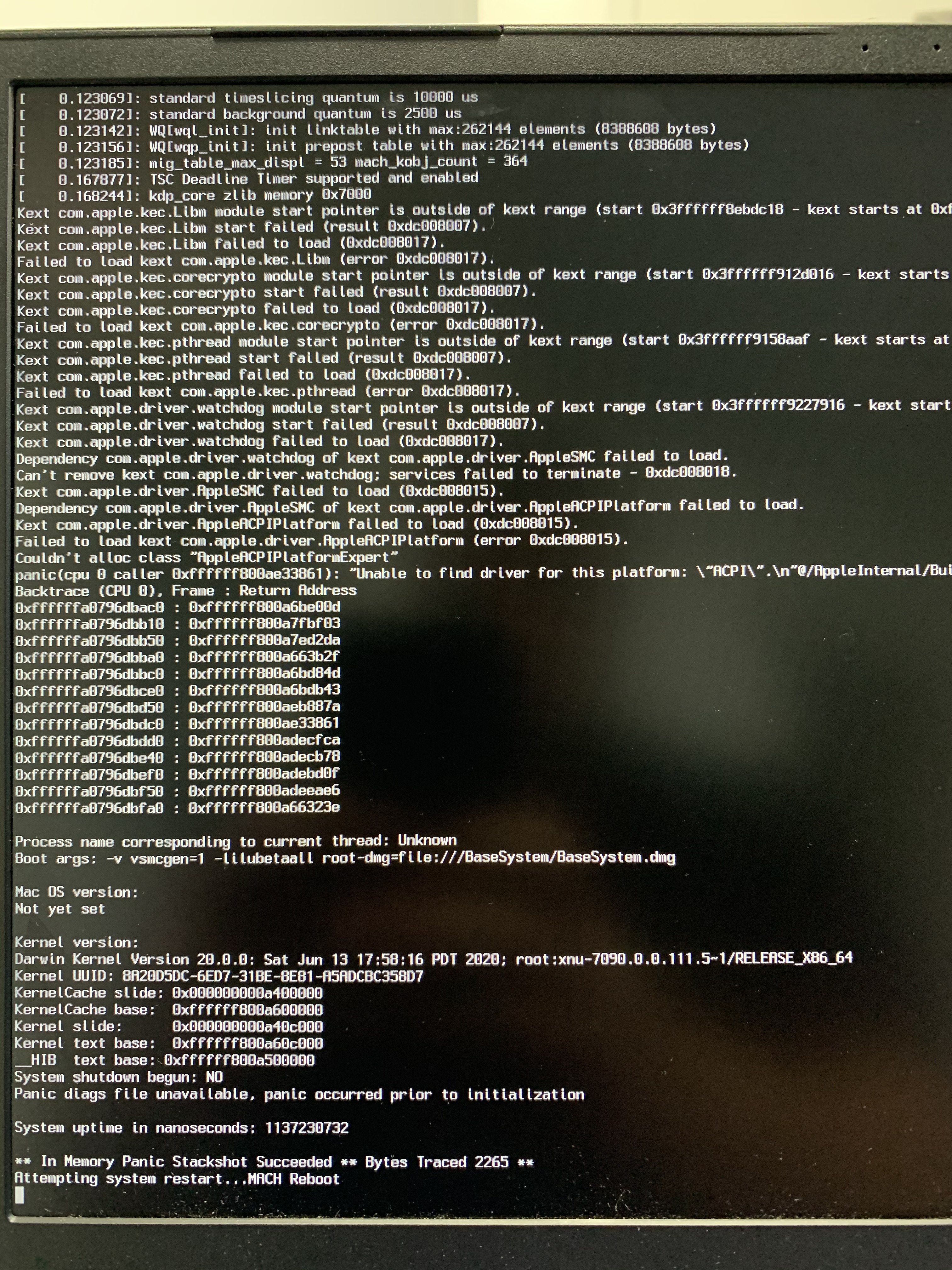

Cephalotus Posted July 6, 2020 Share Posted July 6, 2020 someone managed to solve the problem SIGABRT ? I tried to swap the virtualsmc for fakesmc but always gives this plist for virtualsmc not found Link to comment https://www.insanelymac.com/forum/topic/344428-pre-release-macos-big-sur/page/6/#findComment-2728939 Share on other sites More sharing options...
Pavo Posted July 6, 2020 Share Posted July 6, 2020 11 minutes ago, Cephalotus said: someone managed to solve the problem SIGABRT ? I tried to swap the virtualsmc for fakesmc but always gives this plist for virtualsmc not found You should really know how to use OpenCore before going around and switching kext out. You must update the config.plist with whatever kext you are using. 1 Link to comment https://www.insanelymac.com/forum/topic/344428-pre-release-macos-big-sur/page/6/#findComment-2728941 Share on other sites More sharing options...

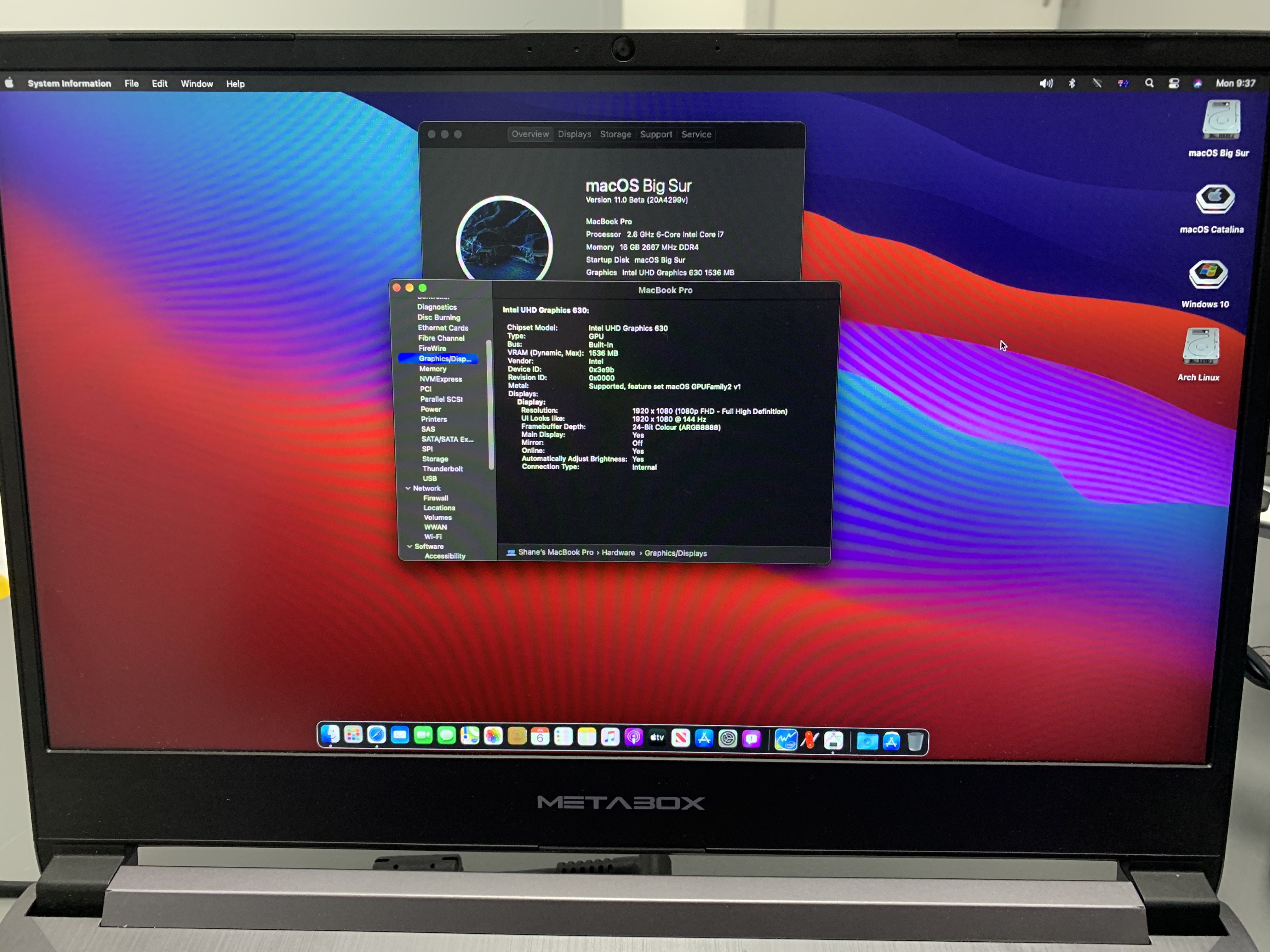

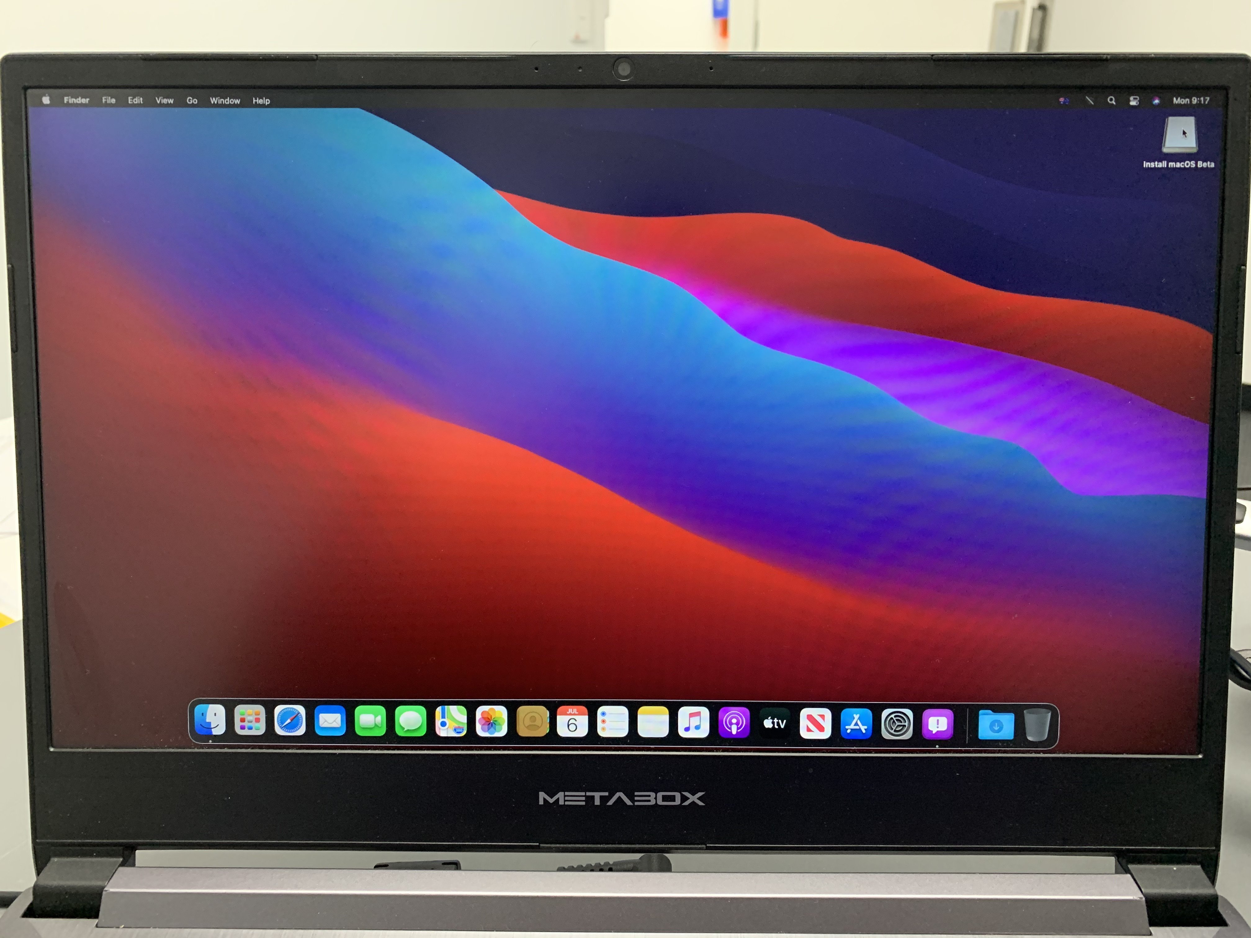

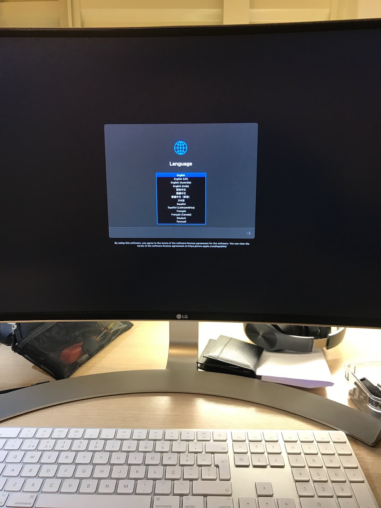

Max.1974 Posted July 6, 2020 Share Posted July 6, 2020 Hi all, i succeded too instal Big Sur with Premade EFI from Olarila.com thanks a lot to @MaLd0n this is guy work hard, deserve so much be recognize, and the same way, all of the great developers from this community. My Desktop from signature: Z170-XP_SLi... Spoiler 3 Link to comment https://www.insanelymac.com/forum/topic/344428-pre-release-macos-big-sur/page/6/#findComment-2728947 Share on other sites More sharing options...

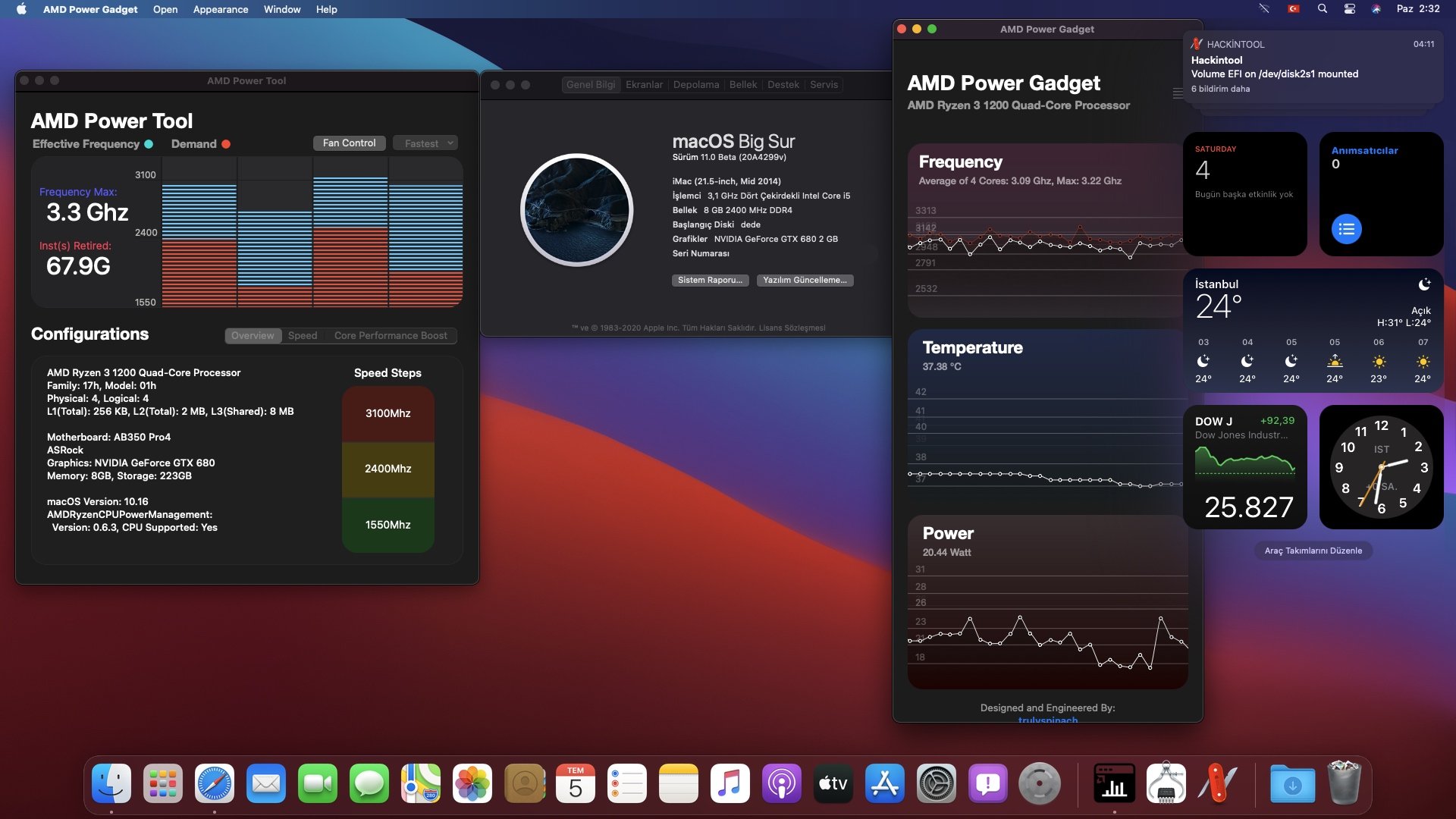

nomadturk Posted July 7, 2020 Share Posted July 7, 2020 Success on Asrock AB350 PRO4, Ryzen 1200, GTX 680 Spoiler Link to comment https://www.insanelymac.com/forum/topic/344428-pre-release-macos-big-sur/page/6/#findComment-2728951 Share on other sites More sharing options...

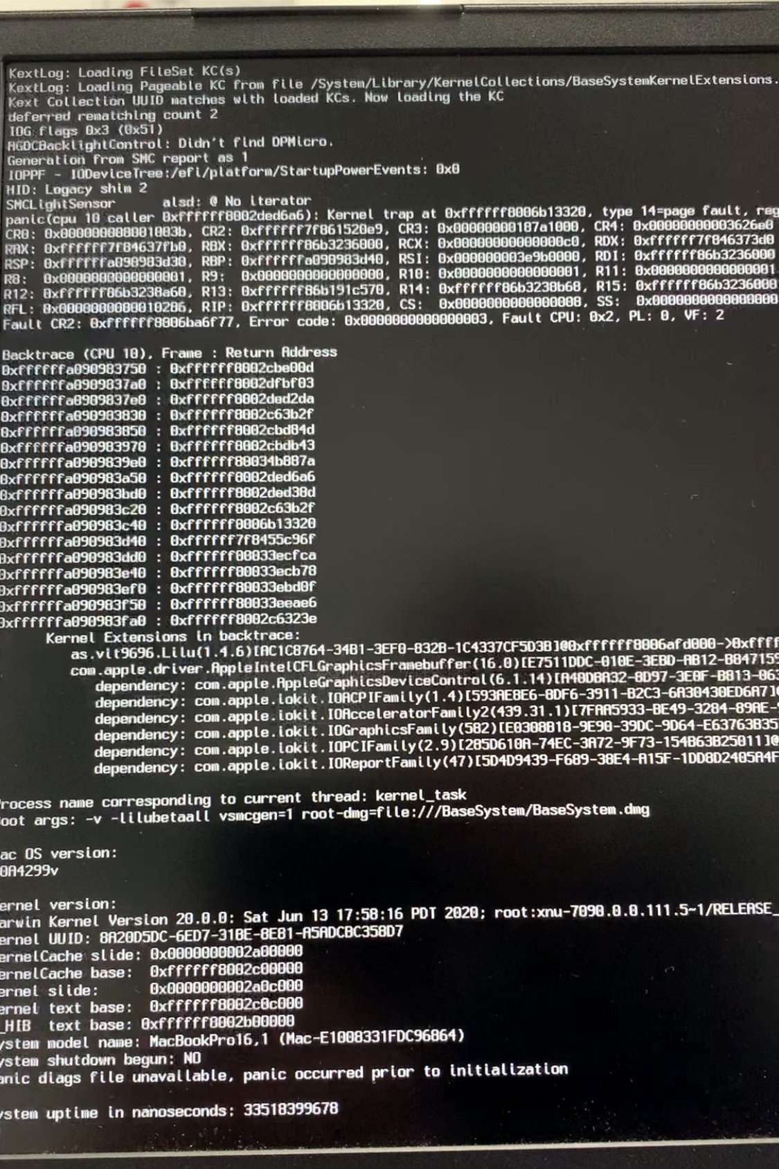

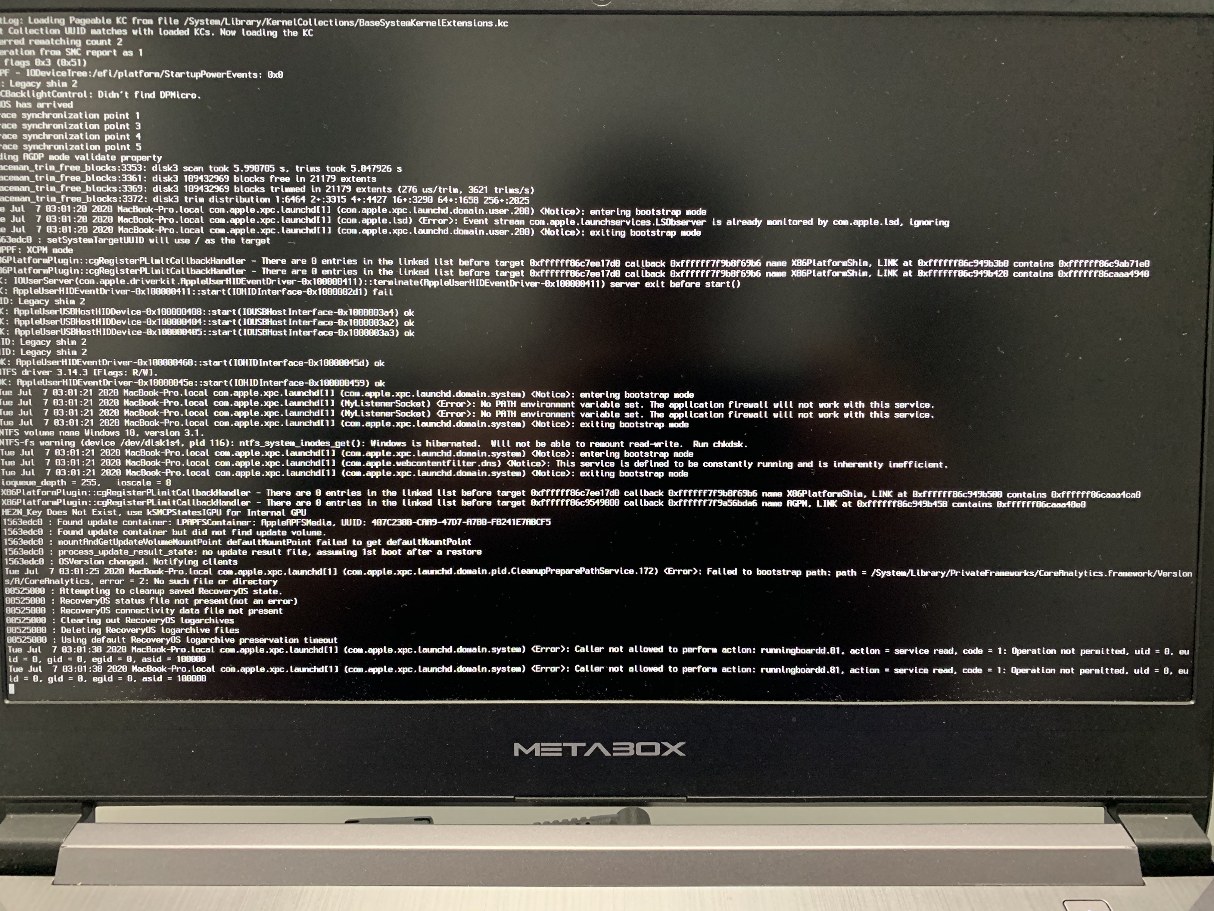

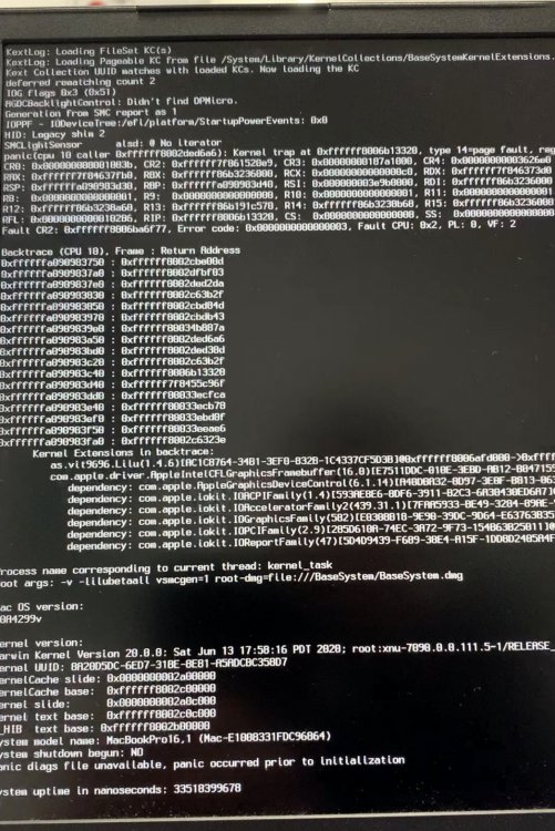

SavageAUS Posted July 7, 2020 Share Posted July 7, 2020 Morning all, so i have build new OC, new kexts and i can make it further in the USB installer but still not very far until i get the shown KP. Boot args: -v -lilubetaall vsmcgen=1 Laptop specs in signature. Spoiler Link to comment https://www.insanelymac.com/forum/topic/344428-pre-release-macos-big-sur/page/6/#findComment-2728952 Share on other sites More sharing options...
eSaF Posted July 7, 2020 Share Posted July 7, 2020 3 minutes ago, SavageAUS said: Morning all, so i have build new OC, new kexts and i can make it further in the USB installer but still not very far until i get the shown KP. Boot args: -v -lilubetaall vsmcgen=1 Laptop specs in signature. Reveal hidden contents No need for -lilubetaall now so you should remove that from boot arg. Link to comment https://www.insanelymac.com/forum/topic/344428-pre-release-macos-big-sur/page/6/#findComment-2728953 Share on other sites More sharing options...

SavageAUS Posted July 7, 2020 Share Posted July 7, 2020 @eSaF Thanks for the tip but removing that boot arg did not help, same KP. config.plist Link to comment https://www.insanelymac.com/forum/topic/344428-pre-release-macos-big-sur/page/6/#findComment-2728955 Share on other sites More sharing options...
eSaF Posted July 7, 2020 Share Posted July 7, 2020 1 hour ago, SavageAUS said: @eSaF Thanks for the tip but removing that boot arg did not help, same KP. config.plist Actually I had to use the full config.plist and fill in all the relevant info before I could get it to boot, I got the idea from dannyboy9's config.plist because when I used the simplified one as I did in Catalina it would not boot. Have a look at the EFI Folder I posted a page or two back just to give you an idea and maybe get you a step further. Good luck. Link to comment https://www.insanelymac.com/forum/topic/344428-pre-release-macos-big-sur/page/6/#findComment-2728959 Share on other sites More sharing options...

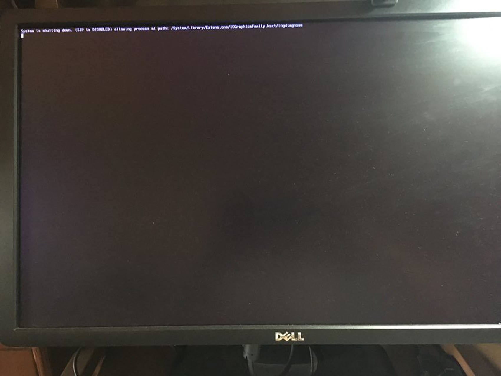

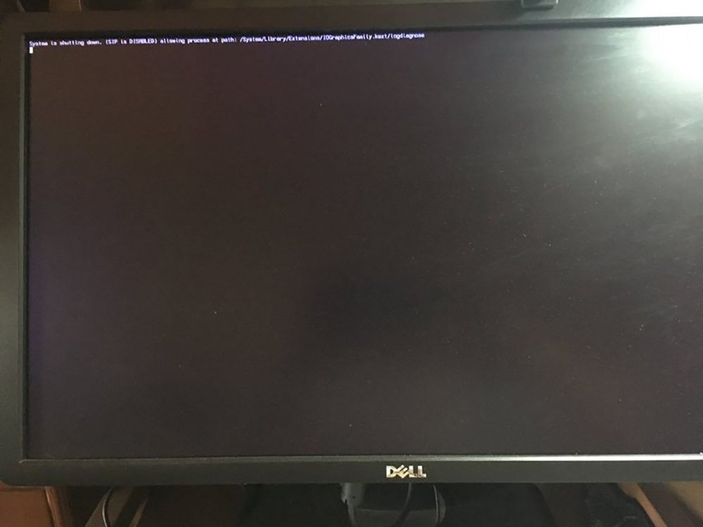

Cephalotus Posted July 7, 2020 Share Posted July 7, 2020 anyone know how to solve this? after this last message the screen goes black and without signal https://www.mediafire.com/view/zdfabvkjnfx4rl7/WhatsApp_Image_2020-07-06_at_21.53.12.jpeg/file Link to comment https://www.insanelymac.com/forum/topic/344428-pre-release-macos-big-sur/page/6/#findComment-2728961 Share on other sites More sharing options...

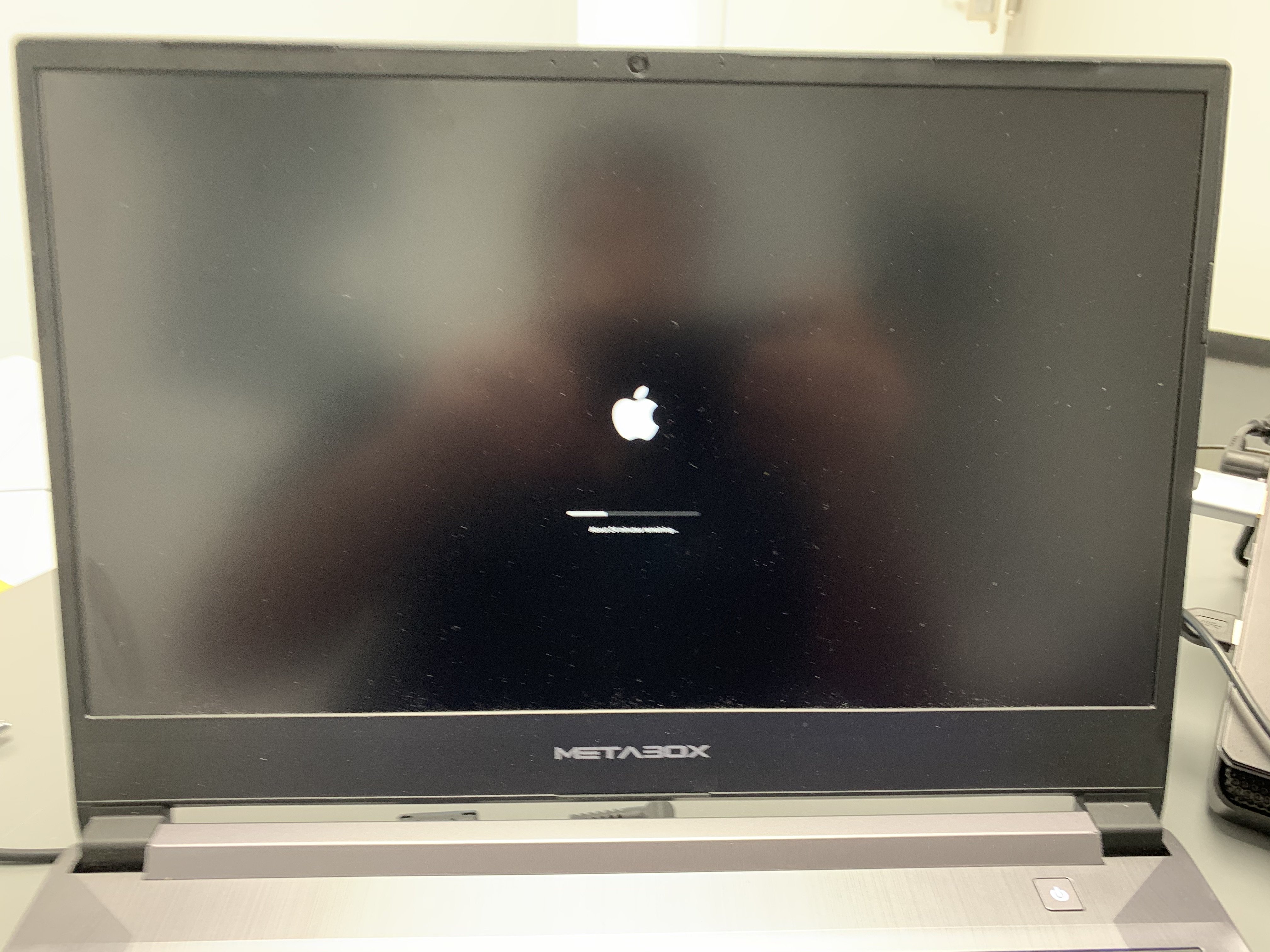

bisdak4920 Posted July 7, 2020 Share Posted July 7, 2020 I was able to boot my usb installer and install. When I reboot and start macos installer, this is what i got. Please help. Link to comment https://www.insanelymac.com/forum/topic/344428-pre-release-macos-big-sur/page/6/#findComment-2728964 Share on other sites More sharing options...

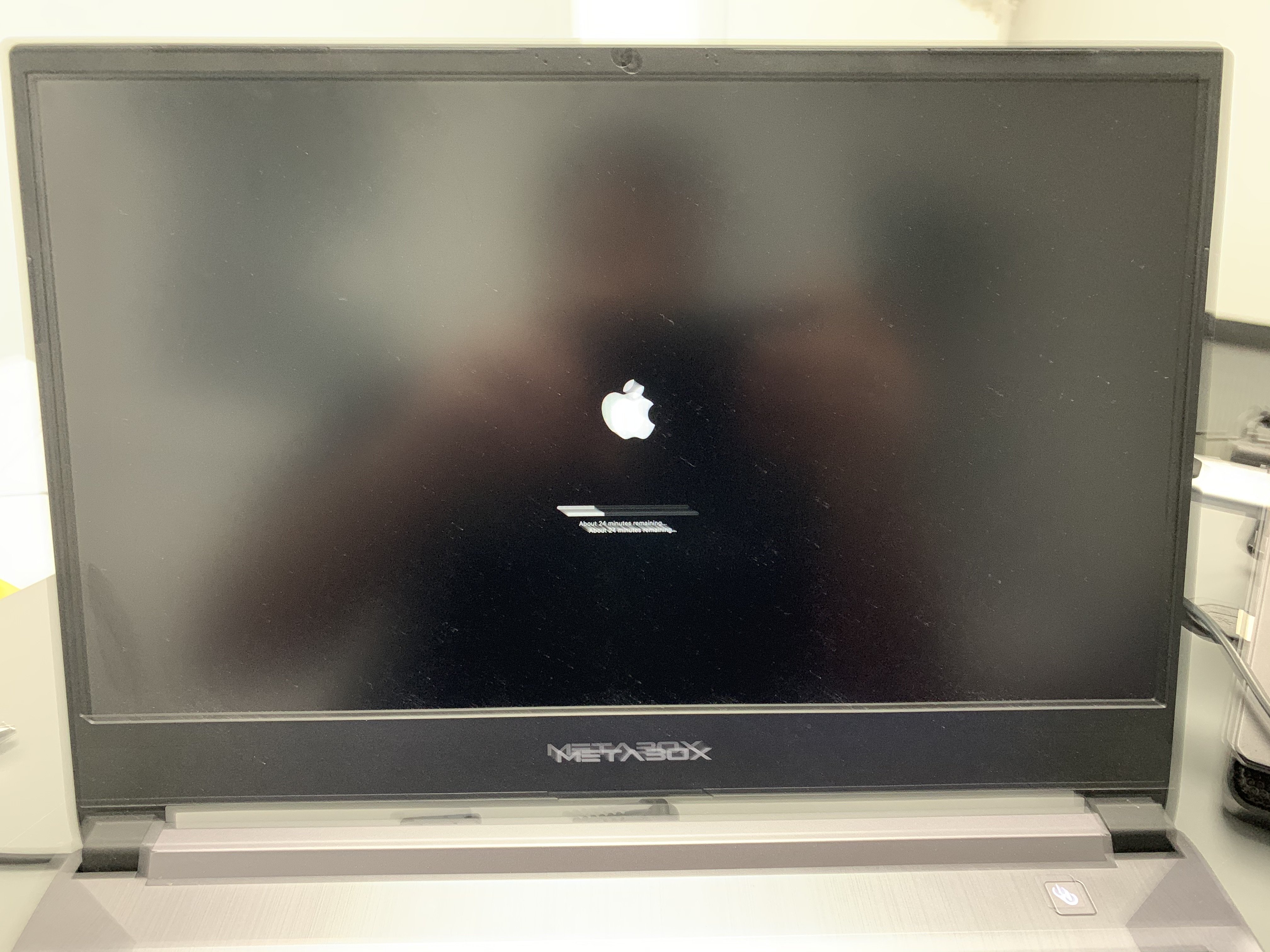

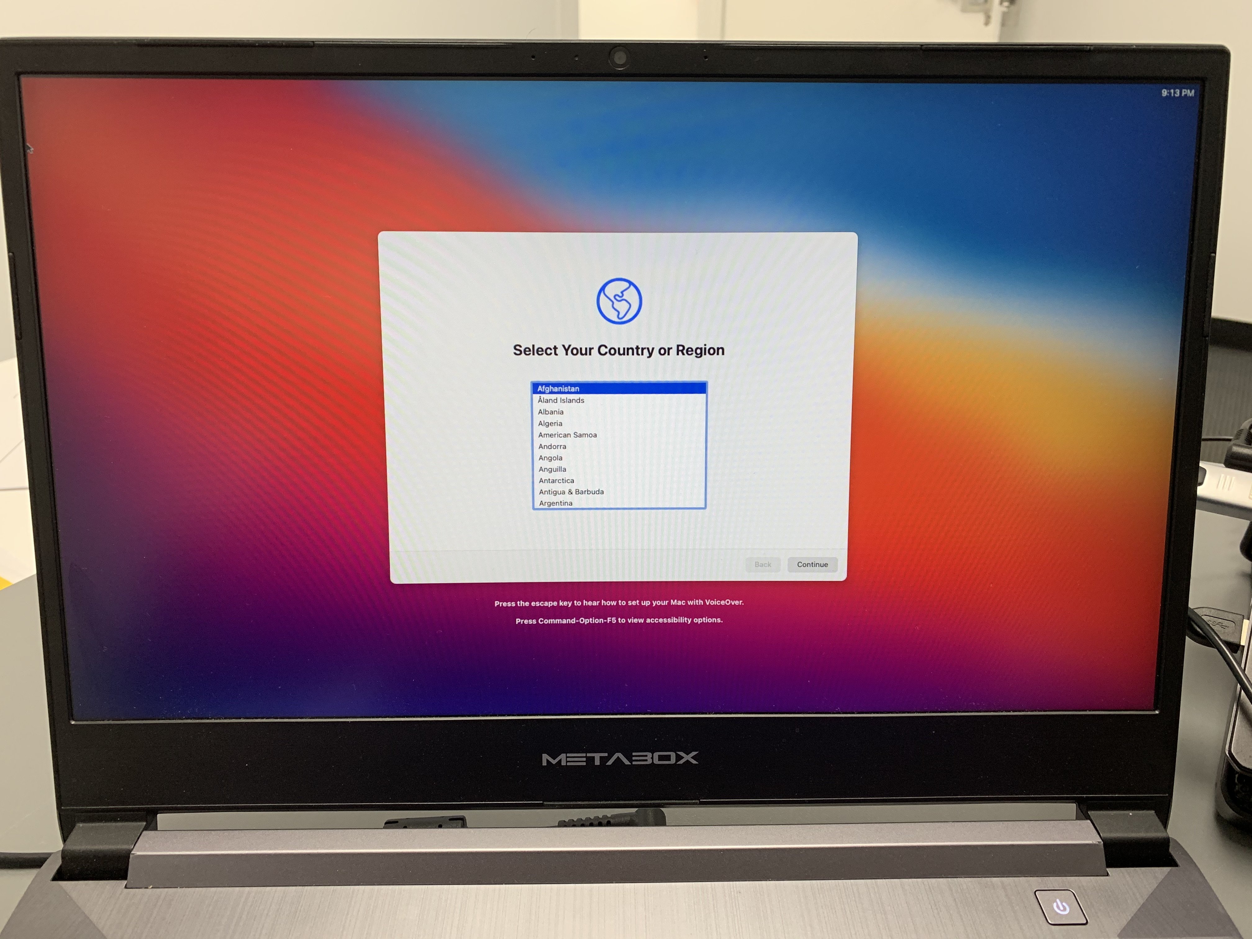

SavageAUS Posted July 7, 2020 Share Posted July 7, 2020 (edited) Success! USB install to internal SSD on my laptop. config.plist attached. Installation took a while (i mean a while) and stalled on a few parts but be patient. So far with limited testing WiFi is the only thing not working (DW1820A) and trackpad is not recognised (But works) Still need to test CPU PM, battery status, sleep, lid and a few other things. Great work to the devs of OC. config.plist Now when i boot into Catalina though i have this drive mounted? Spoiler Spoiler Spoiler Spoiler Spoiler Spoiler Spoiler Spoiler Spoiler Edited July 8, 2020 by SavageAUS 3 Link to comment https://www.insanelymac.com/forum/topic/344428-pre-release-macos-big-sur/page/6/#findComment-2728966 Share on other sites More sharing options...

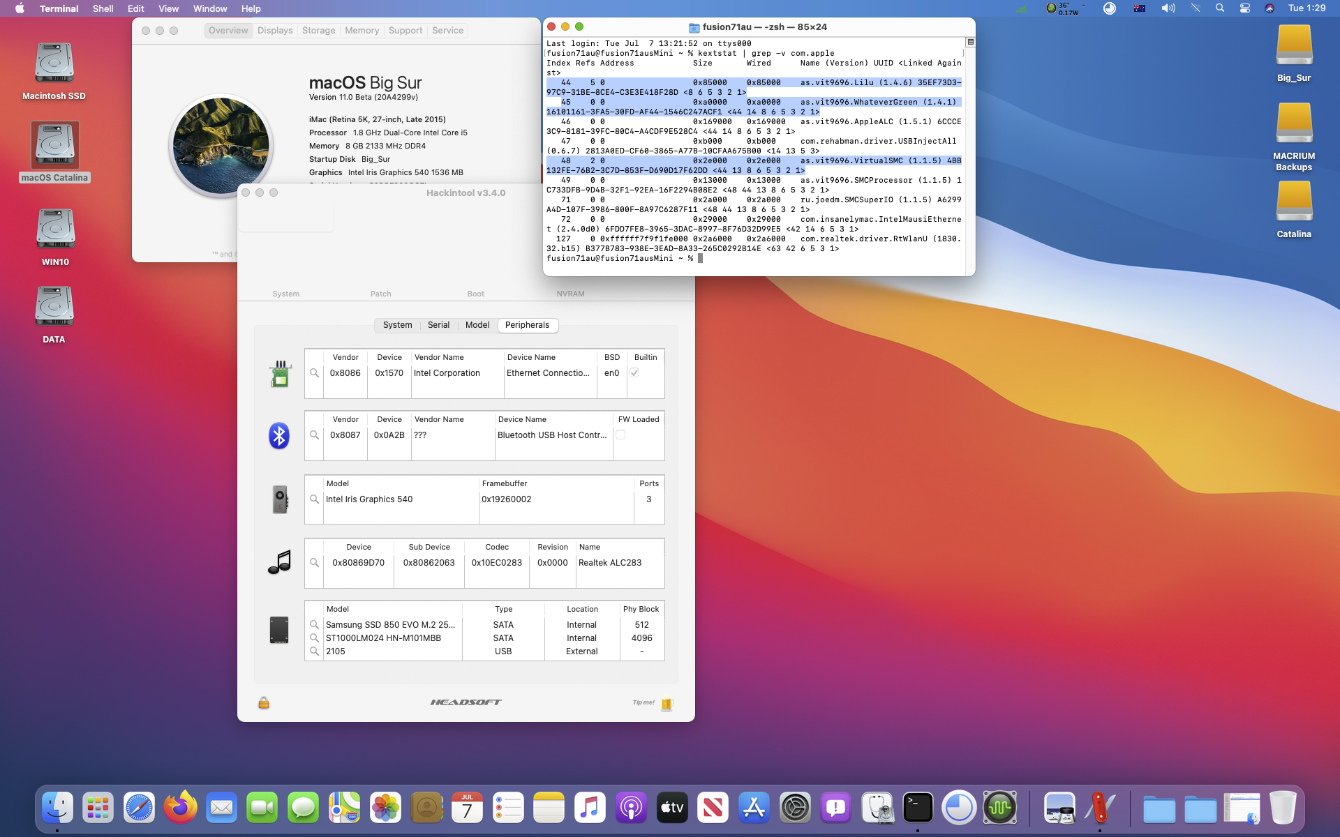

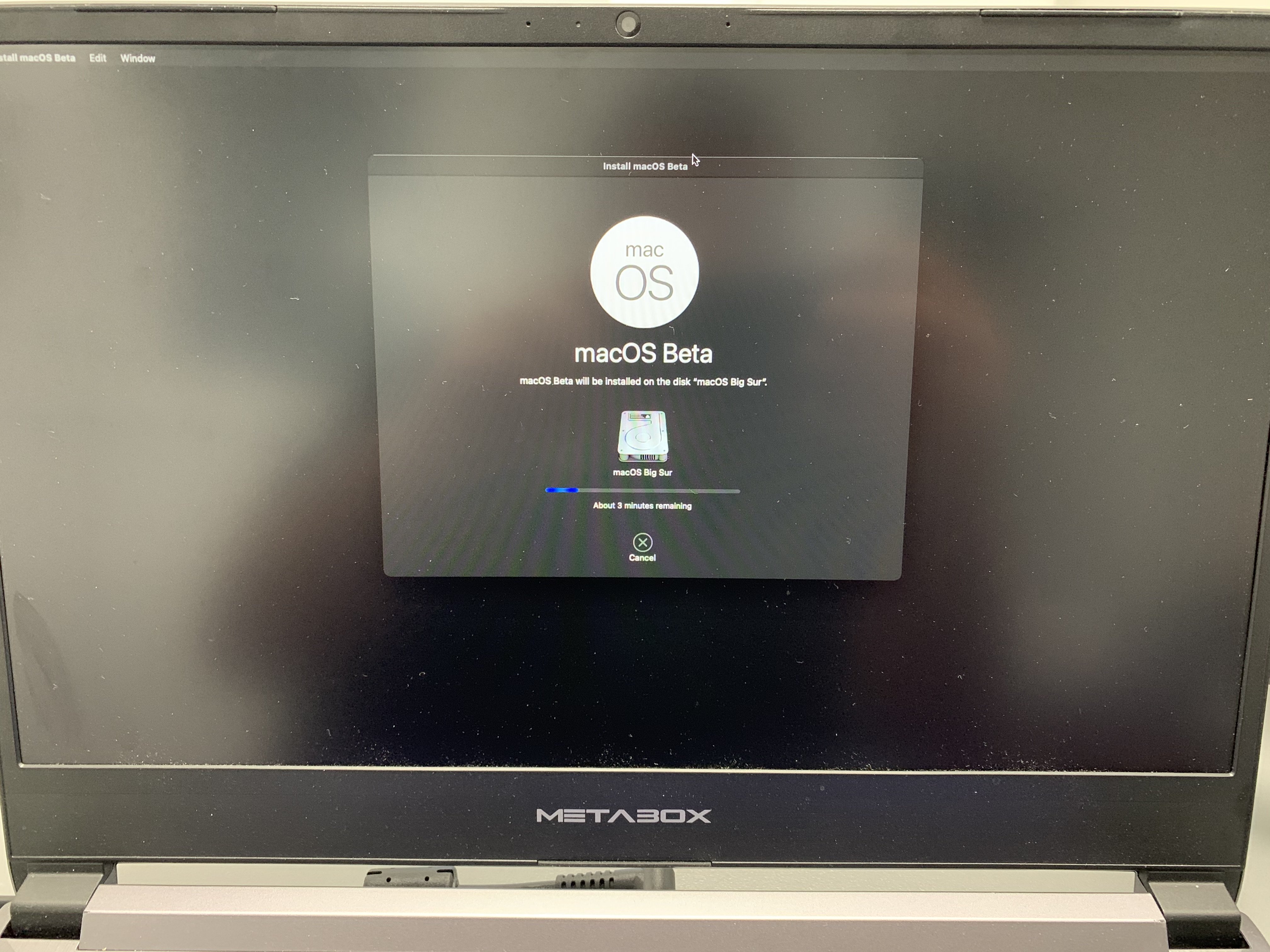

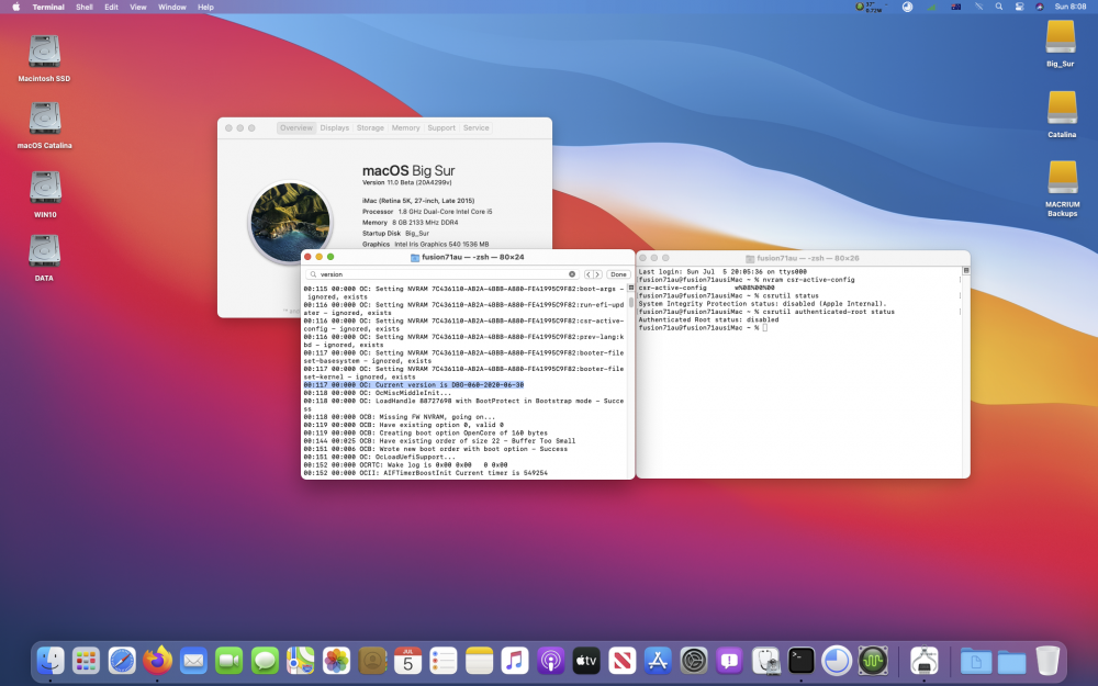

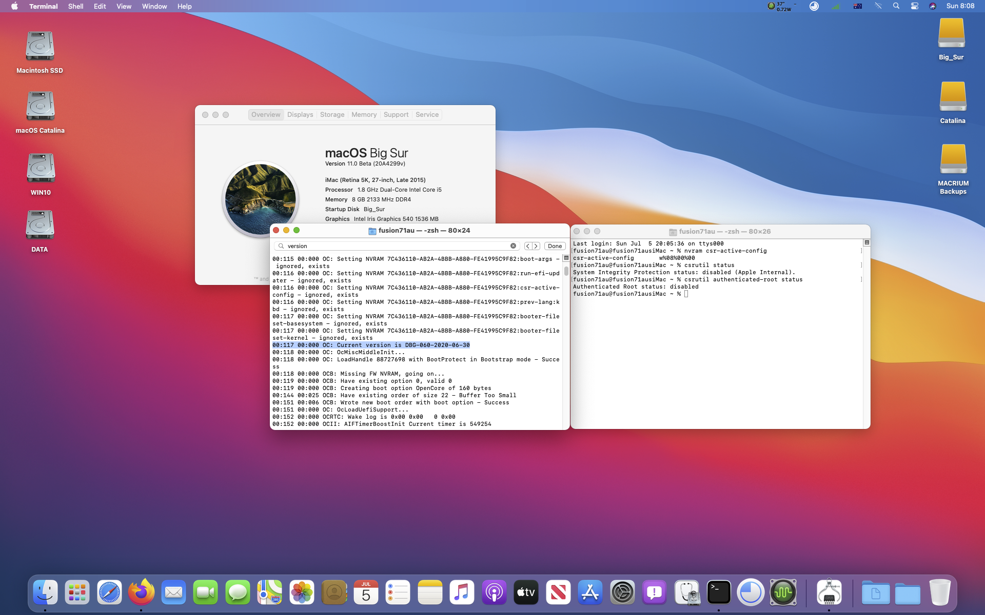

fusion71au Posted July 7, 2020 Share Posted July 7, 2020 (edited) Successfully installed macOS Big Sur Beta1 on my Skylake NUC6i5SYH, thanks to the latest OC 0.6.0. Much kudos to acidanthera devs for their hard work to enable native booting of the BS installer from KernelCollections !!! Spoiler Notes USB Installer made with createinstallmedia method Compiled latest OC 0.6.0 from GIT Hub Also compiled latest Lilu v1.4.6 and WhateverGreen v1.4.1 kexts to avoid kernel panic and black screen before login screen Recommend to set Kernel/Quirks/PanicNoKextDump to YES in config.plist to troubleshoot problematic kexts if kernel panic occurs To disable authenticated root SIP in Big Sur (so can play around with system files), I set csr-active-config in OC config.plist to 0x77080000, then reset NVRAM through the OC boot menu —> csr-active-config w%08%00%00 Catalina kexts for my Edimax EW-7811UTC AC600 wireless USB (based on Realtek rtl8812 chipset) still work well in Big Sur OC 0.6.0 for Skylake NUC6i5SYH.zip Edited July 14, 2020 by fusion71au 5 1 Link to comment https://www.insanelymac.com/forum/topic/344428-pre-release-macos-big-sur/page/6/#findComment-2728969 Share on other sites More sharing options...
