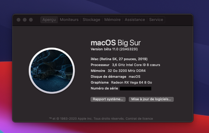

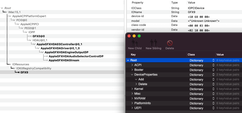

20 hours ago, mick3lson said:
I'm trying to update to beta3 on hp4540s but at first reboot,  stuck on: apfs_module_start:2411
was in the same case.
adding vsmcgen=1 in boot-args solved the trouble for me. (Mac mini 8,1)
Edit same for my iMac15,1.
