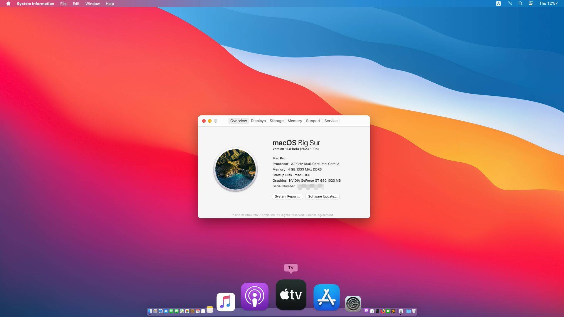

21 hours ago, fusion71au said:
So I wanted to see if my ancient core2duo laptop, Dell XPS M1530 with legacy BIOS (system 3 in my sig), would boot Big Sur beta 2…
  Hide contents
  • Booted with OC 0.6.0 onto Big Sur beta 2 (where installation was done previously onto an external USB HD by my NUC6i5SYH with metal capable Intel Iris Graphics 540)
  • APFS snapshots deleted with this procedure
  • Deleted/replaced the file /System/Library/UserEventPlugins/com.apple.telemetry.plugin with the one from High Sierra
  • No graphics acceleration yet for nVidia Tesla based Geforce 8600M GT (non metal capable).  Waiting for developments from @Asentientbot or others at MacRumors forum.
This procedure works with iGPU owners? Maybe this will works if intel 620 HD that not run Apple TV properly? Thanks!!!
