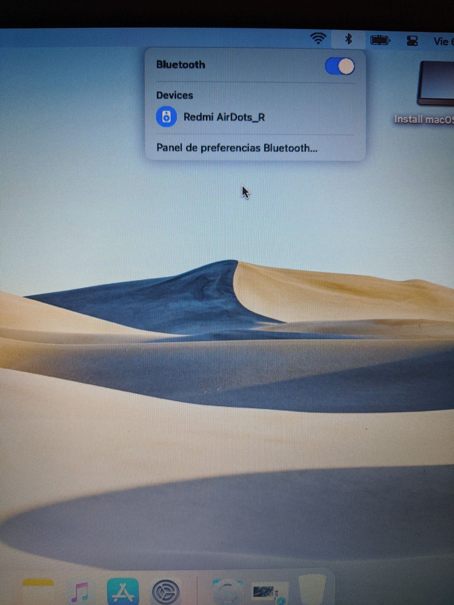

DarkNeptune0 Posted July 3, 2020 Share Posted July 3, 2020 I can confirm that the Intel - 3165ngw card has wifi and Bluetooth working in Big Sur, kext Itlwm and IntelBluetoothFirmware 4 1 Link to comment Share on other sites More sharing options...

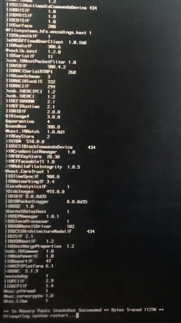

tore2003 Posted July 3, 2020 Share Posted July 3, 2020 (edited) Can someone help me? Why did I got this kernel crash? (then my pc reboots? Can someone help me? Why did I got this kernel crash? (then my pc reboots) Edited July 3, 2020 by tore2003 Link to comment Share on other sites More sharing options...

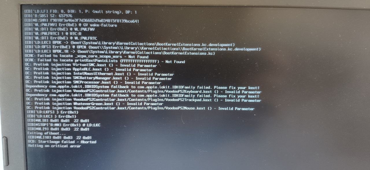

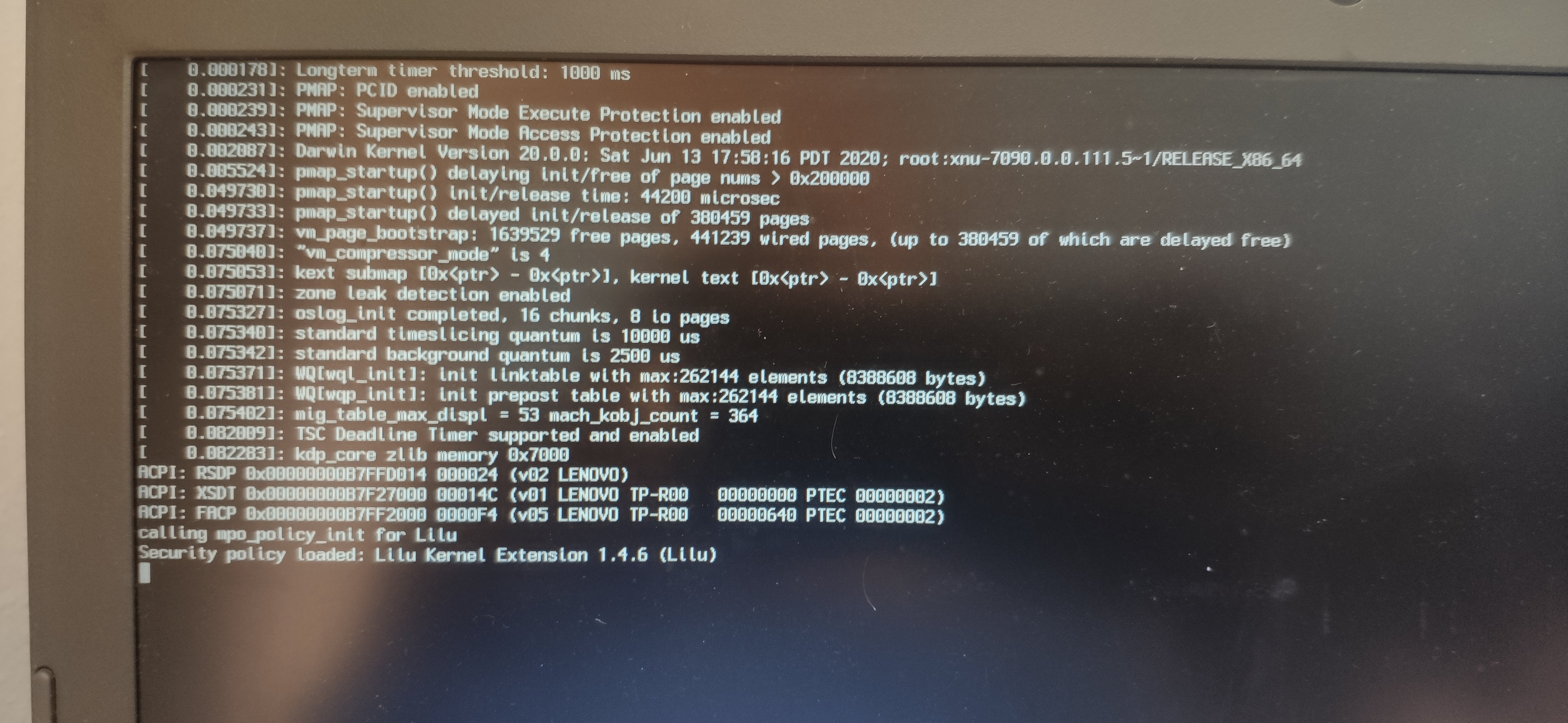

kushwavez Posted July 3, 2020 Share Posted July 3, 2020 (edited) So I tried the modified Clover on my Z170 Skylake system, but it's always hangs with KP (not related to kexts, macOS version not yet set), even on Catalina 10.15.5, same KP as on Big Sur. Tried the latest compiled kexts, same. After some research I found out that this is because of the QcQuirks Or the OpenRuntime, or a misconfiguration in the QcQuirks.plist. After removing them I successfully booted back Catalina. What should I edit in the plist? Here I am attaching my EFI and photos. CLOVER_Z170_Deluxe_BS.zip Edited July 3, 2020 by kushwavez Link to comment Share on other sites More sharing options...

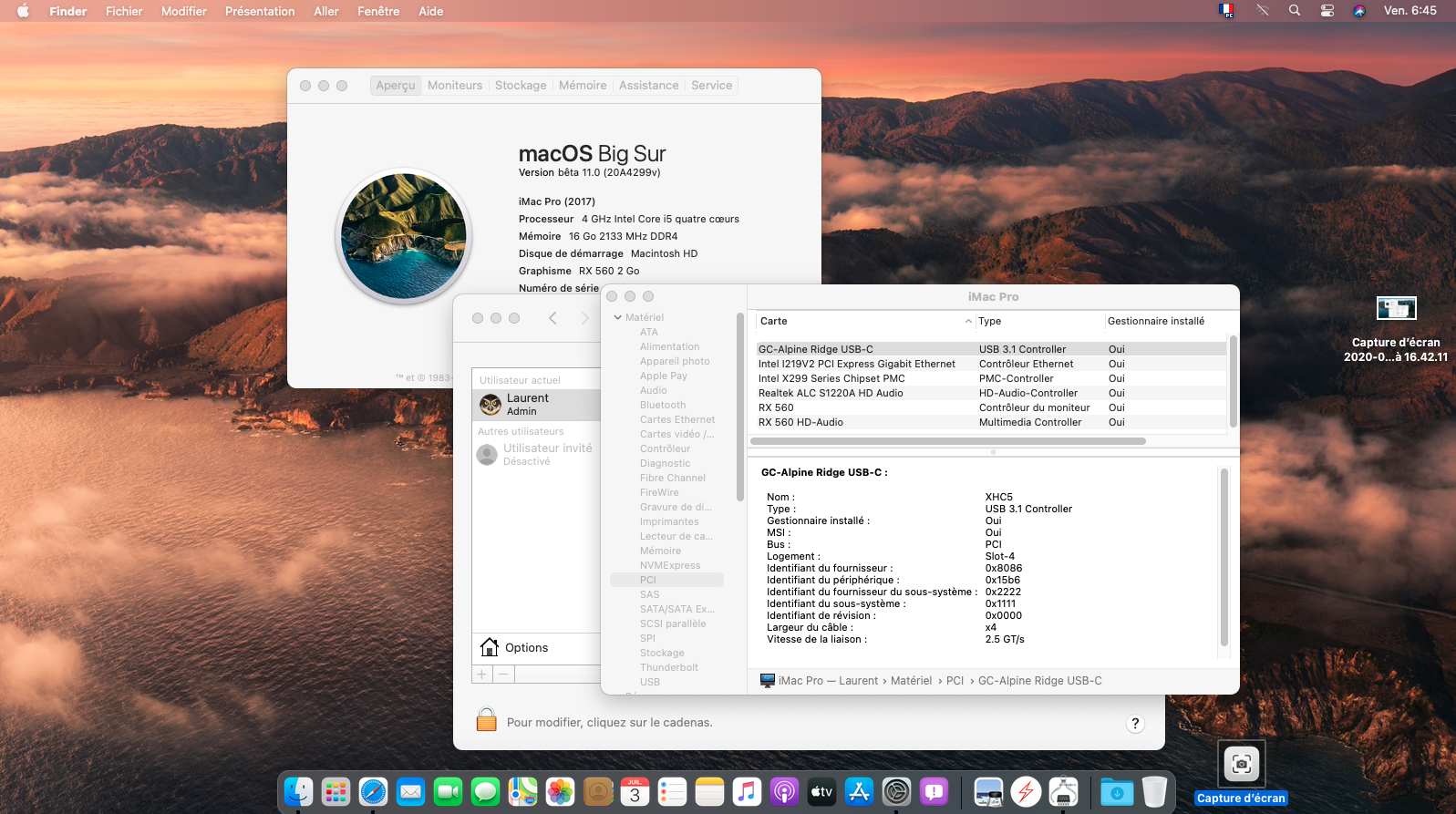

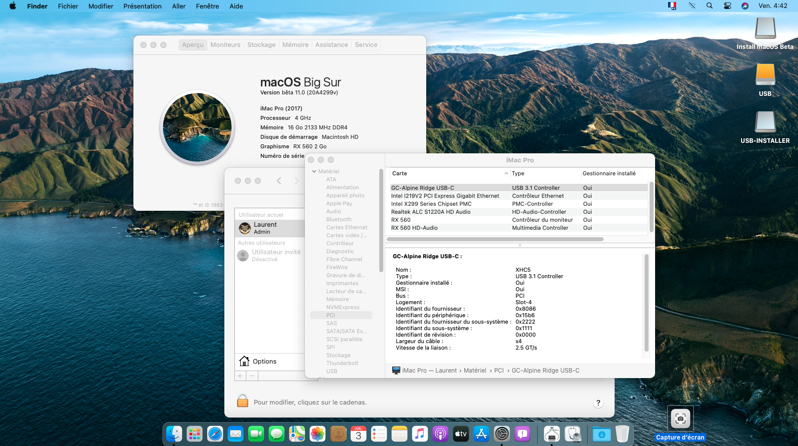

Loloflat6 Posted July 3, 2020 Share Posted July 3, 2020 (edited) First attempt on my test X299 build, installed BigSur from VMware Fusion. I use OC 0.6.0, not tested Clover+OcQuirks for now. BigSur seems very closed anyway... Thanks to @Ellybz for help with instructions getting OC to work. Edited July 3, 2020 by Loloflat6 2 Link to comment Share on other sites More sharing options...
