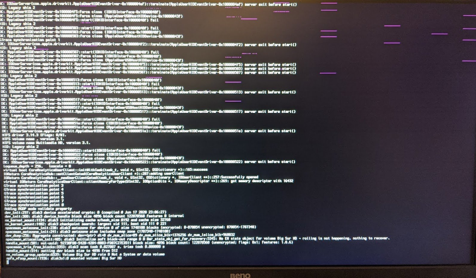

Gravarty Posted June 28, 2020 Share Posted June 28, 2020 (edited) Are there any problems with Whatevergreen+Lilu in Big Sur? I was able to install the OS directly on the SSD in a VM without any problems. With OpenCore it also seems to boot "problem-free" but unfortunately the GPU (Radeon RX 590) does not work properly. -lilubetaall is included as a bootarg. Those colored lines appear first and then blackscreen. I also uploaded my terrible configured OC config, i never used this bootloader before and just did some basic modifications. (ASUS STRIX Z270E Intel i7 7770k AMD Radeon RX 590) EFI.zip Edited June 28, 2020 by Gravarty Link to comment Share on other sites More sharing options...
Cyberdevs Posted June 28, 2020 Share Posted June 28, 2020 1 minute ago, Gravarty said: Are there any problems with Whatevergreen+Lilu in Big Sur? I was able to install the OS directly on the SSD in a VM without any problems. With OpenCore it also seems to boot "problem-free" but unfortunately the GPU (Radeon RX 590) does not work properly. -lilubetaall is included as a bootarg. Those colored lines appear first and then blackscreen. I also uploaded my terrible configured OC config, i never used this bootloader before and just did some basic modifications. I'm using iMac18,1 SMBIOS to avoid the black screen issue on my R9 270X GPU for now, the AGDP patches don't seem to work I guess. 1 Link to comment Share on other sites More sharing options...

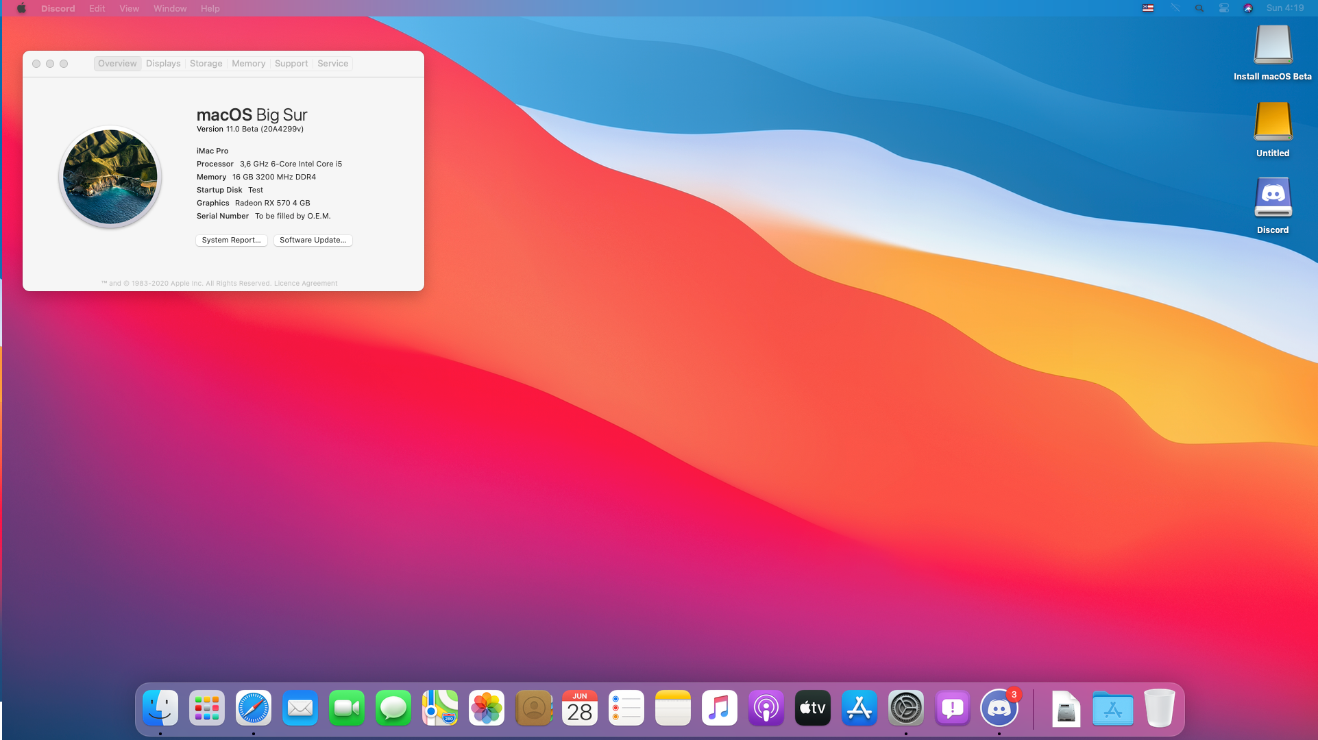

MattsCreative Posted June 28, 2020 Share Posted June 28, 2020 Ryzen 3600 MSI tomahawk B450 RX 570 2 Link to comment Share on other sites More sharing options...

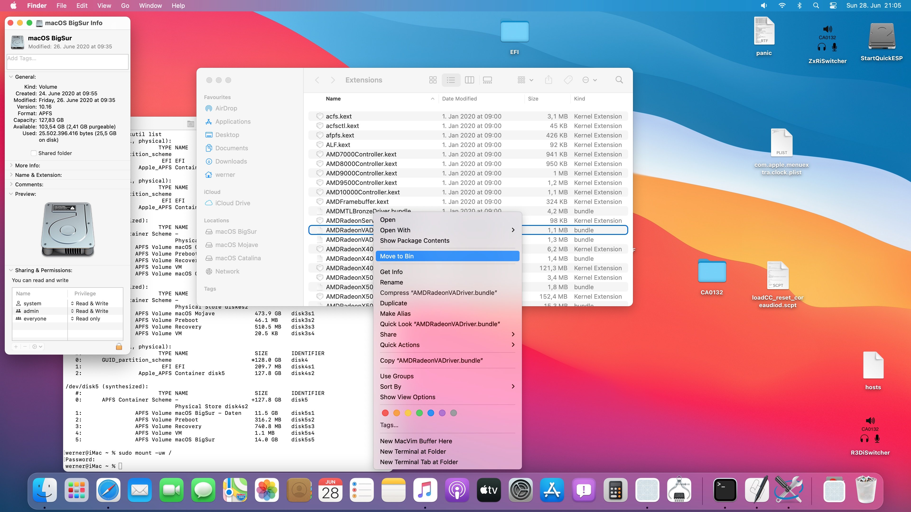

wern apfel Posted June 28, 2020 Share Posted June 28, 2020 After playing around, I can mount the drive without an error and delete kexts. I am not sure what helped, but will repeat any changes I made and let you know what helps. Link to comment Share on other sites More sharing options...

wern apfel Posted June 28, 2020 Share Posted June 28, 2020 4 minutes ago, luki1979 said: From my understanding system is loading from a snapshot, you don’t have access to system hence you can’t put the drive in read and write mode. Rebuilding cache won’t work, even if you manage to add something to system partition you won’t be able to boot as it won’t correspond to snapshot. Hence people boot from installation USB/ Recovery and use commands from there and building new bootable snapshot. Read what involved in simple kext replacing. https://medium.com/@andv/making-wifi-on-big-sur-unsupported-macs-with-failed-with-66-error-36c98e3f7965 Interesting, did you try to reboot? Yes , rebooted a couple of times, it still works. I will reinstall to see if my assumption is correct. I think it's the new APFS FS. kextcache also works kextcache -i / kextcache -arch x86_64 -local-root -all-loaded -kernel /System/Library/Kernels/kernel -prelinked-kernel /Library/Apple/System/Library/PrelinkedKernels/prelinkedkernel -volume-root / /Library/Extensions /AppleInternal/Library/Extensions /Library/Apple/System/Library/Extensions /System/Library/Extensions Can't read info dictionary for /Library/Apple/System/Library/Extensions/AppleMobileDevice.kext: IOCFUnserialize: syntax error near line 1. Can't read info dictionary for /Library/Apple/System/Library/Extensions/AppleMobileDevice.kext: IOCFUnserialize: syntax error near line 1. Can't read info dictionary for /Library/Apple/System/Library/Extensions/AppleMobileDevice.kext: IOCFUnserialize: syntax error near line 1. Can't read info dictionary for /Library/Apple/System/Library/Extensions/AppleMobileDevice.kext: IOCFUnserialize: syntax error near line 1. Can't read info dictionary for /Library/Apple/System/Library/Extensions/AppleMobileDevice.kext: IOCFUnserialize: syntax error near line 1. KernelCache ID: 35C54583567155D1C30E7D0CF0930038 symlink("../../../PrelinkedKernels/prelinkedkernel", "/Library/Apple/System/Library/Caches/com.apple.kext.caches/Startup/kernelcache") failed 2 (No such file or directory) Can't read info dictionary for /Library/Apple/System/Library/Extensions/AppleMobileDevice.kext: IOCFUnserialize: syntax error near line 1. Can't read info dictionary for /Library/Apple/System/Library/Extensions/AppleMobileDevice.kext: IOCFUnserialize: syntax error near line 1. Can't read info dictionary for /Library/Apple/System/Library/Extensions/AppleMobileDevice.kext: IOCFUnserialize: syntax error near line 1. Can't read info dictionary for /Library/Apple/System/Library/Extensions/AppleMobileDevice.kext: IOCFUnserialize: syntax error near line 1. Can't read info dictionary for /Library/Apple/System/Library/Extensions/AppleMobileDevice.kext: IOCFUnserialize: syntax error near line 1. Link to comment Share on other sites More sharing options...
luki1979 Posted June 28, 2020 Share Posted June 28, 2020 (edited) @wern apfelSo it’s the kextcache of prelinked kernel that OpenCore can access. It’s all different than before. More studying needed can you post your diskutil list tree? I wonder if you have a snapshot there? Edited June 28, 2020 by luki1979 Link to comment Share on other sites More sharing options...

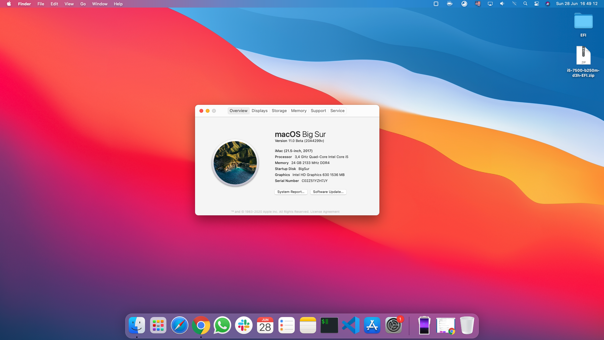

+ira Posted June 28, 2020 Share Posted June 28, 2020 (edited) Hi everyone, Finally got a "vanilla" macOS Big Sur running here, no VM, no real Mac install, no pre-build image. I'll try my best to describe the processes: Build: i5 7500 Gigabyte B250M-D3H Prep: I was running the latest Catalina version. Enrolled to beta channel. Downloaded the 10.16 update. First time it got corrupted and the download finished 80% of the way. Downloaded it again. I tried the createinstallmedia method on a 8GB thumb drive but it would not finish due to the size of the installation being ~10GB. So I created a 16GB partition on a spare SSD that I have with High Sierra and ran the createinstallmedia on it. I was a long time Clover user, so I had to port my setup to OpenCore. I thoroughly followed the dortania OpenCore Desktop guide https://dortania.github.io/OpenCore-Desktop-Guide/ for my CPU family I didn't use anything from my previous Clover setup except for the SMBIOS information which I ended up generating a new one in later attemps. This is my current EFI: i5-7500-b250m-d3h-EFI.zip Installation: I tried the Install macOS Beta first, it would always give me a black screen but I could see it was doing something either by hearing fan noise or the LED indicator, eventually I would reboot whenever it stop doing whatever it was doing just to find out I didn't Install anything, then I moved on to the install media method. The install media would lead to a black screen but I found out that if I change sources on my monitor back and forth it would display something eventually in some stages in others it would be just black but I went on whenever I saw activity hoping it was doing something, and it was. I booted into High Sierra dozen of times between stages until I saw it was not going any further and most of the time it would lead to a pink screen with the Apple logo and a stationary progress bar. So I did the prelinked kernel on Preboot volume method which you guys (can't remember who, thank you anyway) brought to us from MacRumors on another post and I was pretty sure this was the last attempt. Tried to boot again. Nothing. Then I came to the forum and downloaded the EFI posted by @Bios-PC here. (much thanks) I copied most of the quirks and kexts but kept the specifics of my system. And...... It booted! The screen would go black and I had to use the switch sources method but eventually it went ahead and finished installing the system. I hope you guys find this post useful. I'm sorry for not being able to pinpoint exactly what was needed to make it work, hopefully the OpenCore\Clover devs can workaround this soon. Some photos from installation: Edited June 28, 2020 by +ira 6 1 Link to comment Share on other sites More sharing options...

notsnsone Posted June 28, 2020 Share Posted June 28, 2020 On 6/28/2020 at 9:43 PM, Gravarty said: Are there any problems with Whatevergreen+Lilu in Big Sur? I was able to install the OS directly on the SSD in a VM without any problems. With OpenCore it also seems to boot "problem-free" but unfortunately the GPU (Radeon RX 590) does not work properly. -lilubetaall is included as a bootarg. Those colored lines appear first and then blackscreen. I also uploaded my terrible configured OC config, i never used this bootloader before and just did some basic modifications. (ASUS STRIX Z270E Intel i7 7770k AMD Radeon RX 590) EFI.zip use latest nightlies of OC (use OC compare to make sure you are using a correct config.plist), lilu, weg, vsmc Link to comment Share on other sites More sharing options...
