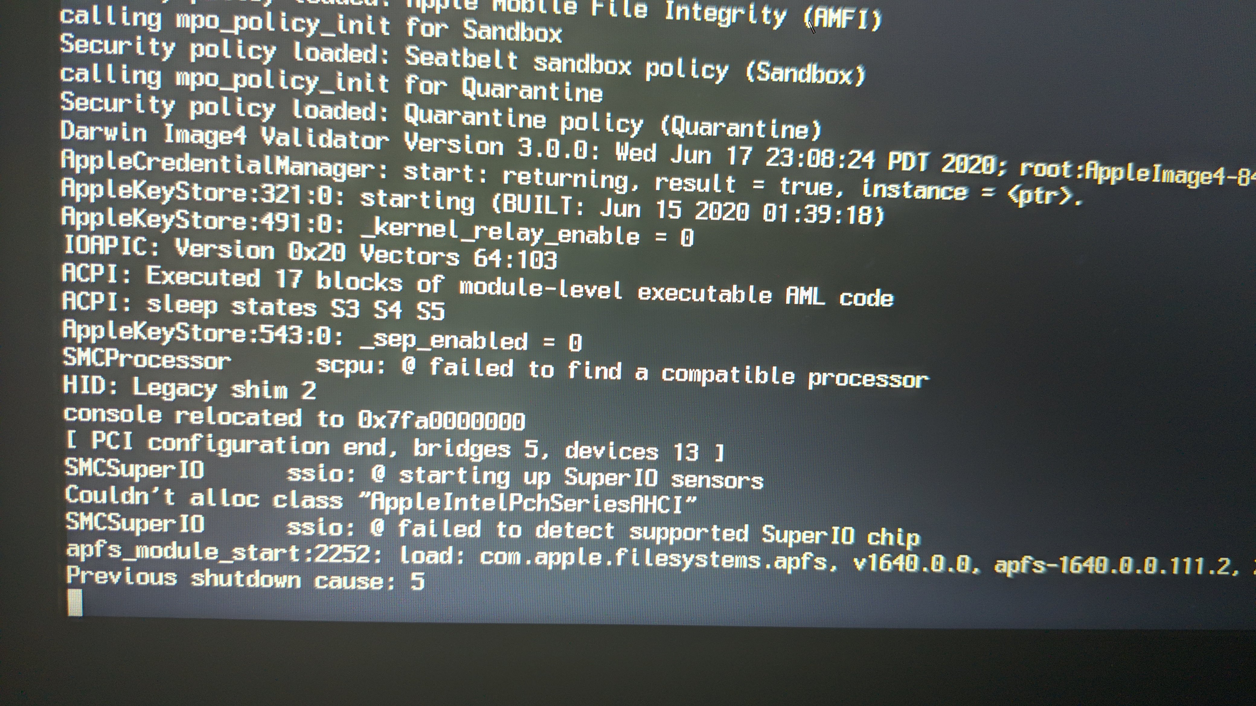

Ivan999 Posted June 28, 2020 Share Posted June 28, 2020 How to fix Couldn't alloc class "AppleIntelPchSeriesAHCI"? EFI(2).zip Link to comment Share on other sites More sharing options...

kushwavez Posted June 28, 2020 Share Posted June 28, 2020 (edited) 13 minutes ago, Ivan999 said: How to fix Couldn't alloc class "AppleIntelPchSeriesAHCI"? EFI(2).zip You forgot to add EC rename patches use either SSDT-EC-USBX.aml or rename via config.plist, I had exactly the same problem. Edited June 28, 2020 by kushwavez 1 Link to comment Share on other sites More sharing options...

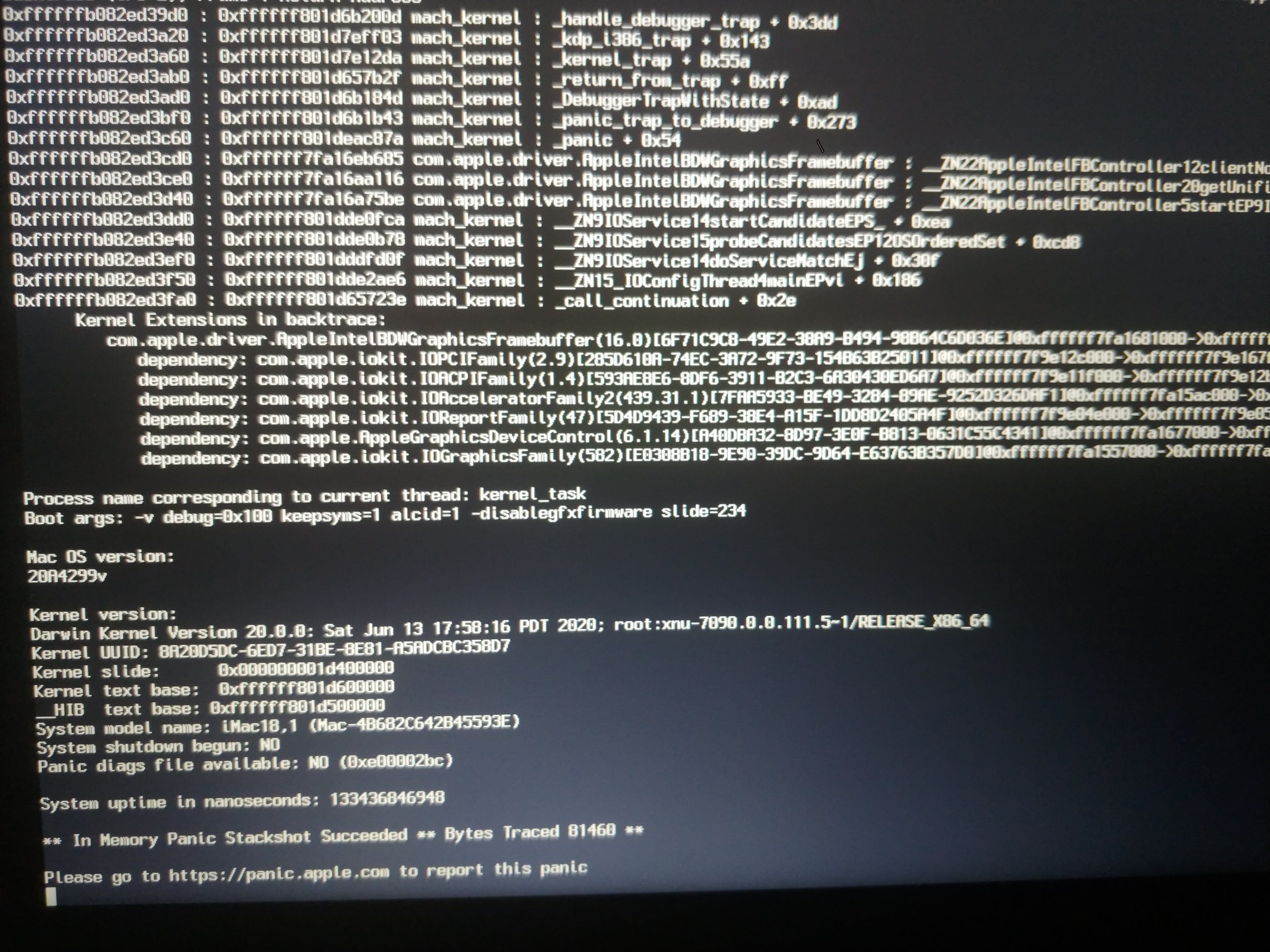

Ivan999 Posted June 28, 2020 Share Posted June 28, 2020 29 minutes ago, kushwavez said: You forgot to add EC rename patches use either SSDT-EC-USBX.aml or rename via config.plist, I had exactly the same problem. Thanks! Renamed EC0 to EC solved this issue But now Im stuck here 1 Link to comment Share on other sites More sharing options...
junologue Posted June 28, 2020 Share Posted June 28, 2020 On 6/28/2020 at 5:06 PM, Ivan999 said: Thanks! Renamed EC0 to EC solved this issue But now Im stuck here Me 2, on my x299 hack. Feels like it’s one last tweak from booting. Link to comment Share on other sites More sharing options...

kushwavez Posted June 28, 2020 Share Posted June 28, 2020 On 6/28/2020 at 4:44 PM, The Tech said: Any idea why the AirportBrcmFixup isn't working? Hmm. no idea. It's loaded for me according to kextstat, but does nothing. BCM94360HMB showed as "Third Party Wireless card", but Airdrop and other features working just fine without AirportBrcmFixup, so I deleted it. On Catalina the card showing up as AirPortExtreme Card with BrcmFixup. On 6/28/2020 at 4:50 PM, tore2003 said: I’m wondering about that too According to @CMMChris progress has been made and it's clearly possible. I think the release will be here soon to support clean install procedure with Clover and OpenCore too. On 6/28/2020 at 5:06 PM, Ivan999 said: Thanks! Renamed EC0 to EC solved this issue But now Im stuck here Looks like a Graphics error, maybe a misconfiguration, you're using iGPU aren't you? edit: I'm dumb af, you're clearly using Broadwell graphics. Link to comment Share on other sites More sharing options...

Ivan999 Posted June 28, 2020 Share Posted June 28, 2020 Just now, kushwavez said: Hmm. no idea. It's loaded for me according to kextstat, but does nothing. BCM94360HMB showed as "Third Party Wireless card", but Airdrop and other features working just fine without AirportBrcmFixup, so I deleted it. On Catalina the card showing up as AirPortExtreme Card with BrcmFixup. According to @CMMChris progress has been made and it's clearly possible. I the release will be here soon to support clean install procedure with Clover and OpenCore too. Looks like a Graphics error, maybe a misconfiguration, you're using iGPU aren't you? Yeah I'm using IGPU What can I do to fix this? Link to comment Share on other sites More sharing options...
