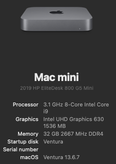

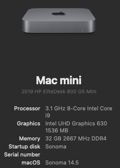

macOS upgrades to Ventura 13.6.7 and Sonoma 14.5 proceeded without issues using the new Open Core 1.0.0 EFI attached to Post #1.  Before upgrading Sonoma from 14.4.1 to 14.5, I set OpenCore's SecureBootModel = Disabled.  After the Sonoma upgrade, I restored SecureBootModel to j174.
About This Hack: Ventura 13.6.7

About This Hack: Sonoma 14.5

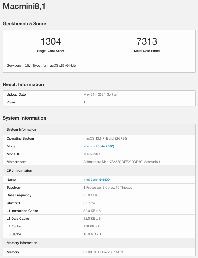

I conducted performance tests of my "new" toy here.  The graphics performance of the Radeon RX560x (the Mobile version of RX560) is impressive.  For those who are still considering the purchase of a G4 Mini vs. a G5 Mini and you are looking for the best bang for your buck, I would recommend the G4 Mini and an upgraded power supply.  When you pair the G4 Mini with a higher wattage power supply (e.g., 150W), you'll get a CPU performance bump.  HP implemented power supply sensing in the G4 Mini to increase PL2 power limit with increasing power supply wattage.  HP does not implement adaptive power limits in the G5 Mini.  I have tested my G5 Mini / i9-9900 with 90W, 150W and 230W power supplies and the GB5 CPU benchmarks remain unchanged.
EDIT: Remember that to maximize performance of these Mini's you need to populate both memory slots with equivalent SODIMMs.
HP EliteDesk 800 G5 Mini 65W i9-9900 GB5 CPU Benchmark
Spoiler
EDIT2: You'll need to test your own hack to measure performance, since ambient room temps, proper application of thermal paste and copper vs. aluminum heatsink will affect your CPU performance.  Also, I can't guarantee that HP continues to implement dynamic power limits if they release new BIOS versions.

As much as I like the 9th gen Intel, I must admit that the new i3s (4c/8t) for around $100 gives way better results in single-core and similar results in multi-core tasks.
Posted (edited)
By "new i3s" do you mean generations later than 9th gen (so something other than an EliteDesk 800 G4 or G5 Mini)?
Edited by deeveedee
Yes, 12th gen and newer. I had 9900 for a while and the performance of my i3 12100F is just better. System is snappier and feels faster. Not that this will make i9 9900 bad CPU, just remember my excitement to play with i9 9900 thinking this is a beast of a CPU.
Good to know that Intel is getting better.  They are getting their butts kicked by the competition.
