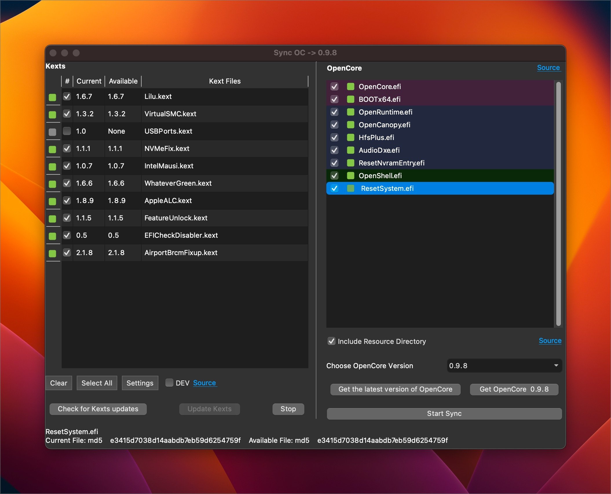

I did upgrade my HP EliteDesk 800 G5 Mini EFI to OC 0.9.7 because of some other development I'm doing.  As expected, I don't observe any differences between 0.9.6 and 0.9.7 on this HackMini8,1.  The upgrade was easy, since there are no config.plist changes.  I don't have time to post the updated EFI, but it is easy to upgrade for those who are interested:
  1. Start with your OC 0.9.6 EFI
  2. Upgrade OC binaries (Boot/Bootx64.efi, OC/OpenCore.efi, OC/Drivers/*.*, OC/Tools/*.*)
  3. Upgrade OC/Kexts/AppleALC.kext version 1.8.7 -> version 1.8.8

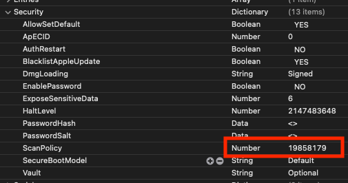

Hi, Thanks! You were right I had the wrong brand of nvme. My Linux partitions were on a Micron 2200 and thats why I got the kernel crash. I just cloned them to a Kingston nvme and problem is gone. About the multiboot within OC. I have multiboot running on all my other computers. There was never a real problem on the others so I did not expect it to not work. But obviously I missed something this time. Usually one of the ways use to work in the link you gave.
Update: I forgot to put ScanPolicy to 0. It all works now.

Someone else PM'd me to say that the USB installer they created using my posted EFI does not see the USB installer.  I thought that I had fixed this here.  I am testing again to see if I can duplicate the problem.  For now, if you are having this problem, change ScanPolicy in OC config.plist to 0.
OC config.plist: Misc > Security > ScanPolicy
Spoiler
EDIT: I am unable to duplicate the USB installer problems that two users have reported to me via PM.  To test, I created a Sonoma USB installer and copied my EXACT EFI from Post #1 to my USB installer EFI.  I added my personal PlatformInfo to the OC config.plist.  The newly created USB installer works perfectly (for me) with the posted EFI.
