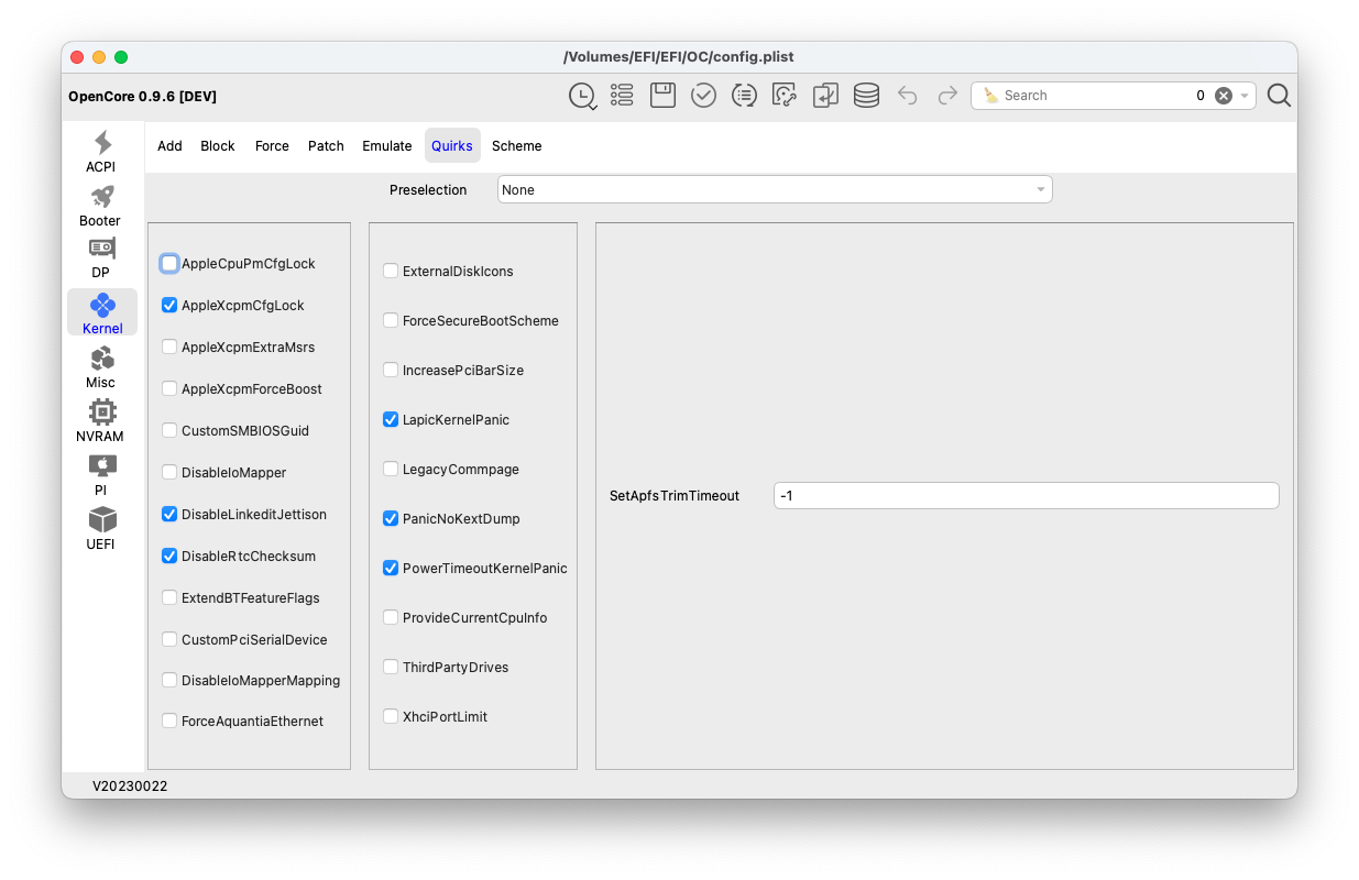

Have you tested Sonoma 14.2 Beta yet?  If so, are you able to boot and run Sonoma 14.2 with VT-d enabled in BIOS and 'Kernel > Quirks > DisableIoMapper = False" in OC config.plist?
EDIT: I don't use Wi-Fi/Bluetooth in my HackMini8,1 and am hoping that others who have Wi-Fi/Bluetooth in their EliteDesk 800 G4/G5 Mini can test and determine whether DMAR table needs to be modified for Sonoma 14.2.  To test, enable VT-d in BIOS, set 'Kernel > Quirks > DisableIoMapper = False" in OC config.plist and boot/run Sonoma 14.2 Beta without modifying DMAR table.

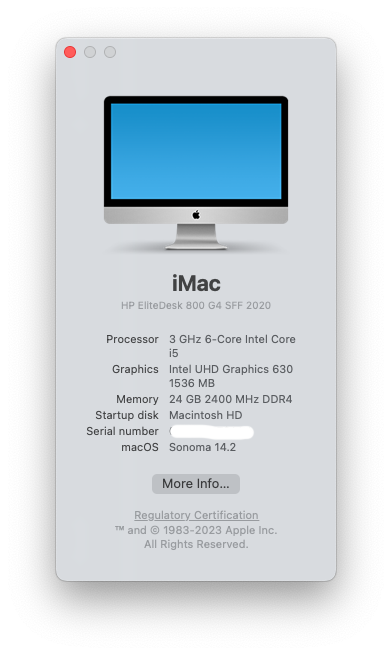

@hiphopboy Your "About This Mac" indicates "800 G4 SFF" which is different from the EliteDesk 800 G4/G5 Mini documented in this thread.  Are you testing Sonoma 14.2 on an EliteDesk SFF or an EliteDesk Mini?
EDIT: Also, are you testing with Wi-Fi and if so, which Wi-Fi card are you using?
Edited by deeveedee

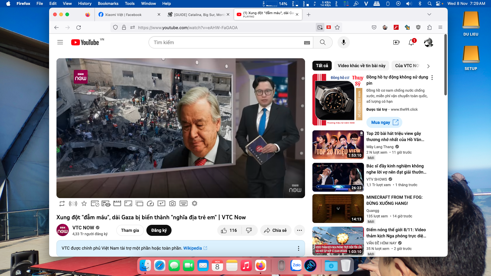

31 minutes ago, ThExSenatoR said:
Im having high cpu utilization under Monterey while watching YouTube videós under Firefox, anyone else experiening this too? Cpu load between 80-120%, very annoying :(
Using EFI from first post, only mod is that I have DP audio enabled.
Does CPU utilization drop if you disable DP audio?

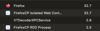

EDIT: I performed a quick YouTube video test with Firefox.
YouTube CPU utillzation as reported by Activity Monitor (Firefox 116.0.2, Monterey 12.6.3, OC 0.9.4 EFI, AppleALC.kext 1.8.3):

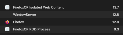

YouTube CPU utillzation as reported by Activity Monitor (Firefox 119.0., Sonoma 14.2 Beta (23C5030f), OC 0.9.4 EFI, AppleALC.kext 1.8.3):

@ThExSenatoR Can you upgrade AppleALC.kext to 1.8.7 and try again?  I just booted Sonoma 14.2 Beta with OC 0.9.6 EFI and AppleALC.kext 1.8.7.  It appears to me that Firefox CPU utils have dropped when viewing Youtube with Firefox 119.
YouTube CPU utillzation as reported by Activity Monitor (Firefox 119.0., Sonoma 14.2 Beta (23C5030f), OC 0.9.6 EFI, AppleALC.kext 1.8.7):

I have attached an updated EFI to Post #1 based on Open Core 0.9.6.  This new EFI modifies the ACPI DMAR table as explained in the change log below, so users of this EFI should enable VT-d in BIOS.  I have tested this EFI with Ventura and Sonoma.  The change log below includes changes for OC 0.9.4 and OC 0.9.6 since I never posted my OC 0.9.4 EFI.
Changes for OC 0.9.6 EFI
  • EFI/BOOT: Update BOOTx64.efi
  • EFI/OC: Update OpenCore.efi
  • EFI/OC/Drivers: Update OpenRuntime.efi, AudioDxe.efi, ResetNvramEntry.efi
  • EFI/OC/Kexts:
    • Upgrade AppleALC.kext 1.8.4 -> 1.8.7
    • Upgrade RestrictEvents.kext 1.1.2 -> 1.1.3
  • EFI/OC/config.plist
    • Add Booter > Quirks > FixupAppleEfiImages (Boolean, False)
    • Add UEFI > Quirks > ShimRetainProtocol (Boolean, False)
  • EFI/OC/Tools: Update tools
Changes for OC 0.9.4 EFI
    • ACPI > Add: Added DMAR
    • ACPI > Delete: Dropped system DMAR
    • Kernel > Quirks > DisableIoMapper = False
  • EFI/OC/ACPI
    • Add DMAR.aml (removed all Reserved Regions except Graphics Reserved Region - same as Real MM8,1)

no, i'm not
@hiphopboy That screenshot confirms it.  Thanks!
I'm going to assume that you continue to post HP EliteDesk 800 G4 SFF test results in this EliteDesk Mini thread.  You're welcome to do what you like, but if they are SFF test results, they are not relevant to this thread.
