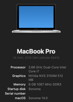

For those who wish to change their "About This Mac" description in Sonoma, the procedure for changing this is the same as what I posted for Ventura here.
I haven't installed Sonoma yet on this HackMini8,1, but I have confirmed the system description change on my HackBookPro6,2:
About This Hack: Sonoma
  Reveal hidden contents
Still change normal on Sonoma

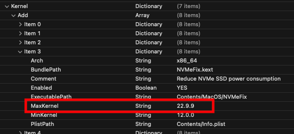

It doesn't look like NVMeFix.kext will support Sonoma (see comment here).  I'm not sure yet, but it might be necessary to add MaxKernel limit for NVMeFix.kext in our OC config.plist so that NVMeFix.kext does not load for macOS versions after Ventura (maxKernel limit would be 22.99.99).  This may be a temporary change if Acidanthera gets developer help with this kext.
EDIT: The OC 0.9.3 Sample.plist includes the MaxKernel limit for NVMeFix.kext (and the AirportBrcm kexts).  I'm going to interpret this as a recommendation and will include the MaxKernel limit for NVMeFix.kext in my OC 0.9.3 EFI.

    • Kernel > Add > NVMeFix.kext (Item 3): MaxKernel = 22.9.9 (Ventura)
    • Add UEFI > Output > ConsoleFont (String, Empty)
    • Add UEFI > ProtocolOverrides > PciIo (Boolean, False)
  • EFI/OC/Tools: Update tools
Note that the sample USB Ports kexts are now in EFI/OC/Kexts/SampleUsbPorts folder.  If you need Bluetooth or you want to make any changes to the USB Port Map, read these instructions.  My EFI includes a default USBPorts.kext mapping that does NOT enable the Bluetooth USB port (HS14).
At the time of this post, NVMeFix.kext does not work in Sonoma, so the config.plist in this new EFI sets a MaxKernel limit of 22.9.9 (Ventura) on NVMeFix.kext.  NVMeFix.kext will not be loaded if you run macOS versions newer than Ventura.  This may change in the future if Acidanthera fixes NVMeFix.kext compatibility with newer versions of macOS.

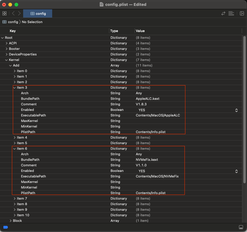

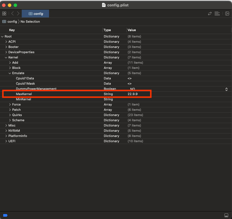

2 hours ago, luky35 said:
@deeveedee It is correctly added to OC config.plist MaxKernel=22.9.9.
  Hide contents
No its not correct @deeveedee is talking about Kernel | Add | Section for NvmeFix.kext | Max kernel 22.9.9
@luky35 You know how to find this.  You're not giving yourself enough credit.  Read the detailed explanation of changes that I provided here and then view the config.plist in the OC EFI that I have attached to Post #1.
NVMeFix.kext: MaxKernel
Spoiler
@luky35 ???
NVMeFix.kext is referenced in "Kernel > Add > Item 3" in the config.plist in MY EFI that I have attached to Post #1.  You are not using my EFI.  NVMeFix.kext is referenced in "Kernel > Add > Item 6" in YOUR EFI.  Take some time to review the Kernel > Add items in the OC config.plist so that you understand how they are numbered.  It's easy after you study it for a few minutes.

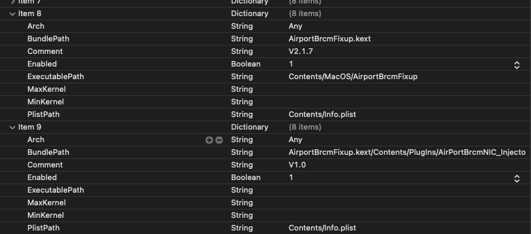

EDIT: We're only changing the MaxKernel value for NVMeFix.kext - not AppleALC.kext.  If you have any AirportBrcm kexts, then you'll need to specify MaxKernel for the AirportBrcm kexts until Broadcom Wi-Fi is fixed in Sonoma.  If you are not using the EFI (and the config.plist) that I provide, then it is up to you to map my suggested changes to your EFI.  Doing this requires you to understand the EFI and how to edit your config.plist.
Edited by deeveedee

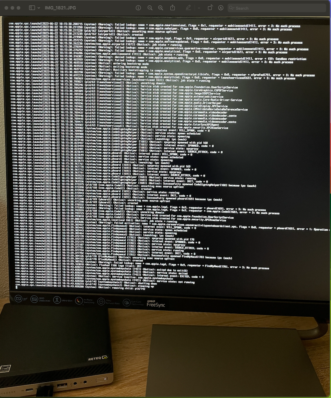

3 hours ago, deeveedee said:
@luky35 Read this.  Now, what is wrong with your config.plist?
Hint
Removed AirportBrcmFixup.kext and Sonoma install goes normally.
Thank you very much for the tip.
P.S.
When restarting, everything stops and does not go anywhere.
Unfortunately, the installation failed.
Edited by luky35
