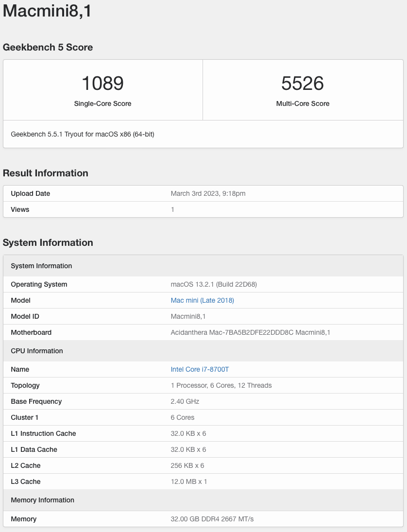

Just for reference, this is what I got from my i7-8700T with 150W PSU before I installed the RX 560:
Thanks for confirming that G4 models don't boot with 9th gen CPU.  Saved me some time from swapping components.

EDIT: @pastrychef your GB benchmark for a "T" CPU are impressive.  Here are my GB5 scores for a G4/i5-8600 with 150W adapter.  Also see this for a comparison to i9-9900.
Edited by deeveedee
1 hour ago, deeveedee said:
Does your G3 sleep/wake?  Do you mind posting your G3 EFI?

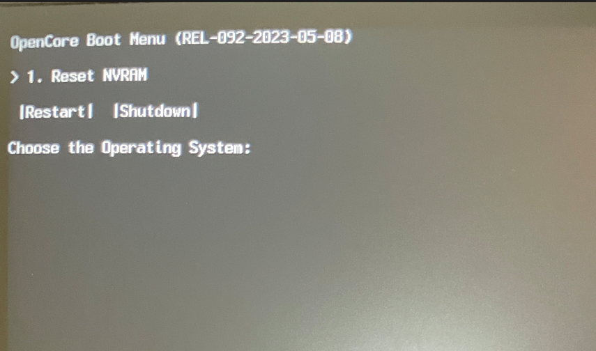

Please help!
I want to install macOS Ventura and I can't see anything but Reset NVRAM in the start menu.
I'm currently on Windows 11 and going back to macOS.
Thank you and best regards,
