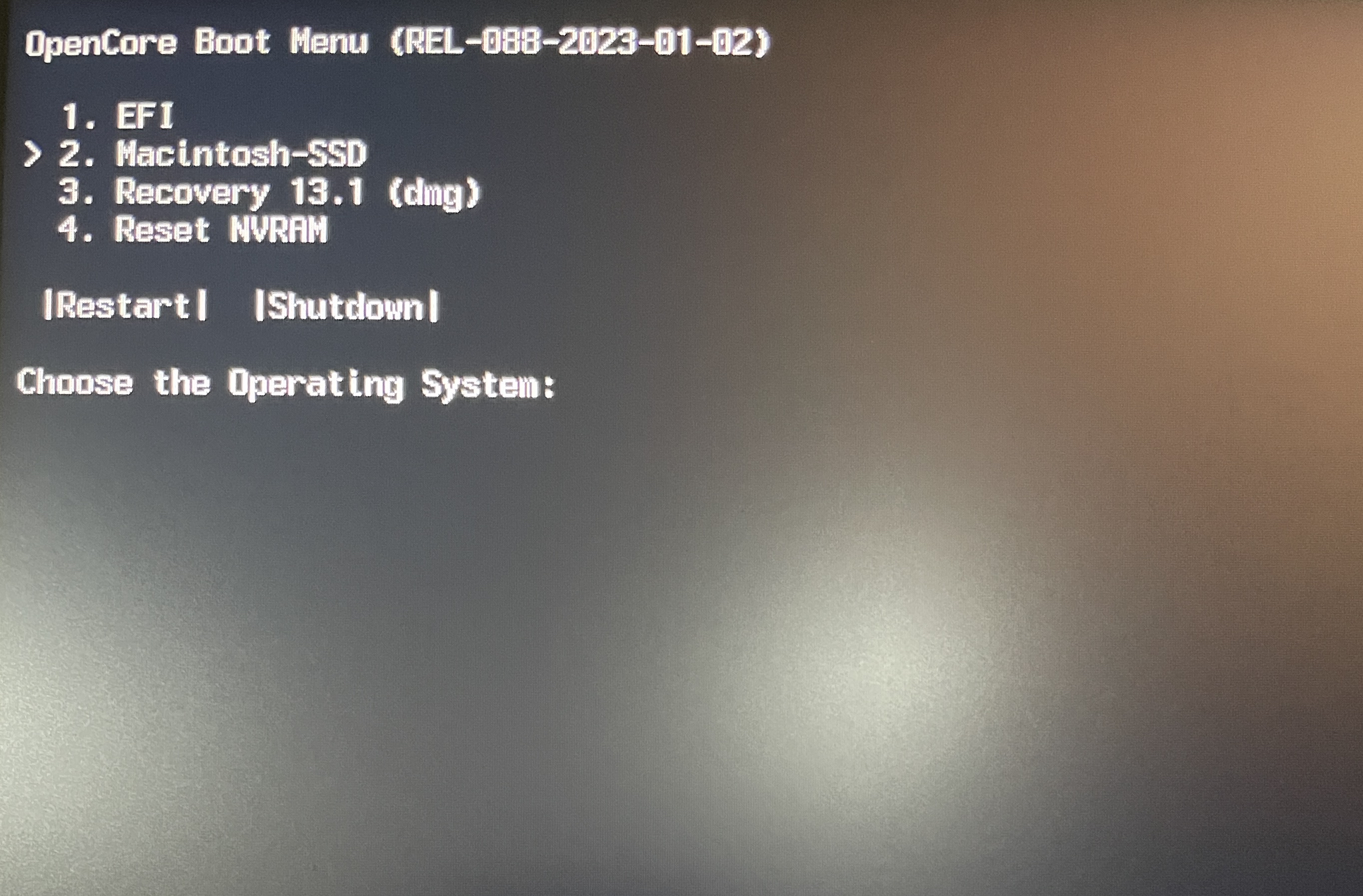

I installed the new OC0.8.8-EFI-R001 and now I have EFI in the 1st place in the Boot menu.
How to remove this because I have not had this until now.
BT also stopped working for me.
I am attaching a picture and an EFI folder.
Im asking for help.
Thank you
EFI.zip
40 minutes ago, antuneddu said:
You need to copy the .contenVisibility file inside the Boot folder ( enable the option to show hidden files )
or completely replace the BOOT folder the file is already inside
@antuneddu
Thanks for the help.
I replaced BOOT with your folder that you attached and the Boot menu is now OK. It is no longer in the EFI menu.
Bluetooth OK.
Edited by luky35
@luky35 Thank you for finding the issue and @antuneddu thank you for the quick response and fix.  I have updated the EFI attached to Post #1 to include the BOOT/.contentVisiblity file with "Disabled"
The new EFI is OC0.8.8-EFI-R002.
@luky35 - I guess you figured out that your USBPorts.kext needed to be changed for working Bluetooth.  The EFI you posted included a USBPorts.kext that did not enable port HS14.
Edited by deeveedee

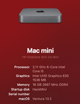

@luky35 Are you referring to the background color?  If so, this may vary since the background of the "About This Mac" is semi-transparent.  Try this: Open "About This Mac" and move it around on your desktop.  Note the color change as a result of transparency.
