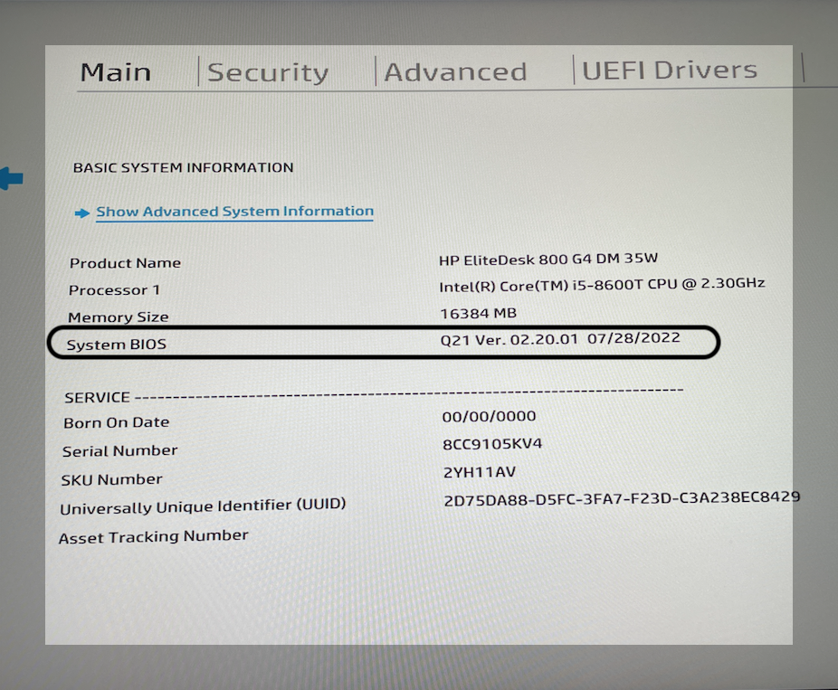

luky35 Posted August 26, 2022 Share Posted August 26, 2022 @deeveedee, Bios does not show me the new version 02.20.01 Rev.A August 15, 2022. I can only see the latest version 02.19 .00 Rev.A. Link to comment Share on other sites More sharing options...
deeveedee Posted August 26, 2022 Author Share Posted August 26, 2022 @luky35 We have enough history/experience with installing macOS on this EliteDesk 800 G4/G5 Mini, that you should be able to find issues documented in the Known Issues here. Whenever you have a problem, it's good to start by reviewing the Known Issues. Take a look at the sixth issue to see if that helps you. Link to comment Share on other sites More sharing options...
luky35 Posted August 26, 2022 Share Posted August 26, 2022 @deeveedee I expected such an answer from you. Are you trying to convince me that I have a Bios update on my EliteDesk 800 G4? I don't have it. 1 Link to comment Share on other sites More sharing options...
CloverLeaf Posted August 26, 2022 Share Posted August 26, 2022 @deeveedee - I did the update earlier using usb recovery method. Update went pretty fast, no problems found. Both Monterey 12.5.1 and Ventura Beta 6 boots and operates normally. No differences in performance at the moment. Further testing is on the way. Thank you. 1 Link to comment Share on other sites More sharing options...
luky35 Posted August 26, 2022 Share Posted August 26, 2022 @deeveedee Just for info. Spoiler Link to comment Share on other sites More sharing options...

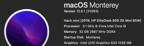

deeveedee Posted September 2, 2022 Author Share Posted September 2, 2022 (edited) After upgrading to Monterey 12.5.1, my HackMini8,1 (EliteDesk 800 G5 Mini, i9-9900, 32GB DDR4, WD SN750 Black NVMe SSD) seems much more responsive. I haven't performed any tests to quantify this performance improvement. Has anyone else noticed that their hack's performance is better with 12.5.1? About This Mac Spoiler Edited September 2, 2022 by deeveedee Link to comment Share on other sites More sharing options...
CloverLeaf Posted September 2, 2022 Share Posted September 2, 2022 I see no difference with mine. It's just flying. I love it! Works great in Ventura also. I'm using both systems as a daily drivers. 1 Link to comment Share on other sites More sharing options...
deeveedee Posted September 2, 2022 Author Share Posted September 2, 2022 @Jazzoo Must be an illusion. It is flying! 1 Link to comment Share on other sites More sharing options...
