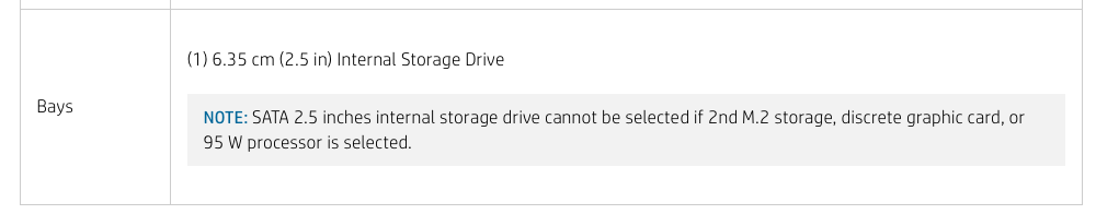

deeveedee Posted August 4, 2022 Author Share Posted August 4, 2022 (edited) I just noticed that HP has updated their EliteDesk 800 G5 Mini specs page to indicate that the SATA drive caddy is not available if a second M.2 storage device is installed. I'm not sure when this page was updated, but when I purchased my Mini, this storage limitation wasn't clear. If you want to install 2 x M.2 storage devices and still use your SATA caddy (for a total of 3 storage devices like I have), follow my instructions here. I have made this mod to 4 Minis now and they all work perfectly with two NVMe drives and a SATA HD. HP's updated storage specs Spoiler Edited August 4, 2022 by deeveedee 1 Link to comment Share on other sites More sharing options...
rafale77 Posted August 4, 2022 Share Posted August 4, 2022 @deeveedee, you should patent your innovation and sell it back to them. 😉 It's a limitation they likely overlooked and can be pretty significant for potential customers of these units. 2 1 Link to comment Share on other sites More sharing options...

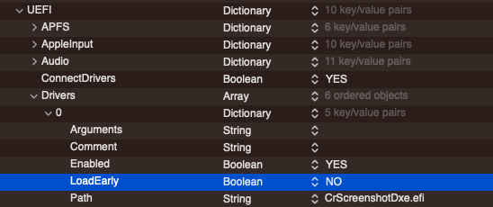

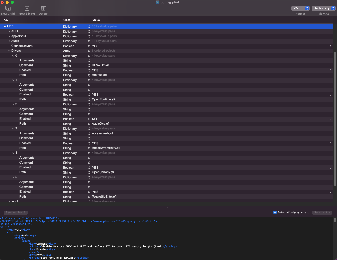

luky35 Posted August 5, 2022 Share Posted August 5, 2022 @deeveedee hi, Why doesn't PlistEdit pro show me the LoadEarly option? Spoiler Link to comment Share on other sites More sharing options...
deeveedee Posted August 5, 2022 Author Share Posted August 5, 2022 @luky35 If you use PlistEdit Pro to open the sample config.plist from the EFI that I have provided in Post #1, can you see the LoadEarly property in each UEFI > Driver? Link to comment Share on other sites More sharing options...
Anto65 Posted August 5, 2022 Share Posted August 5, 2022 Enter it manually copy the key from sample.plist for example 🤷♂️ PlistEdit pro does not automatically add or remove keys you have to edit them yourself Link to comment Share on other sites More sharing options...
luky35 Posted August 5, 2022 Share Posted August 5, 2022 58 minutes ago, deeveedee said: @luky35 If you use PlistEdit Pro to open the sample config.plist from the EFI that I have provided in Post #1, can you see the LoadEarly property in each UEFI > Driver? Yes I see all the LoadEarly property in every UEFI (Drivers). I use your EFI in Monterey. I only added OpenCanopy.efi and icons to Resources. PlistEdit Pro does not show me the LoadEarly option now. Apple's XCode doesn't show me LoadEarly either. I don't know why. But now I'm wondering if I have to add it manually as it is in your original EFI. Link to comment Share on other sites More sharing options...
deeveedee Posted August 5, 2022 Author Share Posted August 5, 2022 (edited) @luky35 If you started with my config.plist that I provide in the EFI attached to Post #1 (which includes LoadEarly) and you later determined that LoadEarly has been removed from the same config.plist, then you either deleted the LoadEarly property (unlikely) or the LoadEarly property was deleted by a tool that you used (possibly an older version of OCAT?). I would suggest that you start over with the EFI / config.plist that I have provided in Post #1 and carefully customize the EFI for your own rig. I can only guess at the reasons why LoadEarly has been deleted and don't want to spend time debugging configurator tools in this thread. If you think there is a problem with configurator tools that you use to edit your config.plist, please post those issues in the appropriate thread. Thank you. EDIT: If you think that you have found bugs in OCAT or there is something about OCAT that you find confusing, you can post your OCAT issues here. Edited August 5, 2022 by deeveedee 1 Link to comment Share on other sites More sharing options...
luky35 Posted August 5, 2022 Share Posted August 5, 2022 9 minutes ago, deeveedee said: @luky35 If you started with my config.plist that I provide in the EFI attached to Post #1 (which includes LoadEarly) and you later determined that LoadEarly has been removed from the same config.plist, then you either deleted the LoadEarly property (unlikely) or the LoadEarly property was deleted by a tool that you used (possibly an older version of OCAT?). I would suggest that you start over with the EFI / config.plist that I have provided in Post #1 and carefully customize the EFI for your own rig. I can only guess at the reasons why LoadEarly has been deleted and don't want to spend time debugging configurator tools in this thread. If you think there is a problem with configurator tools that you use to edit your config.plist, please post those issues in the appropriate thread. Thank you. EDIT: If you think that you have found bugs in OCAT or there is something about OCAT that you find confusing, you can post your OCAT issues here. @deeveedee I found that OCAT wiped out certain settings in my config.plist so I won't be using it again. I'm re-editing your EFI now, it's working great. Thank you for your help and advice. 1 Link to comment Share on other sites More sharing options...

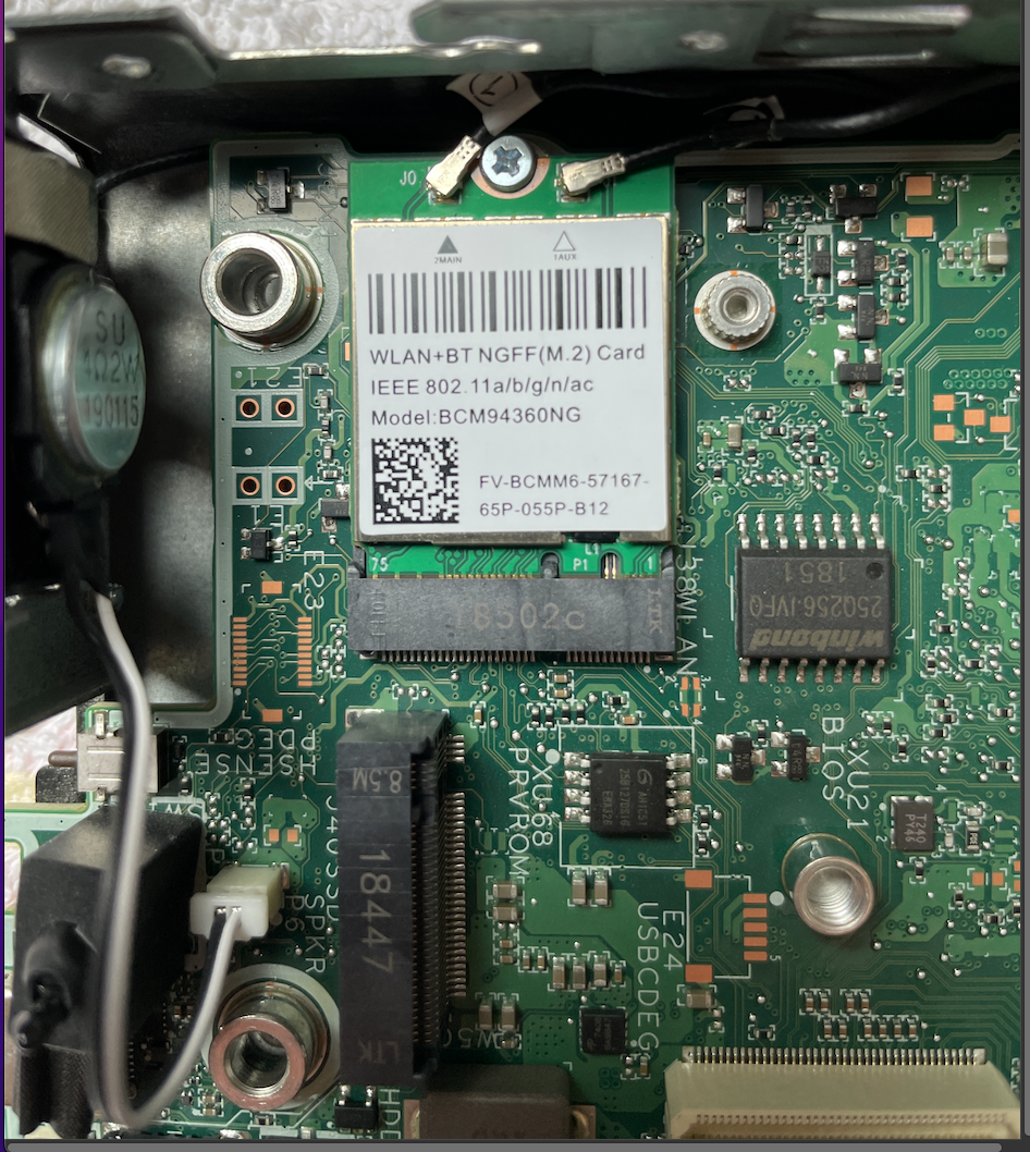

luky35 Posted August 8, 2022 Share Posted August 8, 2022 @deeveedee hi, I got the BCM94360NG Wifi today and put it in the PC (photo attached). In Bios, under System Options, I ticked M.2 WLAN BT. After launch I can see Wifi connection and AirDrop in Finder. Unfortunately Bluetooth doesn't work and I don't know why, as a result AirDrop doesn't work either because there is no BT. But I don't have any kext loaded in EFI. Please help me how to train Bluetooth operation. Spoiler Link to comment Share on other sites More sharing options...
luky35 Posted August 8, 2022 Share Posted August 8, 2022 19 minutes ago, Hervé said: Fenvi BCM94360NG works completely OOB (Wireless and Bluetooth). No kext or anything required. But check your USB ports in case there's something wrong with power settings or port mapping. Can't think of anything else apart from a defective card. Not sure this should be treated in this thread also... Where should I ask for help if there is a discussion for the HP EliteDesk 800 mini? Link to comment Share on other sites More sharing options...
luky35 Posted August 8, 2022 Share Posted August 8, 2022 4 minutes ago, Hervé said: it's more of a support discussion about the BCM94360NG in a thread meant to be a guide but whatever. Thank you Link to comment Share on other sites More sharing options...
deeveedee Posted August 8, 2022 Author Share Posted August 8, 2022 (edited) @luky35 Herve's probably right about the USB port mapping. The EFI that I attached to Post #1 needs to be modified to support Bluetooth. Did you edit your USB port map to include HS14? If you don't know what I'm talking about, please read the instructions here and see this post here. Also, please post your EFI when asking for help. Edited August 8, 2022 by deeveedee Link to comment Share on other sites More sharing options...
luky35 Posted August 8, 2022 Share Posted August 8, 2022 My EFI folder EFI.zip Link to comment Share on other sites More sharing options...
deeveedee Posted August 8, 2022 Author Share Posted August 8, 2022 (edited) @luky35 Thanks for posting your EFI. I'd like you to diagnose your own problem because I know that you are capable of doing this. Please read the install instructions here and read this post and this post. You are underestimating your own ability. Please be patient with your own learning and take the time to read the instruction provided in this thread. Thank you. Edited August 8, 2022 by deeveedee 1 Link to comment Share on other sites More sharing options...
luky35 Posted August 8, 2022 Share Posted August 8, 2022 16 minutes ago, deeveedee said: @luky35 Thanks for posting your EFI. I'd like you to diagnose your own problem because I know that you are capable of doing this. Please read the install instructions here and read this post and this post. You are underestimating your own ability. Please be patient with your own learning and take the time to read the instruction provided in this thread. Thank you. Thank you for the encouragement, I tried, but at the age of 74 it doesn't work as well as you young people. I will look elsewhere for help. 1 Link to comment Share on other sites More sharing options...
deeveedee Posted August 8, 2022 Author Share Posted August 8, 2022 11 minutes ago, luky35 said: at the age of 74 it doesn't work as well as you young people. It might be your assumptions that are holding you back. Start by adjusting your incorrect assumption about age and go from there. 1 Link to comment Share on other sites More sharing options...
luky35 Posted August 8, 2022 Share Posted August 8, 2022 @deeveedee Good people helped and BT works 😃 1 Link to comment Share on other sites More sharing options...
deeveedee Posted August 8, 2022 Author Share Posted August 8, 2022 @luky35 That's great. They must be younger than me. 2 Link to comment Share on other sites More sharing options...
luky35 Posted August 8, 2022 Share Posted August 8, 2022 18 minutes ago, deeveedee said: @luky35 That's great. They must be younger than me. 😃😃😃 Link to comment Share on other sites More sharing options...
