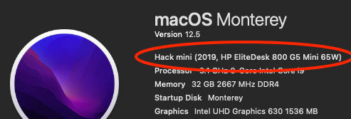

For those who like to change the "CPU Name" in About This Mac (see example below), the allowed editing has changed in macOS Ventura Beta.
For Monterey and previous macOS versions, in order to make this change:
About This Mac: Monterey
Spoiler
we needed to edit ~/Library/Preferences/com.apple.SystemProfiler.plist like this
com.apple.SystemProfiler.plist: Monterey
Spoiler
With macOS Ventura Beta, the CPU Name string must have the format: Mac Model (Description).  We cannot change the Mac Model name and we can only edit the text within the parentheses:
com.apple.SystemProfiler.plist: Ventura Beta
Spoiler
With the edit above, About This Mac -> More Info in Ventura Beta shows the following:
About This Mac: Ventura Beta
Spoiler
Edited by deeveedee

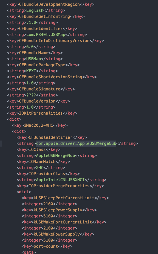

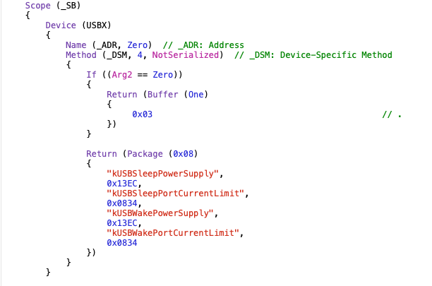

@Jazzoo, How is your USB mapped and do you use SSDT-USBX in your EFI?
I recently discovered that the sleep power settings in my USBMap.kext or USBPort.kext and SSDT-USBX were redundant. I tested injecting these parameters and found that the kext overrides the SSDT. I settled with removing the SSDT and just using what was in the kext.
I am suspecting that the problem you are experiencing comes from the fact that you have neither... or are you using an intel card?

@rafale77  I have the same USB Power Properties in SSDT-USBX and USPorts on both my HackMini8,1 and my HackBookPro15,2.  I don't have any issues on either platform.  My hackbook uses the BCM94360NG card and has no issues.   My HackMini has no Wi-Fi/Bluetooth.

You have both with one overriding the other (essentially making SSDT-USBX non functional) but I am suspecting @Jazzoo to have neither so his USB doesn't sleep properly...
See below:
This is what SSDT-USBX contains
And this is an excerpt from the USBMap.kext
At the bottom, if you convert the hex to dec... you will see that they are exactly the same.
Edited by rafale77
I ran a DOE (Now you can probably guess what I do for a living...):
I deleted the section from the kext and then from the SSDT to make sure I was seeing the same values in ioreg. I then input different values in both kext and SSDT and verified what was showing in ioreg. It is always the kext value.
