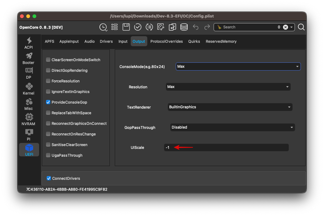

Try changing here
949445016_Screenshot2022-07-09alle11_19_07.thumb.png.8ced5a3542b486763b8ad9052e006273.png
• 1 — 1x scaling, corresponds to normal displays.
• 2 — 2x scaling, corresponds to HiDPI displays.
• -1 — leaves the current variable unchanged.
• 0 — automatically chooses scaling based on the current resolution.
  • Thanks 1
34 minutes ago, antuneddu said:
Try changing here
Thanks, is OK

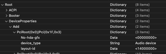

HI @deeveedee
Added No-hda-gfx in OC 0.8.2 EFI. Downloaded macOS Ventura B3 today.
The installation is super OK, only the sound comes from the PC speaker and not from the Monitor speaker.
I went back to the Monterey and the old EFI, where it does sound through the Monitor speakers.
Otherwise, kudos for your work.
Greetings

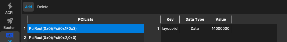

@Jazzoo and @luky35 - DP and HDMI audio works well with the correct DeviceProperties (in your config.plist) if you are using DP->DP and HDMI->HDMI (no adapters).  I have not recently tested DP->HDMI audio (with a DP->HDMI adapter), but when I developed the initial solution for the HP EliteDesk 800 G4 Mini in May 2020, use of graphics adapters (e.g., DP->DVI or DP->HDMI) would result in a kernel panic when waking from sleep.  The solution was to add the property No-hda-gfx to audio DeviceProperties in the config.plist.  At that time, all guides for WhateverGreen and UHD630 framebuffer patching said that graphics adapters would not work and were not supported.  I found through trial and error that with the correct DeviceProperties, adapters did work (but possibly without audio).  That was how I was (and still am) able to use DP->DVI adapters for my graphics.
Carefully read my known issues and my methodology to see the history of this solution.  My helping style is not to do it for you.  Others may do it for you, but I haven't found that to be a very good way to teach.  If you make attempts and provide your EFI and test results, I would be glad to advise.  Here's a hint: As is mentioned in the instructions here, you will be removing No-hda-gfx from the audio DeviceProperties and not adding No-hda-gfx.  Adding No-hda-gfx as is mentioned here is incorrect.
Remove No-hda-gfx in audio device properties to enable audio over DP and audio over HDMI

On my HP 800 G4 mini audio DP-->HDMI works 100%.
As a beginner, I don't know how to edit this in config.plist, I'm asking the person who did it for me right away.

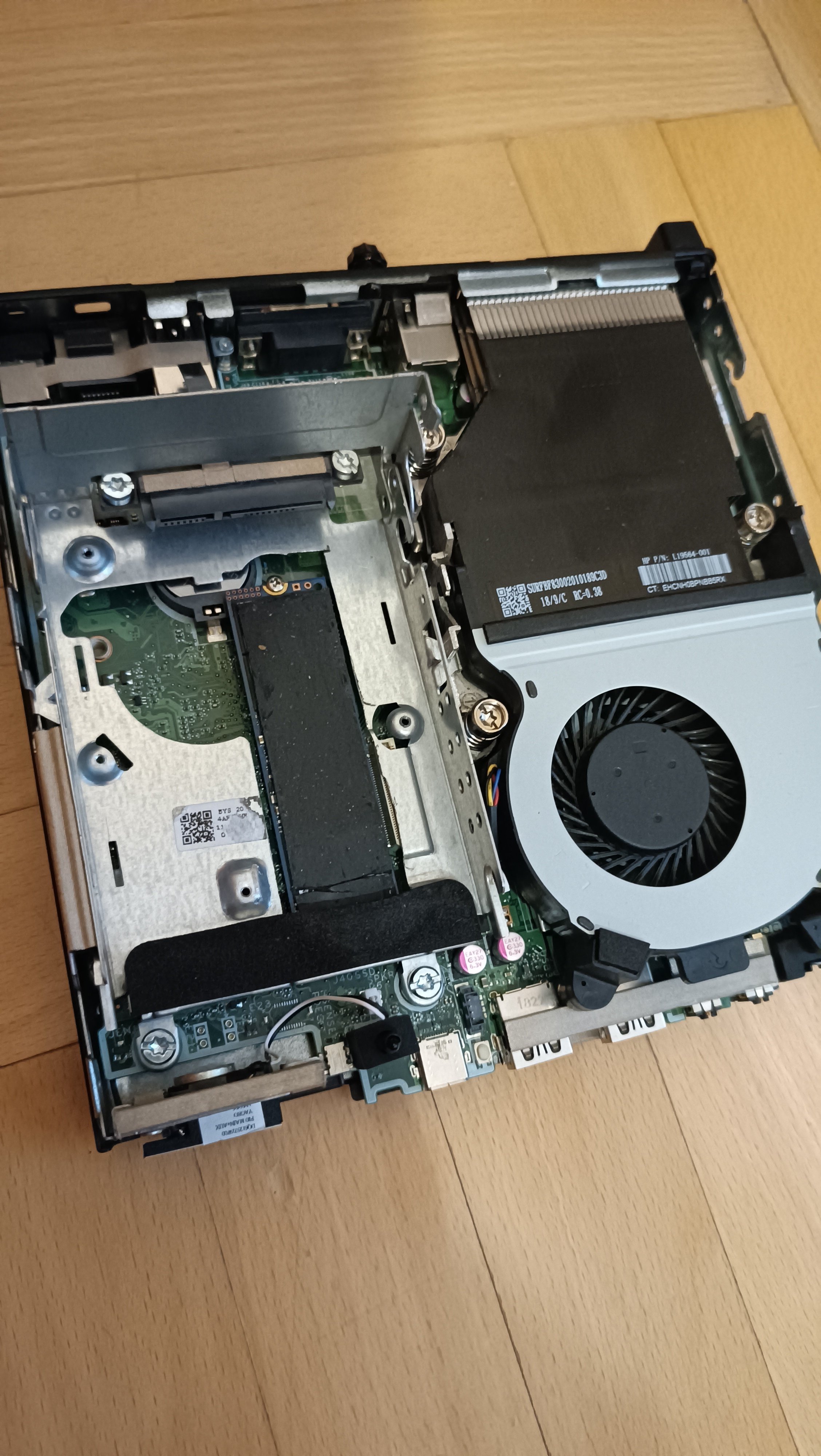

@Jazzoo Well done!  If you don't have a caddy fan and you plan to install a SATA drive in the caddy (with 2 NVMe SSDs), I would recommend adding the caddy fan. This fan is included with 65W models but is not standard with the 35W models. Your rig will generate extra heat with the 3 drives and the caddy fan will help keep the drives cooler.
Thanks for the advice! Fan purchased :) I have 1 nvme and 1 hdd now in my system and the temps are good. 35'C for the nvme (Kingston A2000 500GB + thermal pad) and 43'C for the HDD (Seagate 1 TB SSHD). Using Ventura as a daily driver now, feels great!
@Jazzoo I think you may find that the NVMe SSD thermal pad interferes with the caddy fan. If so, just remove the thermal pad. I don't use any thermal pads on my NVMe SSDs and have no thermal issues.
