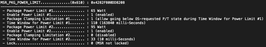

In response to a discussion in "the forum that is not to be mentioned," I extracted the HP EliteDesk 800 G5 Mini 65W CPU PL1 and PL2 values (programmed by HP).  I extracted these values using PikeRAlpha's AppleIntelInfo.kext and Hackintool v3.8.4.  The results are posted below.  Note that HP is limiting PL2 to 95W.
HP's programmed PL1 and PL2 for EliteDesk 800 G5 Mini 65W
Spoiler
EDIT: I'm not certain, but there may be a way to coax more performance out of these little HP Minis (albeit, with risk).  I started a new thread here.

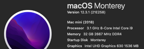

EDIT: I am no longer recommending the use of Carbon Copy Cloner to make bootable backups starting with Monterey.   You can read more about CCC's backup limitations on the Bombich website.  Use DiskUtility's 'Restore' function or perform a clean macOS installation and migration.

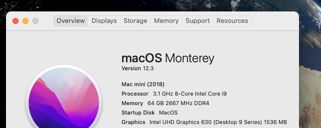

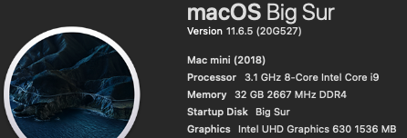

In preparation for an upgrade to XCode 13.3x, I needed to upgrade from Big Sur to Monterey.  After cloning my Big Sur SSD, the Monterey upgrade was uneventful.  For the upgrade from Big Sur to Monterey, I'm using OC 0.7.9 with my OC 0.7.9 EFI attached to Post #1.
About This Mac: Monterey 12.3.1
Spoiler

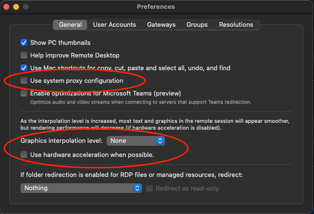

The upgrade from Big Sur to Monterey has gone very well.  I upgraded my OS (Big Sur 11.6.5 to Monterey 12.3..1), XCode (13.2 to 13.3.1, Visual Studio 2019 / Xamarin IDE and packages and supporting developer apps.  My development environment continues to work flawlessly following the upgrade.  This is the first time that I can recall where I upgraded the OS and XCode without having XCode build issues.  Either Apple is getting better at this, or there weren't many changes for Intel platforms.  Either way, I'm very happy with the upgrade.
EDIT: I believe I have confirmed that this RemoteDesktop issue is unique to my DP->DVI display configuration.  I do not experience this problem on other Monterey hacks that do not use DP->DVI adapters.
Since upgrading to Monterey from Big Sur, I have encountered one problem with Microsoft Remote Desktop (Version 10.7.6 (1972) at the time of this post).  When remotely connecting to Windows 10 and Server 2016 desktops (not a problem when connecting to Win7), the monitor displaying the remote desktop would 'lose sync' (screen went to static).  This never happened with previous versions of macOS before Monterey.  I'm not sure if this is because I am using DP->DVI adapters (recall that I need to use framebuffer type HDMI and not type DVI to get my DP->DVI adapters to work with Monterey).  The fix for this problem was to configure Remote Desktop Preferences as follows:
  • Uncheck "Use system proxy configuration"
  • Set Graphics interpolation level to None
  • Uncheck "Use hardware acceleration when possible"
I'm not sure that all of these preference changes were necessary, but it solved the problem and I don't notice any performance difference in Remote Desktop.
Screenshot: Remote Desktop Preferences
Spoiler
Edited by deeveedee

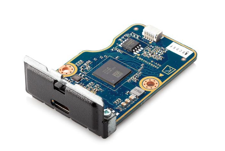

Has anyone tested the HP Thunderbolt 3.0 Port Flex IO expansion card with the EliteDesk 800 G4 / G5 Mini running macOS?  HP Part Number is 3TK77AA.
HP Thunderbolt 3.0 Port Flex IO; Part Number 3TK77AA
Spoiler
EDIT: Here is a thread that includes required ACPI mods for working TB3.  Not sure how much these mods apply to this hack, but the author does appear to know what they're doing.
Edited by deeveedee

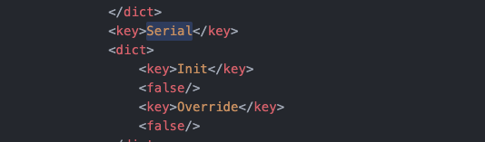

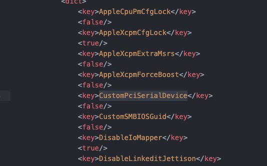

I have upgraded to OC 0.8.0. The only modifications I have had to make was to delete the SerialInit Entry under Misc/Debug and add the ForceAquatiaEthernet key under kernel/quirks with a False value.
Edit: The above was only the minimum required. For the sake of completeness, optional things one would need to do:
1. Add "Serial" key Misc with two options: "Override" and "Init" under it both set as "false" by default.
2. Add "CustomPciSerialDevice" key under kernel/quirks. Set as false.

@rafale77 I haven't upgraded OC from 0.7.9 to 0.8.0 yet, so thank you for your upgrade status.  After looking at acidanthera's github repo, it looks like AppleALC.kext is updated to version 1.7.1.
EDIT: Following @rafale77 's lead I completed the OC 0.8.0 upgrade from OC 0.7.9.  The changes from OC 0.7.9 to OC 0.8.0 are as follows.  Add FeatureUnlock.kext 1.0.8 if you use it.  The new OC 0.8.0 EFI is now attached to Post #1.
Update EFI from OC 0.7.9 to OC 0.8.0

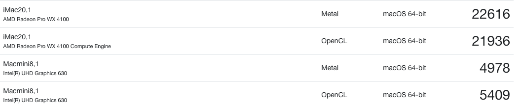

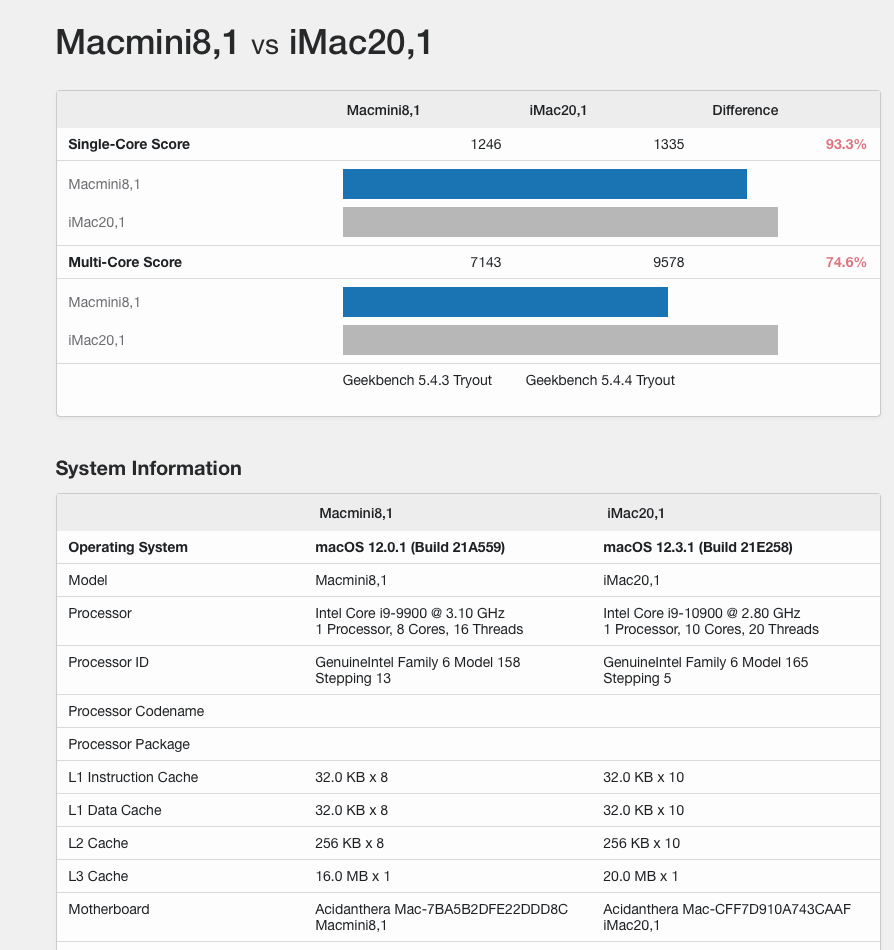

As I am almost done with my new mac mini/tiny, with the lenovo equivalent, I will be jumping ship soon to start a new thread. Pretty amazing what these mini/micro/tiny form factor can do.
A couple of things you potentially could be interested in knowing:
1. CFG Lock is defeatable on the lenovo unlike the HP
2. The lenovo is capable of detecting the capability of the power brick and therefore adjust the CPU PL2 accordingly
3. Expansion capability is much greater with the ability to add a PCIe card through a riser.
4. Cooling capability also appears to be a little better from the lenovo HSF Vs. the HP one as the BIOS reacts much faster to CPU temperature by adjusting fan speed.
At the moment I am still fighting DRM issues in spite of the discrete GPU... Which is the last frontier of getting it as functional as a real mac.
Attached some GB5 comparisons:
