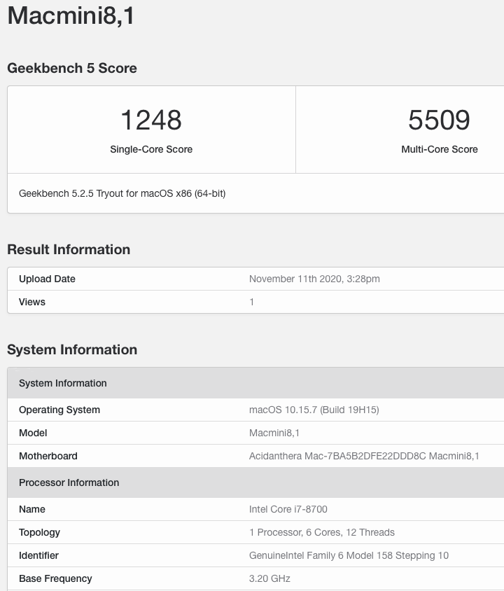

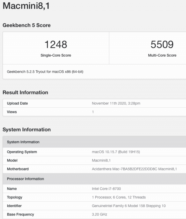

If you are disappointed with your system performance, consider populating both memory slots.
Screenshot: GeekBench5 CPU Benchmarch
Spoiler
1030080661_ScreenShot2020-08-28at4_45_26PM.thumb.png.738308623afaad1ee10a0932be9b3358.png

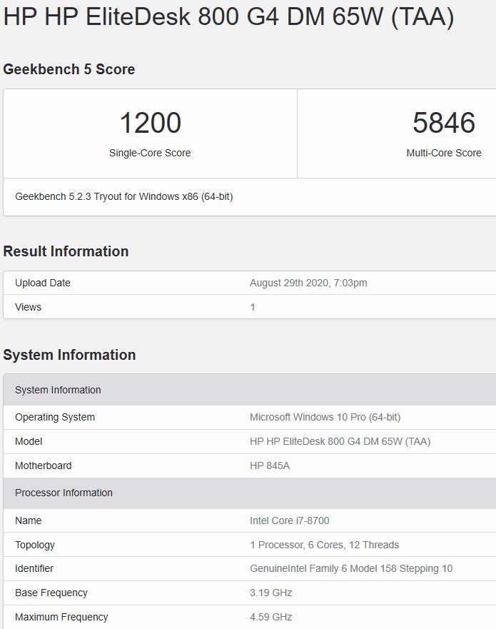

Just ran GeekBench5 CPU test in Windows 10. Looks like multicore performance of the EliteDesk 800 G4 Mini 65W (i7-8700) is better in Windows 10 than it is in Catalina. Not sure why this would be.
Screenshot: GeekBench5 CPU Benchmark - Windows 10

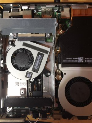

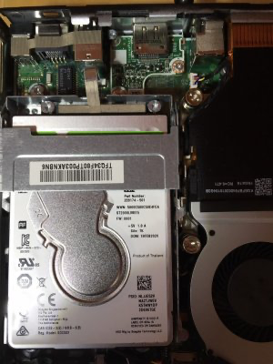

I have confirmed that my SATA caddy modification here works perfectly with the 65W G4 Mini and its HD fan assembly. Two M.2 2280 SSDs and one SATA6 HD fit/work perfectly and the HD cooling fan helps with SSD/HD temps. Note that the 65W G4 Mini issues a boot warning if the system is booted without an HD fan assembly when the SATA drive caddy is installed.  The 35W unit does not require the HD fan assembly (and thus does not issue a boot warning if it is not installed).

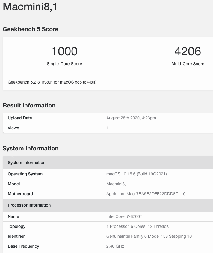

I am currently testing with CLOVER r5122. I have replaced AptioMemoryFix.efi with OCQuirks.efi / OpenRuntime.efi. So far, I have not noticed any difference in behavior or performance. Attached is a GeekBench5 CPU benchmark after migrating to CLOVER r5122 / OCQuirks (from r5119 / AptioMemoryFix.efi). See r5119 performance here.
EDIT: A note about migrating from AptioMemoryFix.efi to OCQuirks.efi: I didn't know what I was doing when I migrated from AptioMemoryFix.efi to OCQuirks, so I guessed the following steps which seems to have worked:

EDIT2: A new CLOVER config.plist with Quirks is attached. If you use my config.plist, you will need to replace the XX-MASKED-XX values with your own values and you should review Known Issues.
Screenshot: GeekBench5 CPU Benchmark after upgrade to CLOVER r5122

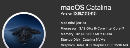

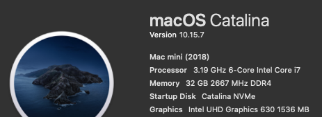

I just upgraded to Catalina 10.15.7 without any issues. There are a few reboots and a couple of times where the installer appears to have stalled (but it hasn't). Just be patient.
EDIT: If you're not sure how to perform the 10.15.7 upgrade, follow the 10.15.6 upgrade instructions here.  In step 6, after the 3rd reboot, you may need to wait for the installation to finish before you see the Catalina desktop.

Attached is my latest OC EFI (OC 0.6.3).
Good news! After the recent fixes (using the attached EFI), my Geekbench 5 benchmarks for OC match benchmarks for CLOVER. Looks like I have completed my OC config. I am still running with CLOVER as my baseline as I continue to test OC. So far, OC looks good.
I am currently testing without RtcMemoryFixup.kext. At first, I simply disabled the Kernel > Add. Now, in my current EFI, I have removed RtcMemoryFixup.kext from OC/Kexts, I have removed rtc-exclude from my OC config.plist boot-args and I have removed Kernel > Add > RtcMemoryFixup from config.plist.
My config.plist still has Kernel > Quirks > DisableRtcCheckSum = 1 (haven't yet tested without this).
I have not observed any RTC issues after repeated Sleep / Wake cycles, repeated Restarts and repeated Shutdown / Boot cycles. When I tested with CLOVER, I occasionally observed corrupt system clock until I enabled KernelAndKextPatches > AppleRTC in my CLOVER config.plist, so I am not calling this a working solution yet. Still needs more testing.
I will continue to monitor and would welcome testing by others. My current config.plist is attached. If you use this config.plist, be sure to replace ***REPLACE*** in PlatformInfo with your own values.

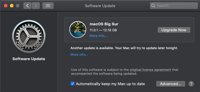

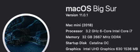

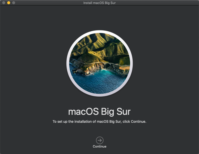

Big Sur just installed on my HackMini8,1 with minimal issues using my EFI here. During install, I experienced loss of real time clock (so I have some tweaking to do), but this never resulted in loss of any BIOS settings and it recovered without me taking any action. The RTC issue was only an annoyance, but not a show stopper. What a painless upgrade! I haven't tested, but BS looks promising on our rigs!
Spoiler
I have changed the title of this thread to include Big Sur.
I performed the update when prompted and just followed the steps. No special actions necessary (except ignoring the RTC issue).
Spoiler
Spoiler
Edited by tonyx86
Fixed broken link

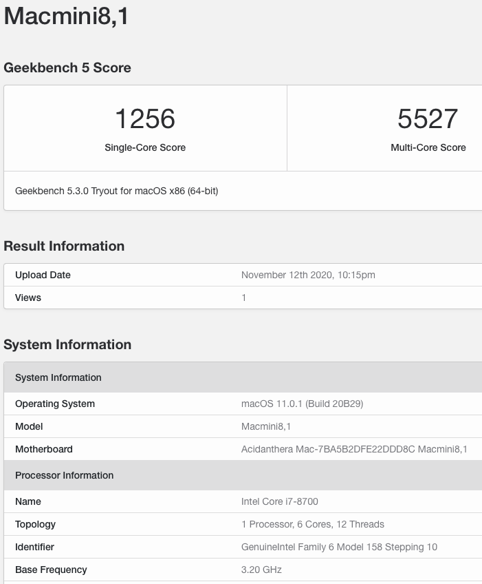

I'm not experiencing any RTC issues after the BS install. Restart, shutdown, sleep/wake all working without issues. Granted, I've only performed minimal testing, but this is an incredible first experience with BS.
Also, I can boot BS Recovery - something I've never done before (with CLOVER).
GeekBench 5 CPU results are same in BS as in Catalina.
Spoiler
