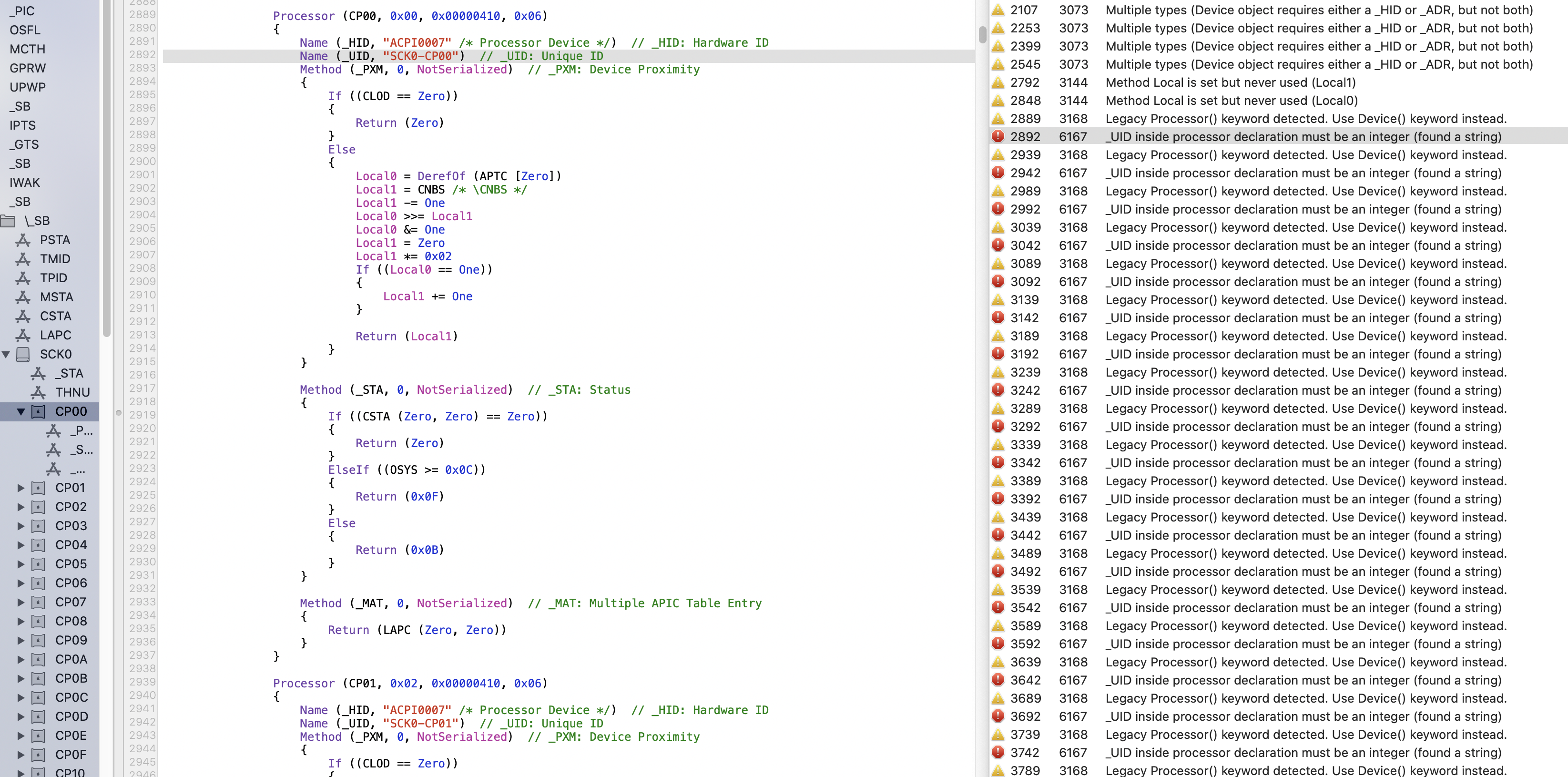

Will it be right?
Find                       Name (_UID, "SCK0-CP00")  // _UID: Unique ID
Replace                  Name (_UID, 0x00)  // _UID: Unique ID
DSDT from BIOS has many errors.
If fix them and implement the corrected DSDT in the BIOS, it be okay?

Did I make such a patch for my DSDT from the Chinese x79 motherboard. which changes the following argument for "_UID" to a hex value/ I don't know if this is correct, but this removed the corresponding compilation errors.
200094063-73fcdc53-def2-45fc-b18f-9b201c
into_all all code_regex Name\s+\(_UID,\s*\"PCI\d\-CP(.*)\"\) replace_matched
begin
Name (_UID, 0x0%1)
end;
https://github.com/acidanthera/bugtracker/issues/2031#issuecomment-1304364381
