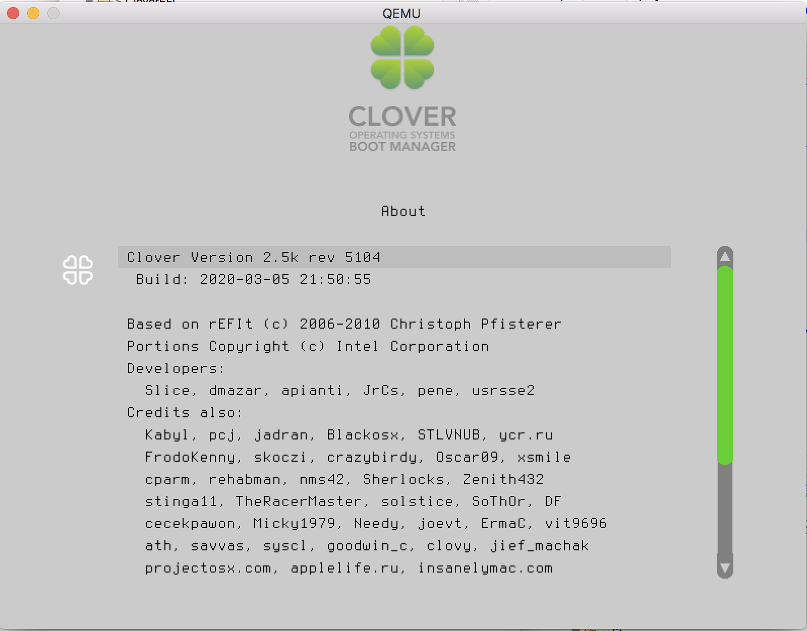

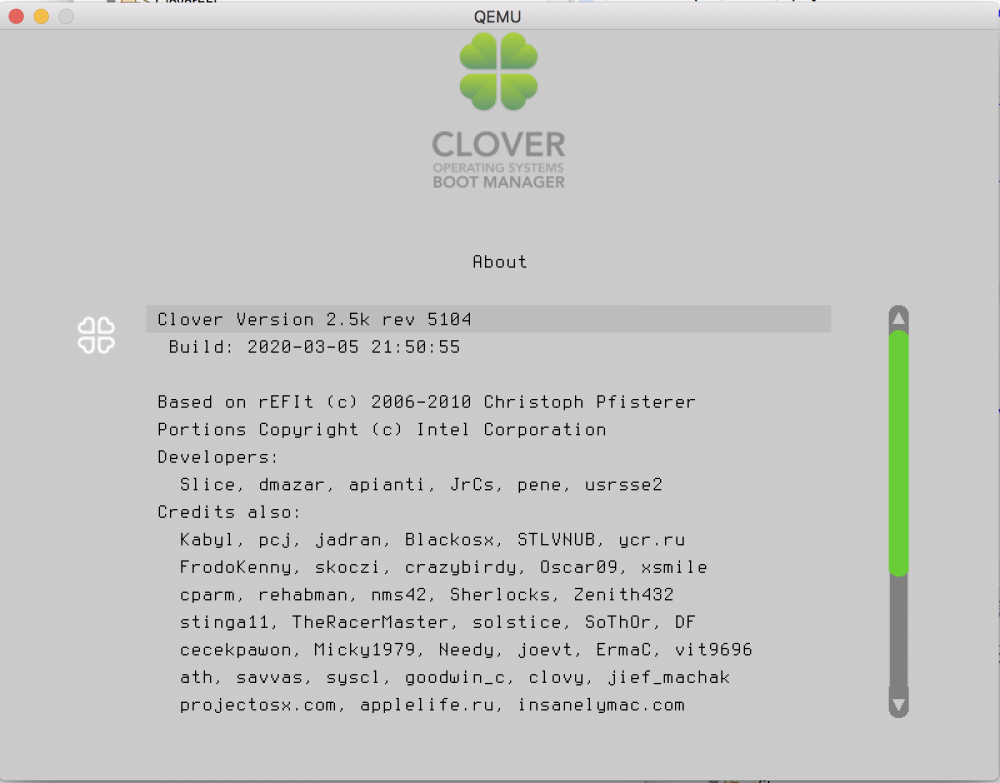

Slice Posted March 5, 2020 Share Posted March 5, 2020 33 minutes ago, Jief_Machak said: How broken. Looks like it's working here (in QEMU, of course) Only 5 lines. Others empty. Link to comment Share on other sites More sharing options...

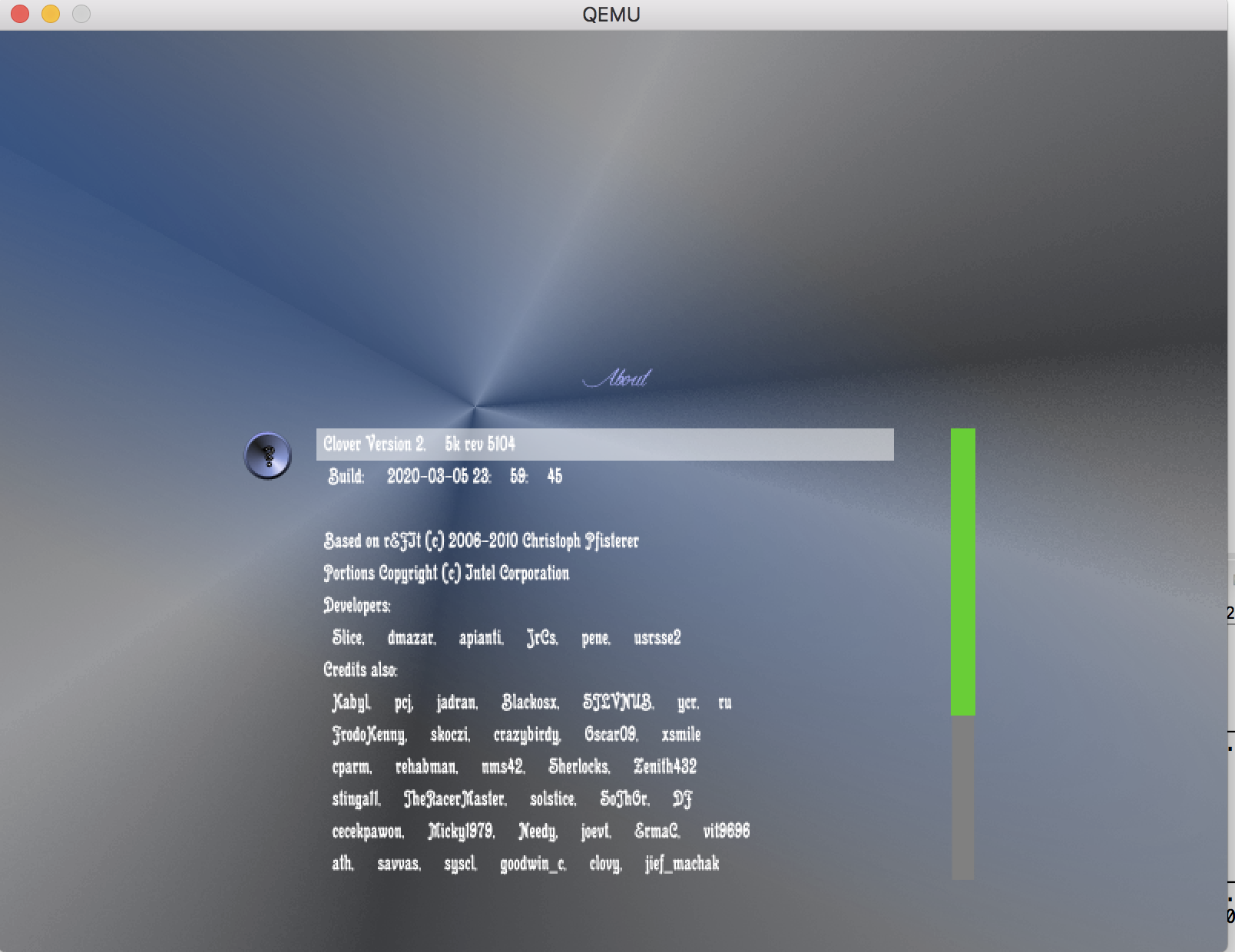

Jief_Machak Posted March 5, 2020 Author Share Posted March 5, 2020 I have that. But it's not the same theme. What's yours ? Link to comment Share on other sites More sharing options...
Jief_Machak Posted March 5, 2020 Author Share Posted March 5, 2020 You sent me your QEMU clover folder. We are supposed to have the same ? I can even change the theme with the option menu. Link to comment Share on other sites More sharing options...
Slice Posted March 5, 2020 Share Posted March 5, 2020 Not same because I made some modification for tests. Your theme is "embedded", I switch to "cesium". Look also my latest commit. Link to comment Share on other sites More sharing options...

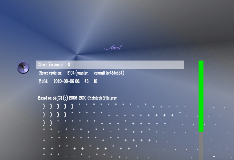

Slice Posted March 6, 2020 Share Posted March 6, 2020 6 hours ago, Jief_Machak said: Just compile what is in the repo and I got the about menu. But it's not exactly the same theme. So send me your theme folder... Found why Duet wasn't starting Clover automatically. My efi was generated with GenFw -e UEFI_DRIVER instead of UEFI_APPLICATION. I guess that DUET is more strict than the EFI bios in VMWare and also the one in my laptop ! I see Clover version 2 on you screen while I set version 5. See my picture It is not theme difference. It is Clover difference as you take no my last commit. Looks like unicode bugs. Link to comment Share on other sites More sharing options...
Jief_Machak Posted March 6, 2020 Author Share Posted March 6, 2020 I took the latest commit. Just didn't regenerate Version.h. Link to comment Share on other sites More sharing options...
Jief_Machak Posted March 6, 2020 Author Share Posted March 6, 2020 9 hours ago, Slice said: Only 5 lines. Others empty. And the icon on this picture is different. Isn't that a theme difference ? Link to comment Share on other sites More sharing options...
Slice Posted March 6, 2020 Share Posted March 6, 2020 15 minutes ago, Jief_Machak said: And the icon on this picture is different. Isn't that a theme difference ? The icon depends on time of day. There are daylight icon and night icon Link to comment Share on other sites More sharing options...

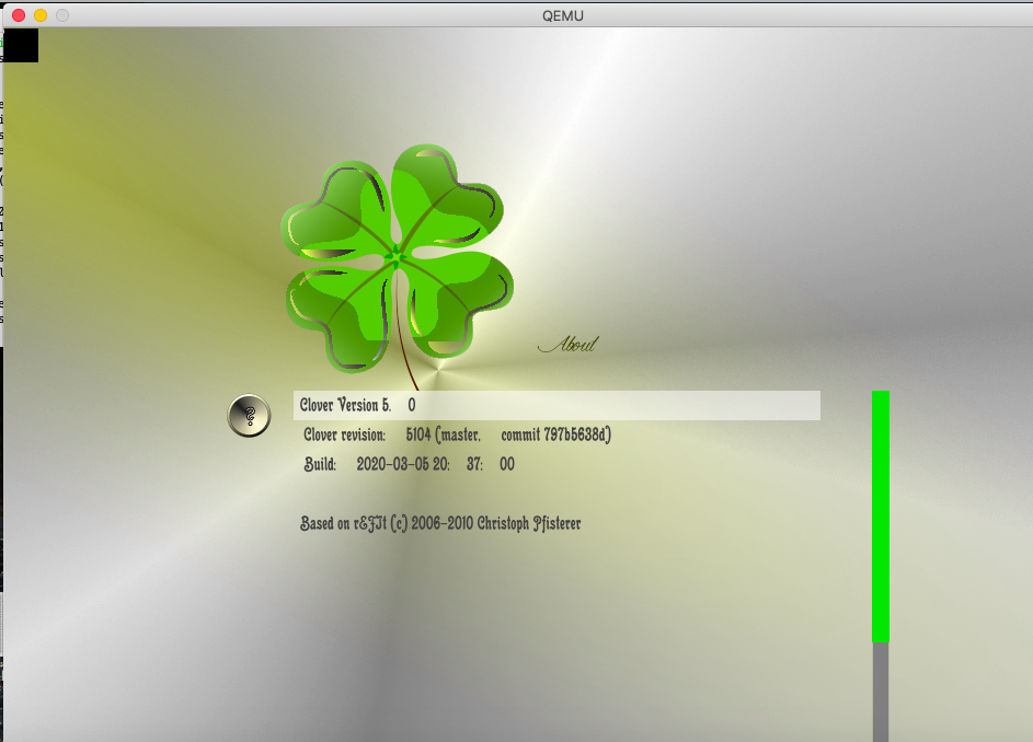

Jief_Machak Posted March 6, 2020 Author Share Posted March 6, 2020 (edited) Ok, sorry, don't have have time anymore until Monday @Matgen84 It works if you change theme. I don't understand what's going on here. Sorry. For the black square, looks like EFI_STATUS st = GraphicsOutput->Blt(GraphicsOutput, &PixelData[0], EfiBltVideoToBltBuffer, x, y, 0, 0, AreaWidth, AreaHeight, LineBytes); XImage line 359, returns 0, but all image memory is 0. Good luck Edited March 6, 2020 by Jief_Machak Link to comment Share on other sites More sharing options...

Jief_Machak Posted March 6, 2020 Author Share Posted March 6, 2020 5 hours ago, Slice said: As I see the same Clover works on real hardware with good about menu. Such bug is hard catchable. And I see some graphics artefacts absent in previous version. I'm pretty sure there is still some memory used before allocation. Where we have to be very careful, is when we use like &PixelData[0] to give to an UEFI service. Because then, the object cannot control and check anything anymore (allocated size). What am I thinking, is to create a method getDataSized(UINTN size) in XArray. It'll return a pointer to the first byte, but make sure that the size is right. I'm currently doing that by calling setLength before, but that's not intuitive and we'll forget it some time. We can also have getDataFromElementSized(UINTN index, UINTN size). That way, we can take the habit to never write "&anArray[x]" to get a buffer, and because we'll be obliged to supply an argument, it'll make us think what size we need !. We can do the same in XStringW, as its correct for a lowlevel function to directly write in XStringW memory. The only thing is to set the length after. Or, remove the "m_len" member from XStringW. After all, it use 8 bytes of memory, just to avoid recalculating the length each time we need it... Food for thought for the weekend... Link to comment Share on other sites More sharing options...
Slice Posted March 6, 2020 Share Posted March 6, 2020 I tested the follow #if 1 //test XImage XImage NewX(NewImage); NewX.Draw((UGAWidth - Width) / 2, (UGAHeight - Height) / 2, 1.f); #else BltImageAlpha(NewImage, (UGAWidth - Width) / 2, (UGAHeight - Height) / 2, &MenuBackgroundPixel, 16); #endif //test XImage #else is working method thus I know .Draw() is not working even if I simplify it to just BltImageAlpha. 1 Link to comment Share on other sites More sharing options...
Slice Posted March 6, 2020 Share Posted March 6, 2020 OK, now XImage.Draw() works. Testing pointer... Link to comment Share on other sites More sharing options...
