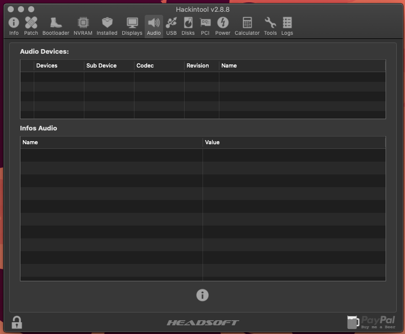

Hello,
One year after the support of this sound card under linux, is there now a way to run a [PCI] Sound Blaster ZxR under Catalina ?
Kernel patch :  http://lkml.iu.edu/hypermail/linux/kernel/1809.3/07093.html
( works perfectly under linux as long as you modify some settings in $ alsamixer )
Vendor : 0x1102
Devices : 0x0012
Sub Vendor : 0x1102
Sub Devices : 0x0010
Vendor Name : Creative Labs
Device Name : Sound Core3D [Sound Blaster Recon3D / Z-Series]
Class : Multimedia controller
Subclass : Audio device
IOReg Name : PCI0.RP03.HDEF
I've tried with AppleALC but without too much experience to go deeper into it :moil:
			<key>PciRoot(0x0)/Pci(0x1c,0x2)/Pci(0x0,0x0)</key>
			<dict>
				<key>AAPL,slot-name</key>
				<string>Internal@0,28,2/0,0</string>
				<key>device_type</key>
				<string>Audio device</string>
				<key>hda-gfx</key>
				<string>onboard-2</string>
				<key>layout-id</key>
				<data>AAAAAA==</data>
				<key>model</key>
				<string>Sound Blaster ZxR</string>
			</dict>
The sound card does not appear with Hackintool.
