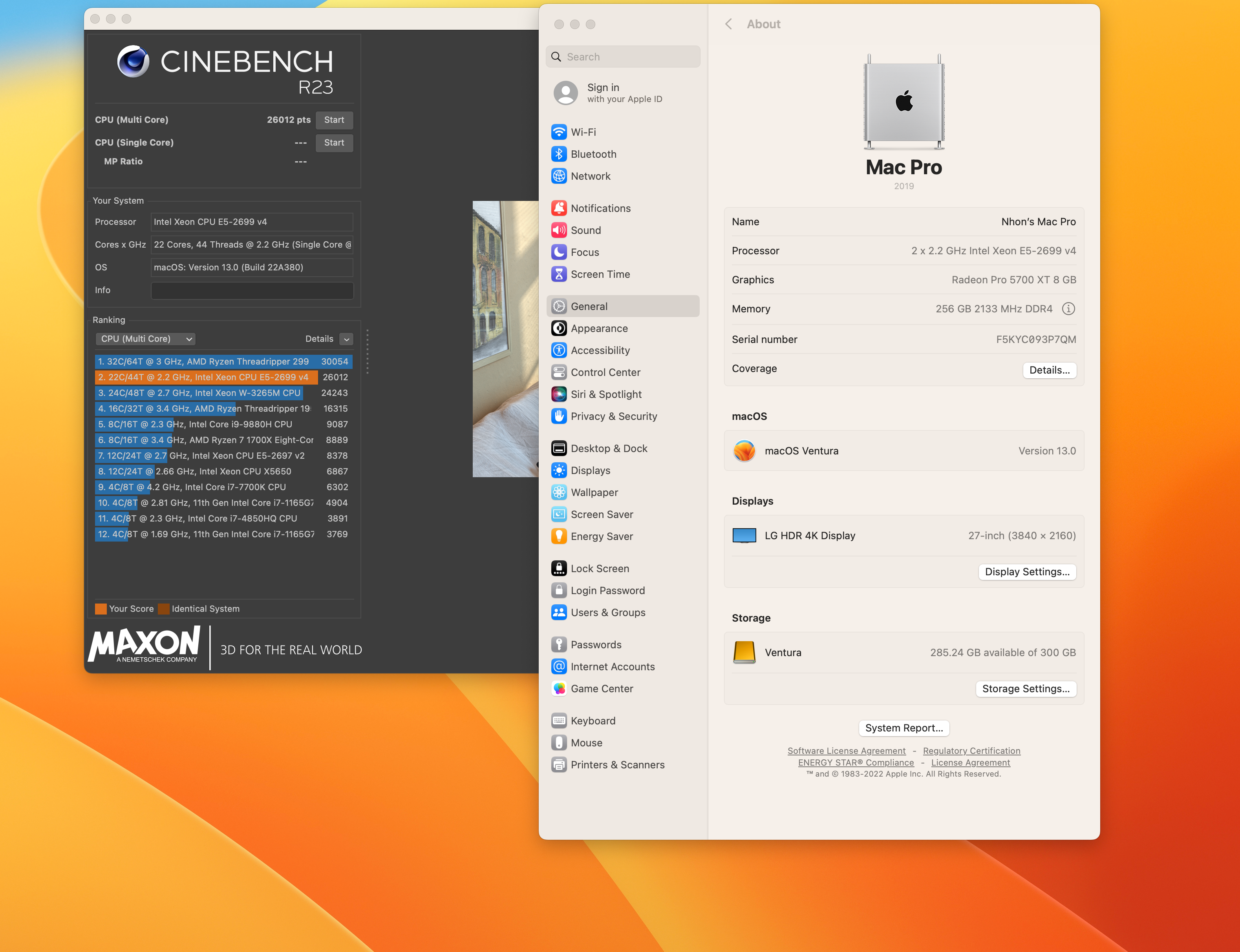

@BillDH2k Thank you very much Bill, I have also installed successfully Ventura on dell T7910 by using ResetTSCAdjust.efi.
  • Thanks 1

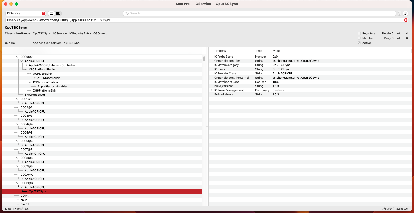

There is a CpuTSCSync kext from a Chinese developer who made a fork of this kext from the acidanthera project.
https://gitee.com/chenguangheiguo/cputscsync-chenguang-network-studio-master
Most of the commits in his repository are manipulations with markdown files (and as you understand, this does not affect the kext itself), but in this commit he made quite a few changes to the kext.
https://gitee.com/chenguangheiguo/cputscsync-chenguang-network-studio-master/commits/master
https://gitee.com/chenguangheiguo/cputscsync-chenguang-network-studio-master/commit/3fd4f61c07b4b03934bd8e293dc52f61ec843045
Try his kext version if someone has problems with acidanthera version CpuTscSync or problems with kext VoodooTSCSync
v1.5.3
https://gitee.com/chenguangheiguo/cputscsync-chenguang-network-studio-master/releases/tag/1.5.3
https://gitee.com/chenguangheiguo/cputscsync-chenguang-network-studio-master/releases/download/1.5.3/CpuTSCSync V5.3.kext.zip
CpuTSCSync V1.5.3.kext.zip

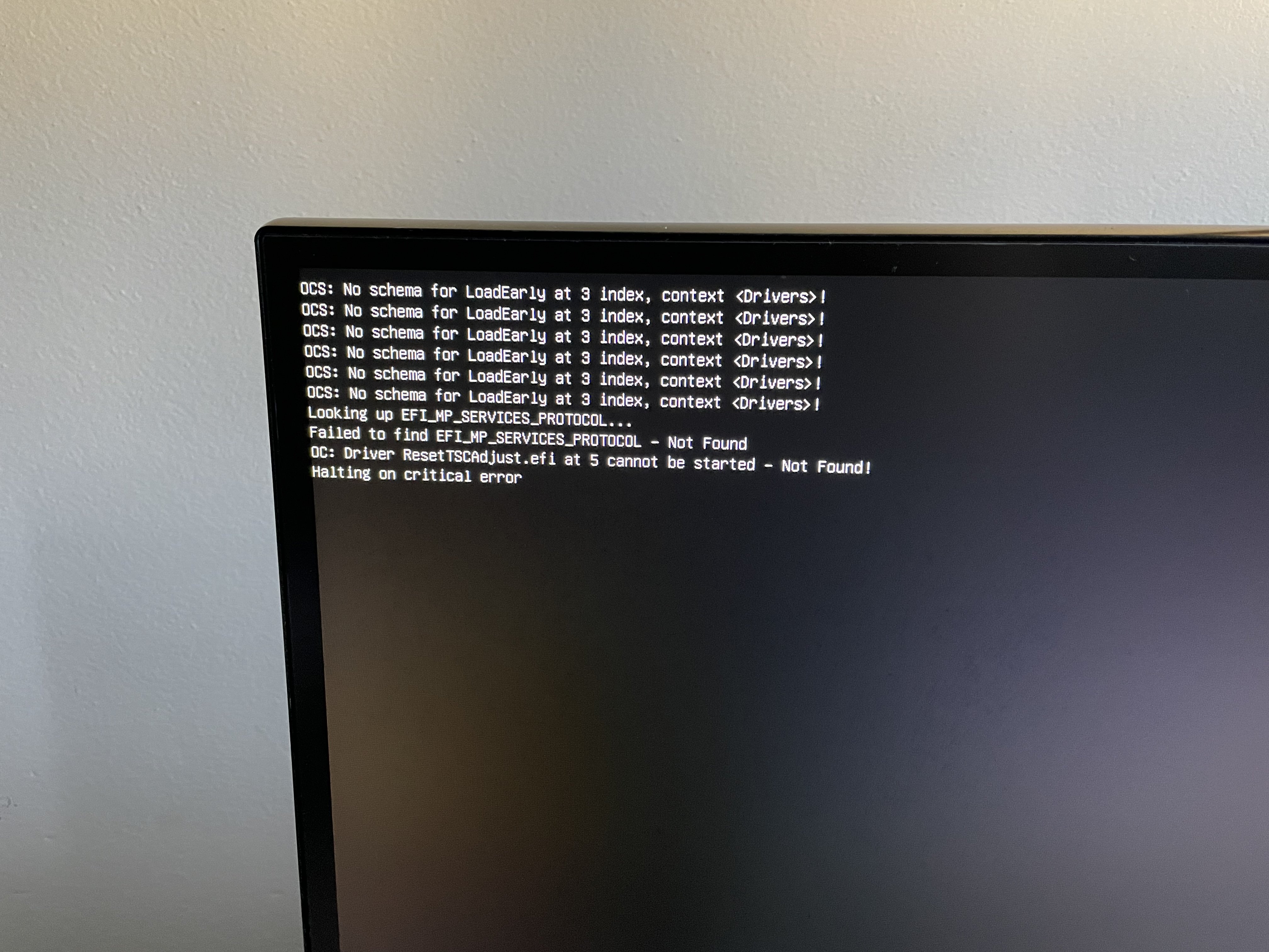

Tested on Monterey ResetTSCAdjust.efbut no luck. A protocol i is missing.
Looking for a solution, I read on the forum where you got this file that problem for 2697v2 should be related to APIC patching. Clover was doing it easily. OC not.
In any case I did some progress.
Using voodootscsyn I fixed Catalina.
I had solution in front of my eyes…but looking elsewhere.
Thanks for patience and suggestions

These links are useless because of chinese language and absent registration.
See my signature. I successfully installed Monterey on X79 + Ivybridge-E5 by Clover 5150.
Yes, I also had problems with TSC sync. Anyway all problems were resolved as said before multiple times.

It works well here!
Thank you guy!
@vdv  I tried to run this efi tool on HP Z420 board (X79/2680V2), it gave the same error. But on HP Z440 [X99] it run properly. So It appears that X79 boards may not have up-to-date version of UEFI BIOS to support "EFI_MP_SERVICES_PROTOCOL" call. The solution could be an update of this efi tool to perform a TSC reset using method supported by the older BIOS. Or better, OC or Clover could do this easily, if the developers are made aware of this issue.

Very bad!!!
If your BIOS doesn't contain EFI_MP_SERVICES_PROTOCOL then you can't use TscSyncTimeout quirk. Also ResetTSCAdjust.efi is impossible.
May be you will be happy with other pathes/quirks. (PatchAPIC in Clover, fix somehow DSDT, VoodooTscSync)

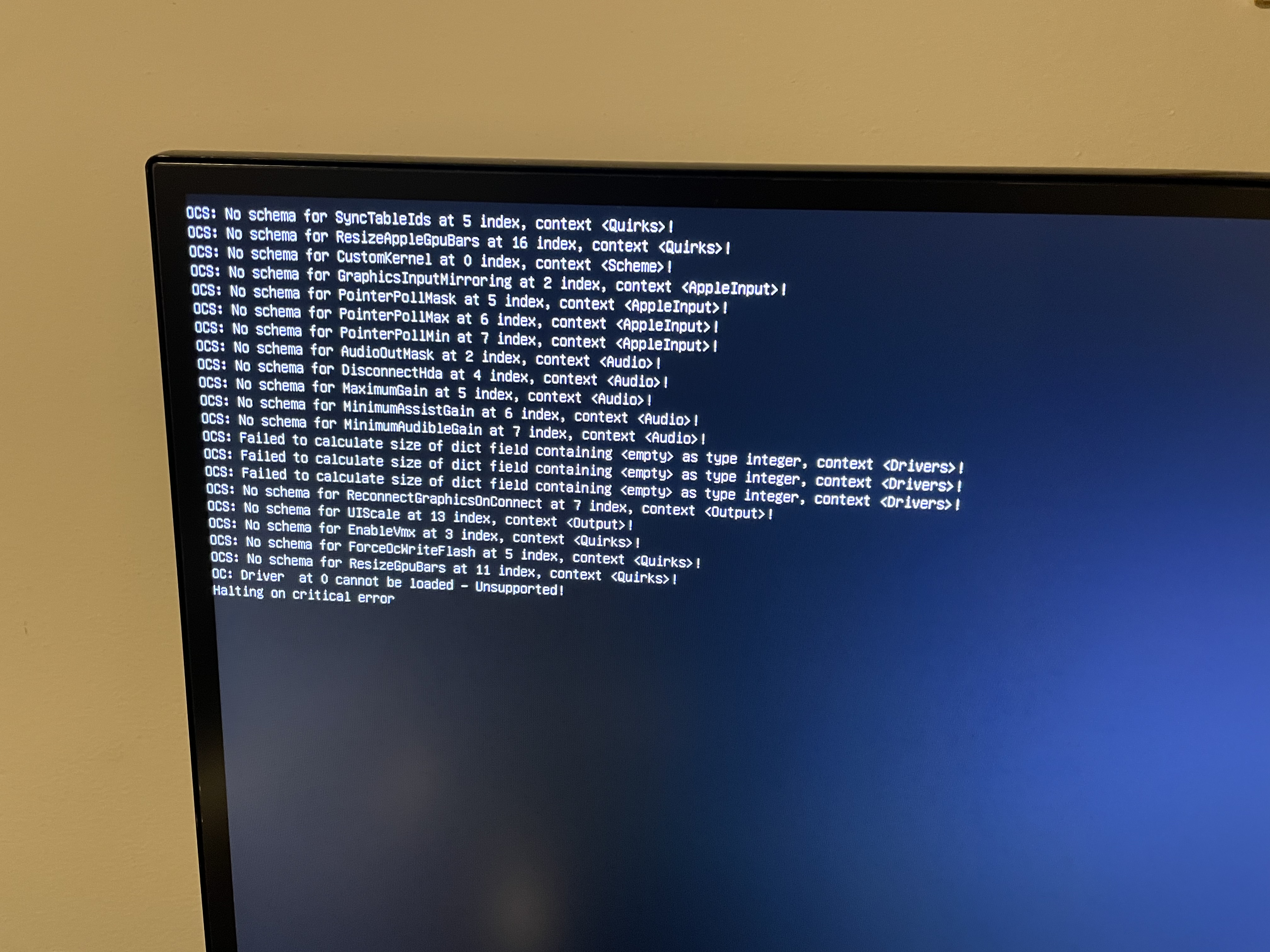

Hi,
1 week of trials and fails.
It seems that DSDT with removed useless thread/CPU + VoodooTSC + current edit is going ahead but still no boot (no issues with CPUS=1 of coarse).
lapic_dont_panic=1 doesn't show benefit.
As you can see it try to "load" SCK2.C200 with is CPU I have erased from DSDT.
It seems also the voodoo is not present if I check with IORegistryExplorer (I have modified the info to 47 - 12x2x2-1 cores)
Is there any place I should erase/modify?
I'm trying in 12.6.1. Should I downgrade to 12.0.1?
Can you please have a look to my folder and to address on the right direction?
I'm also try to work on the MRS unlock of firmware (or Region Unlock).
Unfortunately no big help (an no wish to have a bricked mobo).
Any help appreciated.

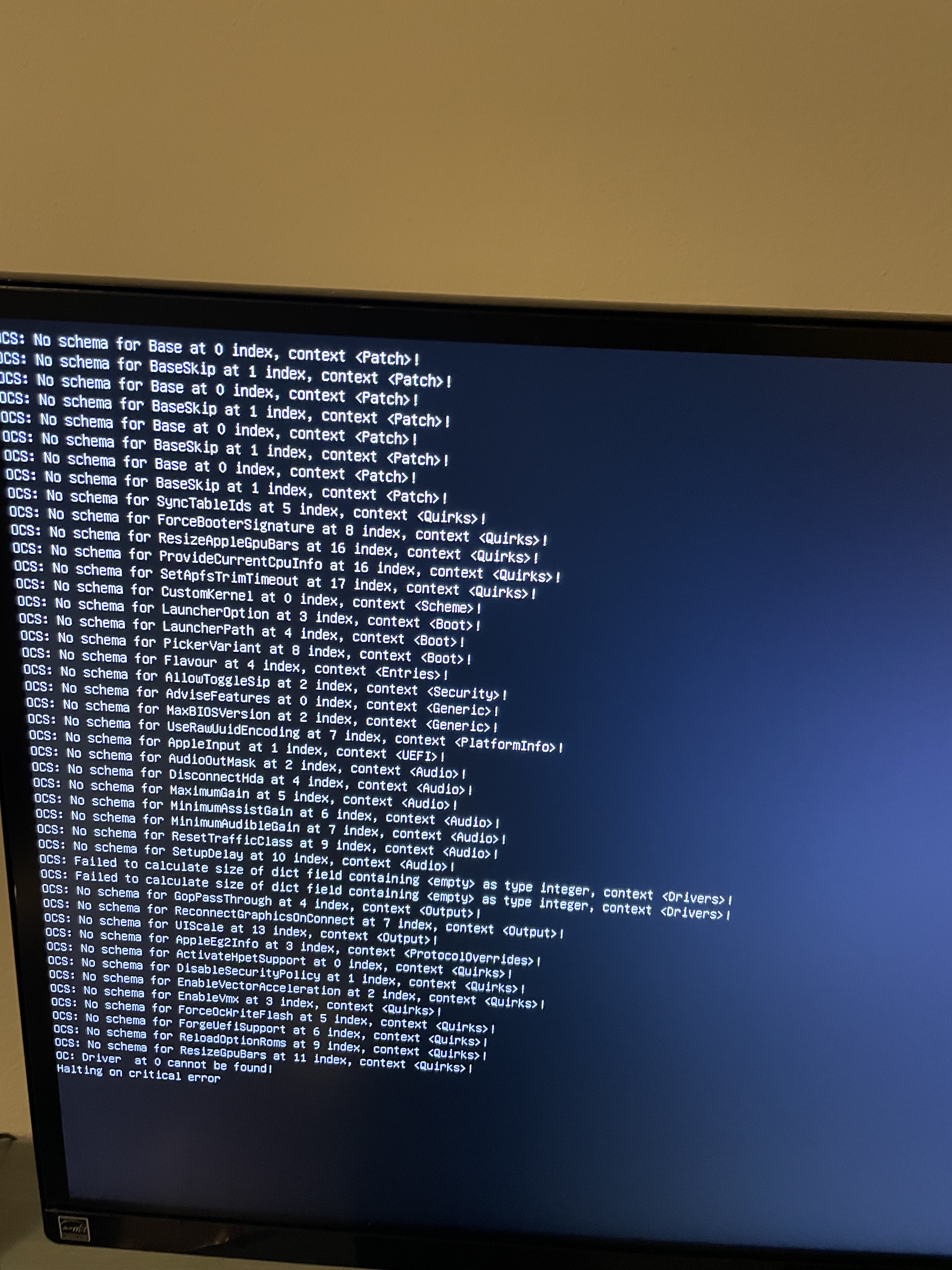

23 hours ago, vdv said:
Refreshed config.plist with properthree.
Didn't the Propertрtree say that there are a lot of errors in the config? For example, "No schema for SyncTableIDS at 5 index, context <Quirks>! ?? And 17 more!!!
In the section, UEFI --> Drivers errors too. The parameter Arguments requires a string value, not a data.
You need to check the config with the ocvalidate utility
