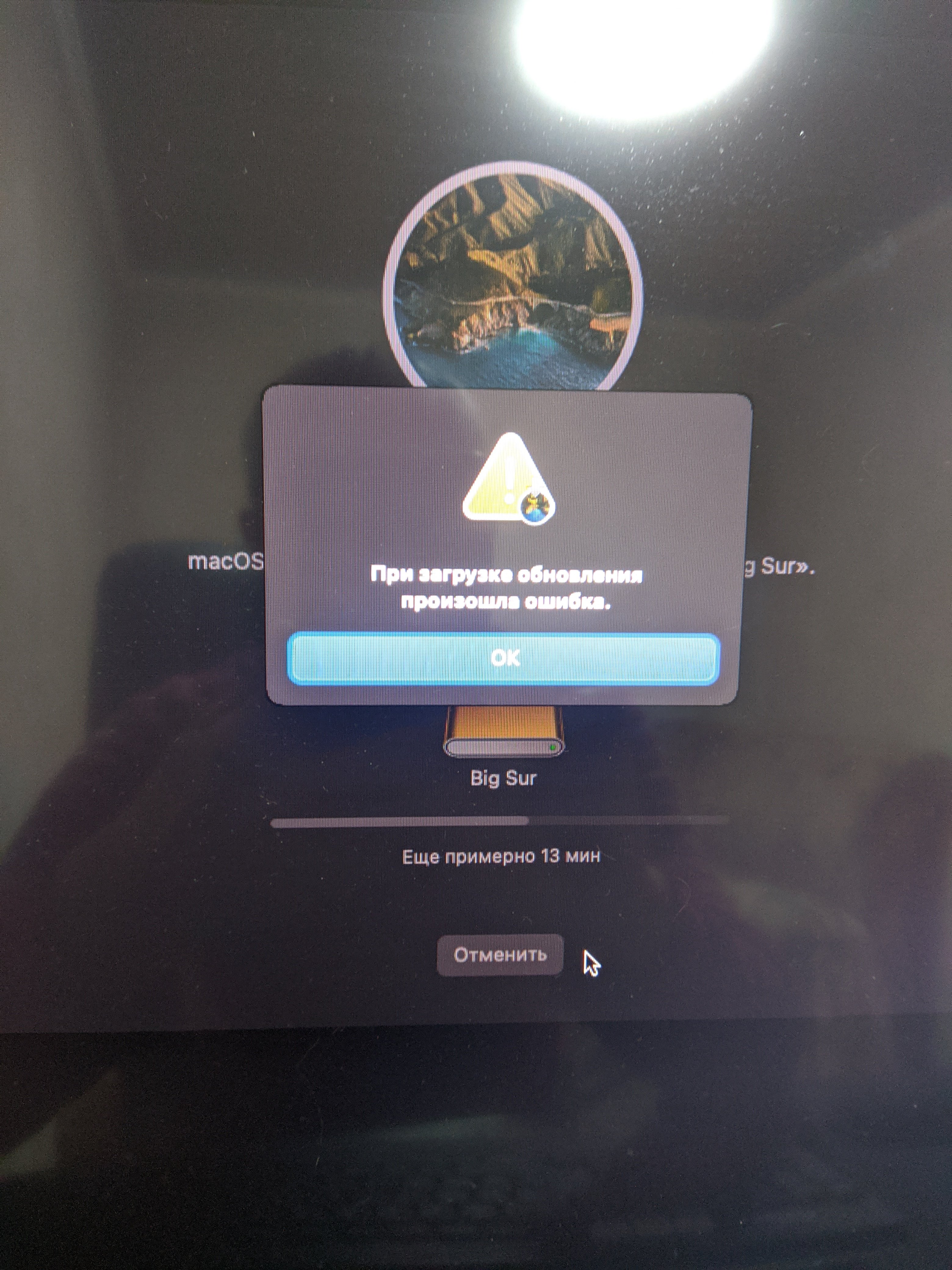

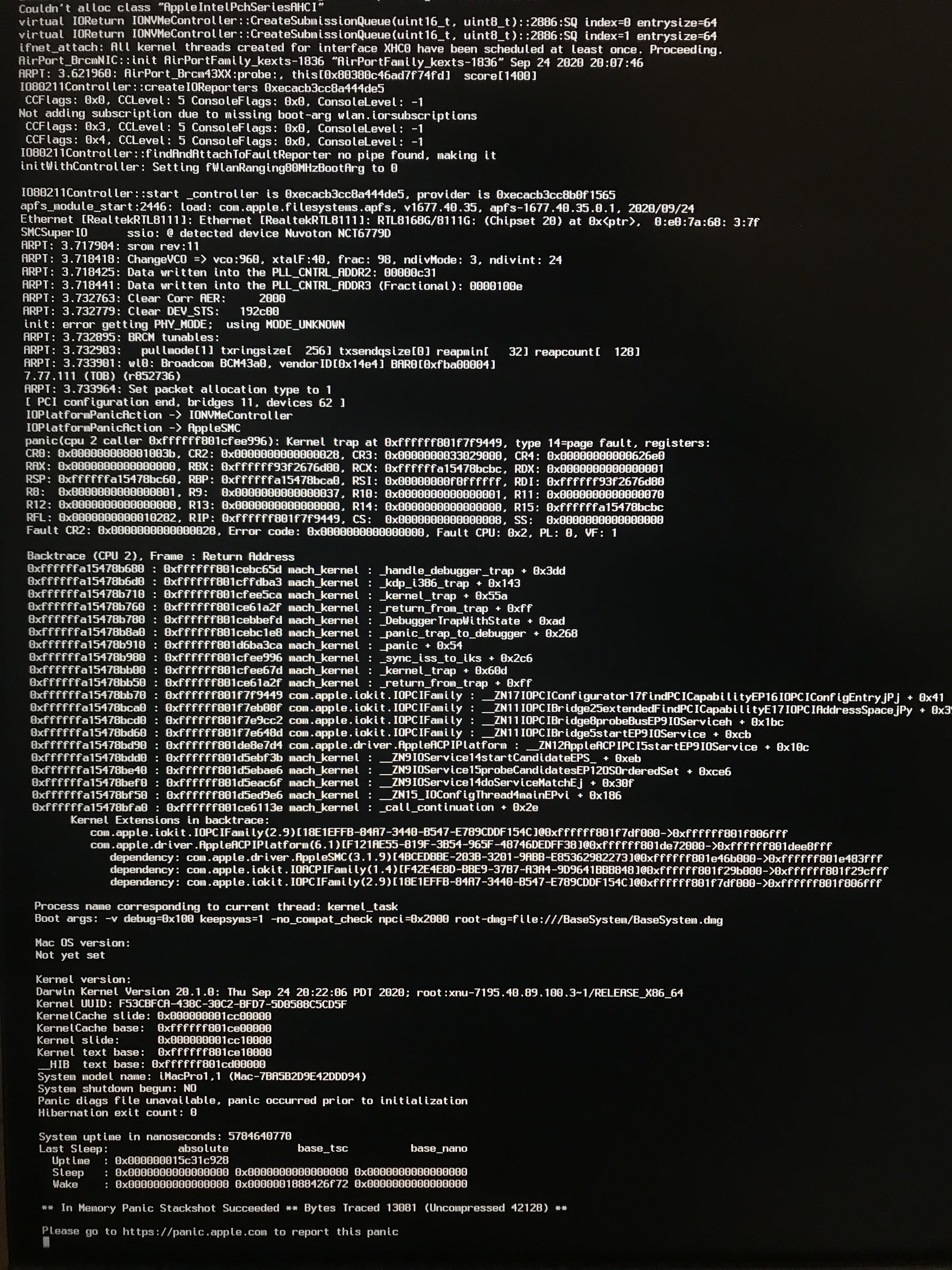

pitrysha Posted October 15, 2020 Share Posted October 15, 2020 7 hours ago, RemB said: Here I'm attached config.plist without PlatformInfo data (insert yours info) and SSDT patches (put this in ACPI Folder OC). No needs to edit DSDT. GA-X99-UD5-WiFi is working well. X99-Conf-SSDTs.zip Doesn't work for me. Stops at "apfs_module_start: 2464: setting max link-id cache size: 18" Link to comment Share on other sites More sharing options...
RemB Posted October 15, 2020 Share Posted October 15, 2020 1 hour ago, pitrysha said: Doesn't work for me. Stops at "apfs_module_start: 2464: setting max link-id cache size: 18" It's an another problem. What config.plist did you use? Link to comment Share on other sites More sharing options...

RemB Posted October 15, 2020 Share Posted October 15, 2020 (edited) 11 minutes ago, pitrysha said: Stops at "apfs_module_start: 2464: setting max link-id cache size: 18" Is it a kernel message? As i understand Edited October 15, 2020 by RemB Link to comment Share on other sites More sharing options...
pitrysha Posted October 15, 2020 Share Posted October 15, 2020 19 minutes ago, RemB said: Is it a kernel message? As i understand Found a bug in ssdt. Everything is working . thanks Link to comment Share on other sites More sharing options...

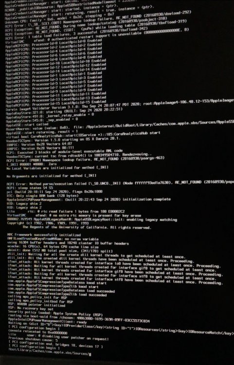

AslashA Posted October 15, 2020 Share Posted October 15, 2020 When I found out that the problem in UNC0 no one paid attention to it)) Without waiting for feedback, I also stopped and did not continue! On 9/21/2020 at 4:09 PM, AslashA said: The problem is not with the device names. I renamed the devices similar to native macpro7,1, but the problem persists. At the same time, catalina with this dsdt worked fine. I just tried to remove UNCx devices and there is no more panic during installation. But the installation stops at this step. If you remove nvme ssd, it stops at the same step, but without the nvme error. Therefore, there is a panic for some device on the UNC0 bus. Now you need to determine which device is in conflict. Today I will try to remove the report from Aida64 and, comparing with Ioreg, determine which devices are on the UNC0 bus. P.S. I apologize for my English)) I use google translator. 1 Link to comment Share on other sites More sharing options...
