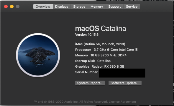

kirkfletcher Posted July 24, 2020 Share Posted July 24, 2020 (edited) 27 minutes ago, AudioGod said: No f11jgk is very good and what I’m using myself right now but the problem with it is that it doesn’t work on all monitors and can cause a black screen so for this reason I don’t give it out or recommend it on the thread just yet but they will fix that problem soon enough and then it will be lovely jubbly. The thing about F11jgk is it has MSR unlock baked into the bios as a option and also has fusion baked in there too. You can flash F11j back to F11e by using doing a usb flash instead of using the Built in qflash. As soon as you told me about that audio problem I knew it was that stupid serial port and that’s why I asked you to try it. People don’t seem to realise how problematic that port is to macOS. Anyway I’m glad I could help you out buddy and awesome stuff that your 100% A ok now. P.S I can knock you up a bios profile for F11jgk if you like boss, just let me know if you want it and il make it so for you? Yeah buddy! I'd love an f11jgk profile only if its not too much trouble, my system did seem to boot so monitors seem fine (2 x Samsung 4k U28E590) just need to get the bios setup correctly (which is what your profile will do). I would love if you could share :-) At least I have f11e on one bios and f11j on the other (gotta love the master for that) Edited July 24, 2020 by kirkfletcher Link to comment Share on other sites More sharing options...
AudioGod Posted July 24, 2020 Author Share Posted July 24, 2020 (edited) 2 minutes ago, kirkfletcher said: Yeah buddy! I'd love an f11jgk profile only if its not too much trouble, my system did seem to boot so monitors seem fine (2 x Samsung 4k U28E590) just need to get the bios setup correctly (which is what your profile will do). I would love if you could share :-) Yep it works fine with that Samsung monitor, I have one myself and a HP 2k 144hz monitor as well. no problem what so ever I shall knock that up for you in the next hour or two. Edited July 24, 2020 by AudioGod 1 Link to comment Share on other sites More sharing options...

AudioGod Posted July 24, 2020 Author Share Posted July 24, 2020 3 minutes ago, kirkfletcher said: @AudioGod Legend, cheers buddy. Here you go Brother. Please let me know that it works just incase I did something wrong, F11jGK Profile.zip - Bios Profile F11j GK with all the correct settings dialled in. 1 Link to comment Share on other sites More sharing options...
kirkfletcher Posted July 24, 2020 Share Posted July 24, 2020 1 minute ago, AudioGod said: Here you go Brother. Please let me know that it works just incase I did something wrong, F11jGK Profile.zip - Bios Profile F11j GK with all the correct settings dialled in. YESSS! Thank you SOOOOO much! 1 Link to comment Share on other sites More sharing options...
kirkfletcher Posted July 24, 2020 Share Posted July 24, 2020 11 minutes ago, AudioGod said: Here you go Brother. Please let me know that it works just incase I did something wrong, F11jGK Profile.zip - Bios Profile F11j GK with all the correct settings dialled in. Worked beautifully! I certainly owe you a beer or two! Thanks for all your help man! 1 Link to comment Share on other sites More sharing options...
