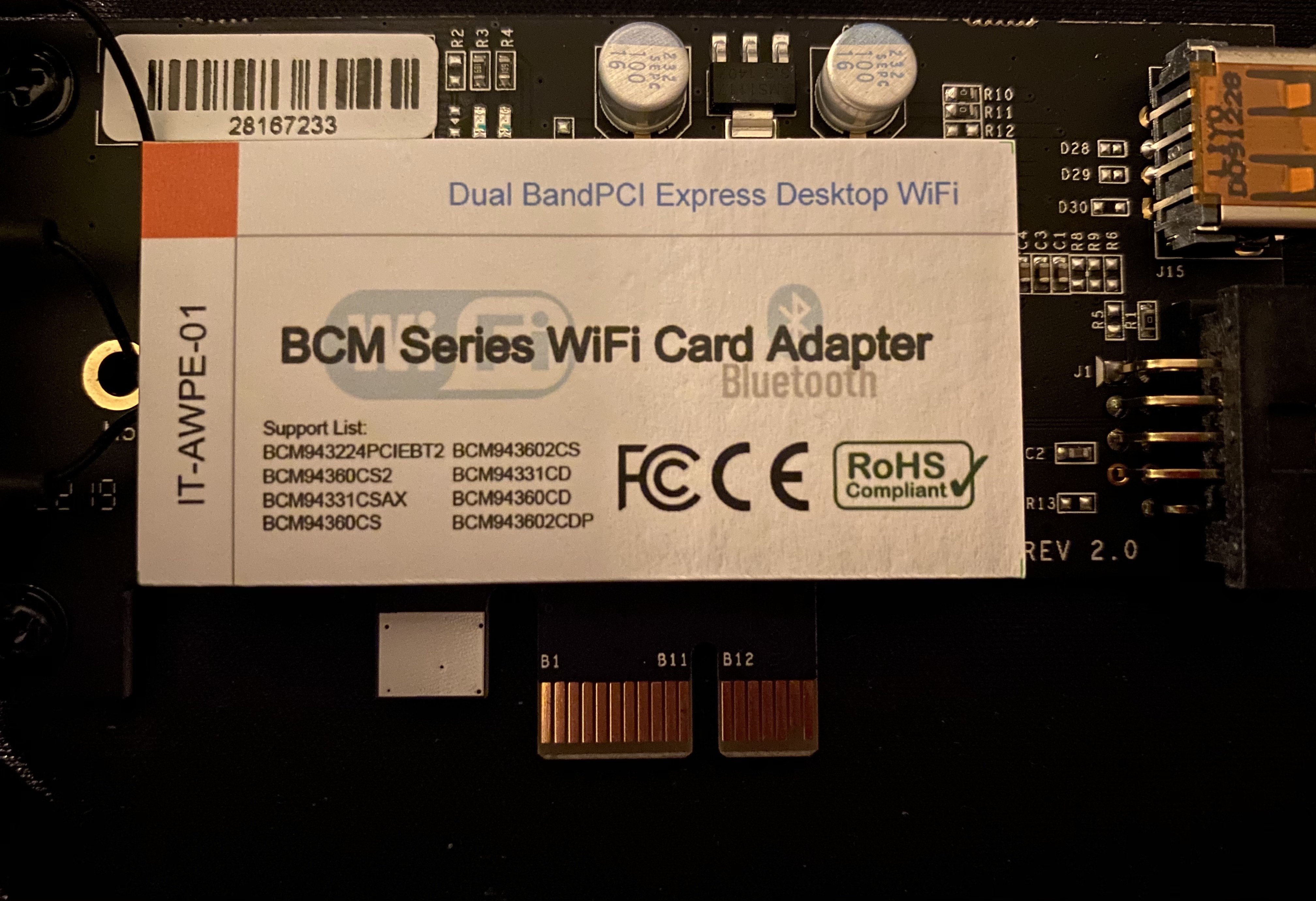

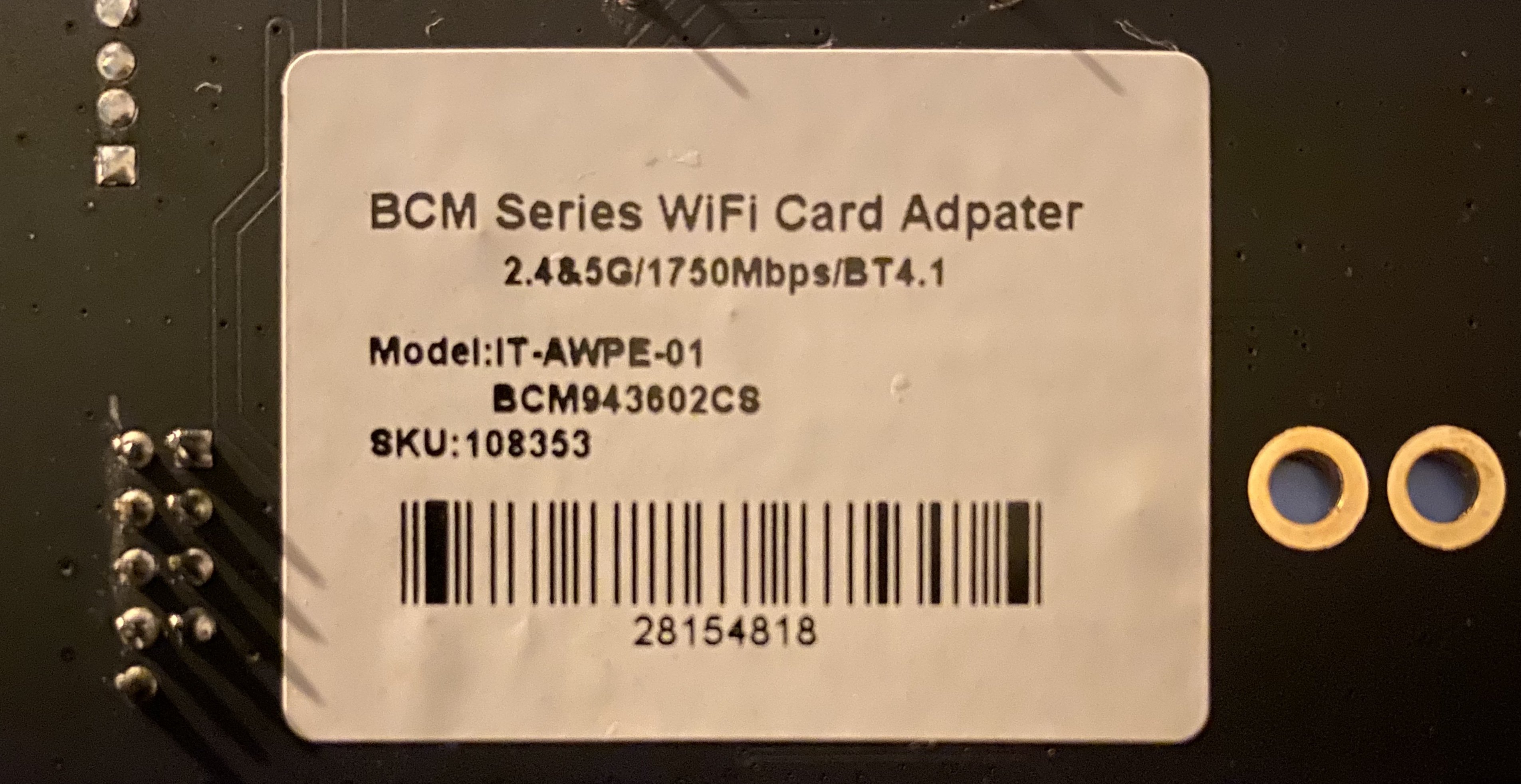

Matkhe Posted May 7, 2020 Share Posted May 7, 2020 Hi, first of all, great work. I used exactly that config on OpenCore latest Version and have more less the same hardware (Z390 MAster, 9700k, 5700XT, 32GB, 970 Evo, WifiCard BCM943602CS incl. BT 4.1).... But I've an issue with my PCI WifiCard BCM943602CS incl. Bluetooth via USB. Connected to the internal USB2 Hub, the Bluetooth adapter always wakes up my hackintosh immediately after sleep. When I disconnect the USB bluetooth from that card, I've no issues and my hackintosh sleeps like a baby and only wakes up until I hit my keyboard. Can this be solved anyhow? Cheers 1 Link to comment Share on other sites More sharing options...
AudioGod Posted May 7, 2020 Author Share Posted May 7, 2020 (edited) 25 minutes ago, Matkhe said: Hi, first of all, great work. I used exactly that config on OpenCore latest Version and have more less the same hardware (Z390 MAster, 9700k, 5700XT, 32GB, 970 Evo, WifiCard BCM943602CS incl. BT 4.1).... But I've an issue with my PCI WifiCard BCM943602CS incl. Bluetooth via USB. Connected to the internal USB2 Hub, the Bluetooth adapter always wakes up my hackintosh immediately after sleep. When I disconnect the USB bluetooth from that card, I've no issues and my hackintosh sleeps like a baby and only wakes up until I hit my keyboard. Can this be solved anyhow? Cheers go into Hackintool and clear your cache and rebuild permissions and then restart and clear the nvram at the bootpicker. If that doesn't work then there's a batch of them wifi combo cards out there that don't work with the latest version of Cat and cause sleep to fail. its not due to the BCM943602CS but the adaptor its using. Is it a black pcb by any chance? I use the ABWB BCM943602CS 802.11AC WI-FI With Bluetooth 4.0 PCI-Express (PCI-E) and it works a charm. Also try with and without AirportBrcmFixup.kext some cards like mine love it and some others using a different adaptor seem to hate it. only other things I can suggest is to make sure you use one of the lowest two slots on the board. (8x at the bottom or the 1x just above it) Edited May 7, 2020 by AudioGod 1 Link to comment Share on other sites More sharing options...
Fullyarm Posted May 7, 2020 Share Posted May 7, 2020 13 minutes ago, AudioGod said: go into Hackintool and clear your cache and rebuild permissions and then restart and clear the nvram at the bootpicker. If that doesn't work then there's a batch of them wifi combo cards out there that don't work with the latest version of Cat and cause sleep to fail. its not due to the BCM943602CS but the adaptor its using. Is it a black pcb by any chance? I use the ABWB BCM943602CS 802.11AC WI-FI With Bluetooth 4.0 PCI-Express (PCI-E) and it works a charm. Also try with and without AirportBrcmFixup.kext some cards like mine love it and some others using a different adaptor seem to hate it. only other things I can suggest is to make sure you use one of the lowest two slots on the board. (8x at the bottom or the 1x just above it) I have fenvi T919 for macOS PC PCI Wifi Card Continuity Handoff BCM94360CD and it's working both here and on windows. No issues. 1 1 Link to comment Share on other sites More sharing options...
